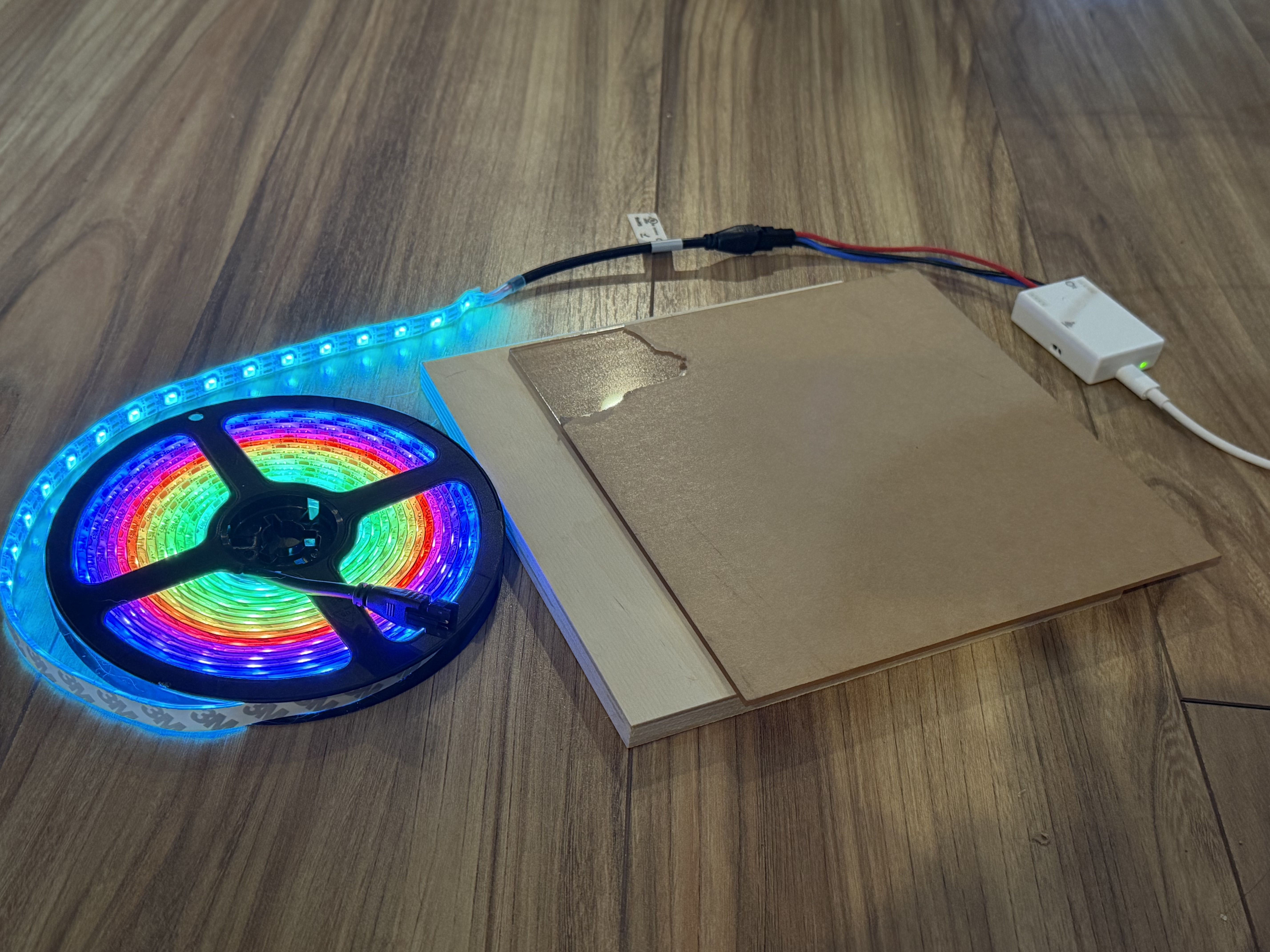

We’ll make a small test stand out of ply to hold the strips and test pieces. Nothing special, just a 10mm slot for the strip, maybe a diffusion layer, and a small slot for the acrylic.

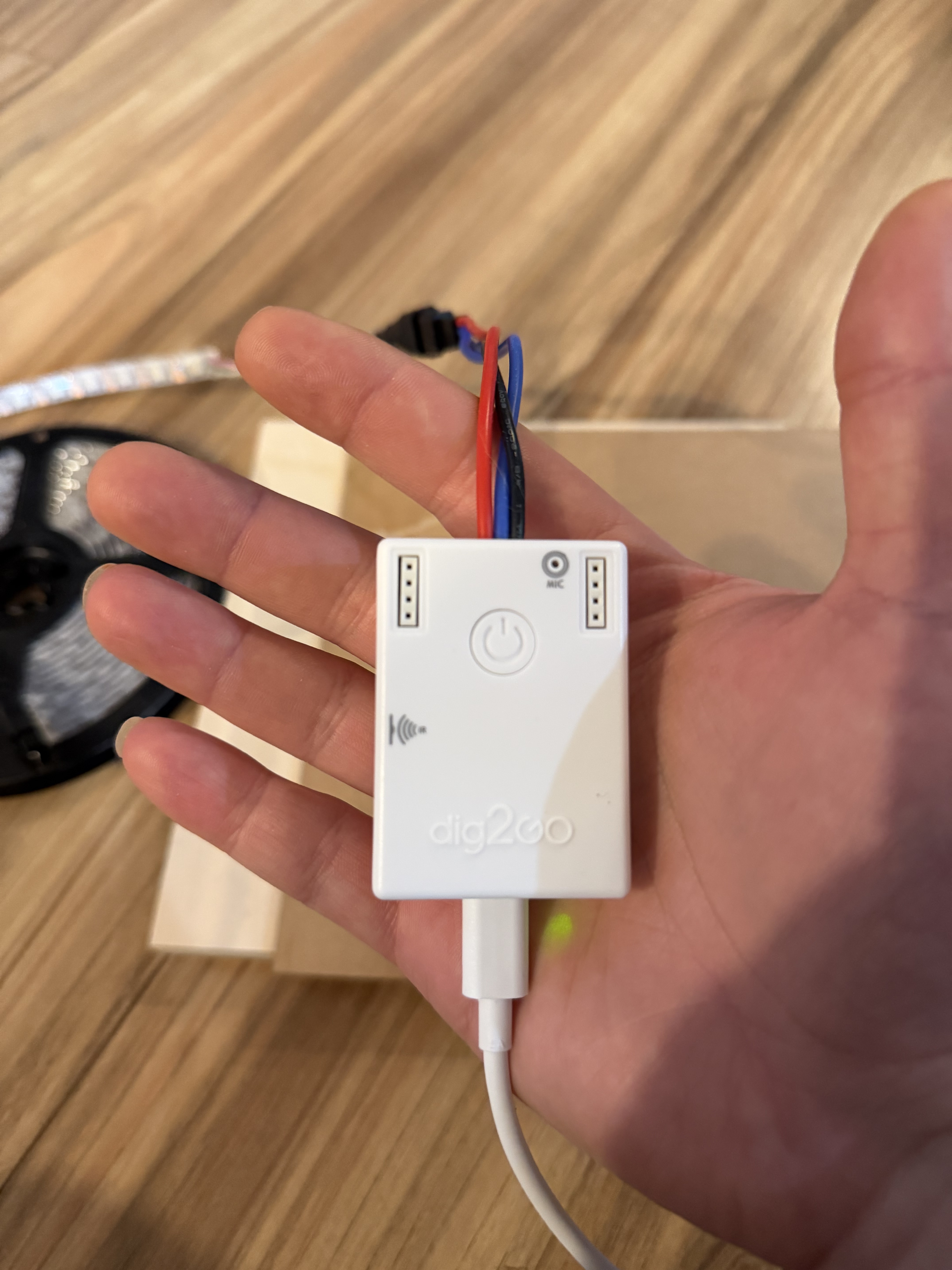

Controller is a dig2go. It’s a 5v controller that runs on usb-c with a ton of built in functionality like music reactivity and headers for expansion. It also works on WLED so controlling it is trivial from phone or WiFi.
It’s my goto development board, though I’d likely go with something cheaper if I was going to be selling pieces.
The test strip is a bit special. RGBW, the addition of the dedicated white lets you get really clean white light if you care about that kind of thing. Just a great all around strip with good versatility.

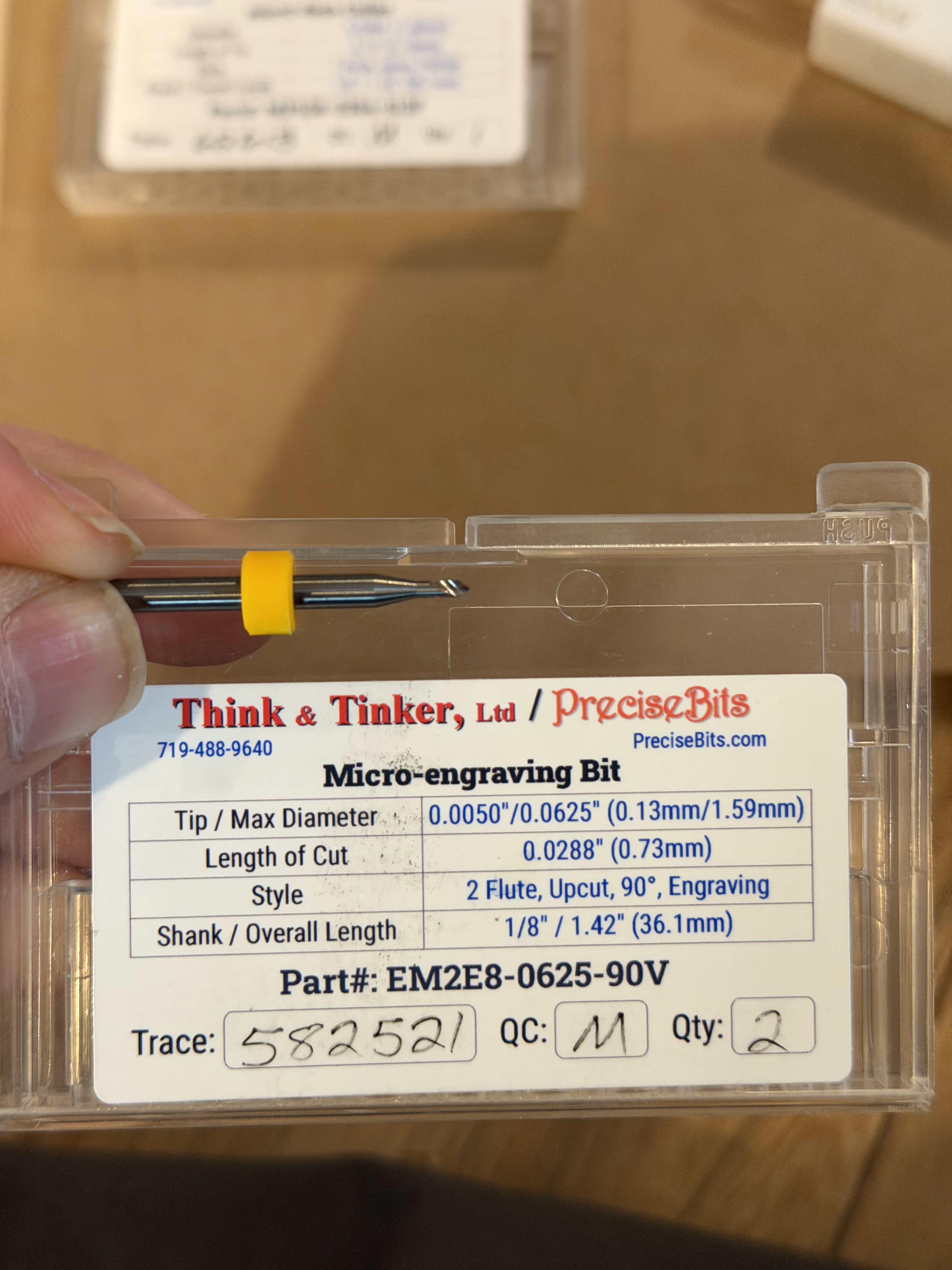

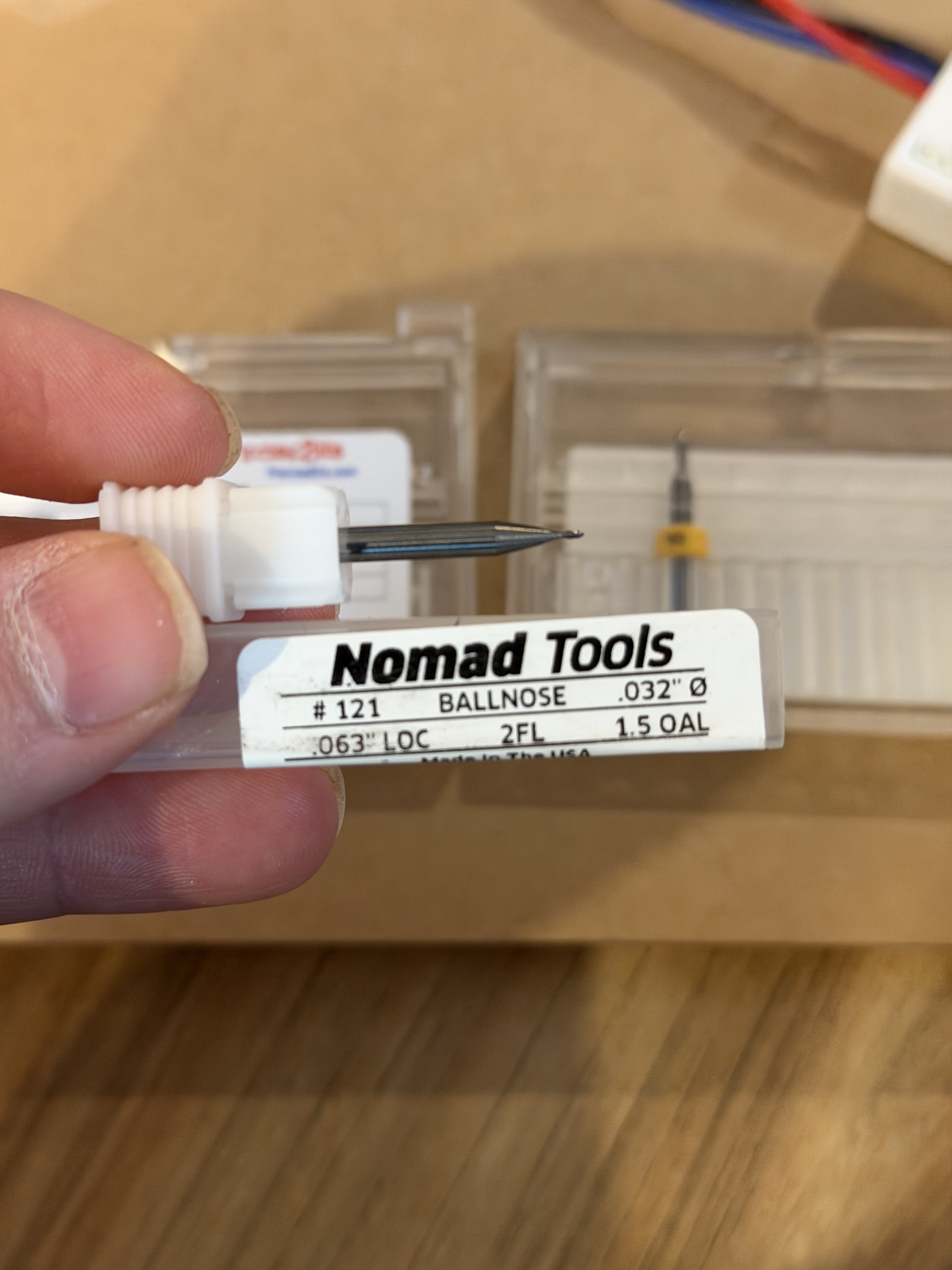

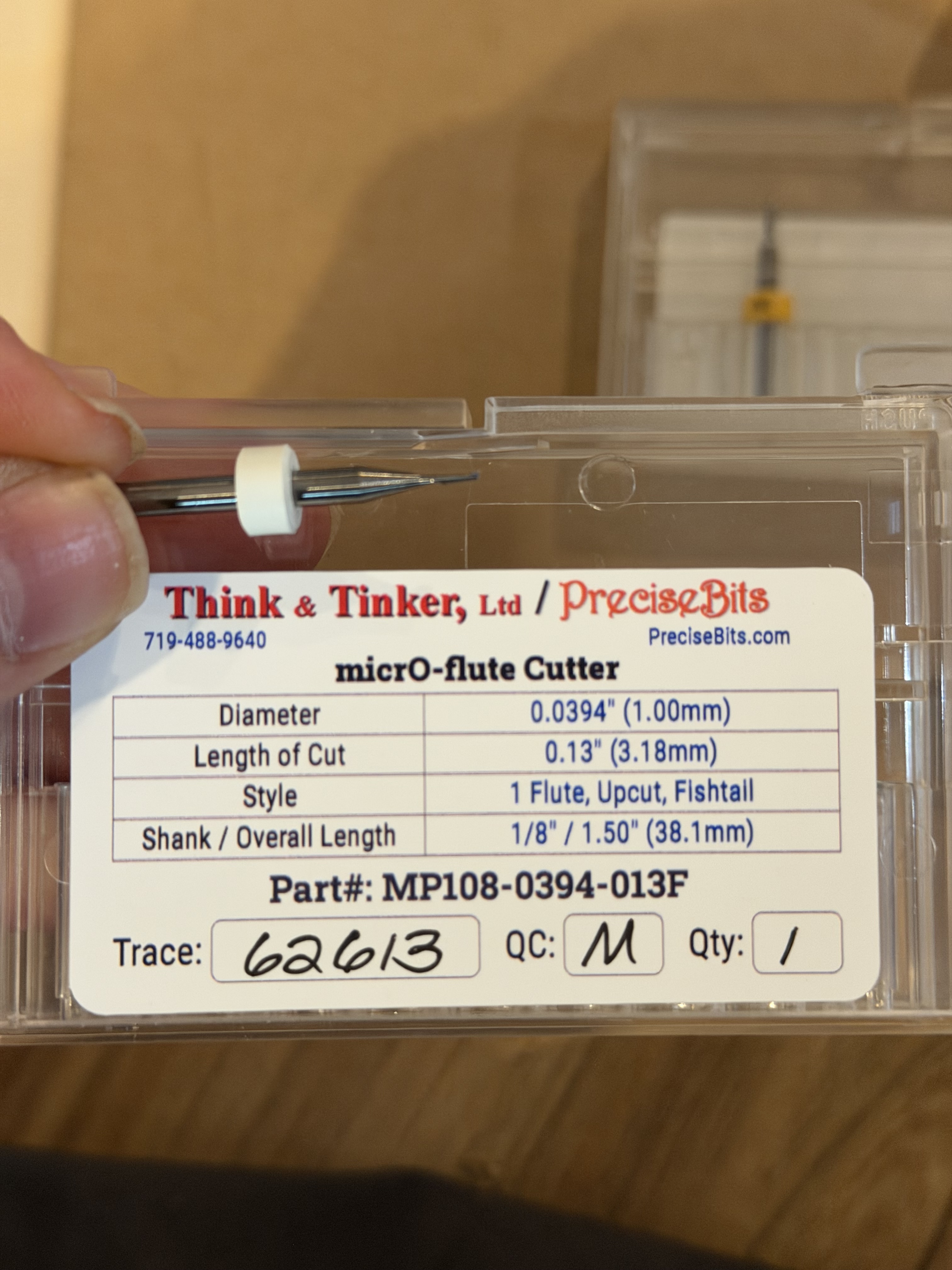

Tooling I’ll be testing today is a tiny ball mill, a v bit engraver, a tiny plastic specific single flute, and if I can find it…my MCEtcher. (If anyone knows where I left it, let me know :see_no_evil:)

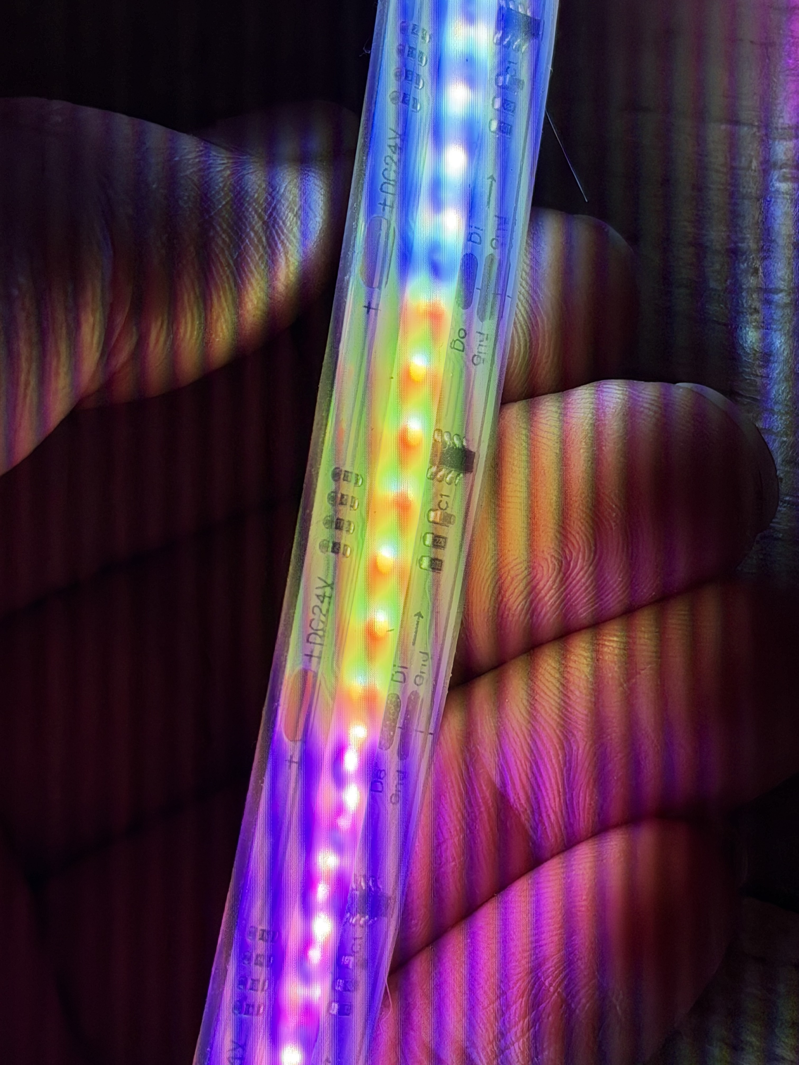

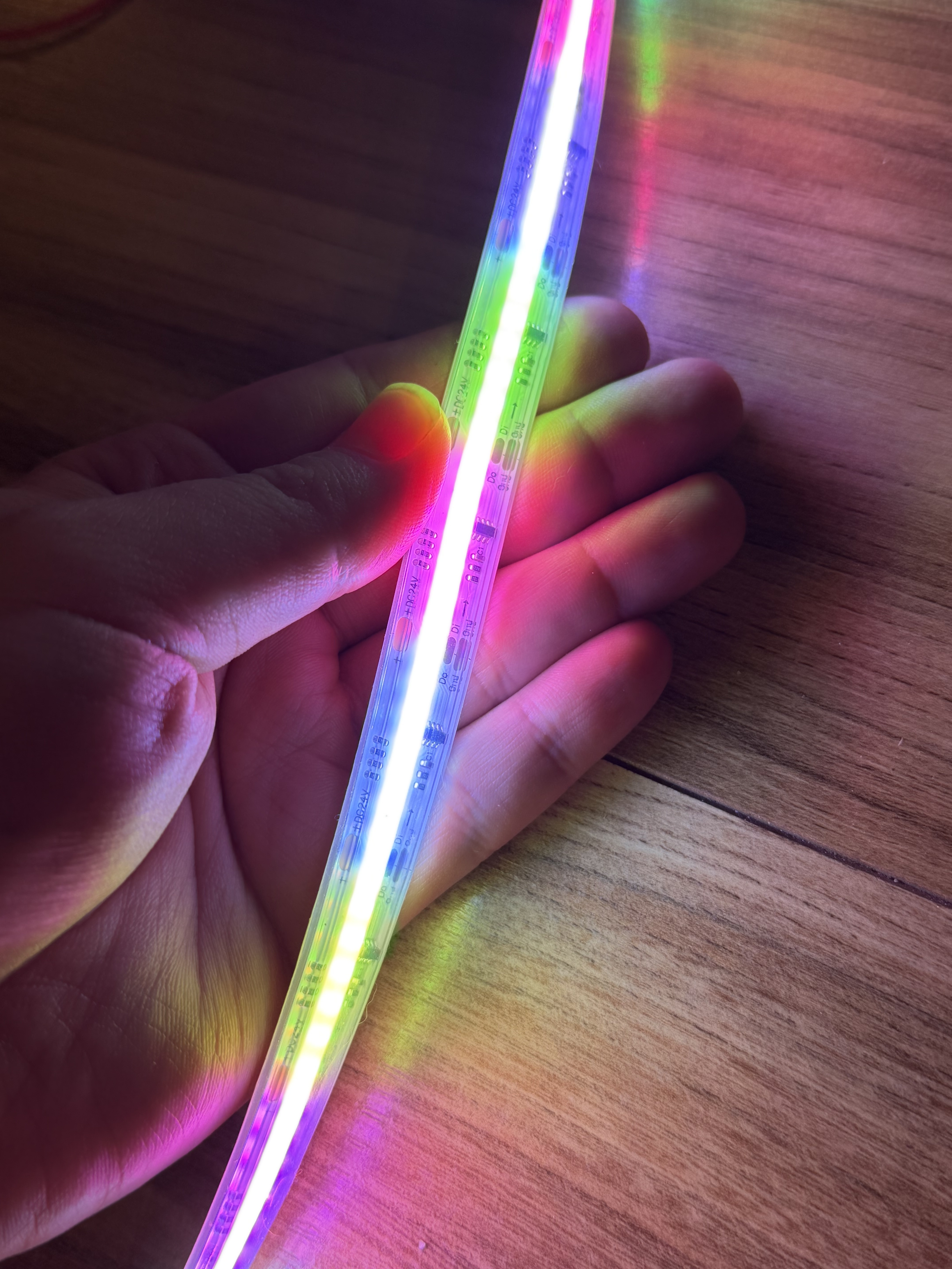

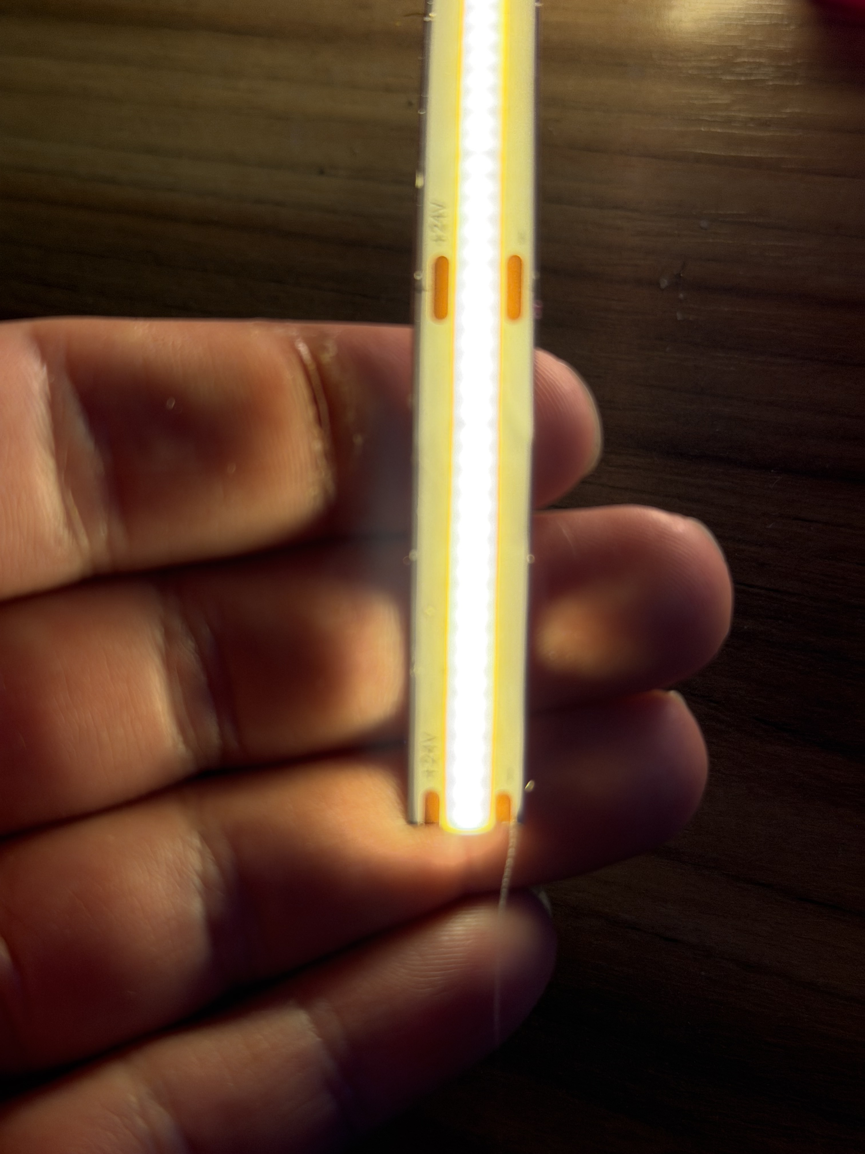

While RGB addressable LED strips are super-cool & great to experiment with, I’d also suggest looking at strips that use micro-LEDs or designed to simulate Neon lighting. These provide a more uniform light pattern into the edge of the acrylic. I’d also suggest getting hold of some coloured-mirror acrylic panel - it has a super-cool look!

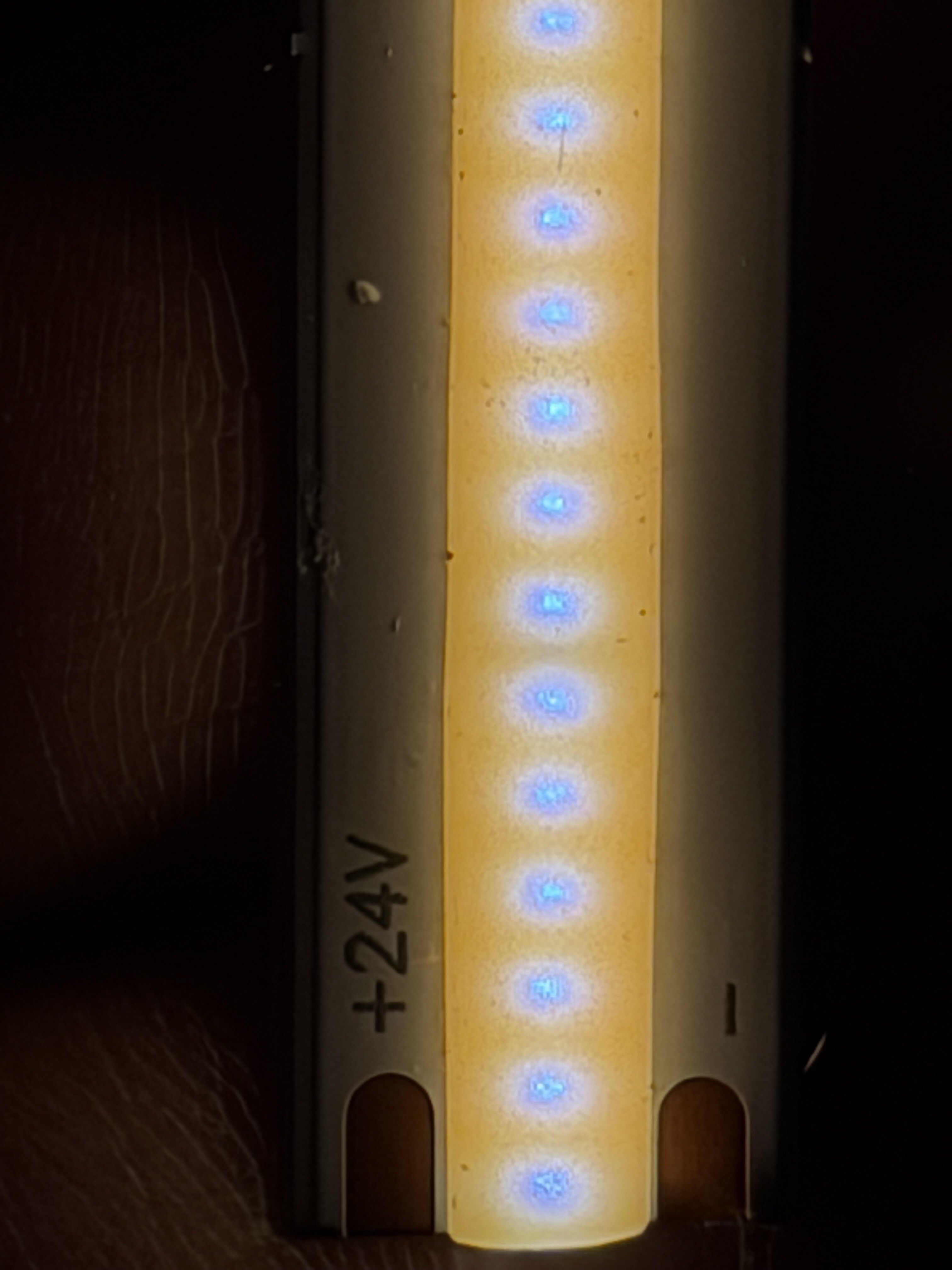

Yeah the fcob LEDs are my favorite, they just tend to be a bit more complicated to work with. They also tend to be overkill for what I expect to be smaller signs.
Here are some more dense rgbw fcobs for reference:
And some incredibly dense single color analog pwm fcobs:
Most of the more dense strips I’ve found aren’t capable of being run off of usb power. But I’ll go into the more capable higher voltage controllers and strips after we’ve got some good testing done :slightly_smiling_face:
Good call on the mirror backed acrylic, that’s going to be interesting to play with. Especially if we can do any forming on it.
Clearhill 5V USB COB LED Strip Lights,Cool White 6500K,8mm Width 320LEDs/m,8W/m,CRI90,16.4FT/5M,Electroplated Double-Sided Panel Light Strip,Waterproof IP20,Flexible Strip for Indoor Decoration : Amazon.ca: Tools & Home Improvement
The USB powered LED strips are definitely the way to go for small signs.

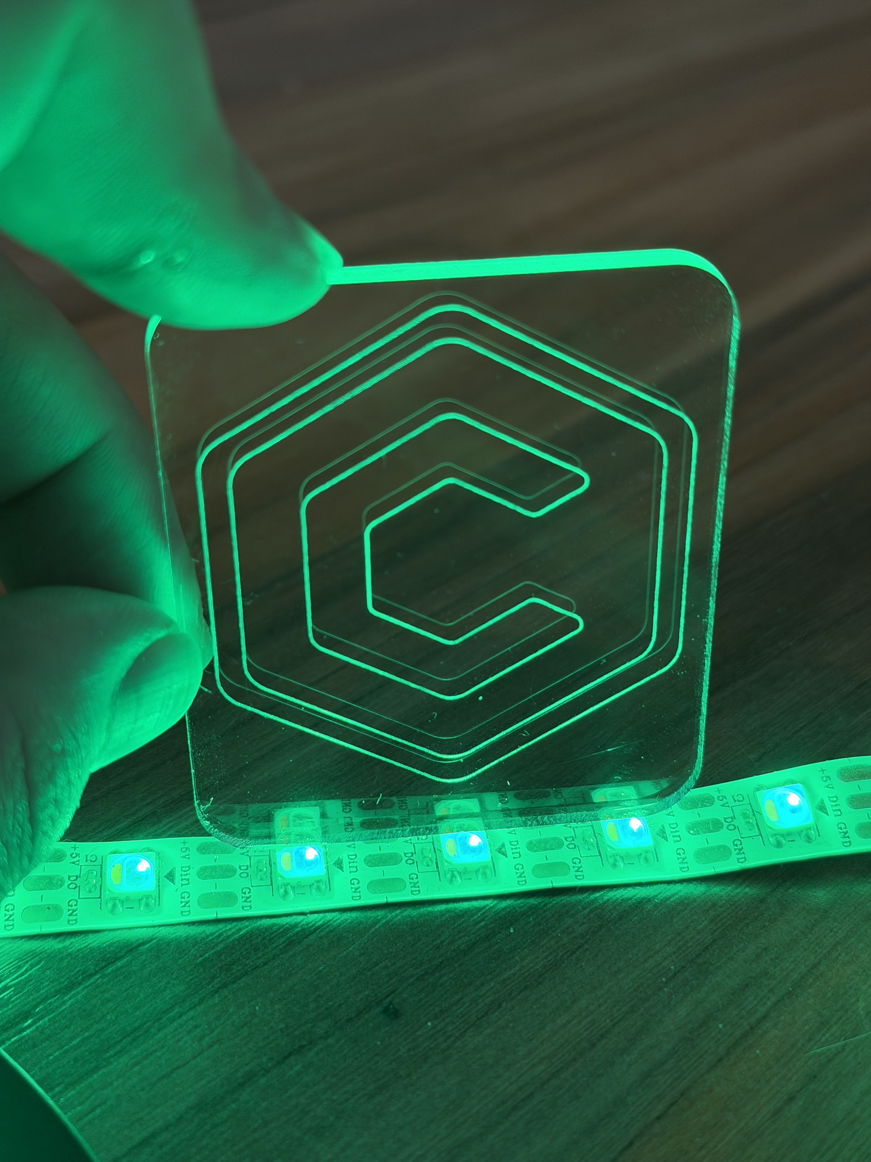

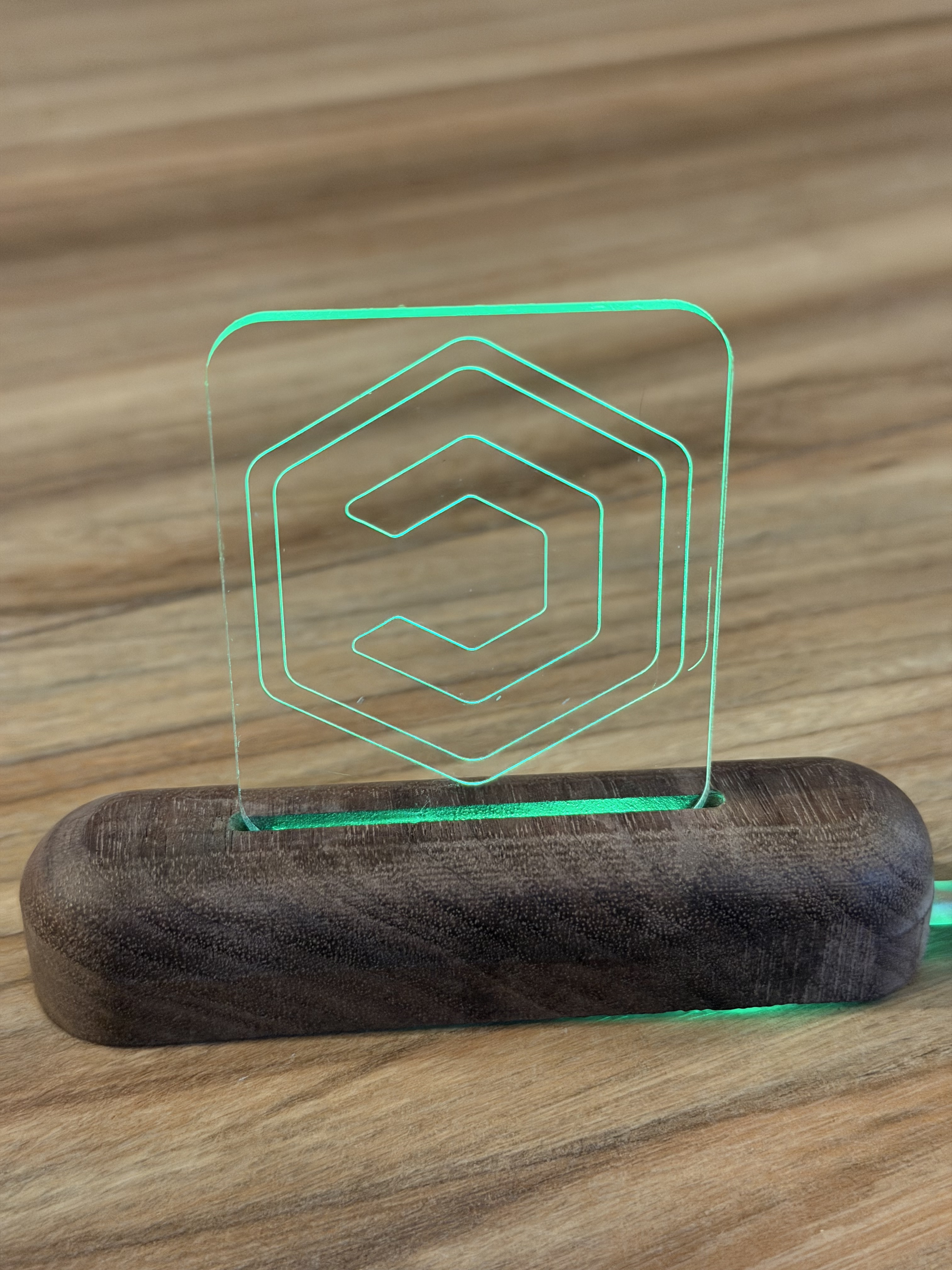

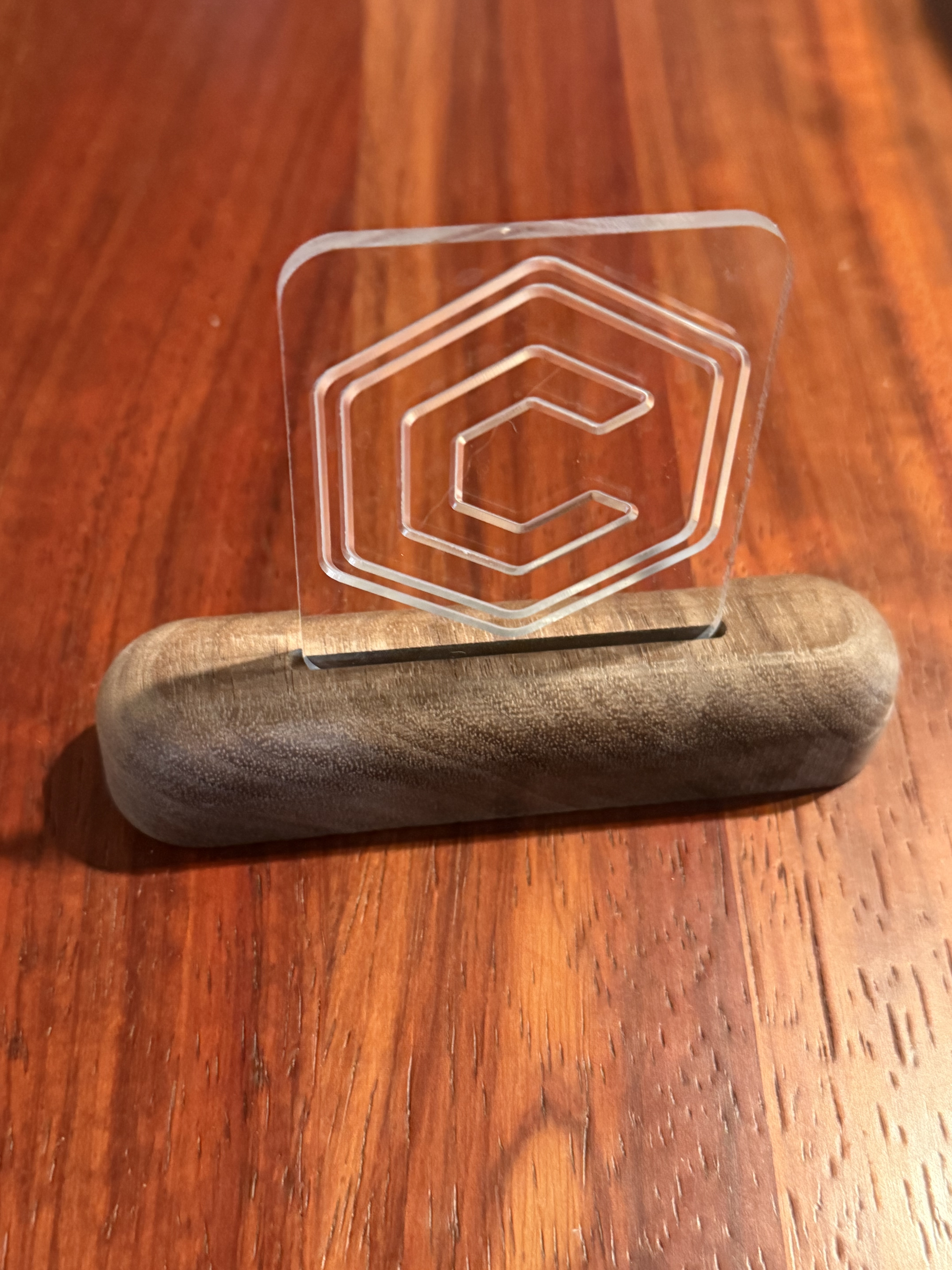

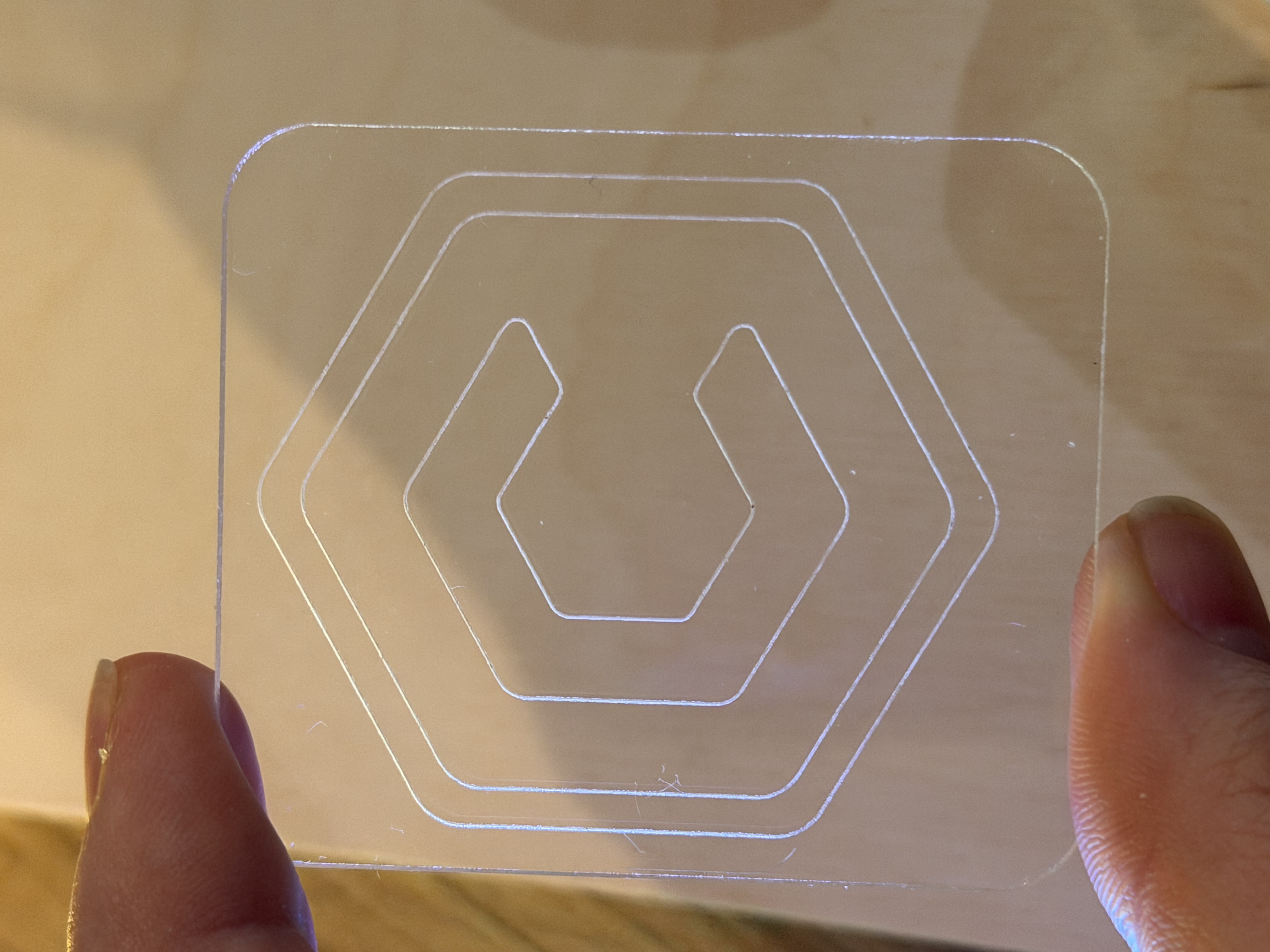

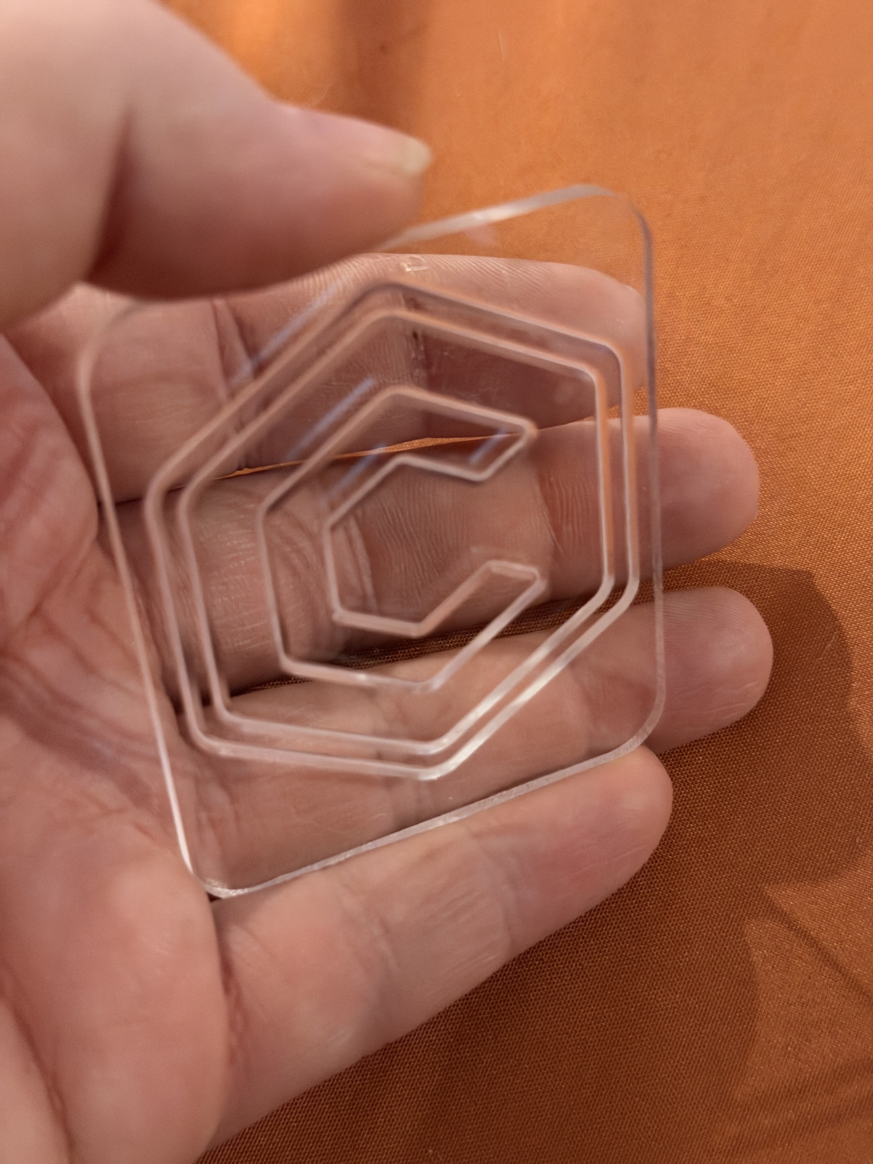

Got distracted and need to get the wood stand cut but here’s an example of the 90 degree mcetcher:

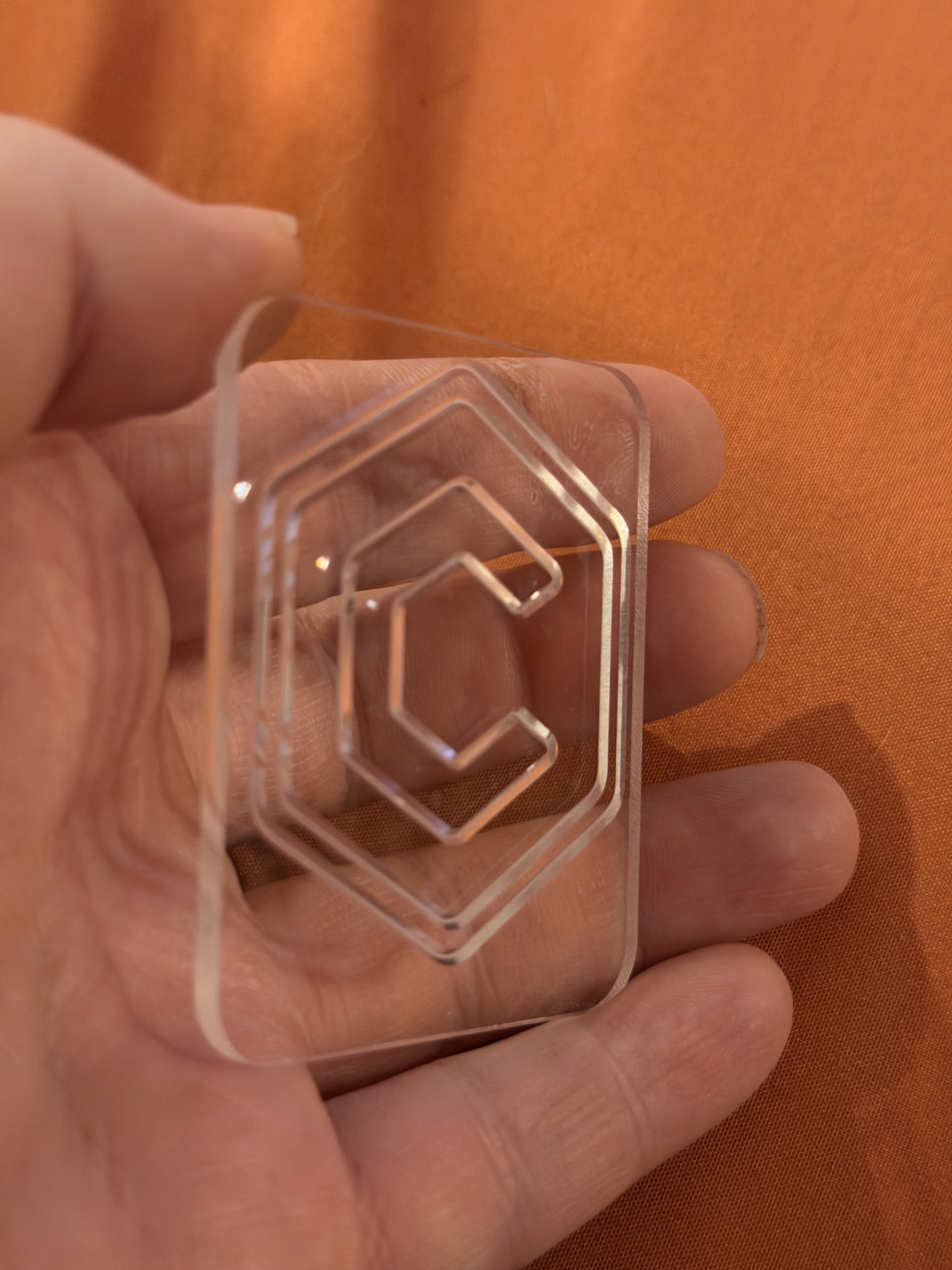

Little ~2” signs so I can get a bunch of em out of a single acrylic sheet.

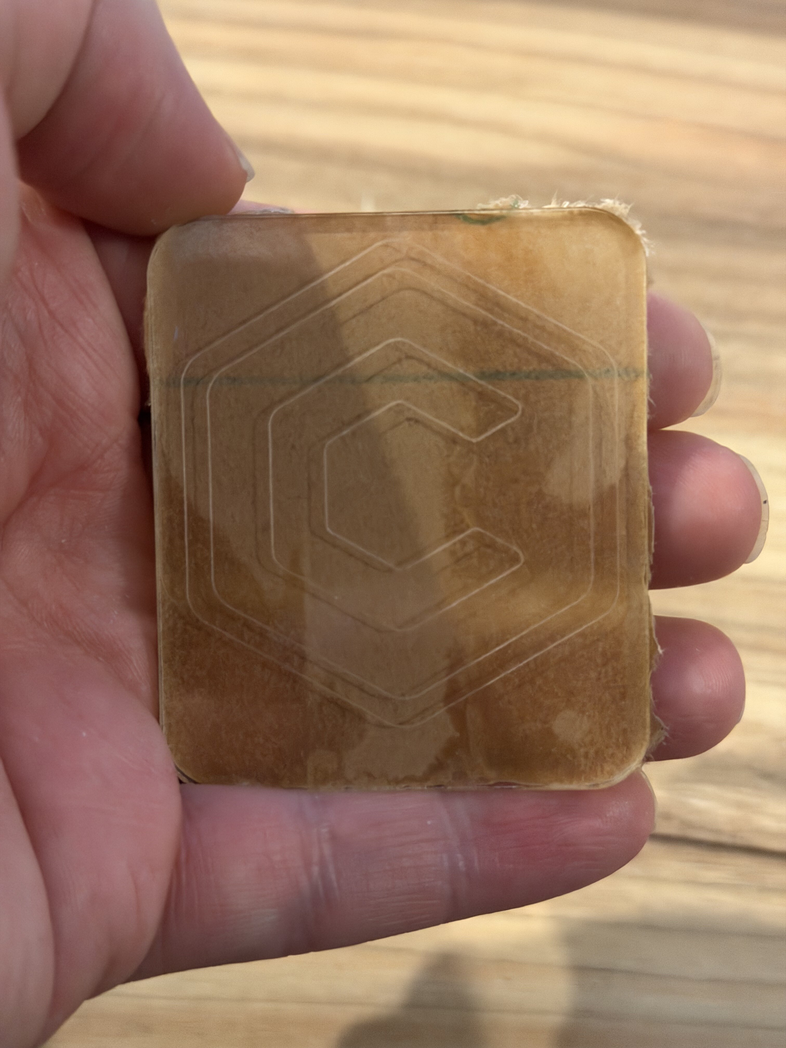

The soap and water on the surface trick that (I think) @WillAdams recommended seems to have worked very well.
I’ll use the C3D logo for testing and get a few larger sheets of acrylic ordered for some 8” topo maps.
Mount Rainier here we come.
Super excited to try some thicker acrylic for 3d topo maps but I’m not sure how to finish it. Maybe a careful flame polish or something…3d topo will almost certainly be its own post :slightly_smiling_face:
I have to try the soap trick tomorrow.
Thin acrylic cuts like thick. I use 0.115 think ( glowforge )
I cut a 0.090 sheet, looks/handles the same.

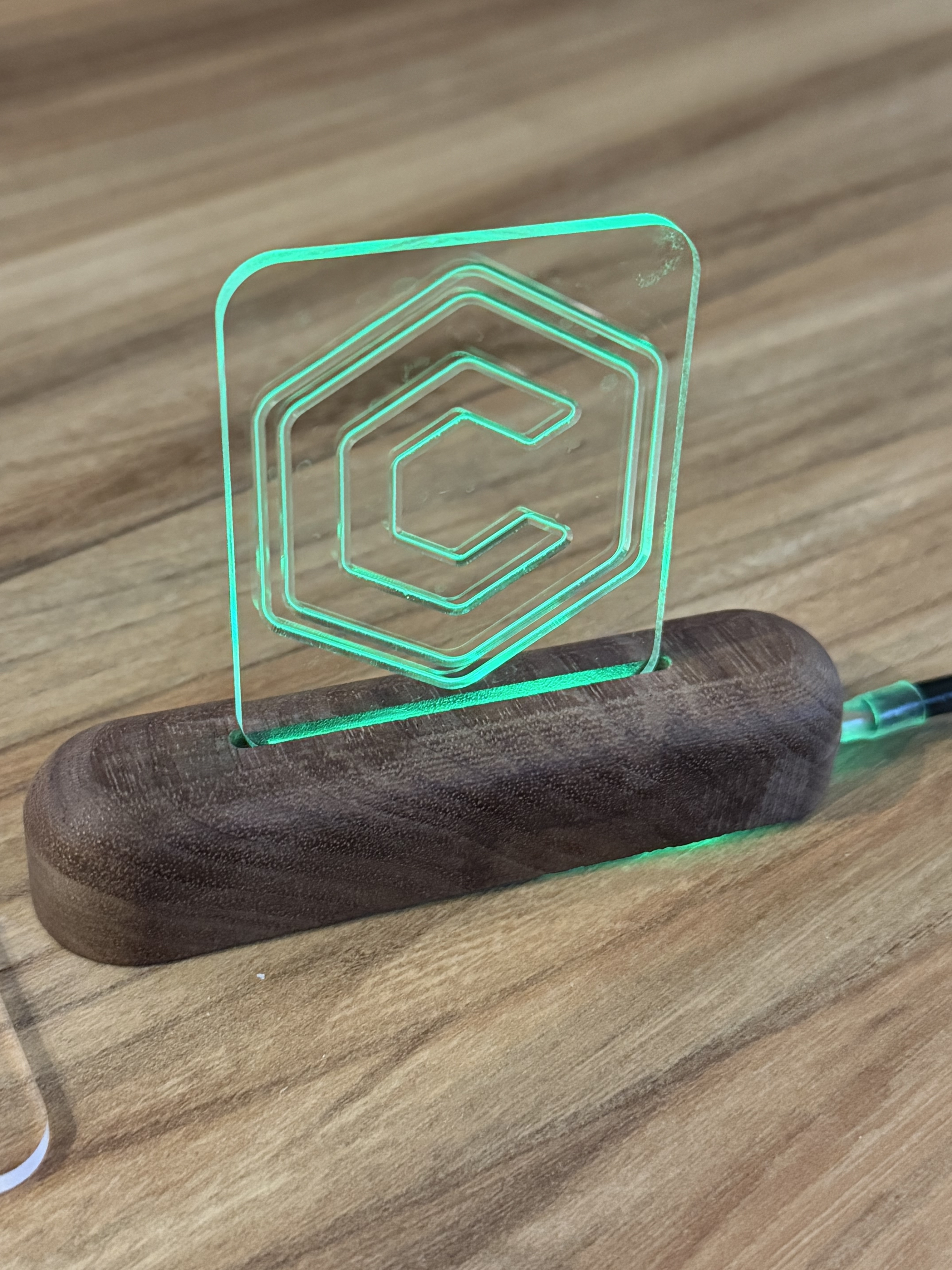

.04” depth of cut with 90 degree engraver.
Front and back to show how it looks with engraving on each side.
Engraving 90 mcetcher.

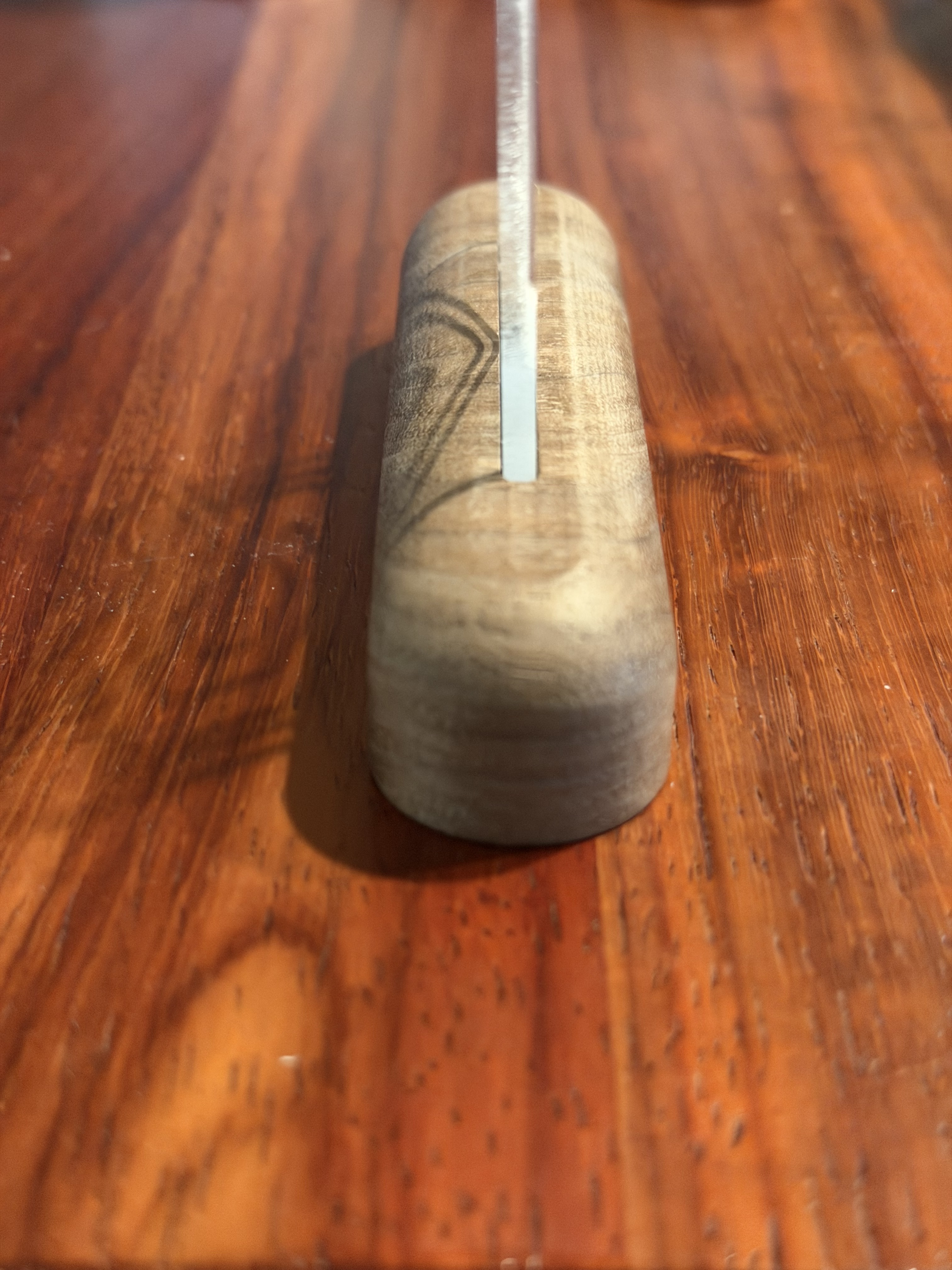

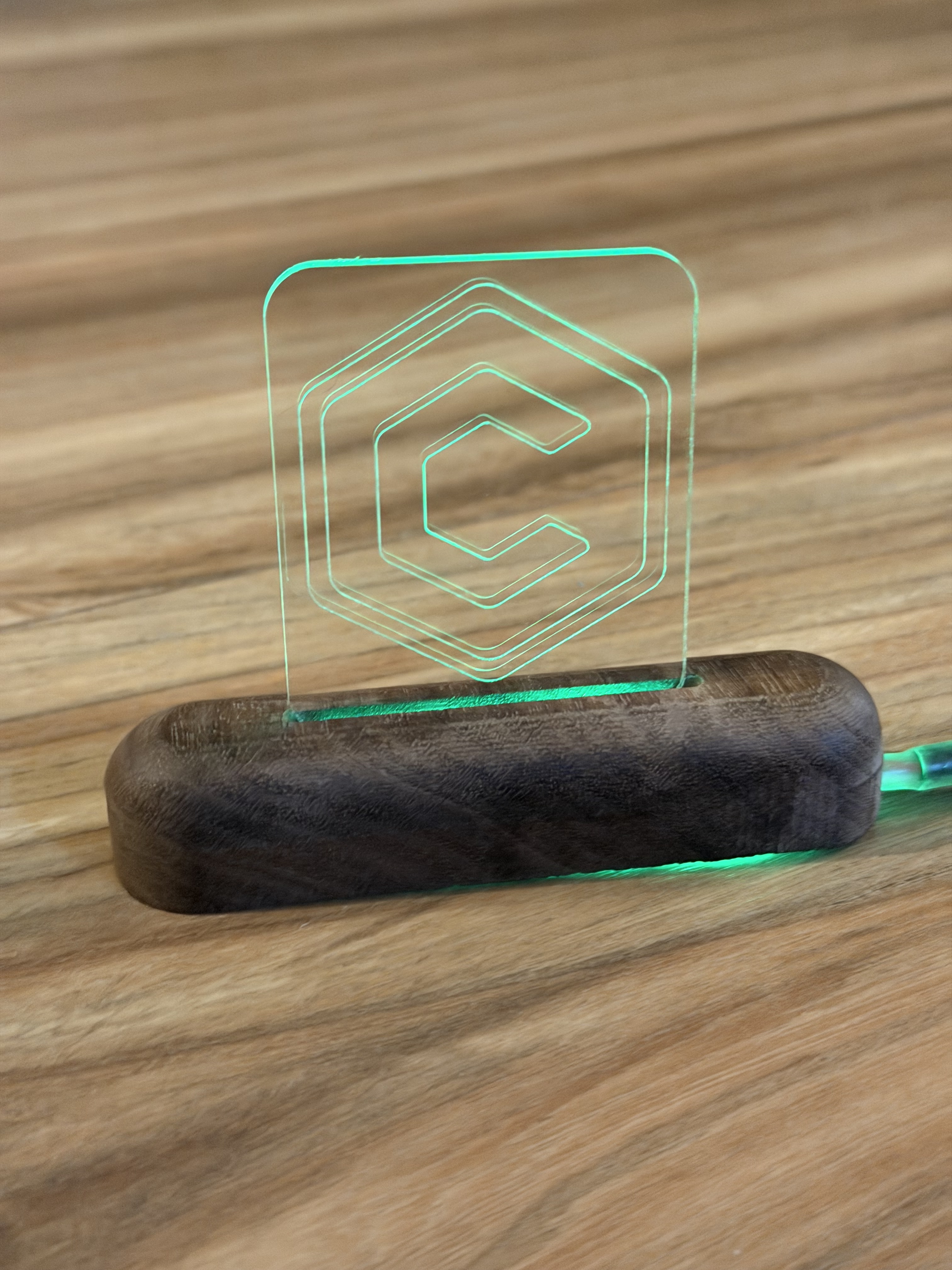

Stand very much not finished :sweat_smile:

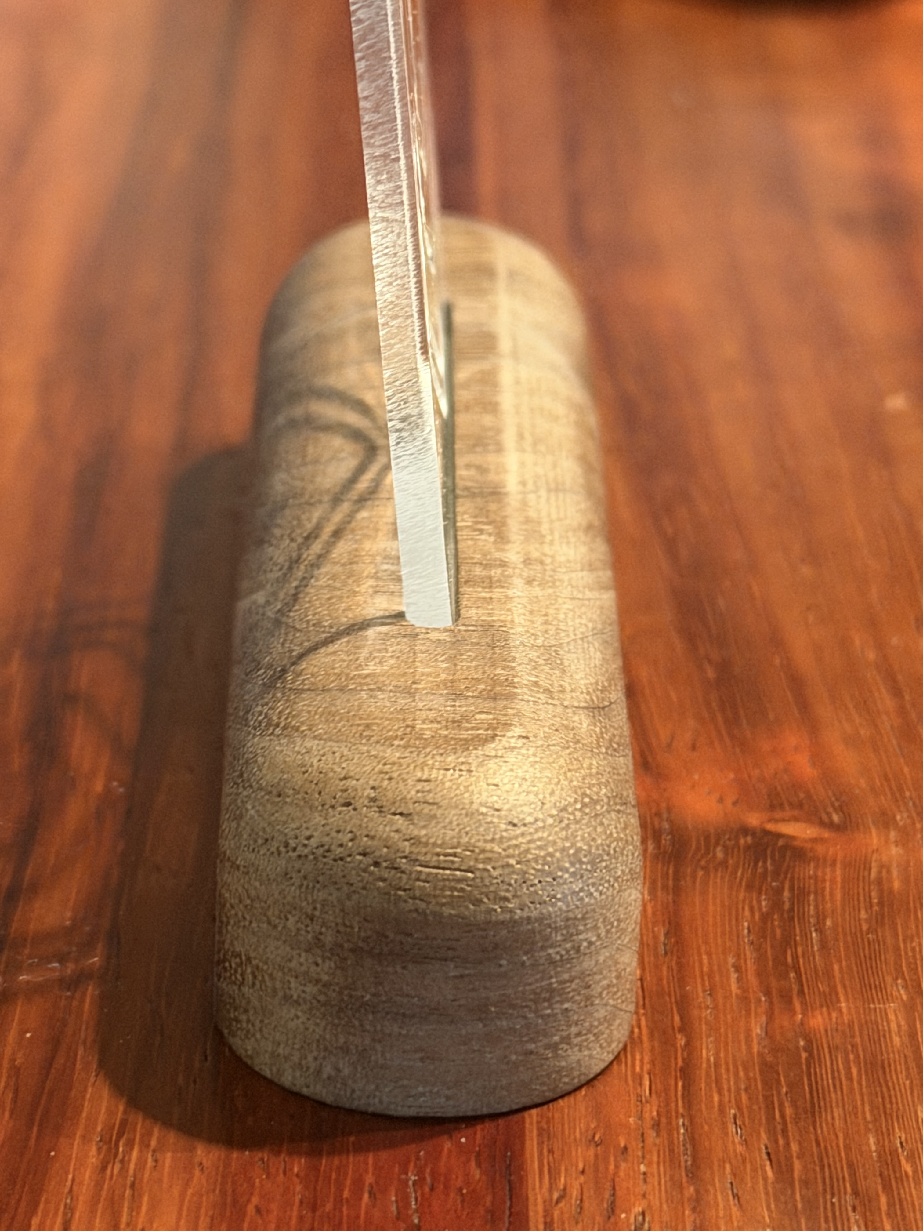

Walking by this stand a couple of times today and the tilt of the acrylic in the slot is actually pretty annoying.
Pretty sure I used an 1/8” tool to slot and this acrylic is just under 3mm. It sits fine if it’s just right:
Might throw a piece of felt in the slot over lunch to straighten it up without scratching or fuss.
I’ve found that 1/8" acryilic is actually closer to 2.5mm - with the protective paper/plastic wrap it’s 3mm. A stubby 1/16" bit makes quick work of a slot that is 2.75mm.
For purposes of press fitting, slots, etc., note that there is some variability in thickness of acrylic sheets even from the same manufacturer.
That’s a good shout :pray:
I’m hoping a bit of felt will be good enough to absorb tolerance differences in most of the smaller signs I’d want to do.
For larger pieces, I imagine the cost of the material alone makes it worth measuring and accounting for each piece as necessary.
Electrical tape wrapped around the bottom of the acrylic? It would stay in place better than felt.

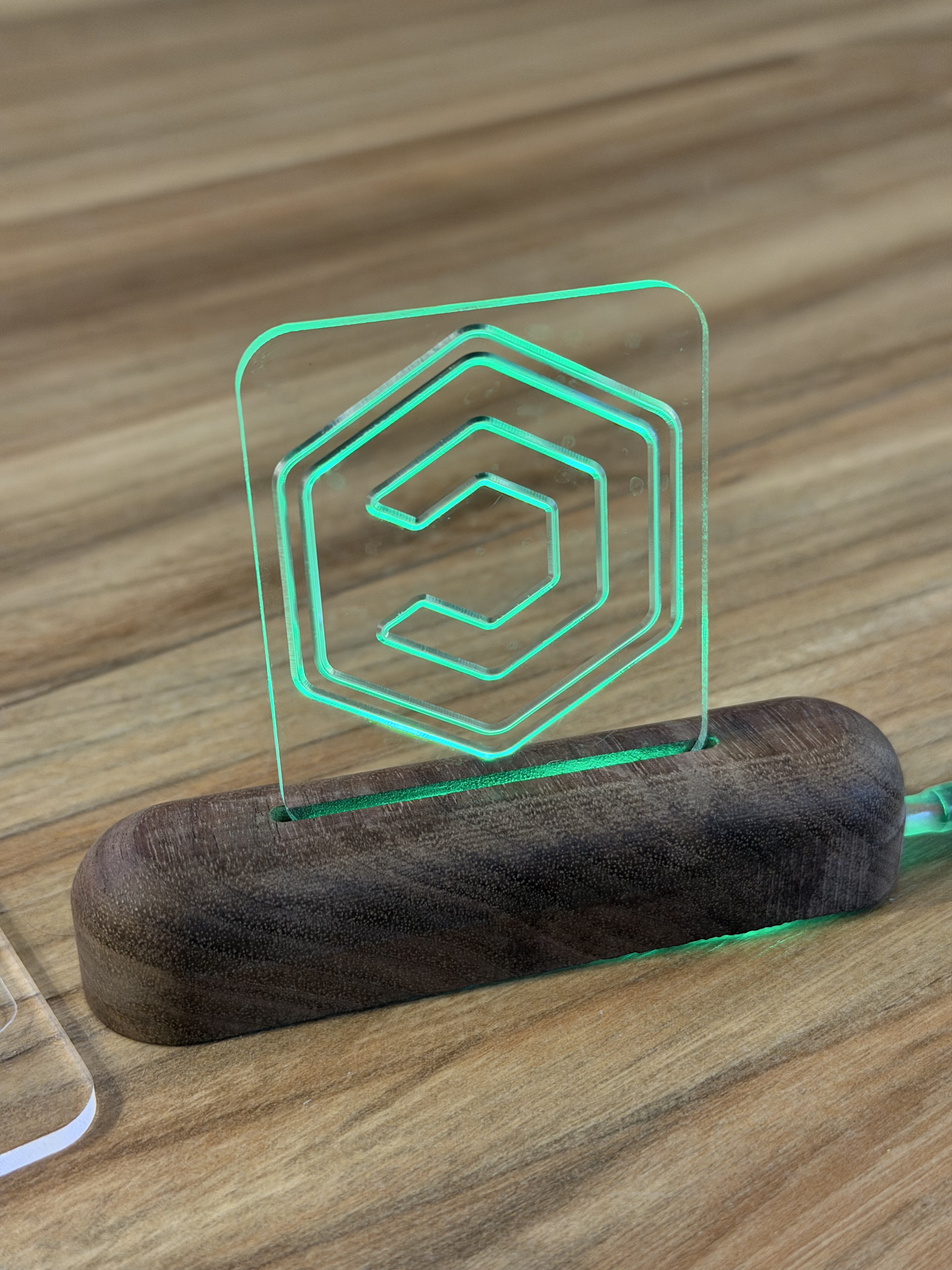

I cut the test piece with the ball mill today. Came out beautifully.
The biggest surprise for me in this testing has been how impactful the tool geometry is on the final product. The highlights of the signage end up finding their way just a little differently.
It makes sense when I think about it though, light is a fickle thing. Hitting a 90 degree wall vs a 45 degree vs a curve, they’re going to have dramatically different impact on the path of that light. That difference results in perceptible aesthetic differences.
Kind of like gem cutting I suppose. Those angles make a world of difference.
