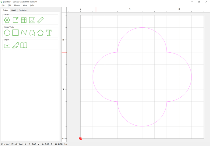

I have 4 overlapping circles and I need to remove all the lines except the outline I have tried everything that is obvious Please Help.
Looks like a plus sign with rounded ends.
This can be done using Boolean operations:
or the Trim Vectors tool:
just click on the lines you don’t want:
until you arrive at:
where you may select:
and use the Join Vectors command to join into a closed object:

A further consideration is that since in current versions Boolean operations yield polylines, it is arguably better to use the Trim Vectors tool, since it preserves curves — just click on all the lines one doesn’t want, then stitch back together what one is keeping.
Thanks guys I finally got it !!!
