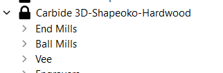

Have the 311 and 312 bits and looking forward to using them. CCreate V8 does not list these in the bit selection. I know they can be added, but being novice at tweaking bit settings I have no idea where to start. Can you provide recommended parameters for these bits for hardwood?
Thanks!
I see the bits in Shapeoko Hardwood under vee bits.
They may be in other categories as well. I am not completely up to date but CC is 838.
Thank you, I see them now…Duh
