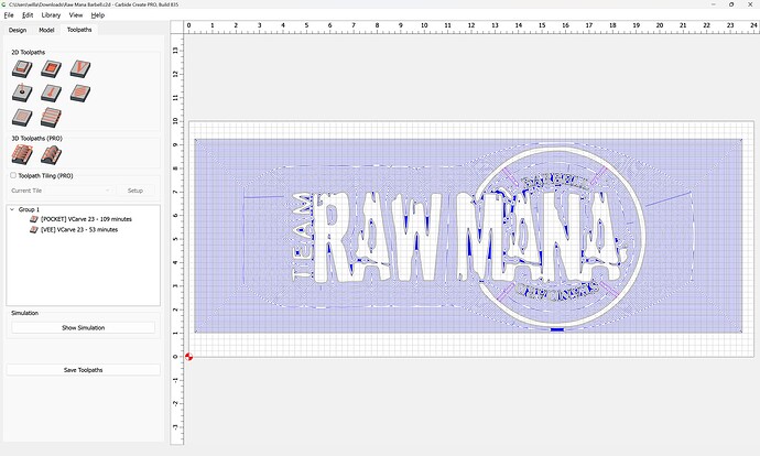

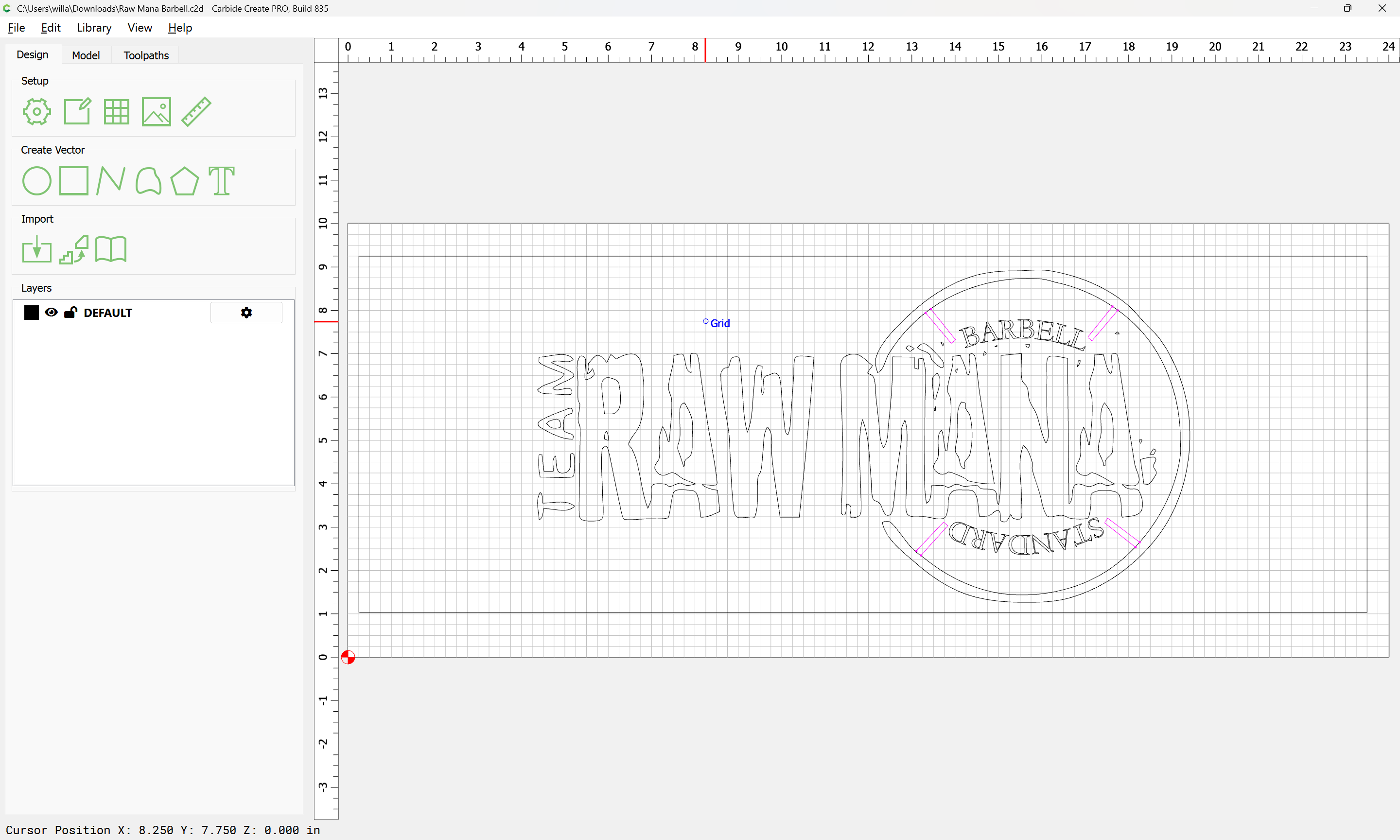

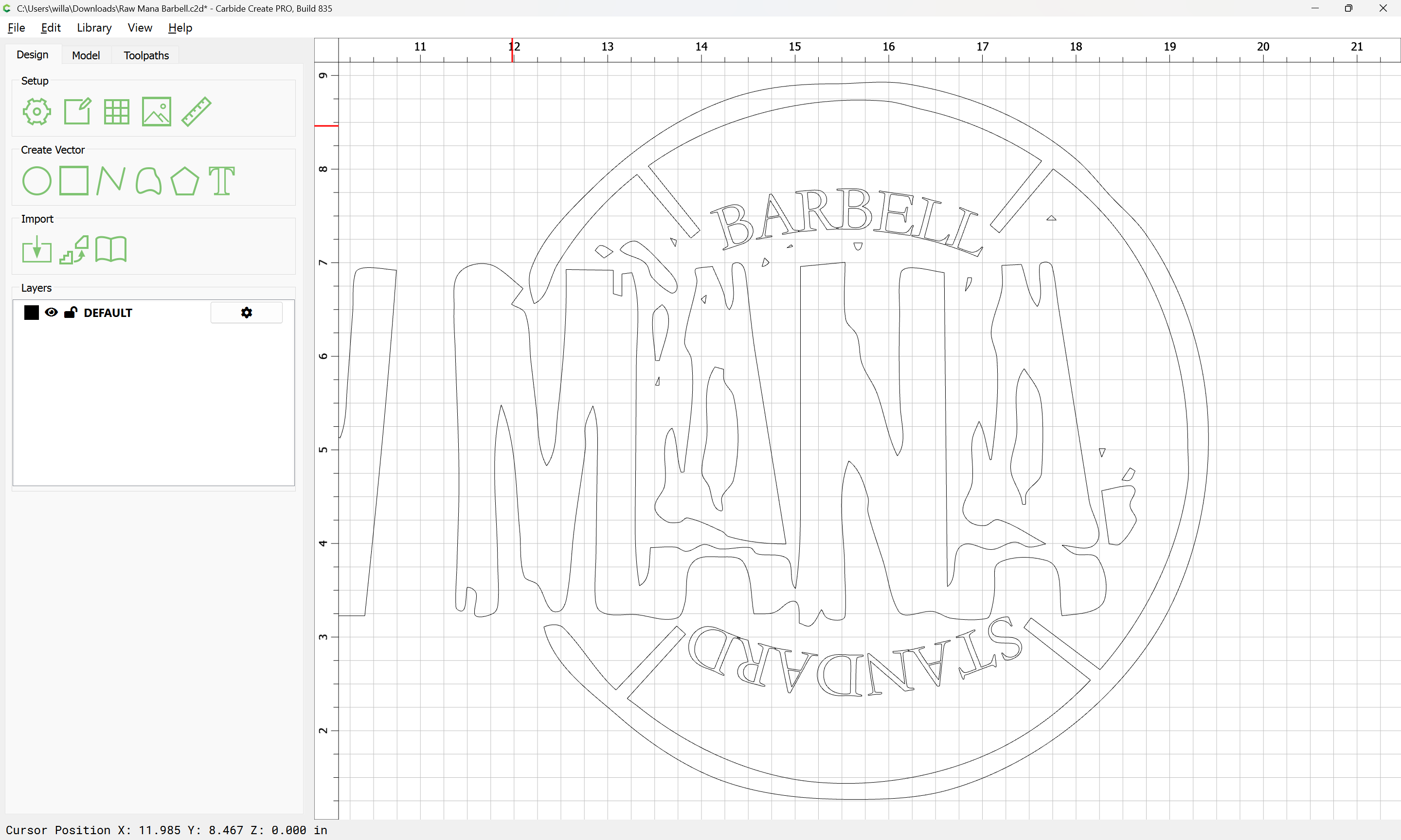

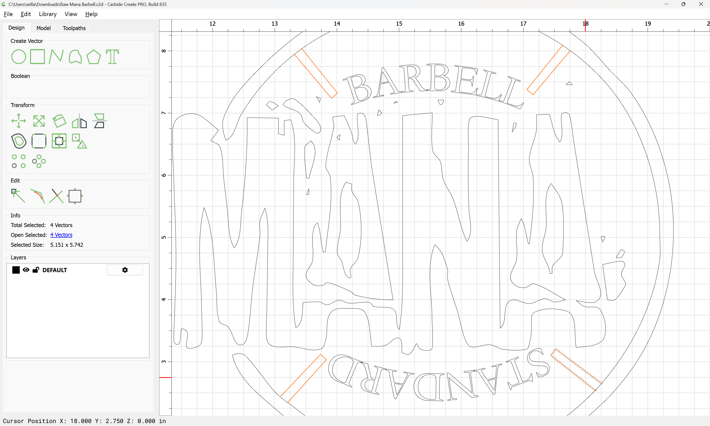

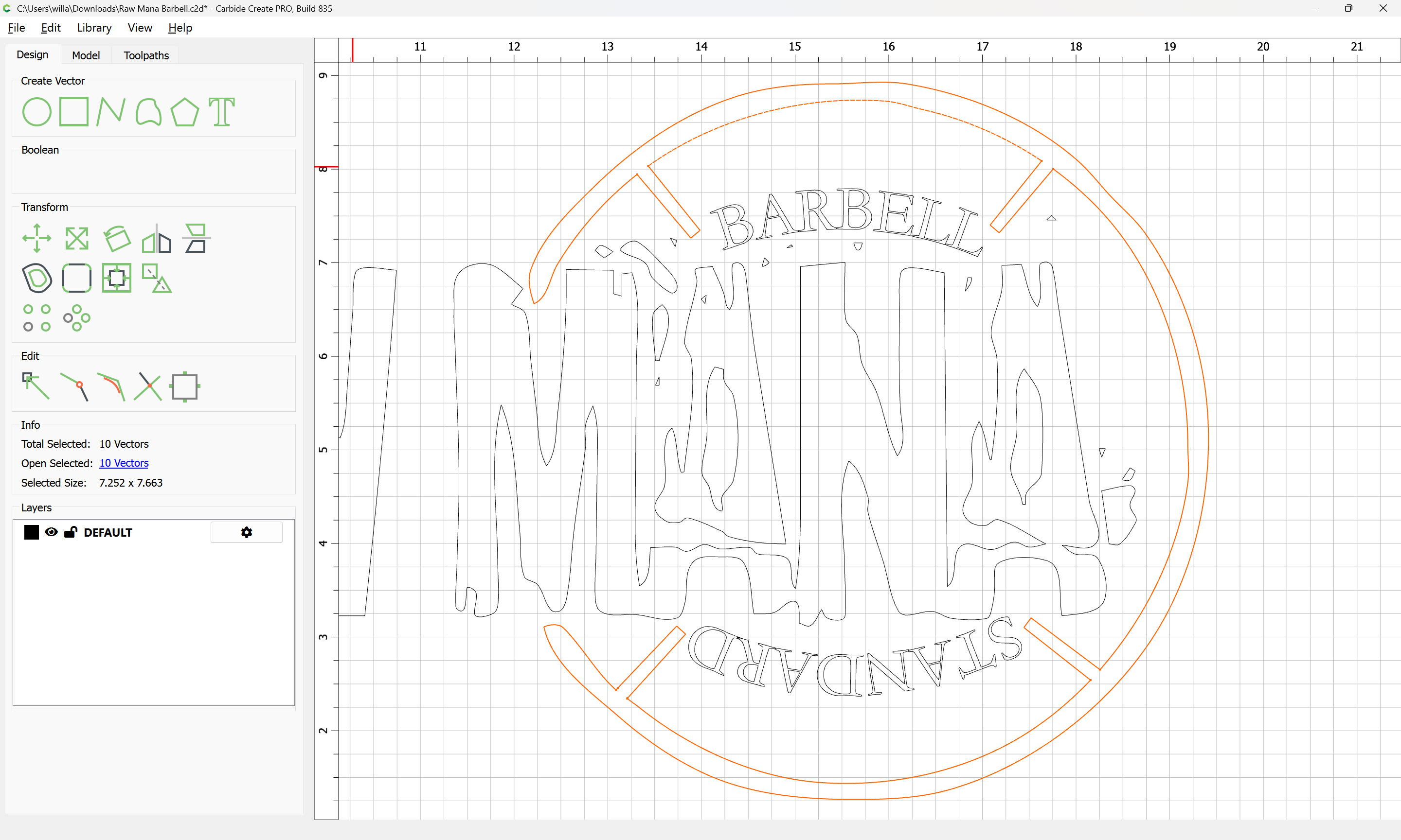

…place called Raw Mana. Their logo is below. I would like to leave the slots on the barbells but they seem to be carved out when I do the rest of the weight. Can you help me include the 4 slots on the inner weight?
The problem is that the “slots” on the weights are open/unclosed geometry, which may not be used with a V carving (or other toolpath, save for a Contour).

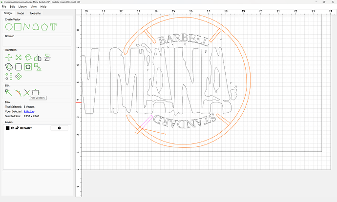

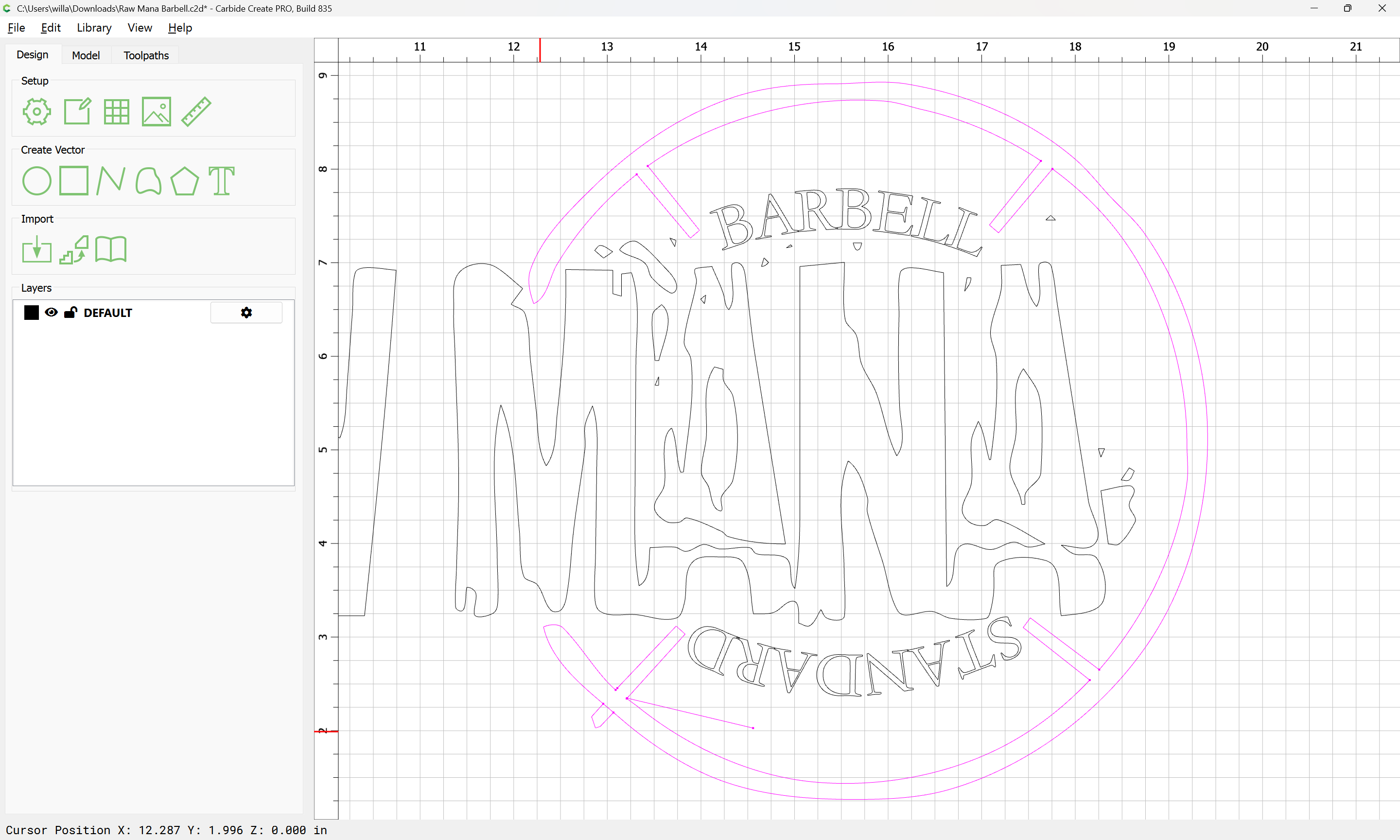

The open geometry:

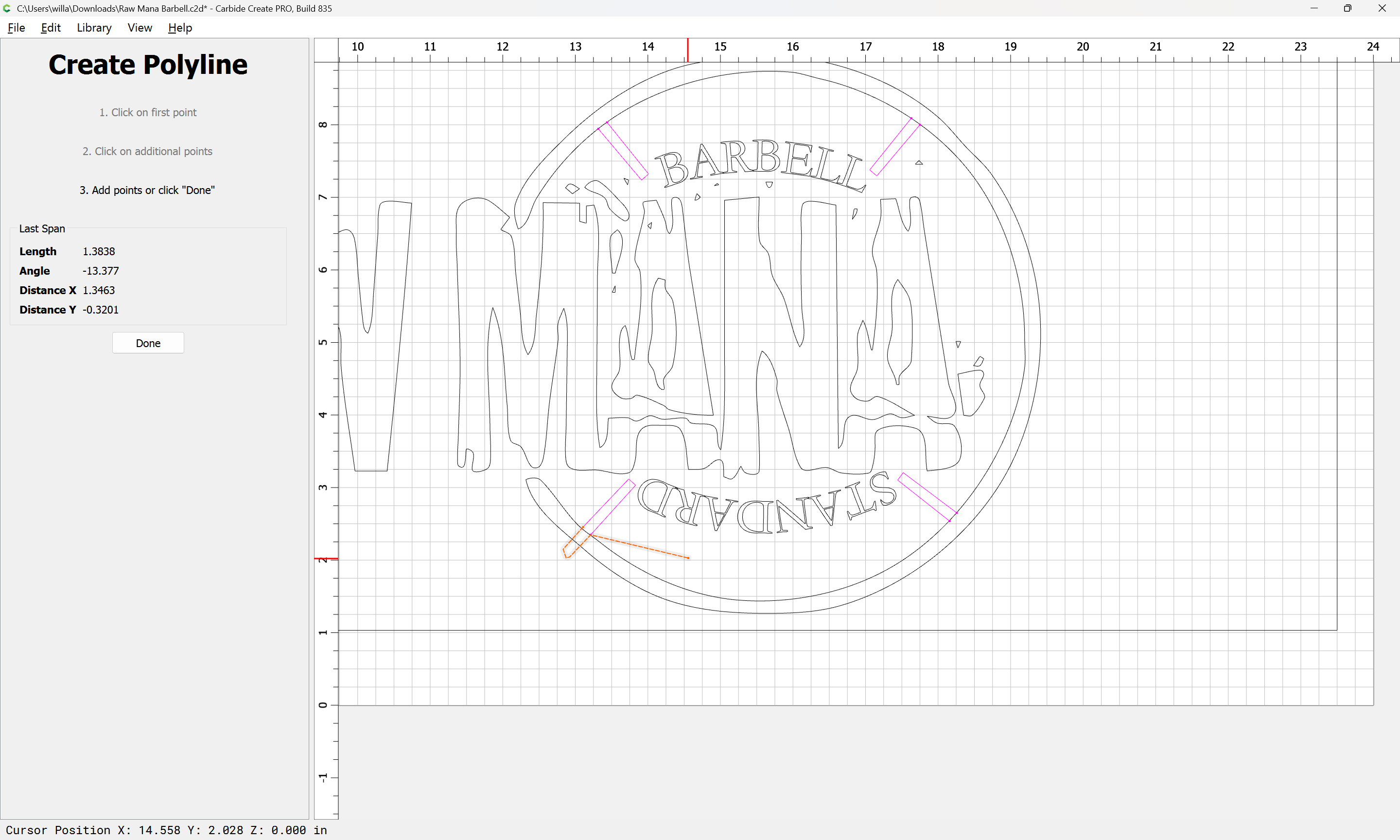

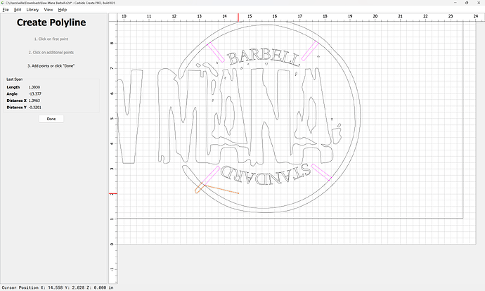

must be added to the surrounding closed geometry — this is easily done by drawing in some geometry to define the connections where necessary:
Done

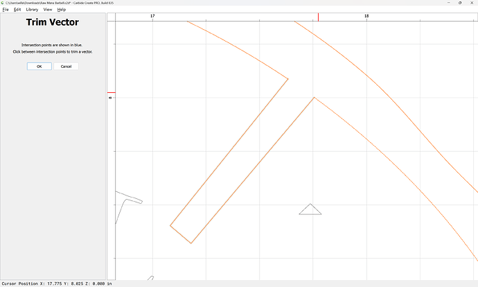

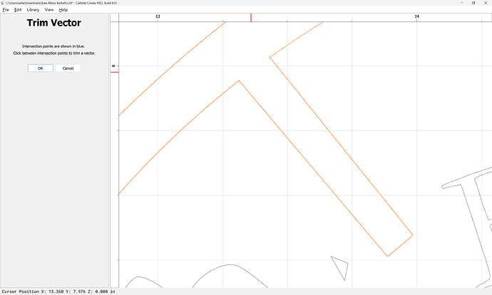

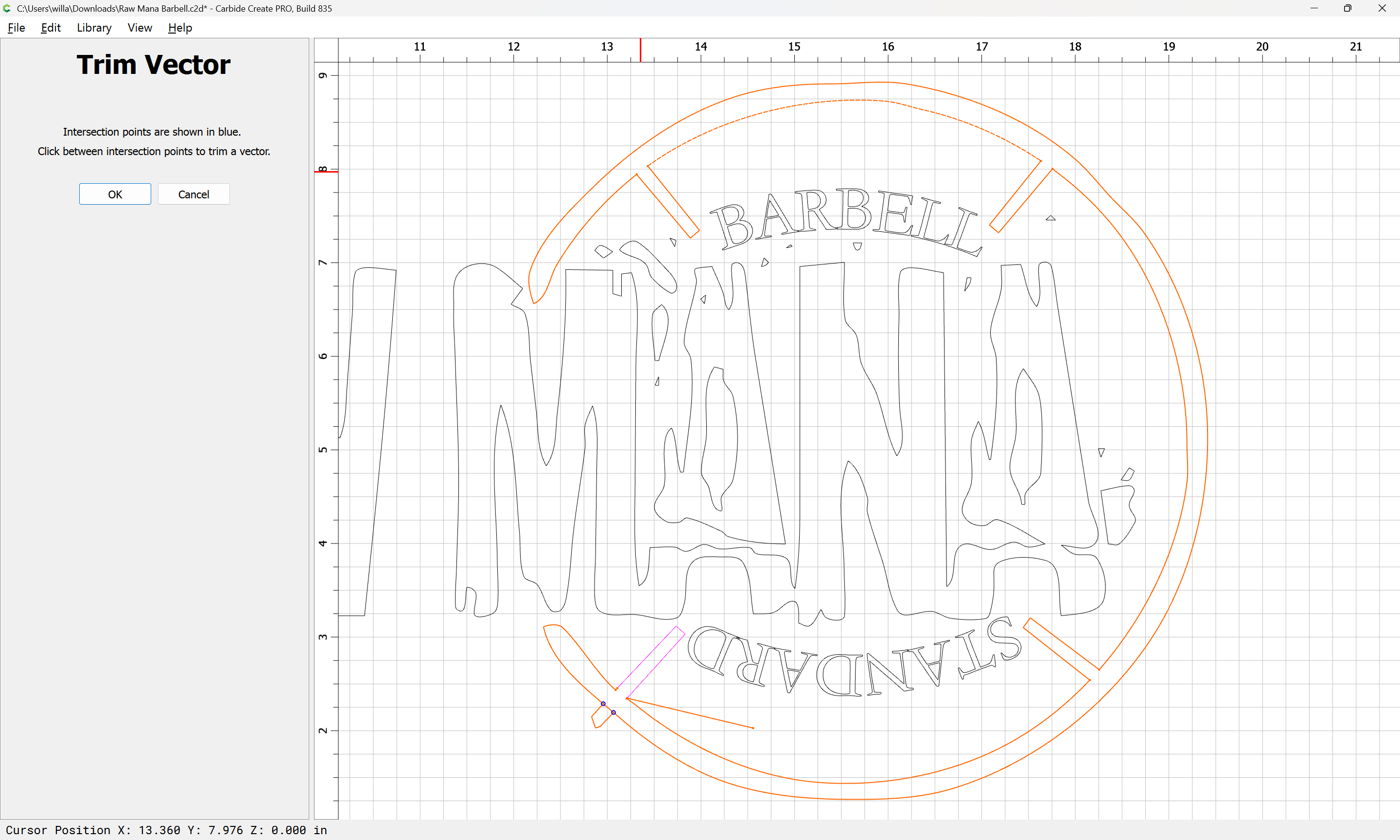

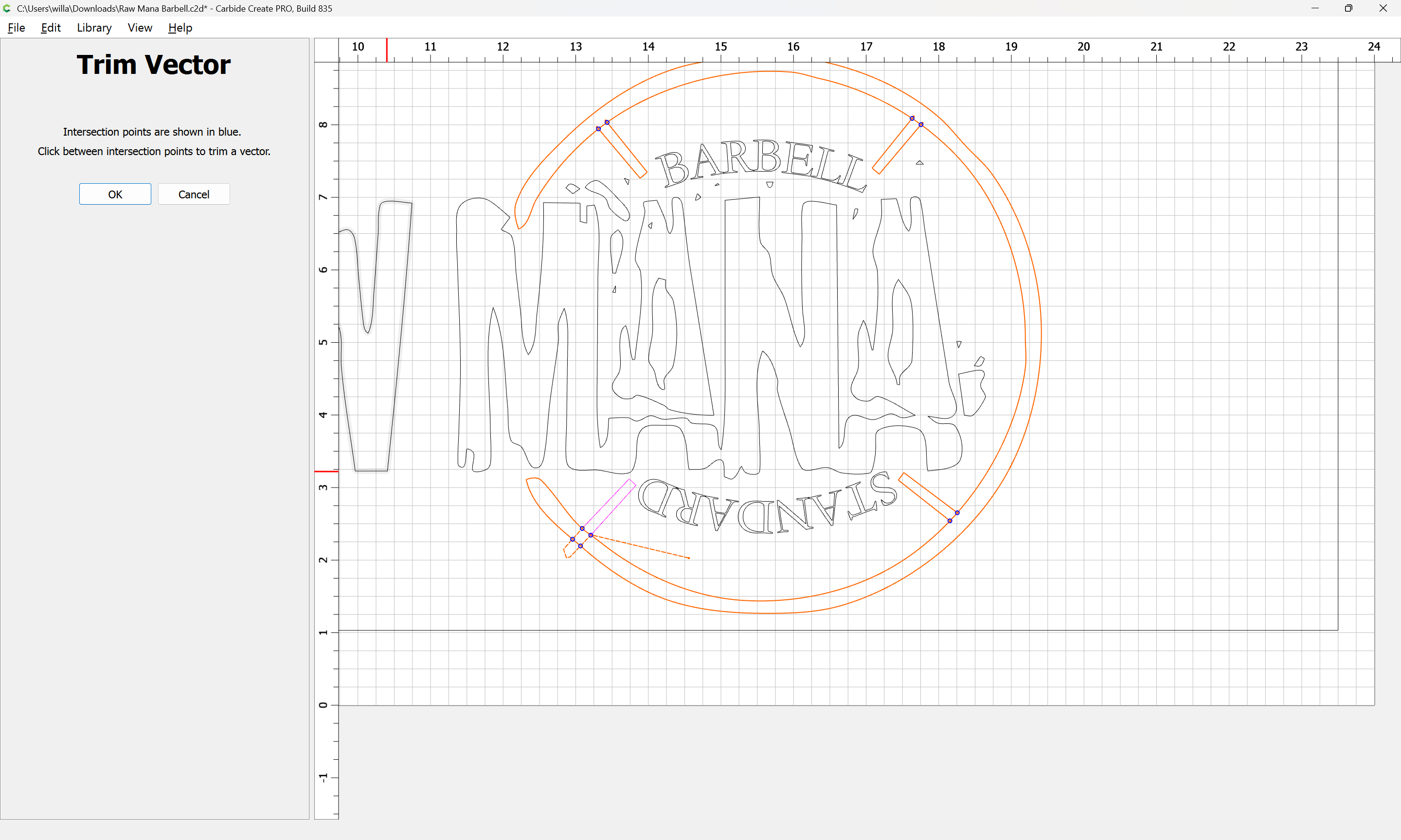

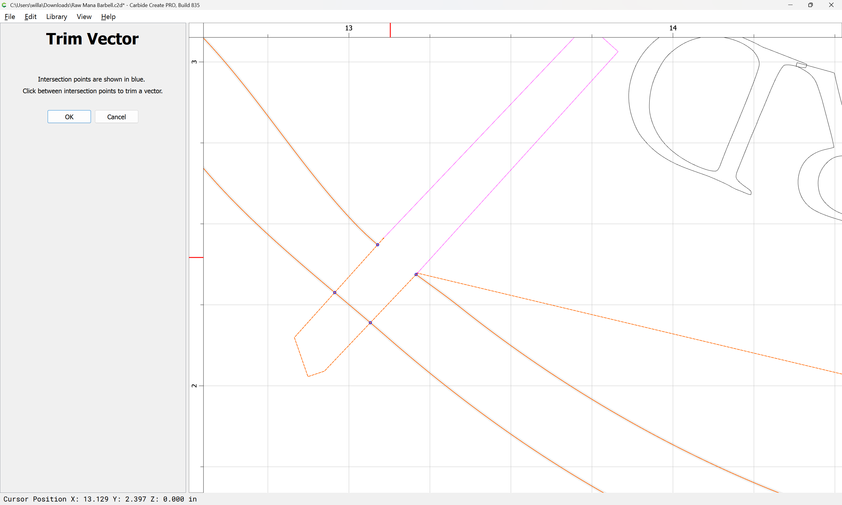

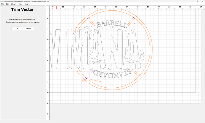

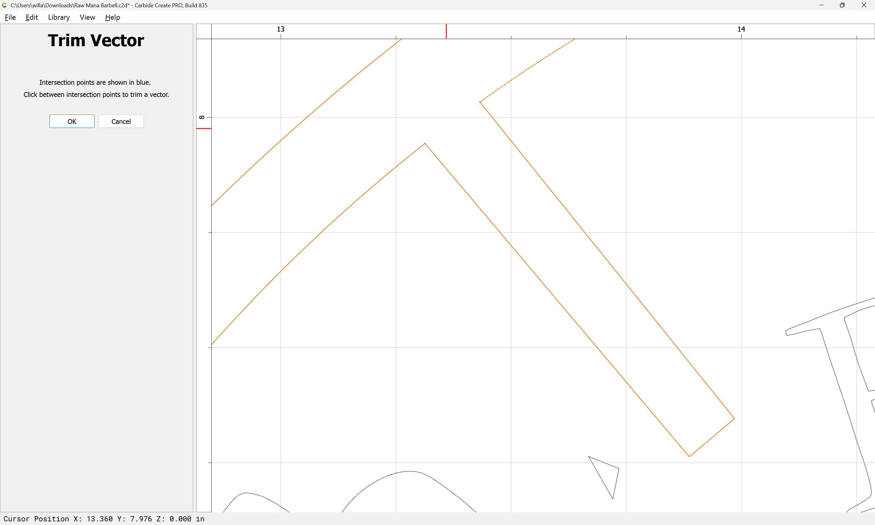

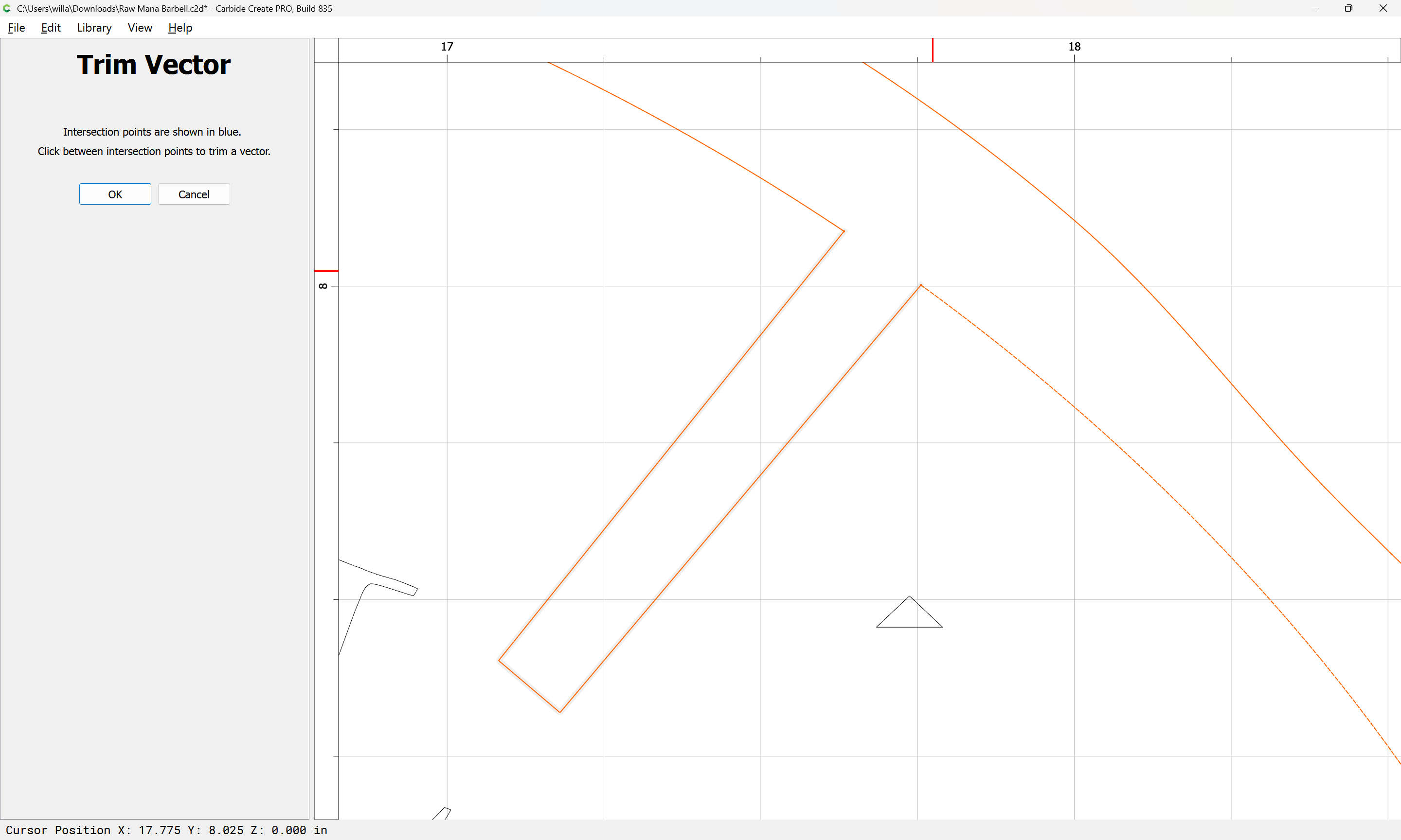

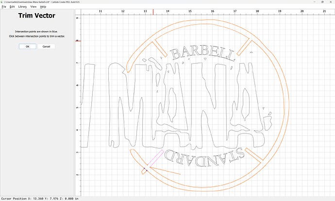

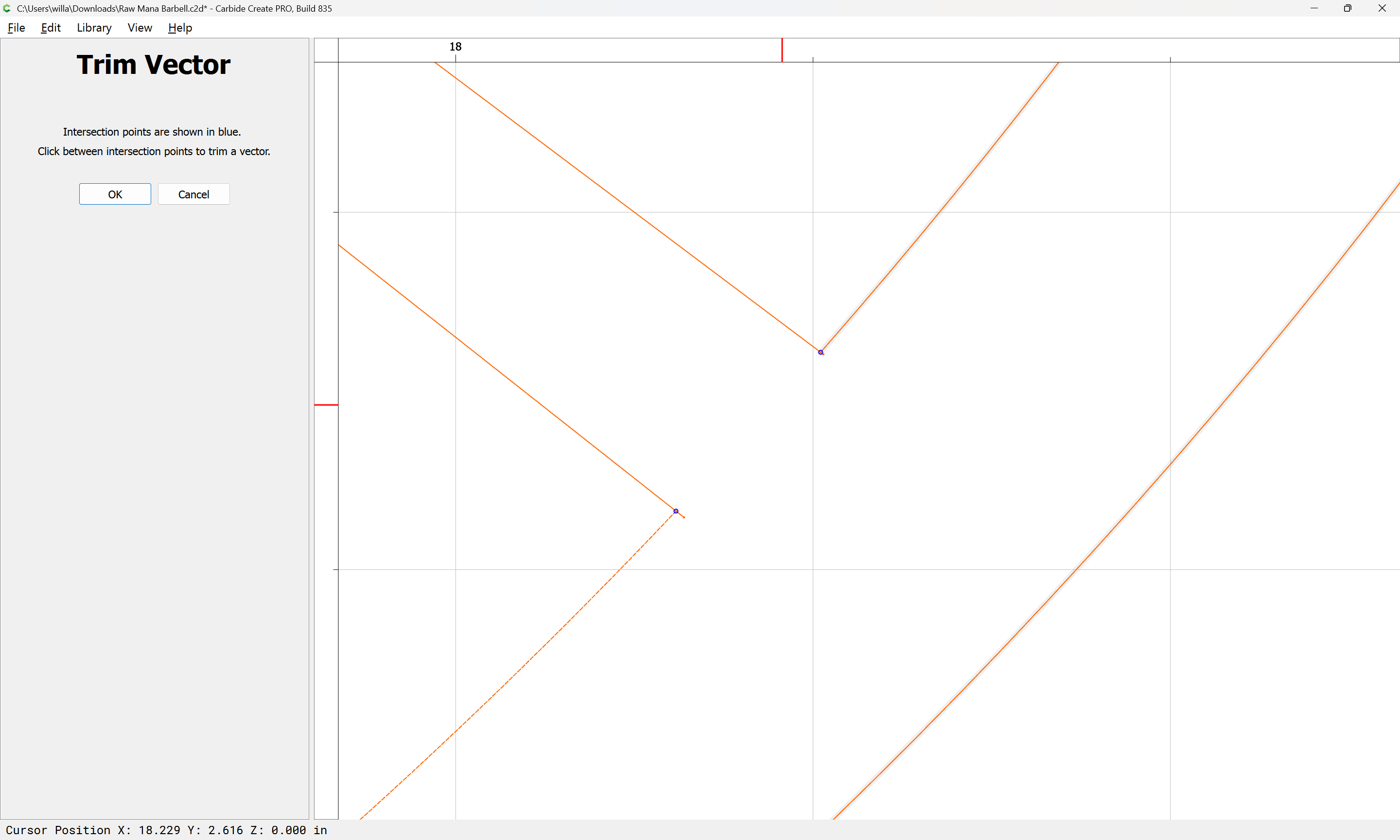

Trim Vectors:
and removing what is not wanted:

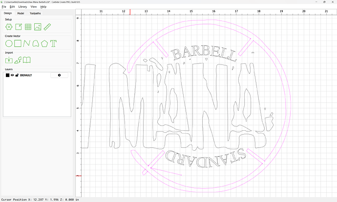

OK

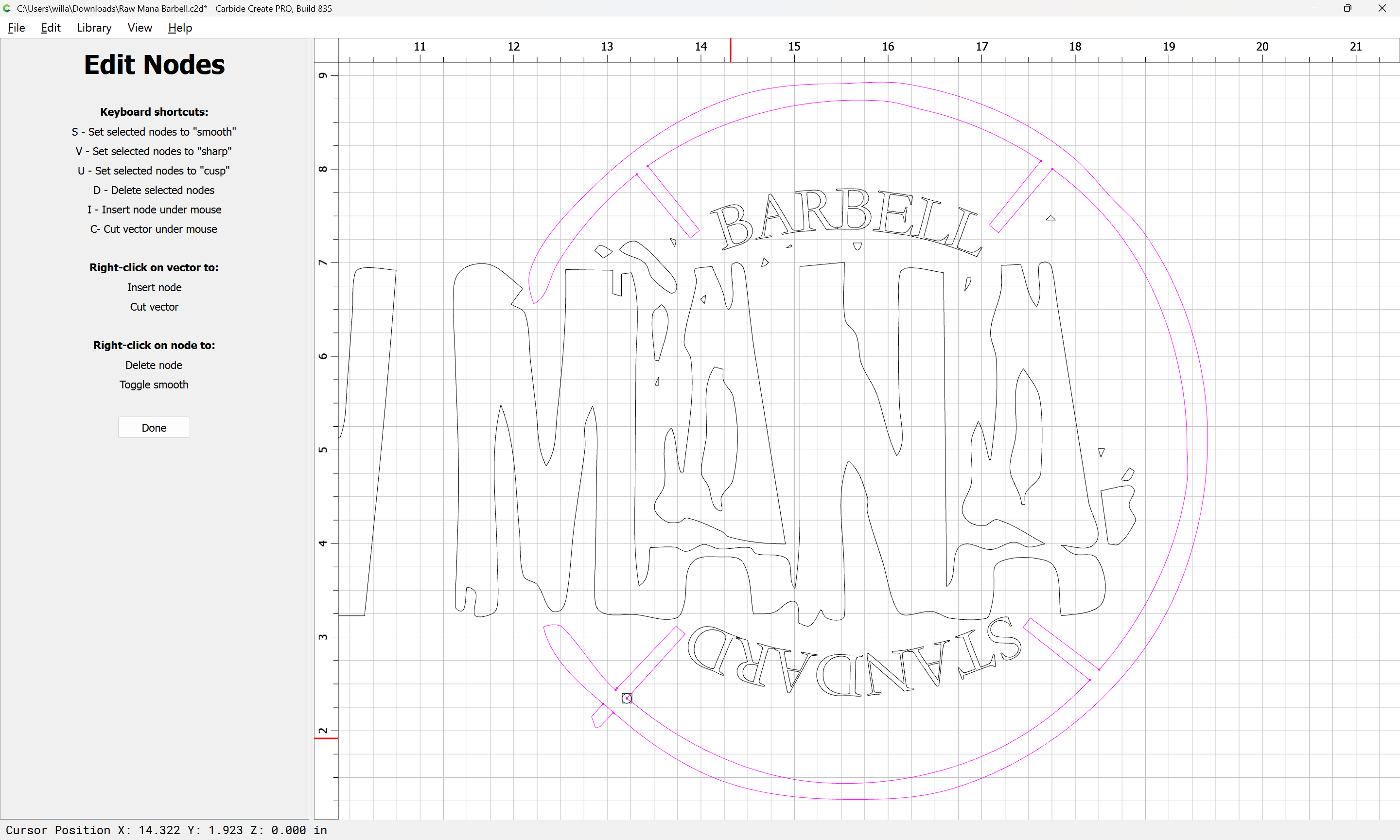

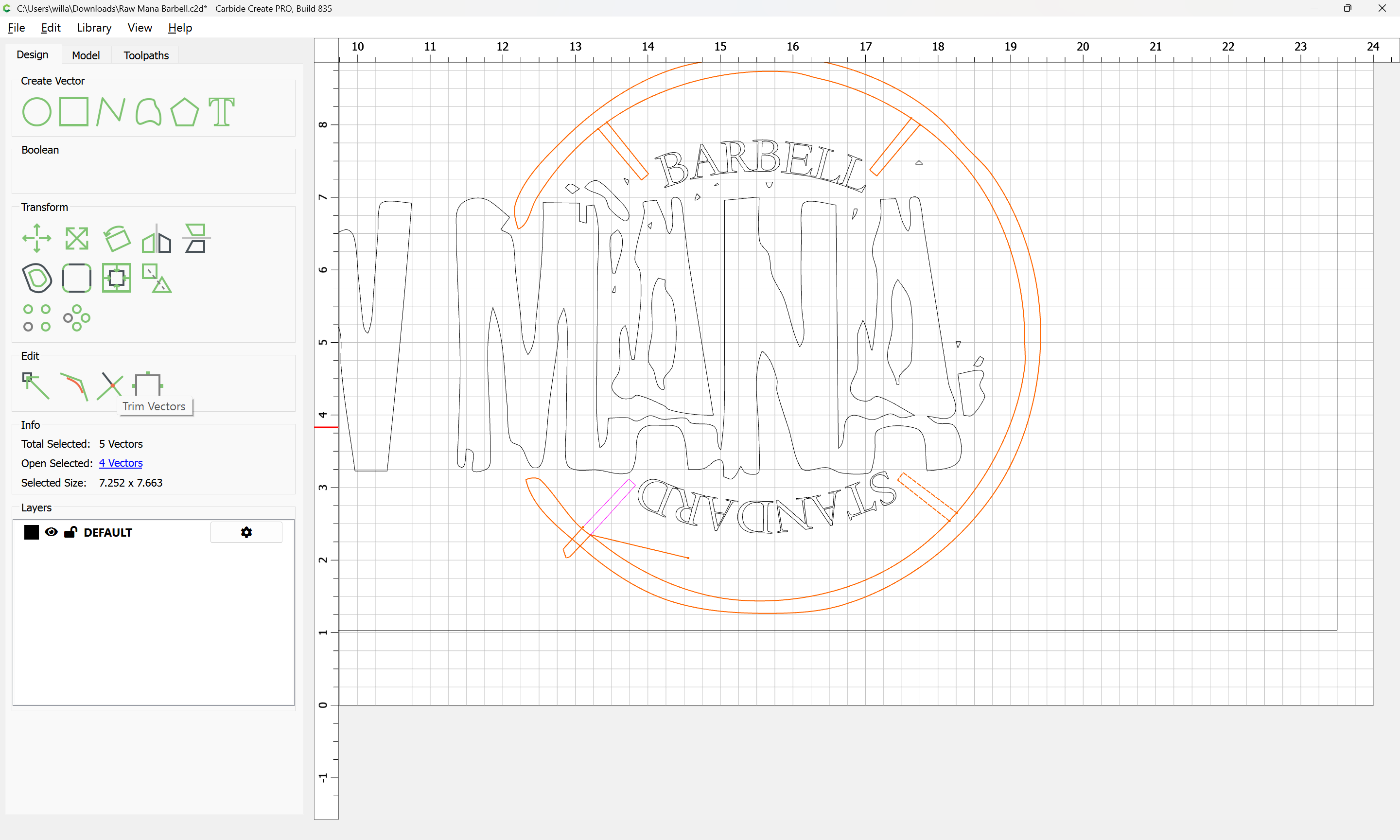

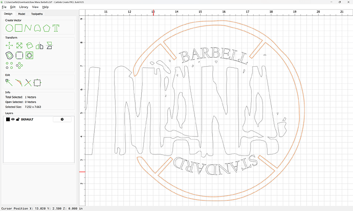

If need be, use Node Editing to adjust:

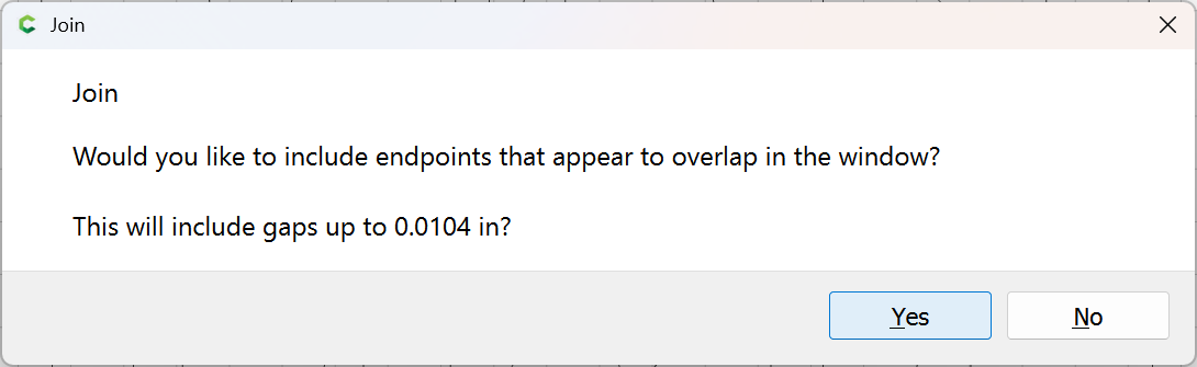

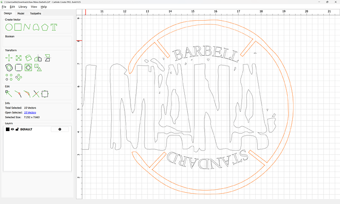

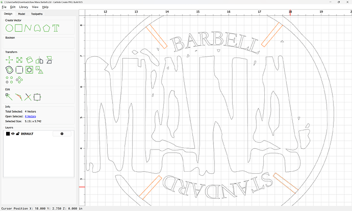

Select Open Vectors:
Join Vectors:
Yes
