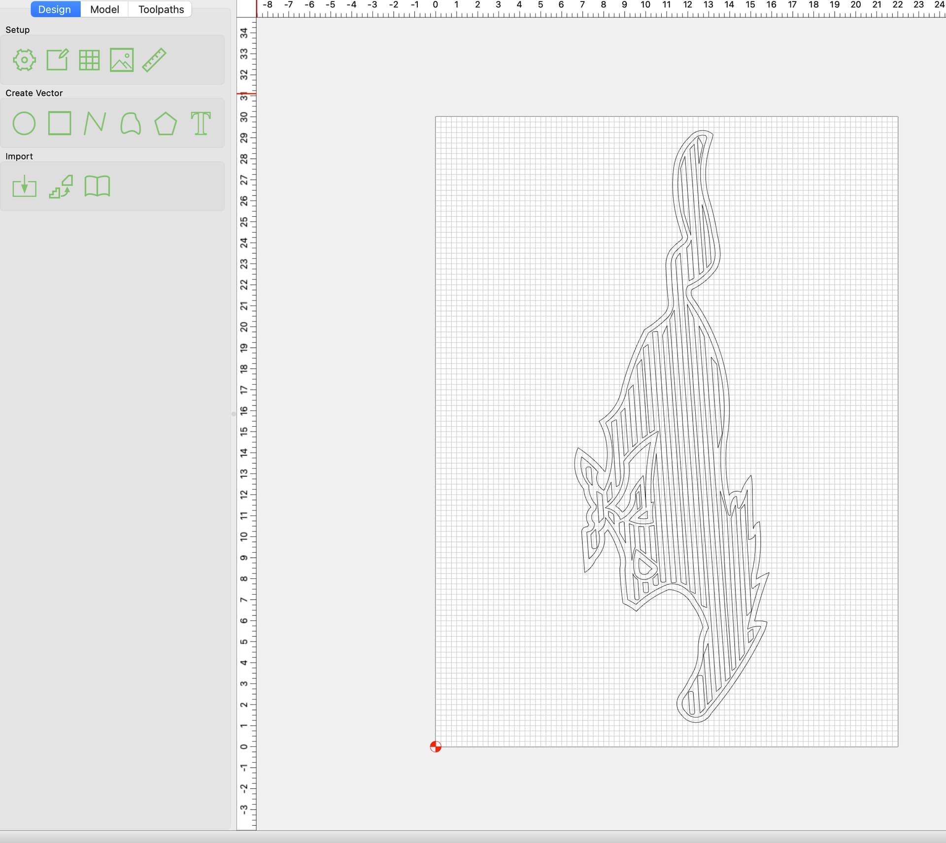

I designed a carve and then saved it. When I save it saves with Zero bytes. Open the file in BBEdit and it is empty. If I do a simple design like a circle it saves properly. Maybe a size issue?
Model 22 in X 30IN High Res SELECTED.
MacOS Sequoia 15.3.1, M1 MAX, 64GB
CCP Build 813

The file has tool paths.
Tried Save and Save As
Carvide Create Pro Build 813 2025-01-15 Downloaded 2 days ago from C3D

Post a screengrab showing the contents of a file which won’t save?
Saving to Local Download (Default) folder
Imported a DXF file created in Fusion 360
I have been playing with it. At this stage it saves. I have not done tool paths though.
Upload the DXF file here?
Try saving to the Desktop instead?
The original DXF had to have some repairs done in CCP.It is a bit of work to get it to a useable state.
I just did the Tool Path and Saved it using Save As. It is showing 922KB now. Closing CCP and double-clicking the file, CCP opens but does not display the model.
MACHEV6TP.c2d (900 KB)
This is the file without the tool path.
MACHEV61.c2d (256 KB)
I reduced the size of the job and it appears this is a size issue. I was doing a 22 X 36 and it saves but also creates a journal file. When you open it it does no load the image. I reduces to a 18 X 24 and everything works as I would expect. Is there a way to bring this to the attention of the devs?
