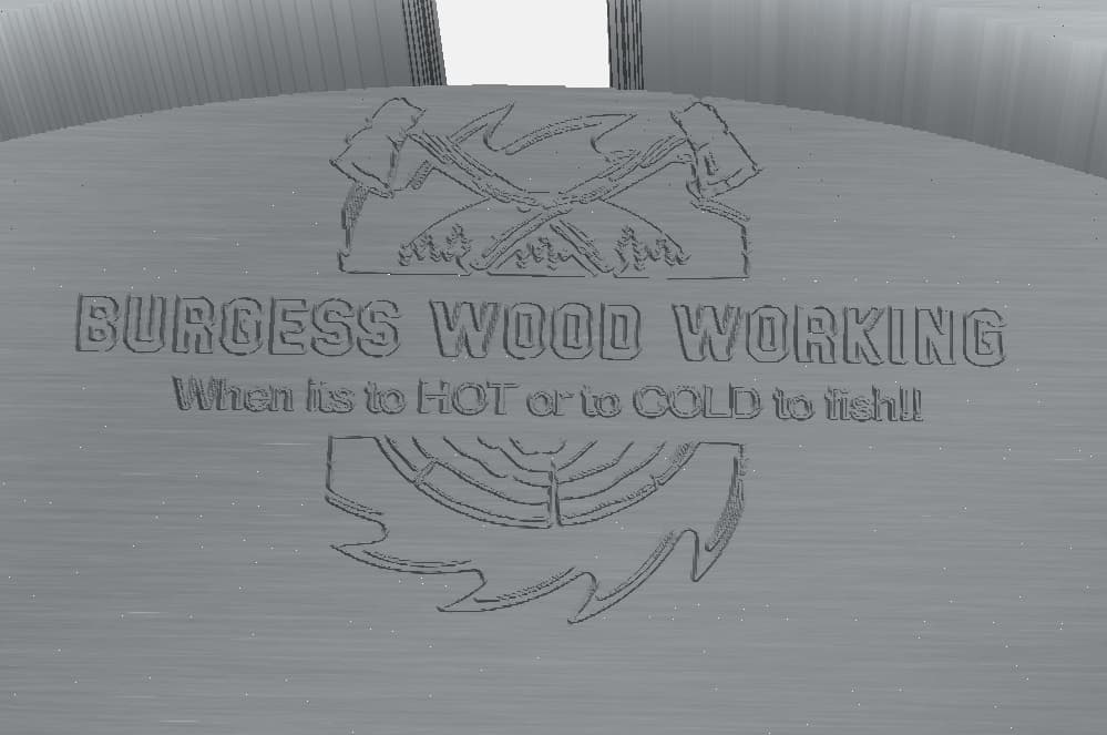

I am getting an empty tool path when adding my logo to this board. What is the problem

I used an Advanced V-Carve for this logo.
.33 Start and .38 for max depth
This one I used a 60 degree Vbit and did a Contour Cut No offset
Corner Cutting board with logo sdguy toolpaths.c2d (892 KB)
What depth did you cut it at?
Contour Starts at .33 and finishes at .35
Adv VCarve starts at .33 and ends at .38

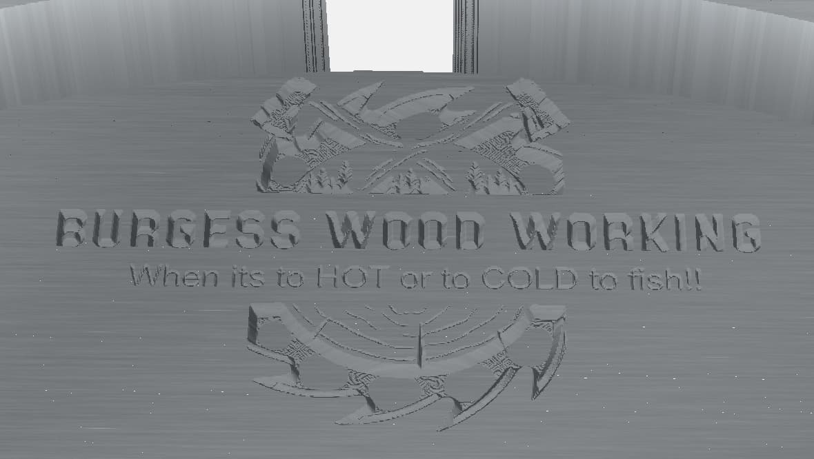

first i grouped your logo and the blade vector.
Then put an offset vector around each one. (.0625)
took out all added vectors just left the outline.
then selected the logo, text and the blade
for an advanced v carve.
maybe this is look you want.
jim
corner cutting board with logo sdguy toolpaths 2.0.c2d (1.1 MB)
