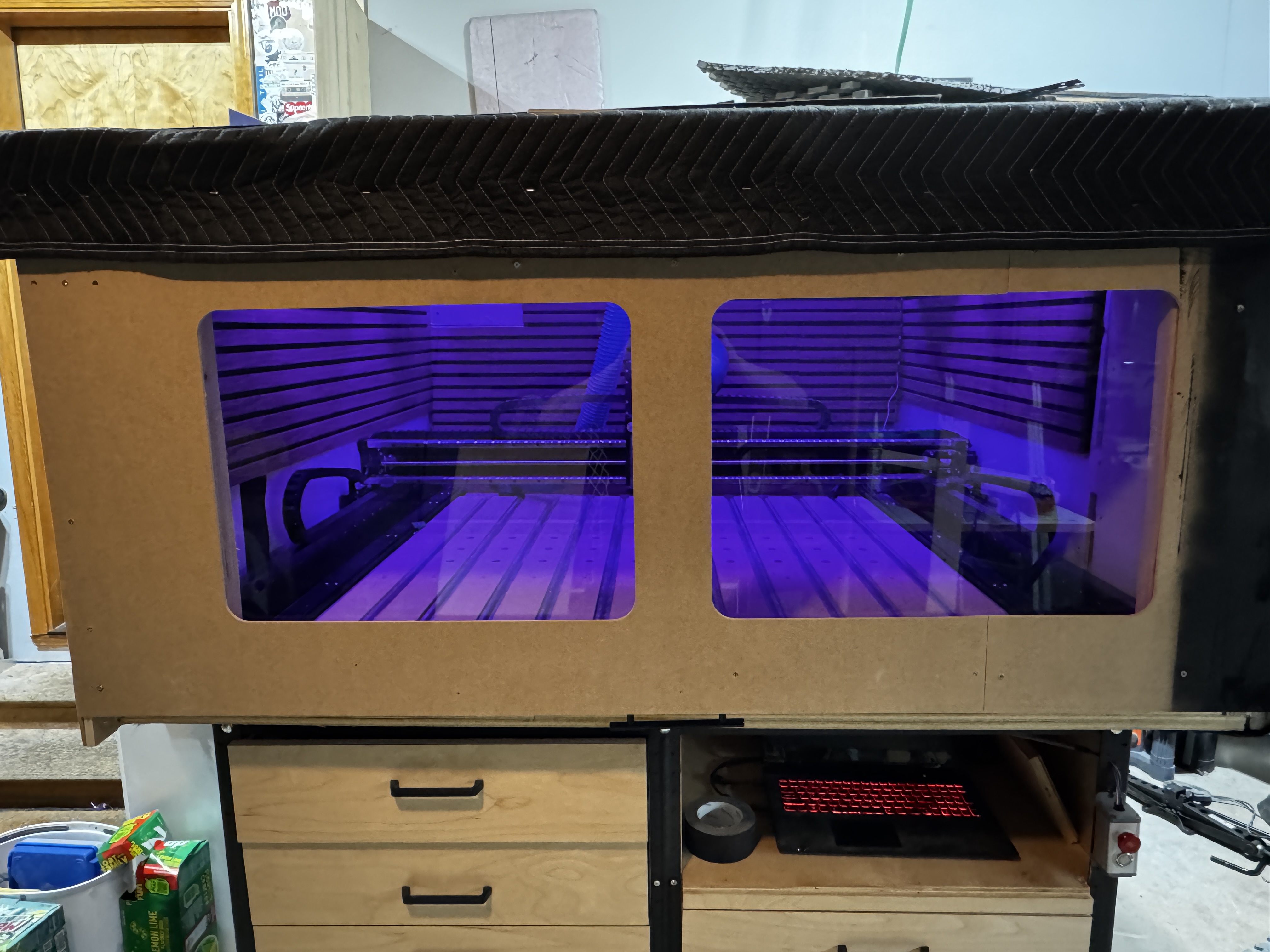

Was getting real tired of dust everywhere and the noise, so I decided to build a CNC enclosure as a side project to keep myself busy.
Most of the lumber was free, reclaimed 2x4s from a project my dad had just torn down. The sheetrock was also free from a remodel he finished recently. I was also able to use up a huge chunk of scrap wood that was filling up various corners of my garage. Project was relatively budget friendly, but wood is still pricey here when I needed to buy things.
I went through a few redesigns early on once I realized that a 16” deep door, lined with sheetrock on the inside and ¾” MDF on the outside, was… optimistic :sweat_smile:. Learned a lot along the way and adjusted as I went.
Key features:
  • Frame is 2x4s turned sideways
  • Exterior skinned in ¾” MDF
  • Interior skinned in ½” sheetrock
  • Wall cavities stuffed with cut-up workout mats I wasn’t using anymore
  • Outside wrapped with moving blankets for extra noise control
  • Lift assist on the main door — even my kid can lift it one-handed
  • Back wall has a flip-up door for rear access and tiling longer pieces
  • Table was already on heavy-duty machine casters, so the whole thing can be rolled around pretty easily still
Still not “studio quiet,” but it made a huge difference in both noise and dust, and I’m pretty happy with how it turned out.
I’m still stuck on the dust collection hose and how to stop that from getting tangled up. If anyone has suggestions I’d love to hear them.

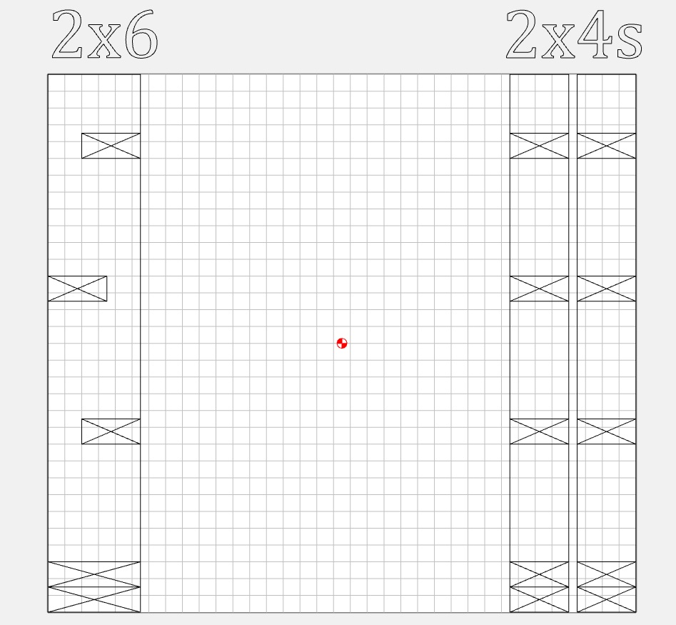

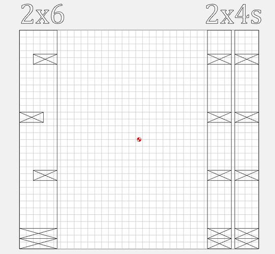

Here’s the two ways to soundproof a wall, per my radio buddy.
2x6 walls with offset 2x4 studs. Then you run insulation weaving between the whole length. It’s cheaper and 90% effective.
2x4 double walls. You still need to insulate between 2x4 studs on both walls but you leave an airgap so they never transfer sound. Costs more, more work, 100% effective. Sounds like a solution that’s too effective for our problem.
The 2x4 double wall design is actually the best design for sure. The work around for the surround be still cost effective because you wouldn’t be using so many 2x4s as you would think when turning them sideways. Of course this design you have modeled would mean the wall would be at least 7.5 inches or more wide. The way I am saying to turn them, as per the statement from earlier about them being turned, would make the wall around 3.5 to 4 inches deep.
The 2x4s could be ripped long ways into 1.5 inch by 1.5 inch strips and the 2x4 studs be turned and put on top of them. This would make a 1.5 inch thick wall then add about 1/2 inch gap, then add a second wall the same thickness. This would reduce the full wall to 3.5 inches and the soundproofing should work really well.
If you are restricted in the thickness of your walls, then there are work arounds that could be done, but the result that one is trying to perform is to make a barrier for soundproofing material to be installed between the two compartments.
