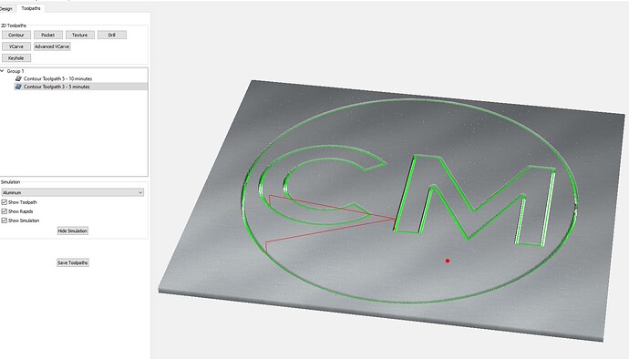

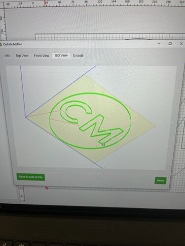

I have my stock set correctly, zero set at lower left. But it travels away from zero and starts cutting in the wrong spot. Third project I had to abort, have yet to complete a single cut.

Can you post your file please.
Anthony
Is this still clamped up?
Use the Rapid Position command to move to current Z+6 (assuming Z origin is at the surface), then move to current XY — where is it? Does that match where the origin was set?
How did you set the origin?

Yes sir I did all of the above. Rapid position to the lower left, clear offsets , zero all. Twice!
There are no tool paths off the grid.

You seem to have the origin set at the center of the file.
Thanks Will
Can you elaborate? The red target is at the lower left and my endmill was also zero at the lower left.
The unintentional red dot on the previous photo was from red on my pen in photoshop. I was drawing lines on another file.
Check where origin is set in Job Setup.
Just dbl checked and origin is correct.
Thought that’s what you mean but making sure I didn’t miss something. Still checking, not ruling out a mistake on my part, so so much for saying I’m software savvy. :grinning:
bottom left corner is the red target in the project file
I tried it in the center and it goes ever further off the stock so I have to hit stop.
I also went back and made sure the file (object) itself was at zero but that’s my default workflow when designing in 2D and 3D.
Does the size of the stock in your program match the sizing of your actual stock?

So it seems after all this it was user error. I was starting at the lower left of my stock, but it had a radius corner for one thing.
I just didn’t get far enough down onto the left because I was avoiding that little screw holding the stock in.
Fleming to the rescue, called me up and instructed the best method is to start with your center point. I did just that, and it worked perfectly.
