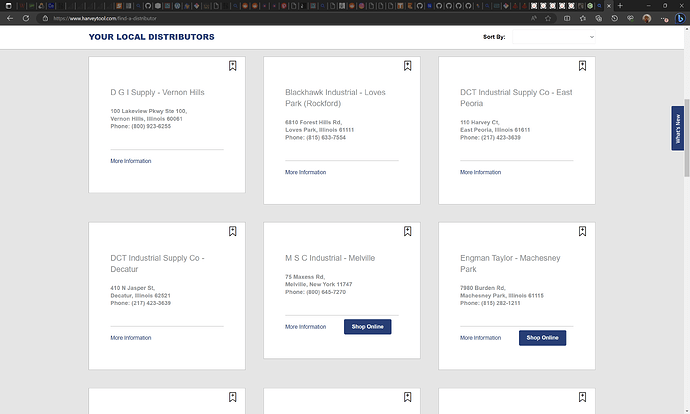

When I was just starting out, I used Harvey’s “Find a distributor” page to find a local shop which was willing to allow me to drop by and give them a check for some endmills, which I then picked up after their next shipment came in.

Is there anything in the Chicago area that anyone would recommend for endmills?

Go to:
click on “Illinois” in the map:
there are more further down.
Whether or no these folks will be willing to do business w/ an individual would have to be determined by checking in w/ them.
