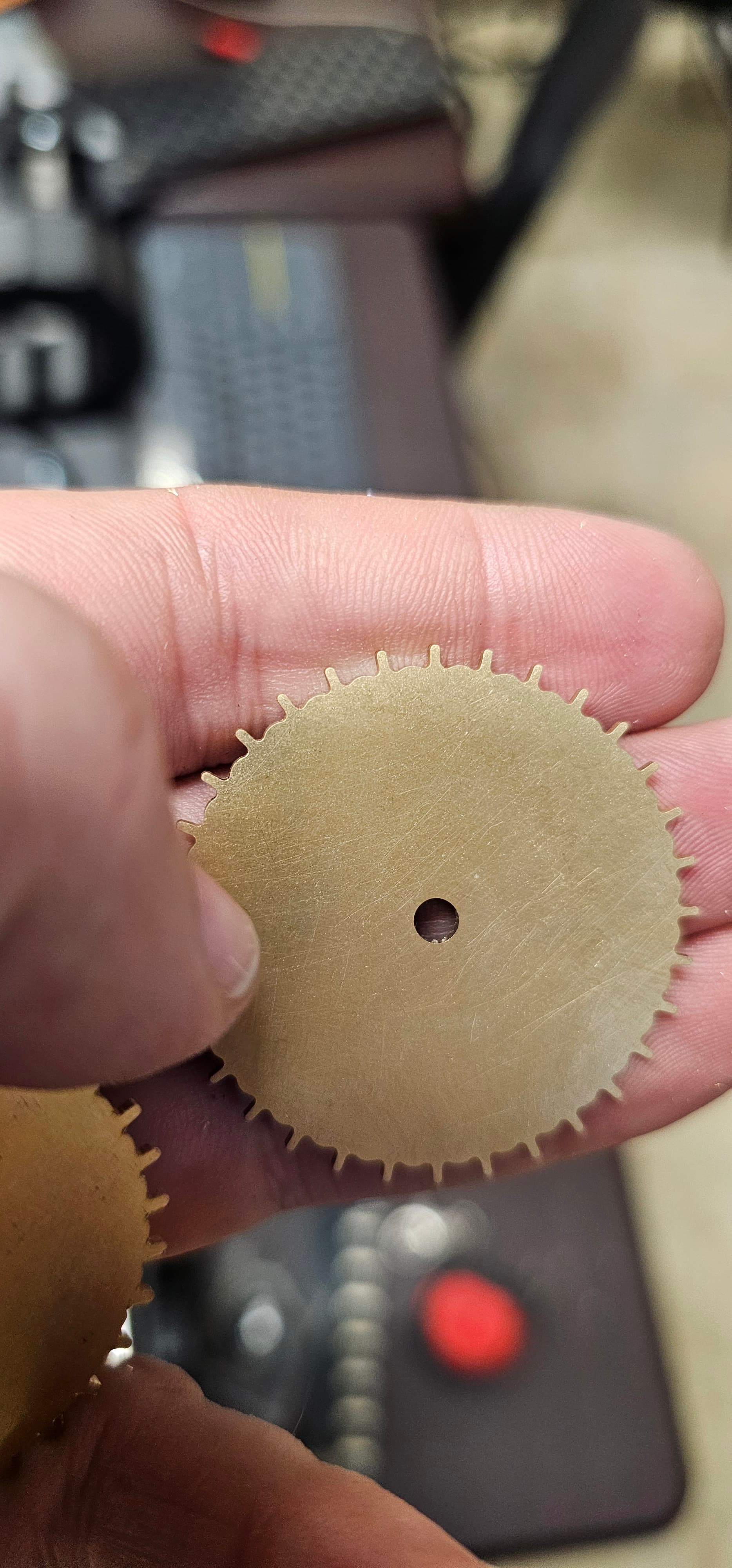

I grabbed a brand new 1/32 from the pack and gave it a try with 818mm/m. Here is the result:

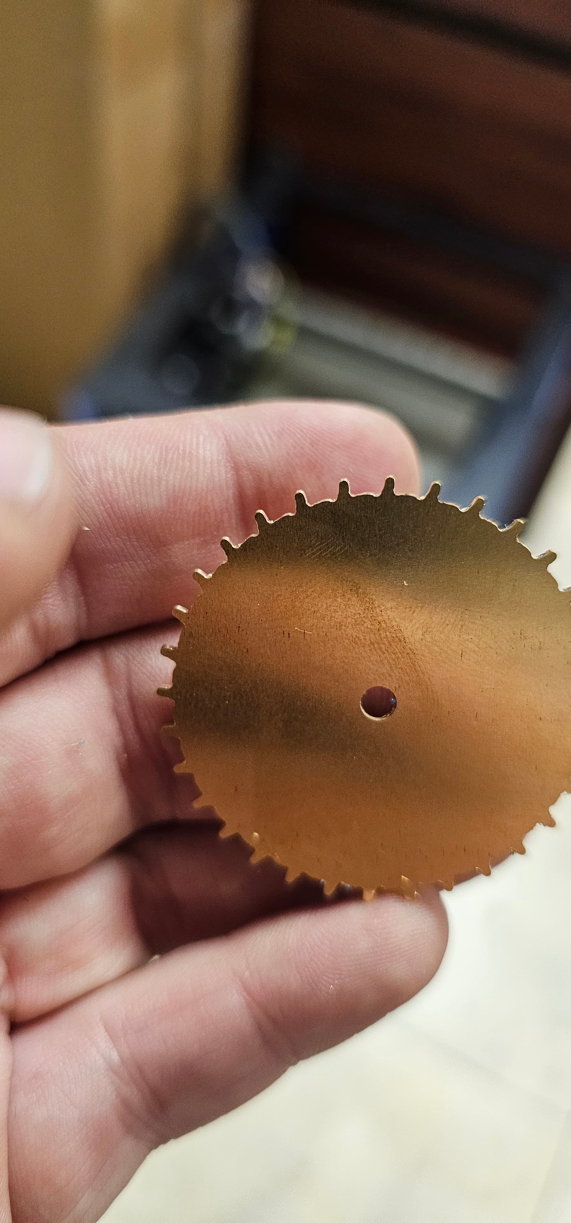

And for reference here is what it is supposed to look like but with better tolerances:
all the teeth geometry is rotated somehow. I will say that there is no burr which is better than what I was getting.

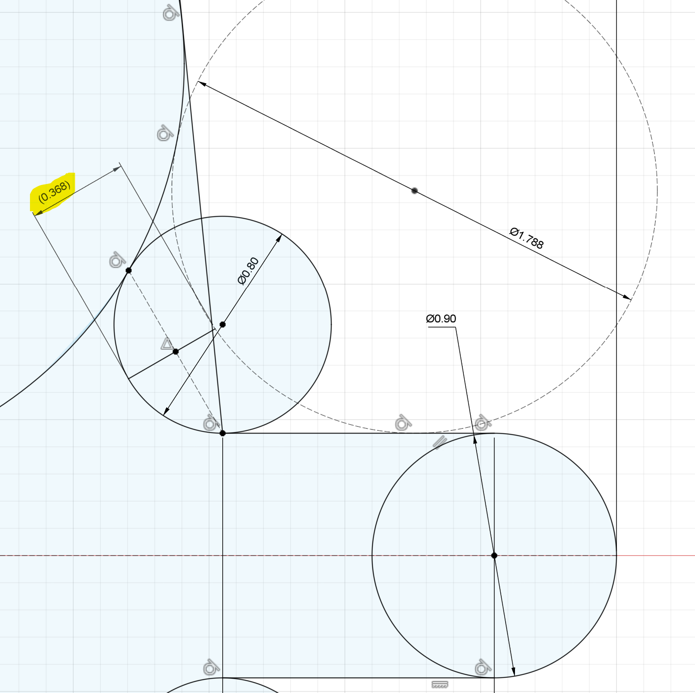

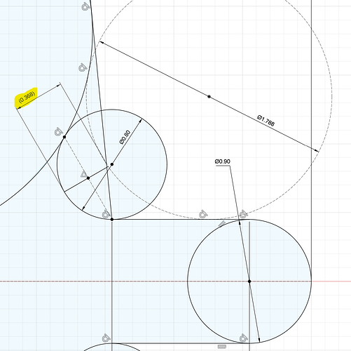

I did the math and I think I figured out the bigger issue.
The previous toolpath is a 1/16th endmill doing a contour pass with 0.1mm stock to leave. The inside corner radius of those teeth is 0.8mm. Assuming I understand how Fusion is calculating STL in this instance the 1/16th endmill is being effectively treated as a 1.788mm ( (1/16 * 25.4) + 0.2) endmill. That means that there is around 0.368mm of material still in the corner for the 1/32nd endmill to chew through.
I am trying to figure out a good set of toolpaths to deal with that.

I added several 1/32 contours each with progressively smaller stock to leave (0.3, 0.2, 0.1, then 0) and the part came out with less of the “twist” to it but it is still there. When removing it I did notice something. The painters tape has a slight elasticity to it. So when forces are low like when I had the feedrate at 150mm and 32KRPM it did not move much. Now that I am up at 818mm the part is twisting. I am going to see if I can add some tabs to keep it attached to the parent stock till the very last operation.
