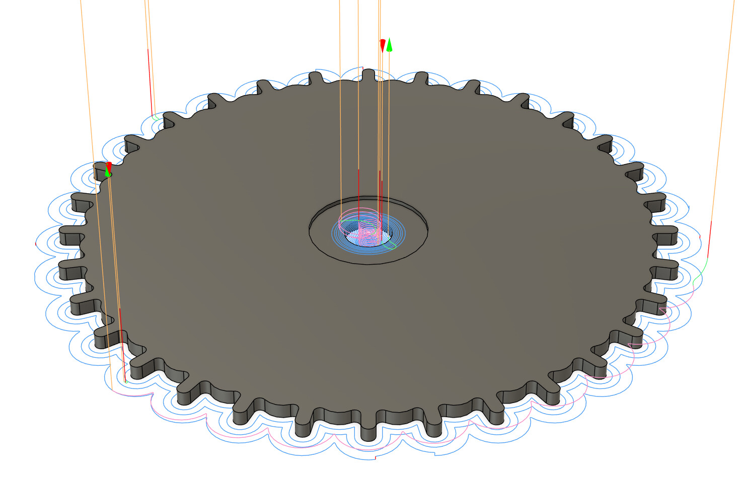

I have been making brass indexing wheels for a Pick-N-Place system on my S5 Pro. My initial wheels had near perfect dimensions. I have to make 100 of these so went into production. After making the first 45 of them I decided to check my measurements. The cogs on the indexing wheel are supposed to be 0.9mm wide. They are coming out 0.7mm wide?!! The only thing I can think of that would cause this is that the endmill I am using for the last operation is too wide, but I was wondering if there is anything else I should check.

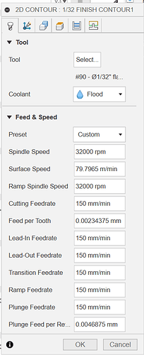

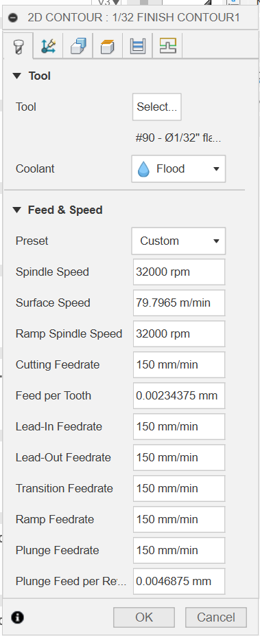

Using Fusion360
Tool is a SpeTool 1/32nd endmill 3 flute endmill doing a 2D contour. Previous op is using a 1/16th endmill with 0.1mm stock to leave.
Maybe tool engagement being at 50% is not giving it enough time to remove the material in the corners? Also effecting the leadout? would be super hard to identify without making a mating shape to between those teeth and seeing if one side or the other fails to match up rather than both.

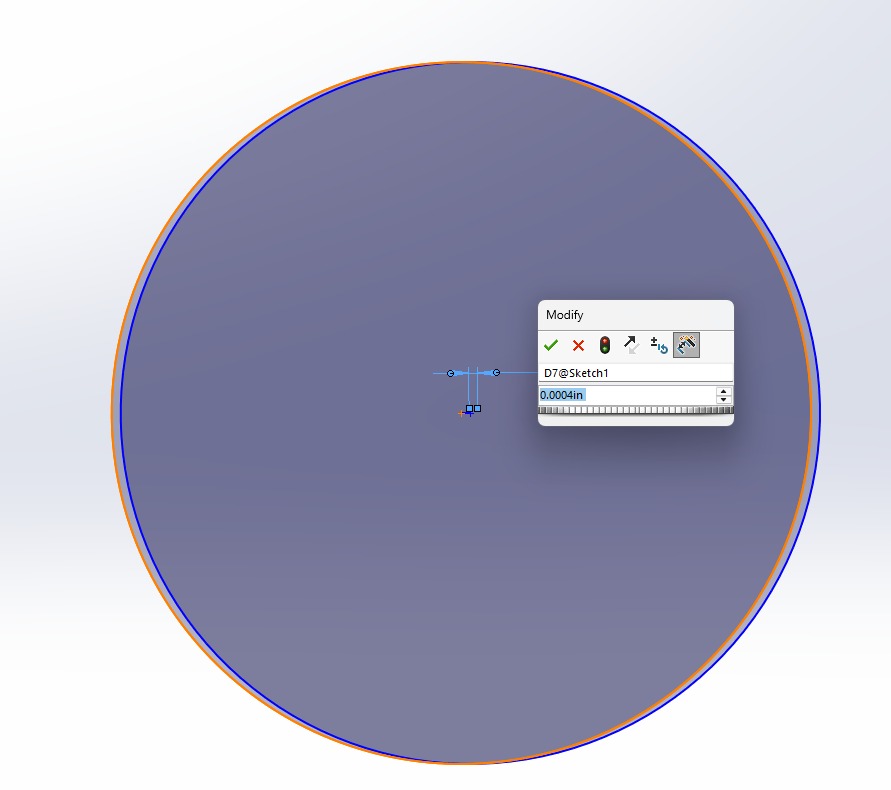

I’d guess based on this spindle runout but it would be about 4 tenths out at 1" stickout which will be ridiculously hard to measure accurately and fix. I think I’ve got 5 tenths or so on mine. I’d also expect you to be breaking more endmills though, albeit carbide is strong as hell even with that amount of runout.
This should visualize how it’s just minor enough to not snap that endmill but your holes should be about 0.01602475" instead of .015625"
THAT SAID instead of fixing the runout if you are already having success with this endmill why not up it’s size to .01602475" in fusion and run the part again if you have the stock. If it comes up correctly we know the problem.

Assuming I understand this correctly you are taking a full depth cut of unknown depth with a more or less 0.1mm stepover at 32,000 RPM at 150mm/m… If that’s all correct you are burning the tool alive. That is definitely rubbing and you are almost certainly building up a edge even at that RPM. Then add dulling the tool on top of it and you are greatly increasing the force and therefore deflection with very little linear inches. Depending on the geometry, length of cut, and stickout of the tool you could EASILY get it to deflect enough to eat 0.2mm. That being said, if you are climb finishing than you would be deflecting away from your finished part and therefore it should get bigger. If you are conventional finishing than this could be your problem. Although there are some weird changes in this based on the stepover.

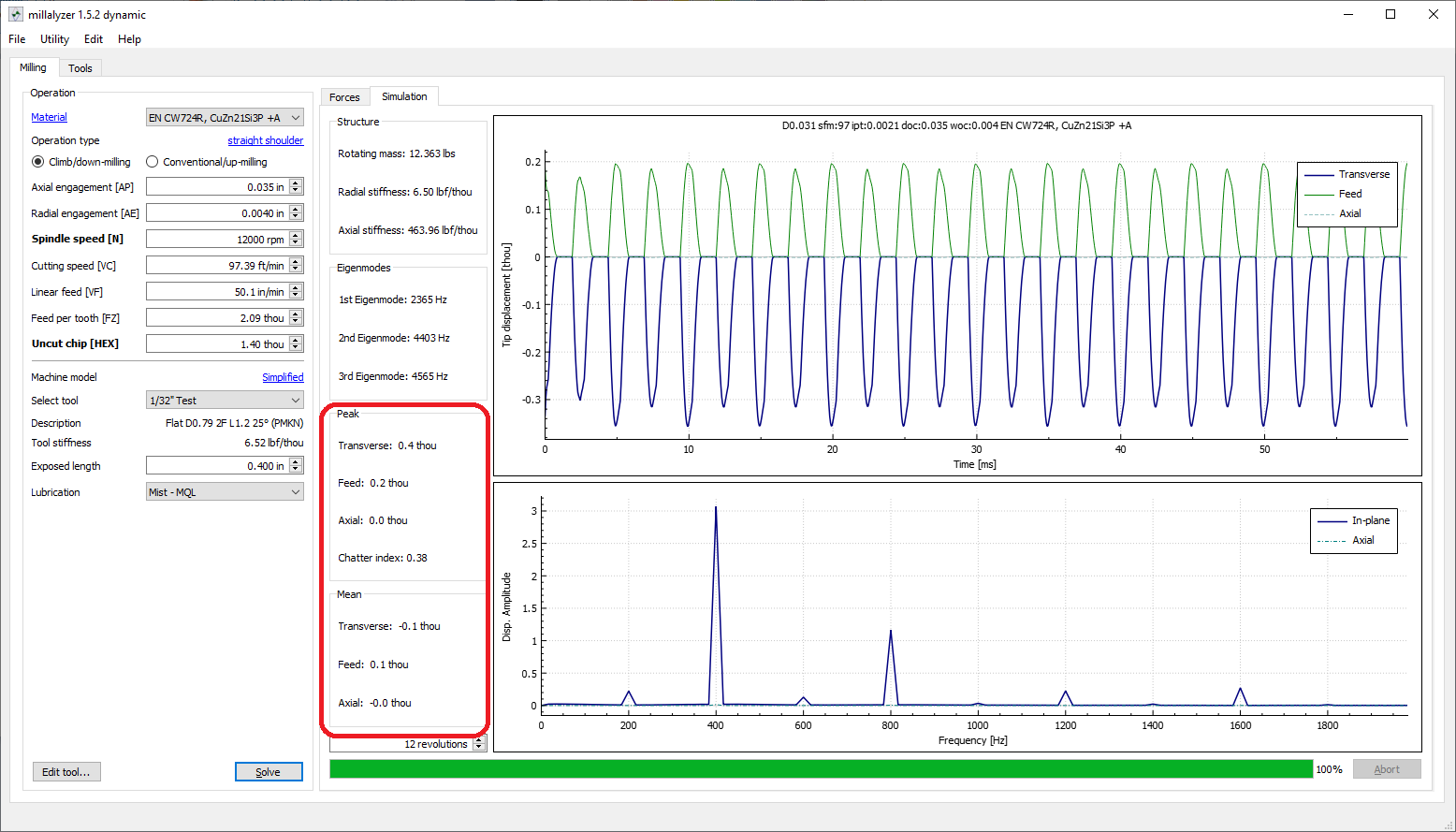

So a bit of background. In most cases with a tool designed for non-ferrous metals in this size you can get down to around a 0.0003" (0076mm) chipload and not be rubbing. They will like higher numbers but that’s our floor. This is exacerbated in this case by the steel cutter design and runout. In order to actual cut and not grind away material we have to have a chip that’s at least bigger than the chip we are making. A steel cutter typically has a bigger edge radius to strengthen the edge. Runout gets added and subtracted from different flutes at different rotational positions, more so with a helix (flute twist). So we have to assume that we are going to both take a chip plus the runout and a chip minus the runout in each cut.
This is not meant as derogatory to the Makita or Makita clones. But one of the areas they are not great in is runout. There’s too steep of an angle with too little engagement length of the collet for consistent low runout. At a minimum I have to assume 0.0005" (0.013mm) runout regardless of collets. With customers we have tested with it’s a bit variable but it’s usually over double that.
So let’s assume that you have a really good router and collet with only 0.0005" (0.013mm) of runout. We’ll also assume an aggressive steel tool that we only have to hit a 0.0004" (0.010mm) chipload with. That would make our feed based on a 0.0009" (0.022mm) chipload and give us a big chip of 0.0014" (0.036mm) and a small chip of 0.0004" (0.010mm). If we convert that into a feed we get 54IPM (1371mm/m) with the 30K of the router. If we go down to the minimum of 12K we get 21.6IPM (549mm/m). But that’s only if we are taking at least a 50% of the tool diameter in radial (stepover). In the case of an 0.1mm cleanup pass we are only taking about 13%. So our actual chipload drops to 0.0006" (0.015mm). To compensate we need to increase our chipload up to ~0.00134" (0.034mm) to actually get our 0.0009" (0.022mm) programed feed. That works out to 80.5IPM (2045mm/m) at 30KRPM or 32.2IPM (818mm/m) at 12KRPM.
With those numbers there’s no way the machine will be able to keep up in that tight of a space with the 80.5IPM (2045mm/m). So our best bet is probably the 12KRPM at 32.2IPM (818mm/m). To be clear I can’t be sure that it will be able to maintain that feed either but we have much better odds there.

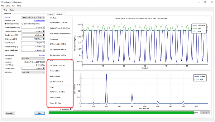

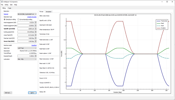

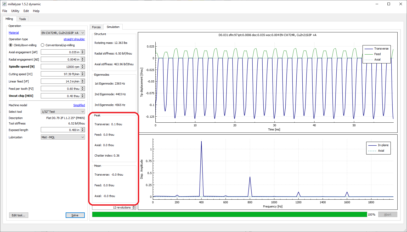

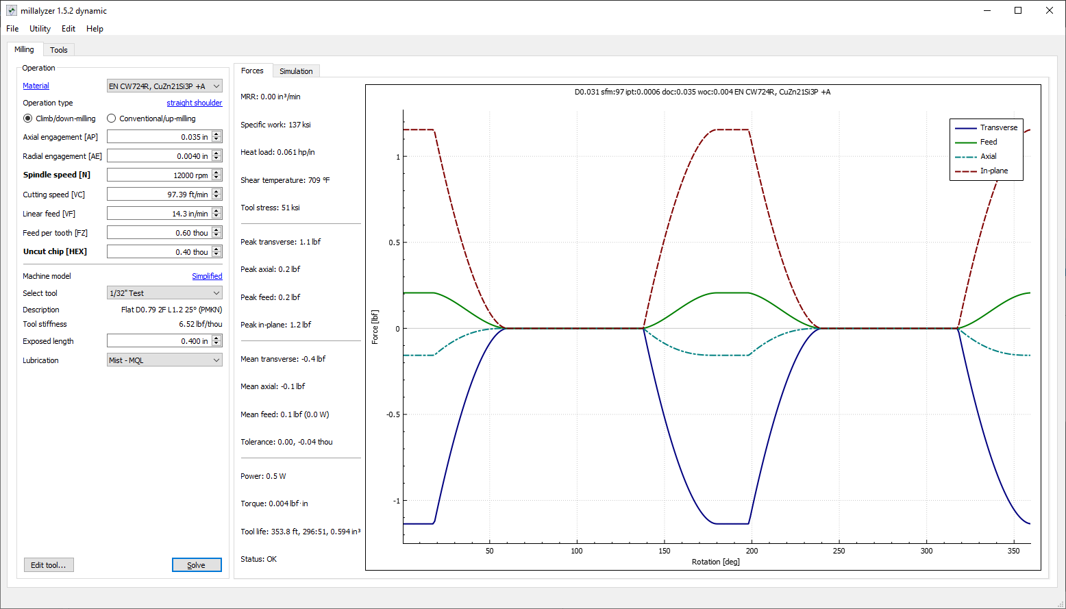

Let now look at Millalyzer to see if we are crazy. Have to use a silicon brass as it’s the closest thing there. Your H62 should be slightly easier on forces but want slightly more chipload.
Small chip:
We are mostly ok here and we expect a peak deflection of 0.0001" (0.0025mm) into conventional.

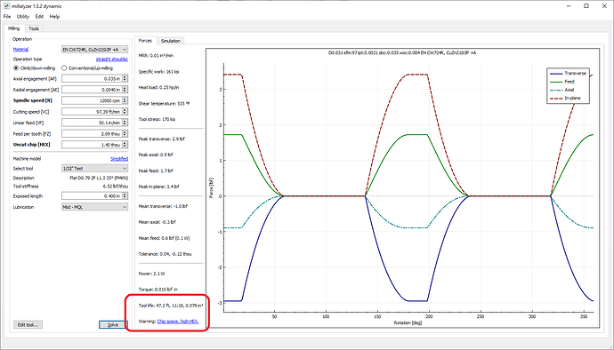

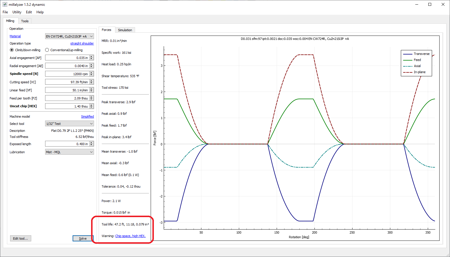

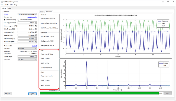

Large chip:
We do have some potential issues here. It’s warning us we might not have enough room in the flute of the cutter for the chips we are making. This being a steel cutter that may be true and we might compress them some. Might be ok as we are ejecting them out the back since this is a cleanup pass. Additionally, we won’t have this chipload across the whole flute as the helix will change the amount of runout across any single flute. Can’t say completely as I don’t have one of those cutters to inspect.
We have also increased the deflection on the tool up to 0.0004" (0.010mm).
If we have to assume for more runout we probably don’t have enough room to actually use the tool as a cutter. At least not with the steel cutter geometry and a full plunge. If you have to use the tool as a grinder you will actually have more forces and therefor more deflection even though you are removing less material. Keep in mind too that whatever your runout is will add to both sides of the cut.
Other solutions to this would be a single flute tool as they only have to deal with the runout in plunge and certain direction changes. Lower runout but that’s not an easy ask. A more aggressive cutter geometry to give us more space and a lower minimum chipload. Multiple passes to lower our forces and let us take larger chips.
