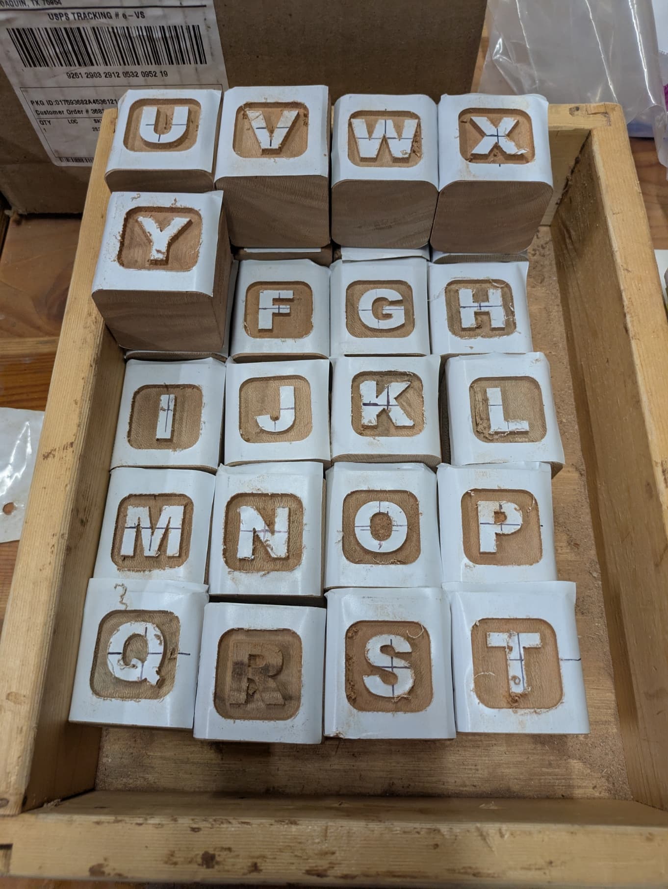

I buy Easyliner Adhesive Shelf Paper at Walmart. I have Oramask that goes unused. The shelf paper works well and is CHEAP. All masks can get frayed and come off during cutting. Here is an example of some sycamore blocks I made and the shelf paper came off. The main purpose of the shelf paper was to mark the center for machining. I did not make the blocks and some were different sizes. They were carved on both sides.
