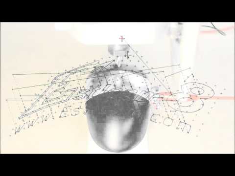

Not sure if this might work for you, but Estlcam has a surface scanning option that’s interesting:
