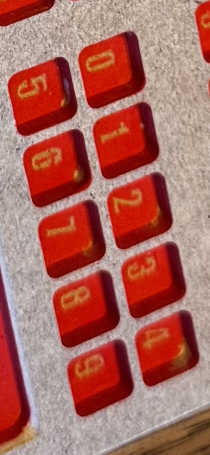

I’m making a game board using walnut that has pockets with engraved text at the bottom. I’ve made a few different prototypes using mdf, but the struggle for me is getting the text to “pop” more at the bottom (but still look nice). My latest effort has me cover the top with oramask, cutting the pockets, spray painting, then engraving the text, which works well enough to make the text stand out, but doesn’t feel high quality:
My next thought was to glue a brass sheet to the bottom, cut the pockets down to leave a very thin layer of wood above the brass, then engrave deep enough to cut into (but not through) the brass. I’m a bit worried about the “disconnected” wood though - interiors of 0’s, 6’s, etc. I’d have to have a very strong and even application of glue - these pockets are only 8mm wide and the text only 5mm tall.
Alternatively, I could engrave the brass separately, paint fill the text, cut the pockets all the way through the walnut, then simply glue the two pieces together - although cleaning up the excess glue would be tough, as there are over 70 individual pockets.
Any thoughts on these two approaches?

Your concept sounds solid, I would try your first example with a twist. Is it possible to mill out the text (I assume this is letters and numbers) from the brass sheet using the blue tape or double sided tap, create the pockets and then insert the milled out text?
Based on numerous glue ups I have performed it may be very difficult to align things as well as the cleanup you mentioned.

My inclination would be to mill out the text and then fill it in, then wipe or face things off.
Epoxy is popular for this, a lacquer-stick is the traditional machinist option for metal.
Perhaps try a negative/positive approach? Machine the numbers proud, then machine a mirrored negative out of a slightly thicker piece (so no worry about interior spaces/counters), glue it in place, then face it off?
Tim - That’s definitely an interesting approach I hadn’t considered. It would help me use more of the brass sheets (right now I would have about 2”x6” of waste per sheet of brass, not considering everything that’s hidden by the wood!) I may try that with some of the scrap and see how well it pops into the pockets. Could probably get away with minimal glue depending on how snug it is!

Not quite the same application but from my experience with copper sheet, getting the cutouts to fit just right is a huge pain: What did you cut on your Shapeoko/ Nomad today? - #4445 by HeuristicBishop
The bits of sheet will catch on the grain on the wood and cause the metal to enter at an angle. That makes it catch more and bend which makes it catch more…so if you’re going to inset any more than the inlay of your material, I’d be hesitant to recommend sheet inlay.
That said, if your numbers will be roughly flush with the surface of the walnut (like most inlay I suppose) the inlay for numbers might be relatively quick and easy.
One benefit of this approach is that you may be able to punch the brass numbers from your sheet stock. That would give you very clean inserts even with a very thin sheet and should have good yield in terms of the raw brass.

After some thought and seeing all the good information in this post I wonder if a two sided cut operation would work? Cut pocket’s under each of the keys, cut small square brass inserts to allow them to be placed in the pockets after the keyboard is flipped over and all of the text is machined out. This (in theory) would allow the text to be seen as cutouts with the brass in the bottom.
An advantage of this process is the pocket from the rear can be cut slightly larger than the text itself which will allow cutting the individual squares of brass larger and easier to insert from the underside of the keyboard. (In theory……)
And if this would work it could open up options for different material to be used underneath and even backlight with LED’s?
A flip operation would work great with the only issue being the islands in some of the characters. Might have to sacrifice some aesthetic and bridge the islands.
