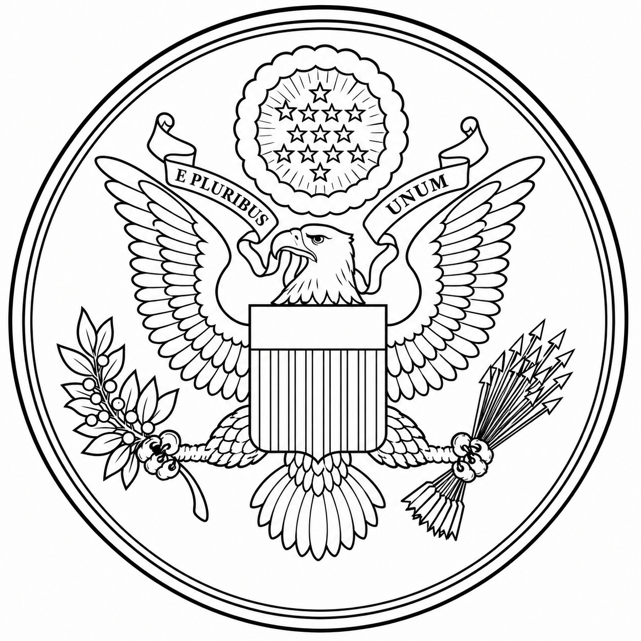

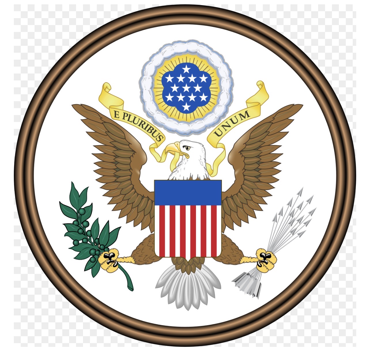

I was tinkering with the thought of using some epoxy for a transfer gift for someone. The customer wants the colors of the Great Seal of the USA in color and instead of disgracing the walnut lumber with some rattle cans I was feeling a bit ambitious after doing some wood inlays. My idea was to try my hand at some epoxy inlays.
I am having trouble wrapping my head around a work flow or the most efficient way to get it done with as close to as much detail as possible. And keeping the “brown” for the bird as just a basic contour with no offset type engraving. The one part where I have some fudge factor is that the seal will probably be about 4” in diameter so I know the detail won’t be as intricate being so small. Any thoughts or advice, please Send It.

Then work outside → in. Starting with white, I would do the entire area in white, then cut the other colors, yellow, blue, gray, red, green, black into the white. And then the lines in the eagle into the clear.

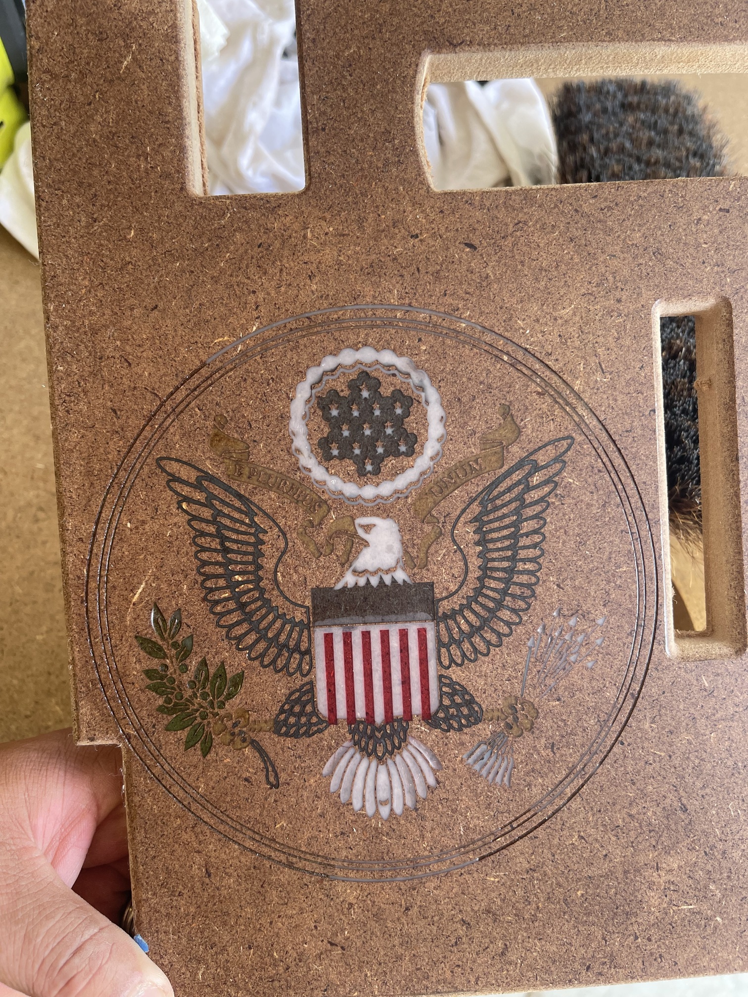

Sorry yall, I went rogue for a bit. So I did run the file and made the design significantly bigger. Everything was descent until the last run and I am unsure how it happened lol. My trial I finally got the image to upload fine with AI help with this image and some node edits. My last run after I left the epoxy on to cure I attempted to do the white stars for filling, and the red stripes along with the white tail on the tool path because I hadn’t figured out a good flow for incorporating the red and white stripes. Overall it was a descent run. And a learning experience. I did have some bleed over from the white to the blue due to my impatience.
Yeah I see what you are saying. I did bump the table while off and the gantry moved back is the only way I could possibly explain what happened on the last run which may have caused this homing to be off. But with the final piece I will not have the center as over this image so I would be able to find my center again once runs are complete. Once my center of the shield was cut I was kinda of riding blind and just hit the I Believe button and sent it.
