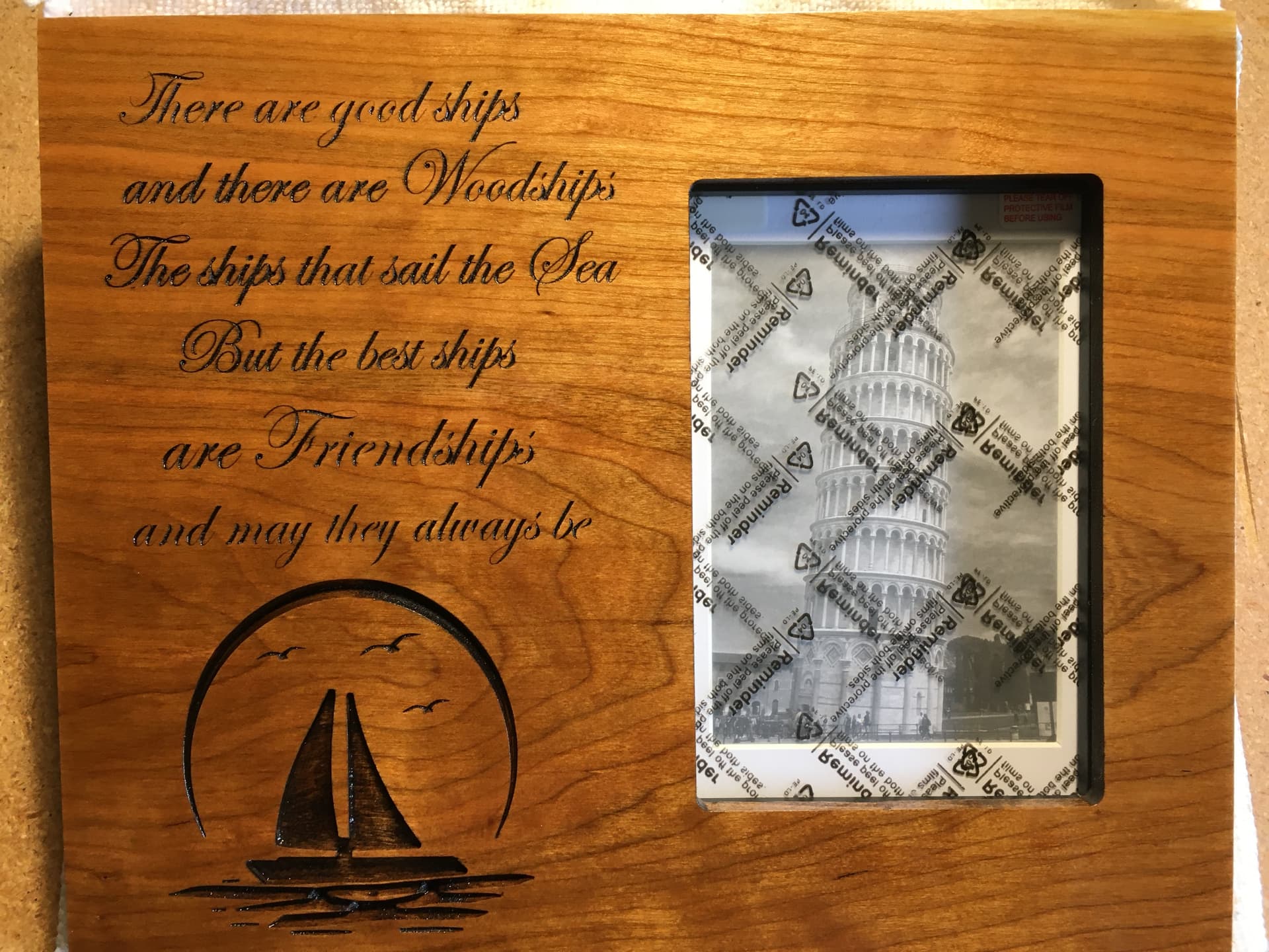

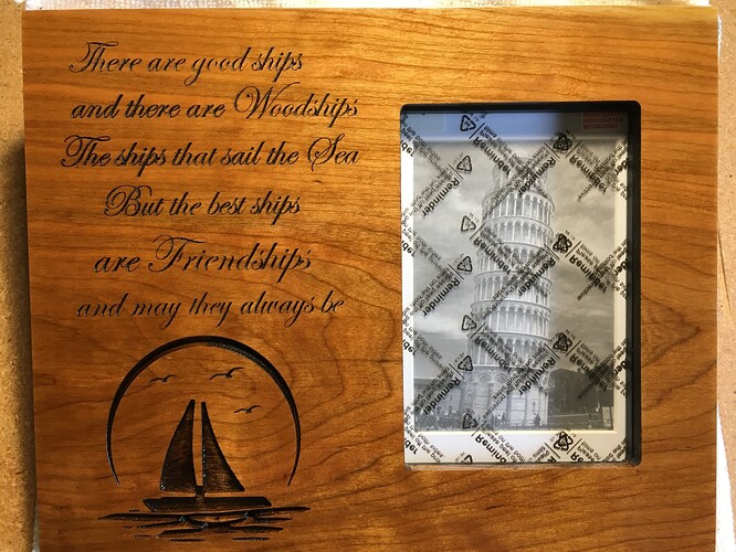

What type of wood are using? I plan on using a white/pearl epoxy on either cherry or walnut. When I paint my carvings I generally give it a coat of poly, then carve it. This seals the top and lets me get the paint off because I am a messy painter and don’t stay in the lines. I have also done dark stain to darken the image, without changing the wood color much with 2 coats of urethane before carve.
@Tom_S
That process allows you to remove the paint from the surface, however if you look at the capital letters W, B and F you can see some grain wicking of your paint. To help prevent this it’s common to seal the carved out design with a clear drying sealer of some sort. Elmers glue is a simple one that works for me. Most paint has a fairly “short” drying time compared to most epoxy’s used in this type application. The longer cure time allows the wicking action of the grain to pull more in if not sealed.
And as always, the wood species has allot to do with the severity bleeding effect.

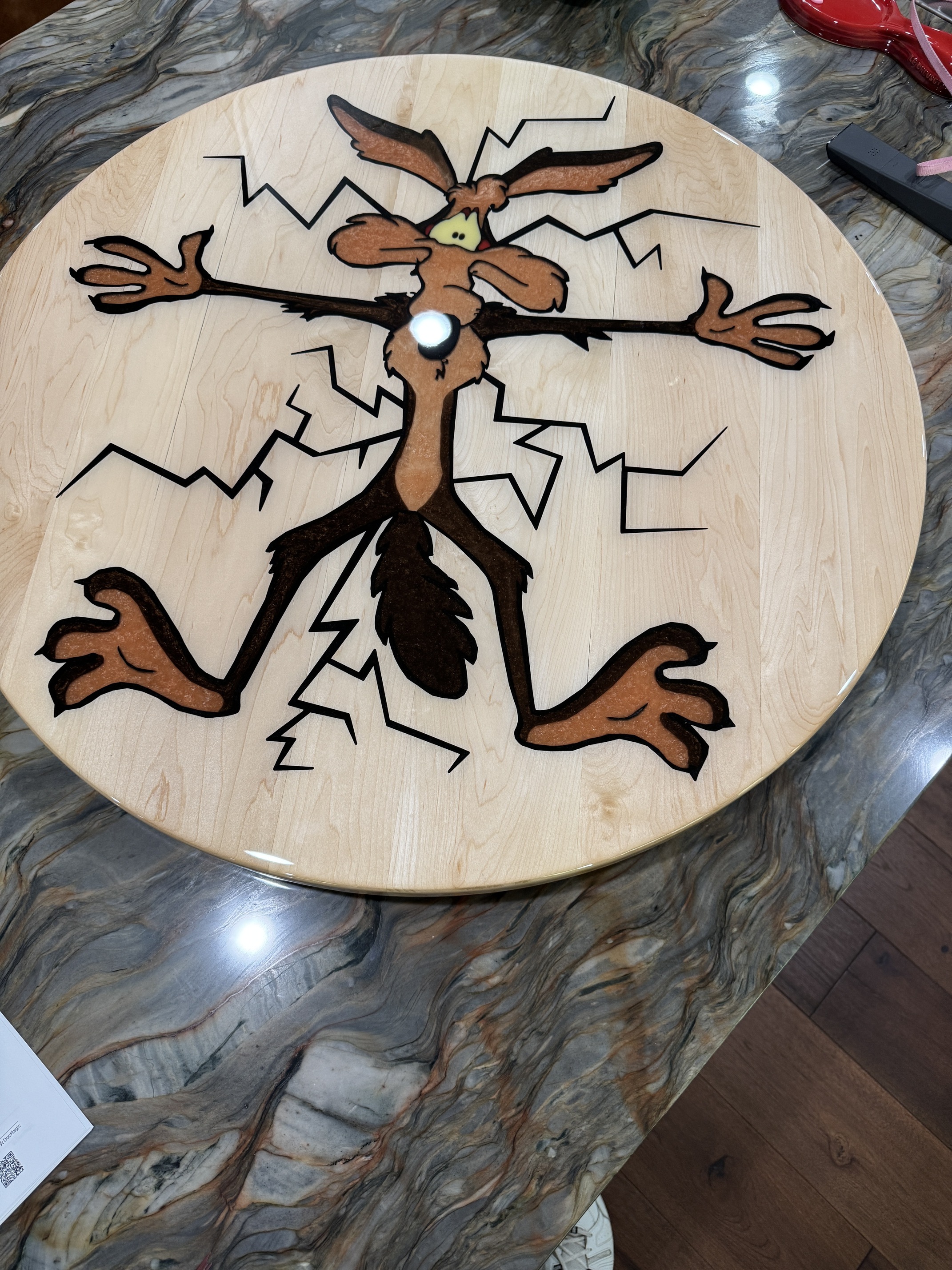

I carve my wood to .25”, then spray the entire board with 3 coats of Bulls eye wax free shellac. My last project, I only sprayed one layer where I was going to pour, and the black epoxy got into the spaces where I glued the maple boards together.
