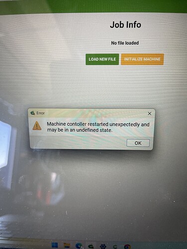

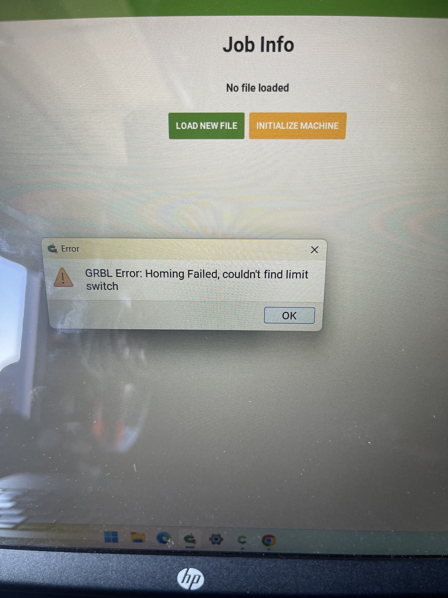

I have been using my shapeko xxl for over 3 years without any issues. I turned it on to initialize today and received these errors. I tried refreshing settings in the motion software and nothing is working. Please help… know how to run the machine but I’m not very technical.
Thanks!
Power down, unplug the power supply from the controller and the wall and wait 30 minutes or so.
While waiting, reboot your computer and slowly/gently move the machine through the full range of motion for each axis, bring each axis back to the center of motion — does anything mechanically interfere? If you have a Z-Plus or HDZ are the linear rails well-lubricated?
https://carbide3d.com/hub/docs/maintenance/
Power up and connect to the machine and go to Settings | Debug — are any homing switches stuck on? Test each homing switch — does each signal as the correct axis?
Try initializing — what does the machine do? Let us know step-by-step. It should:
  • home the Z-axis, lifting it
  • begin moving both X and Y towards the back right corner — when an axis hits a switch it should continue in a straight line
  • at the top, back, right corner it should re-home each axis
