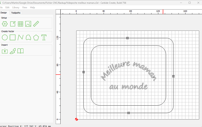

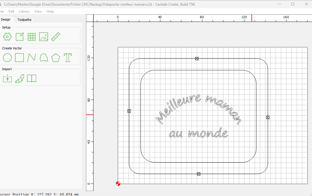

1- Original File and an image from the file on Google Drive :
Videpoche meilleur maman.c2d (240 KB)

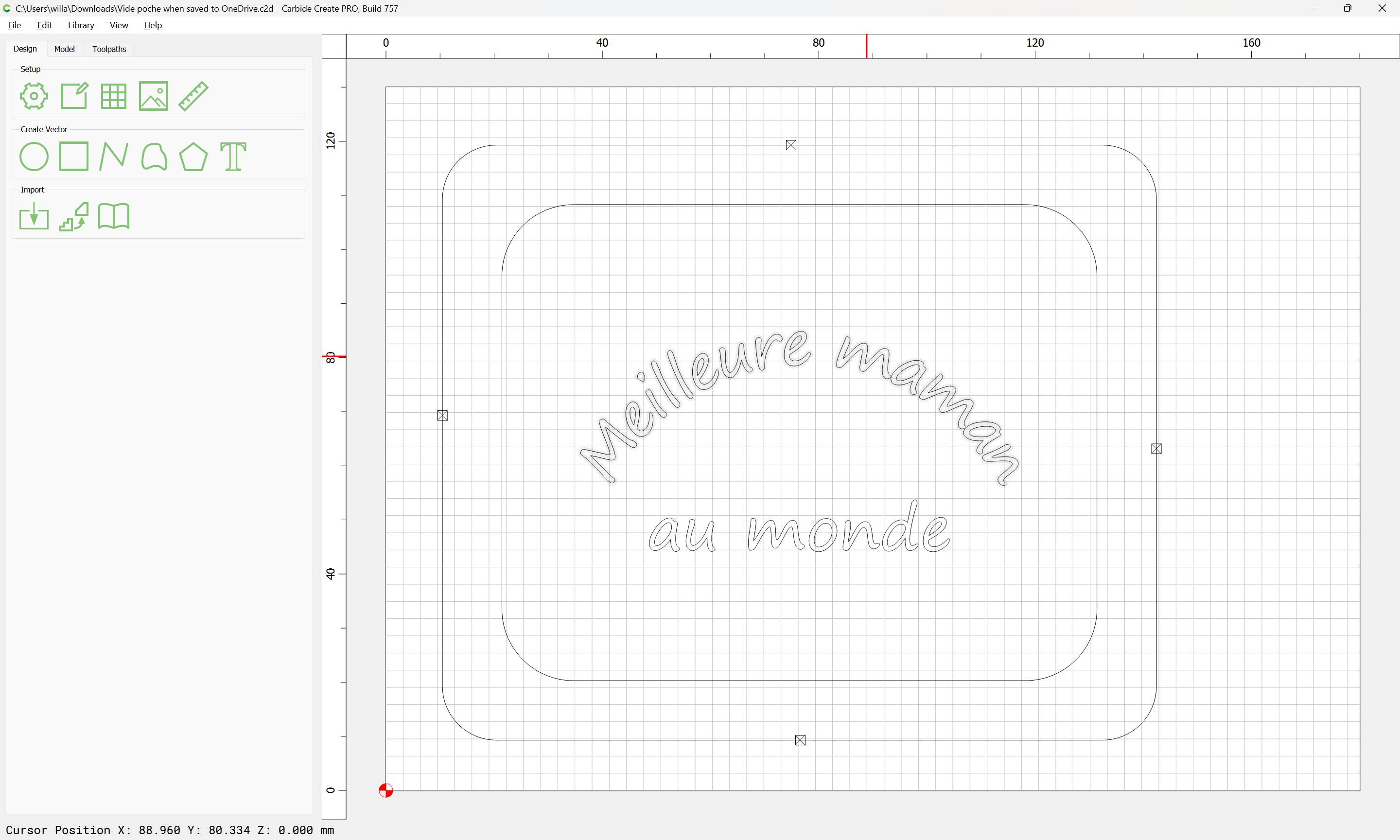

2- File that I save to Onedrive. I know that If I copy it on C:, it will open correctly
Vide poche when saved to OneDrive.c2d (240 KB)

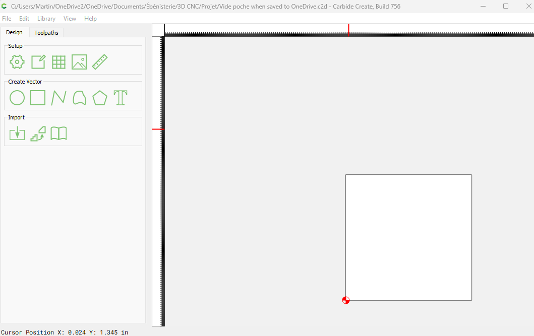

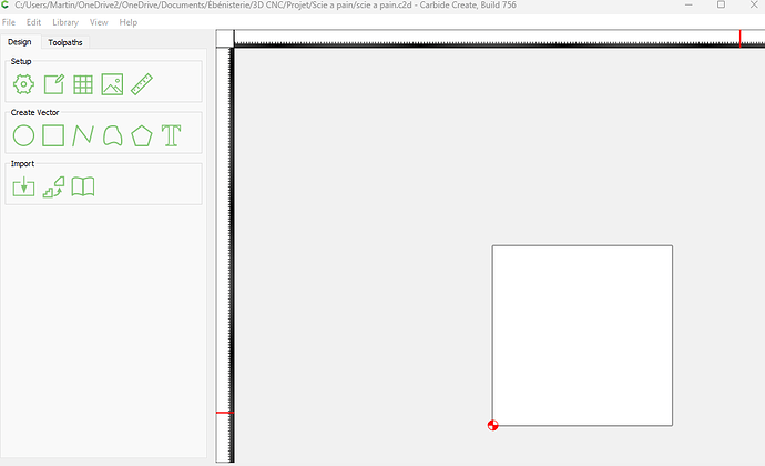

3- Here how it looks when I open it from OneDrive. Just saw that iti in inch and not in milimeter anymore
4- File after saving it :
Vide poche when opened from OneDrive.c2d (44 KB)
It look like it is loosing the Job Setup

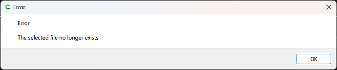

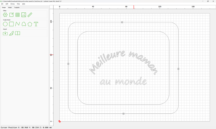

The file opens fine here:

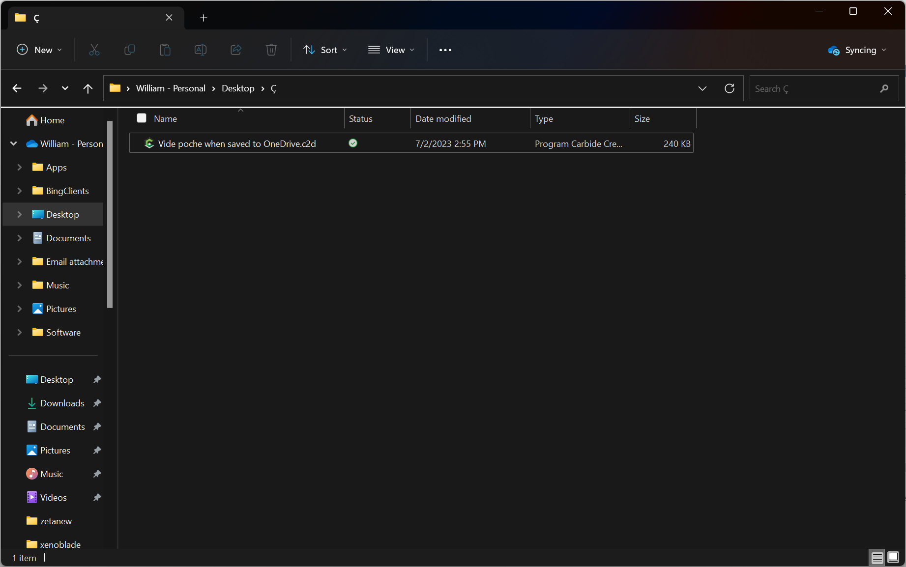

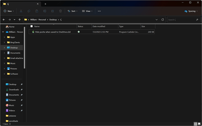

but if I put it in a folder which has a non-ASCII character:
“C:\Users\willa\OneDrive\Desktop\Ç\Vide poche when saved to OneDrive.c2d”
I get the message:
when I try to open it and a similarly blank file.
We have this down as a reported bug which we have been able to replicate, but it may be that it is a consequence of the programming toolkit which we are using (I supposed I should check on my Mac to see if it’s specific to Windows).
Bingo, You got it. My folders name have French accent. I removed them and I don’t have the problem anymore.
Thank you very much
