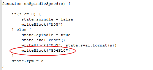

First, I’m new to writing code. I’ve managed to tweak a generic carbide create post-processor to turn on my VFD router and pause for 10 seconds before starting to cut. What I have works great if I don’t have tool changes. Currently when I have to change tools the Gcode tells the router to stop and raise to make the tool change. When I restart the process after changing tools the router does not start or has a dwell time before cutting. How and were would I write in the code in the post-processor to set the parameters in the Gcode to turn on (M03 S = spindle Speed for new tool), Pause (G04 P10), then continue on with the cut.

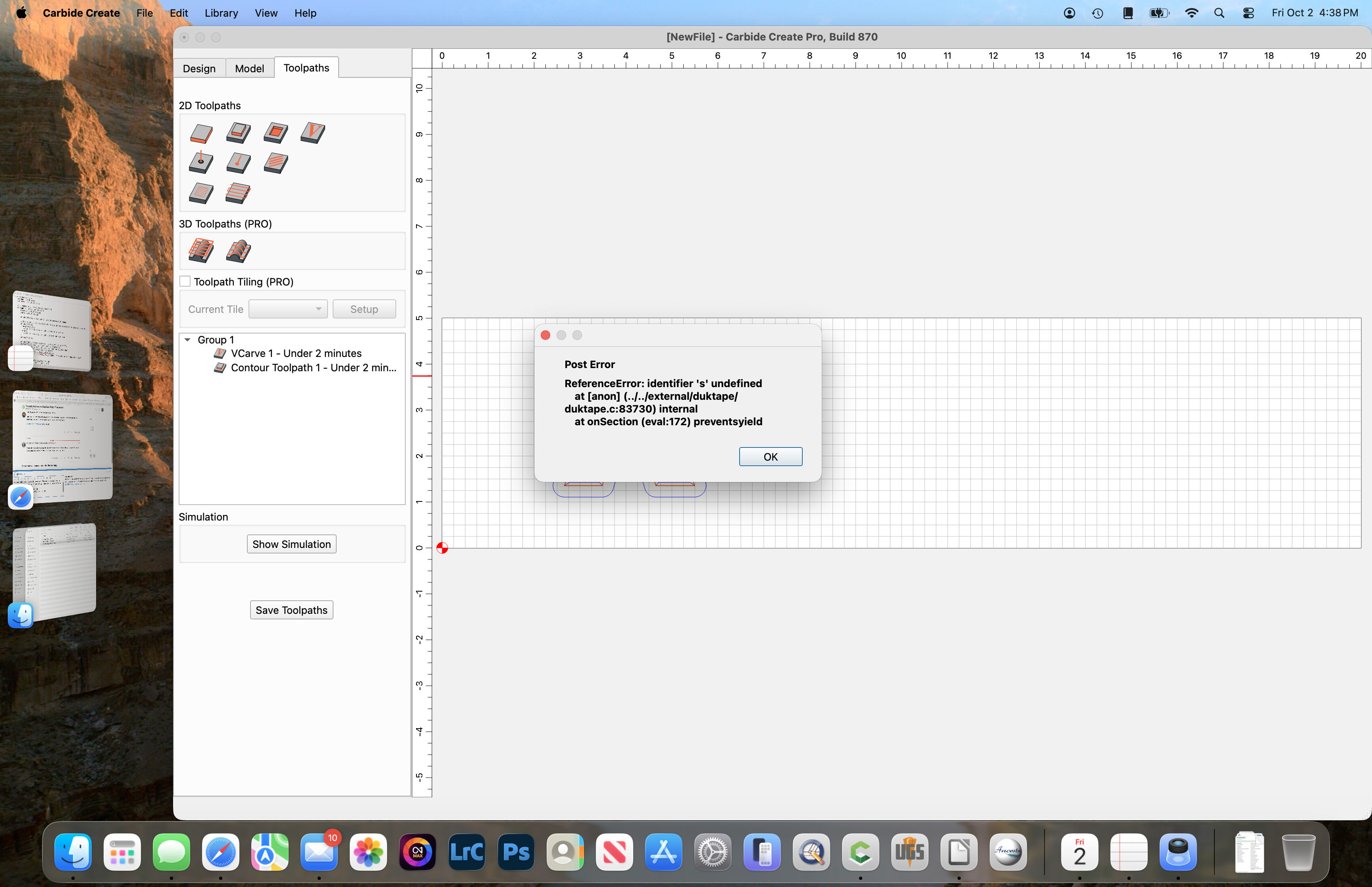

The lines I added are in the “function onSection”. They are the last two lines under the Manual tool change sequence - #1. I am getting an error when it makes the Gcode .ns file.
GRBL CCP_VFD2.post .zip (3.1 KB)
Without those two lines the post-processor works great when I don’t have to make a tool change. My work around was to edit the Gcode in UGS at the change tool point and place these two lines under an M0 command. Then the router does what it’s suppose to do and I can finish the process. I just want to automate it so the lines are there when I generate a .nc file in Carbide Create Pro.

You shouldn’t need the M00, just add this line to the onSpindleSpeed function…

Thanks Tod, That helps. I’ll give it a try. I use the M00 pause to allow me to recheck before starting. It comes in handy at the beginning because I seam to forget to put my brush on for dust pickup on occasion. Most of my paths start near the lower left edge of my board. the file I sent was just a sample for the Gcode.
Just wanted to let you know that fixed my problem. Thanks for that. It works great now. I have two other issues in the script. The M6 and the G53 code are causing issues. I’ll work on tweeting the code.
