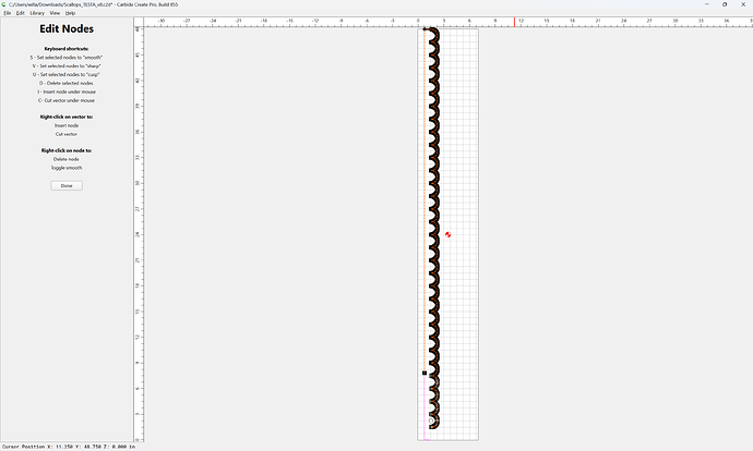

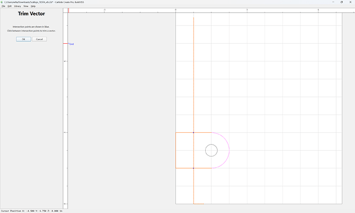

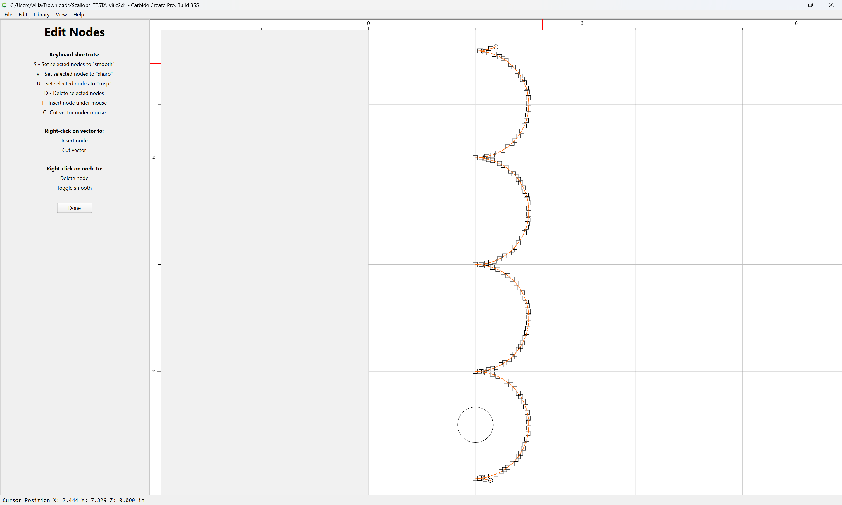

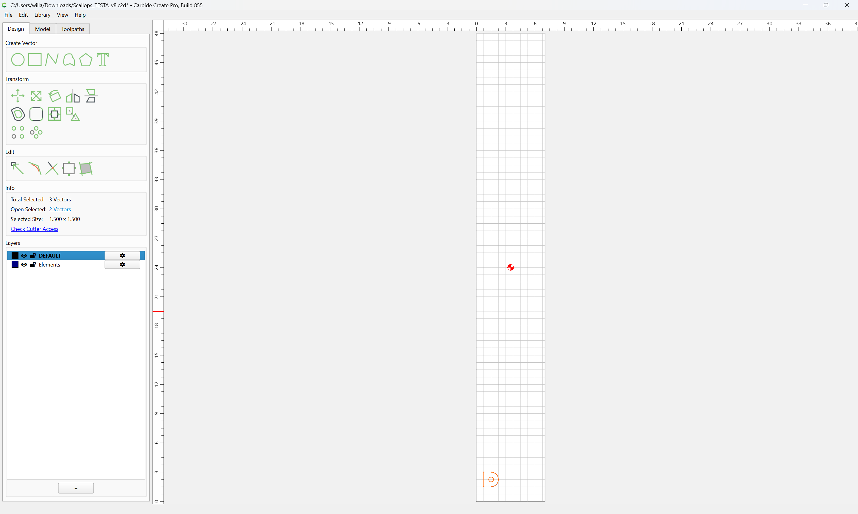

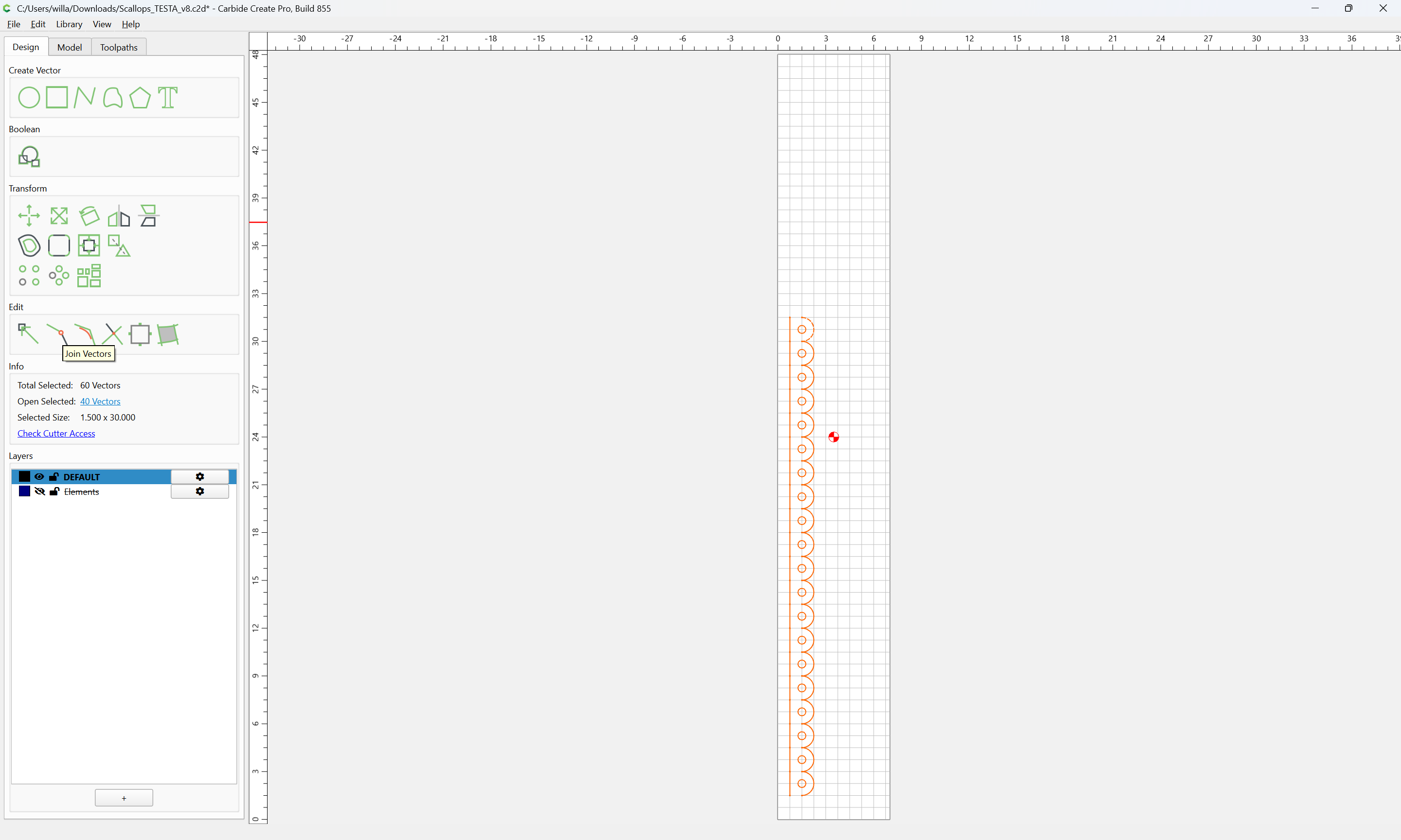

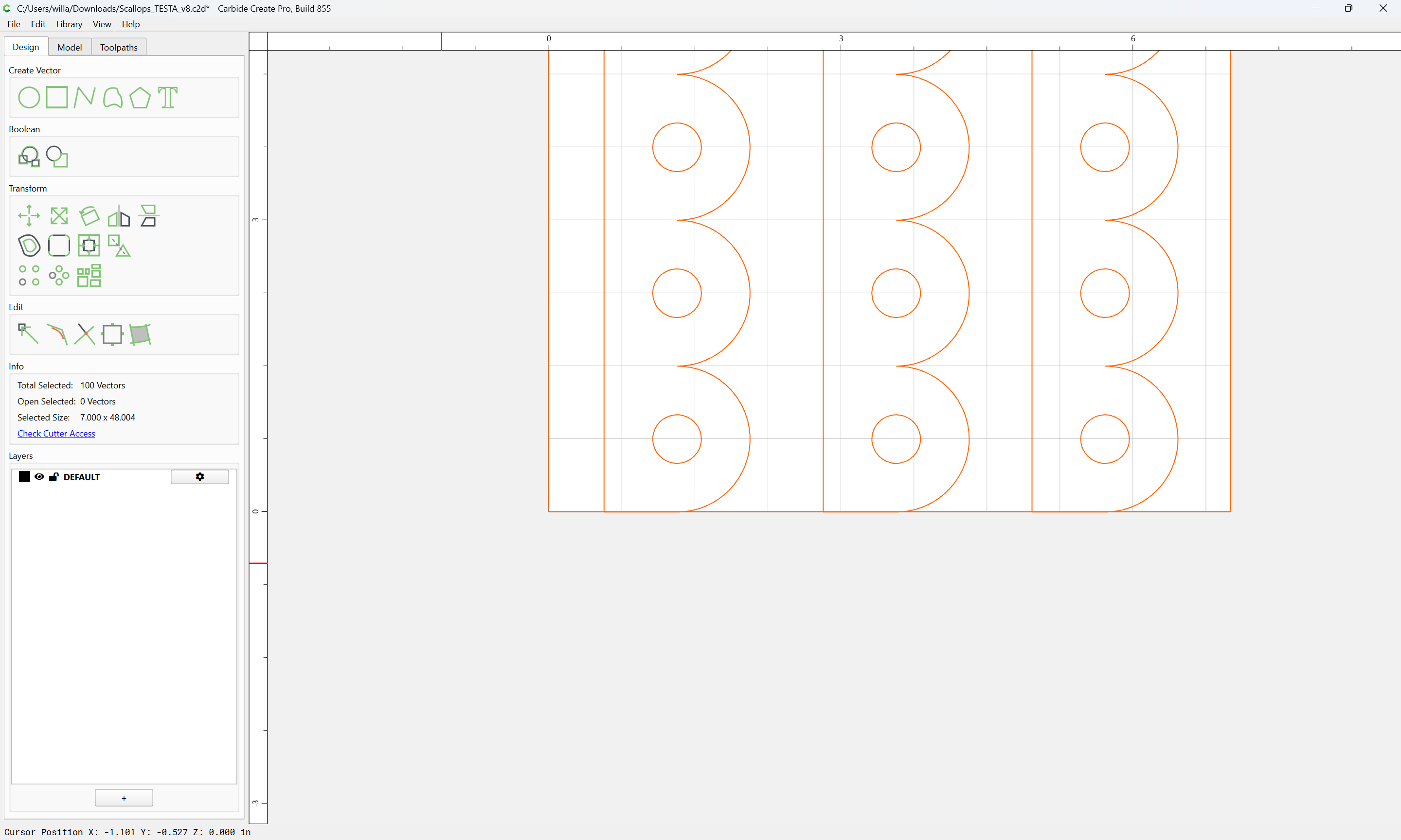

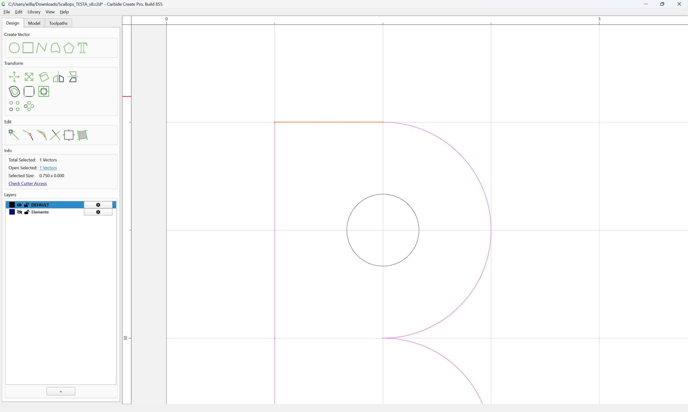

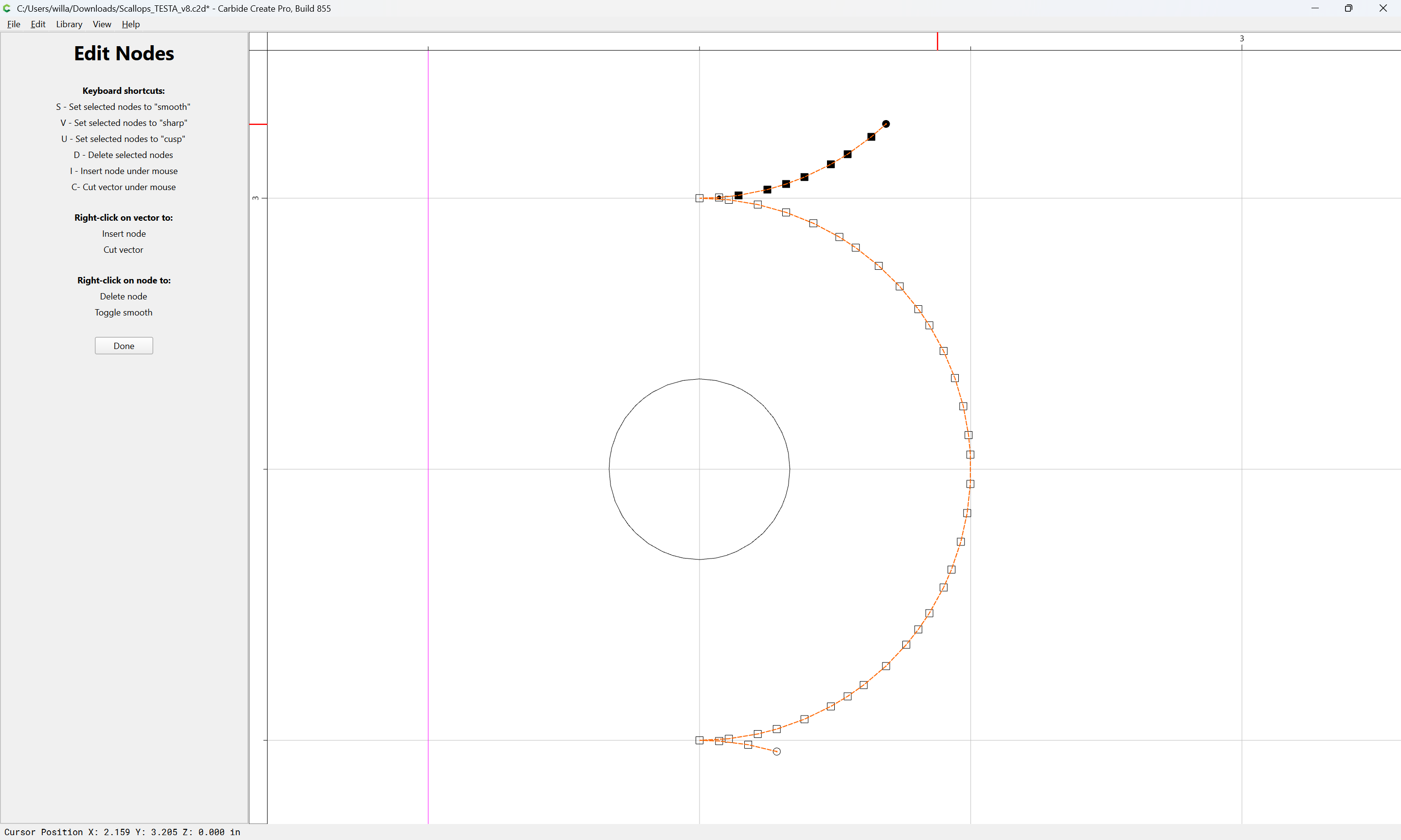

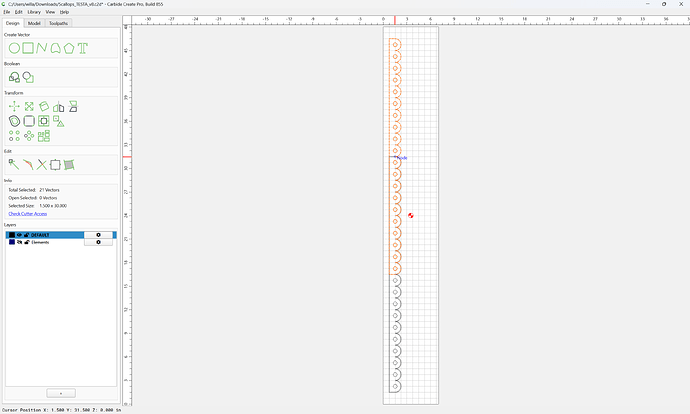

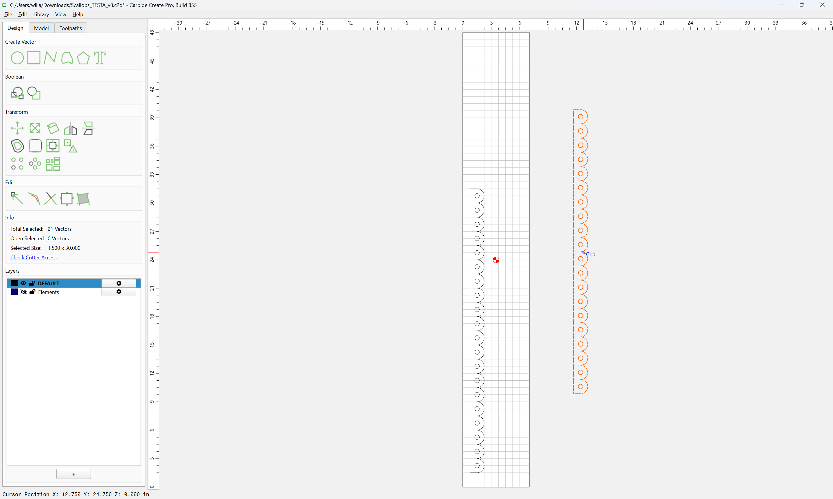

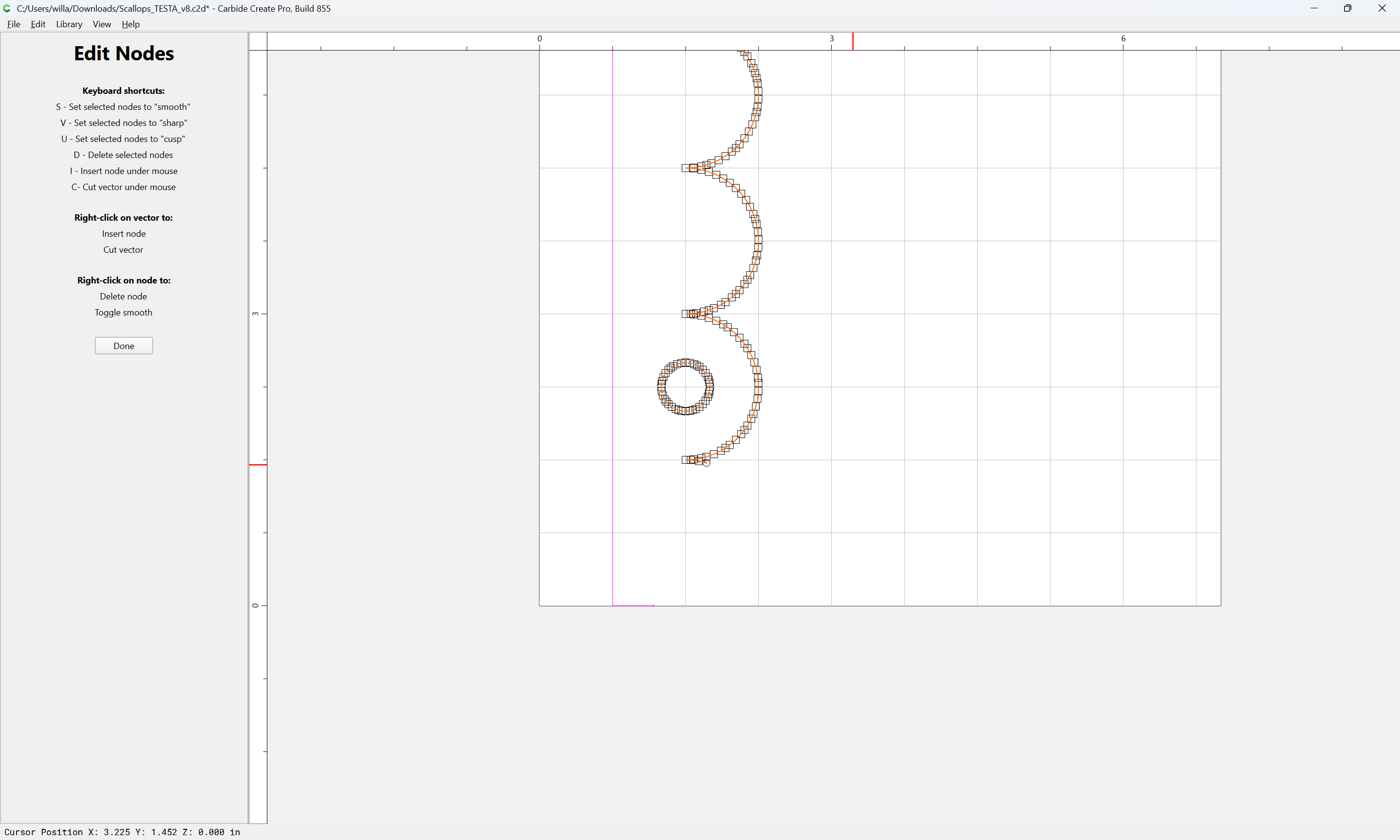

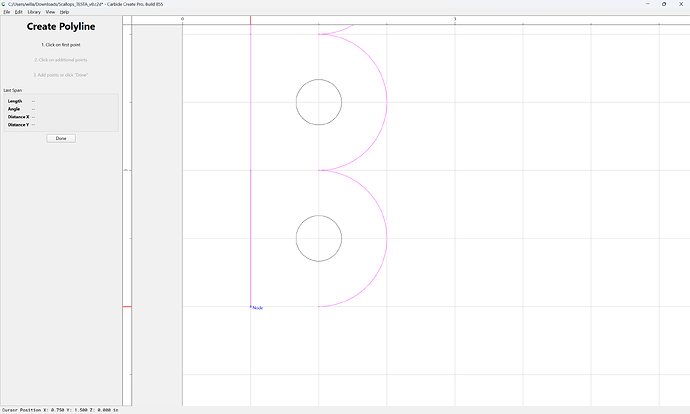

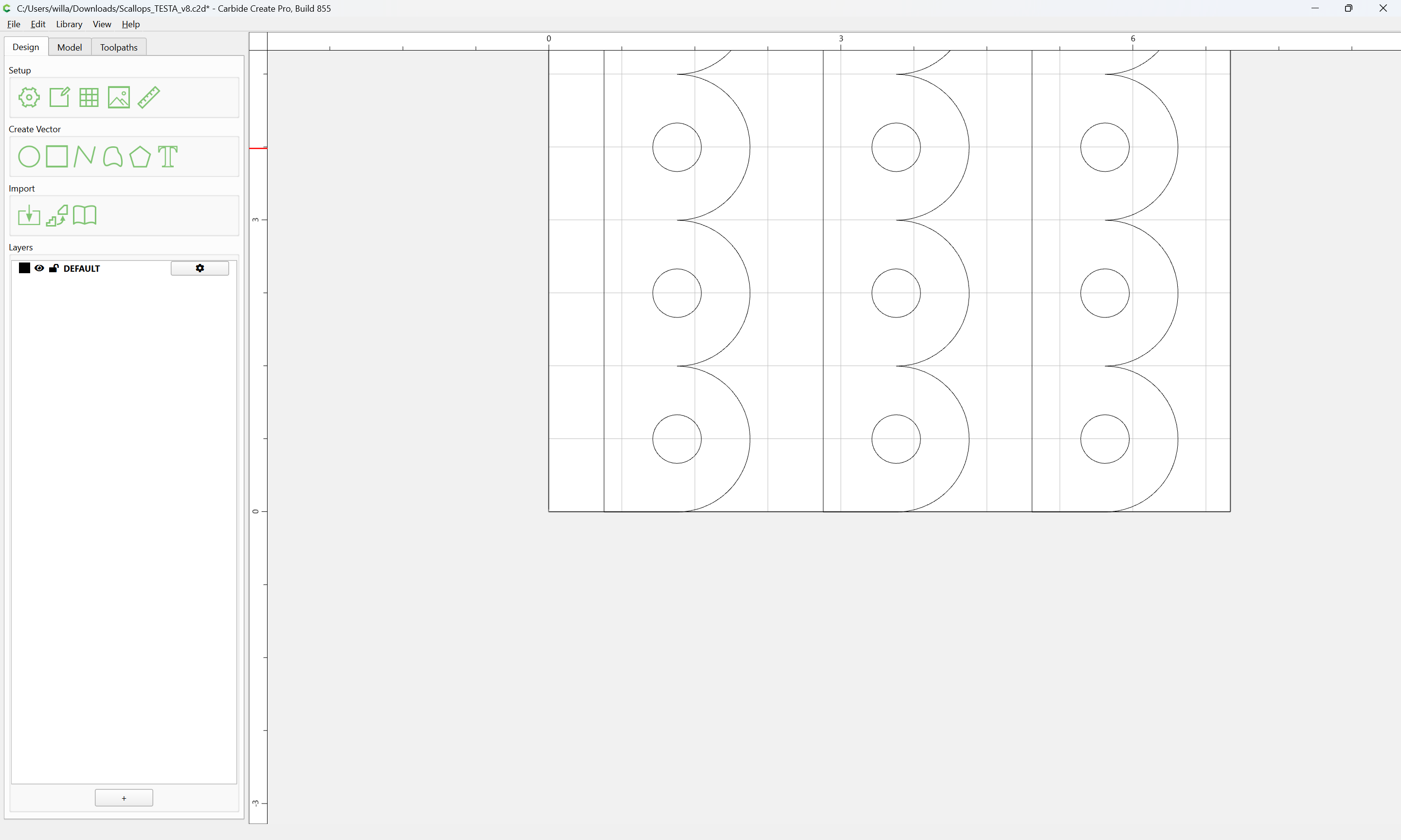

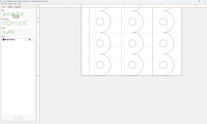

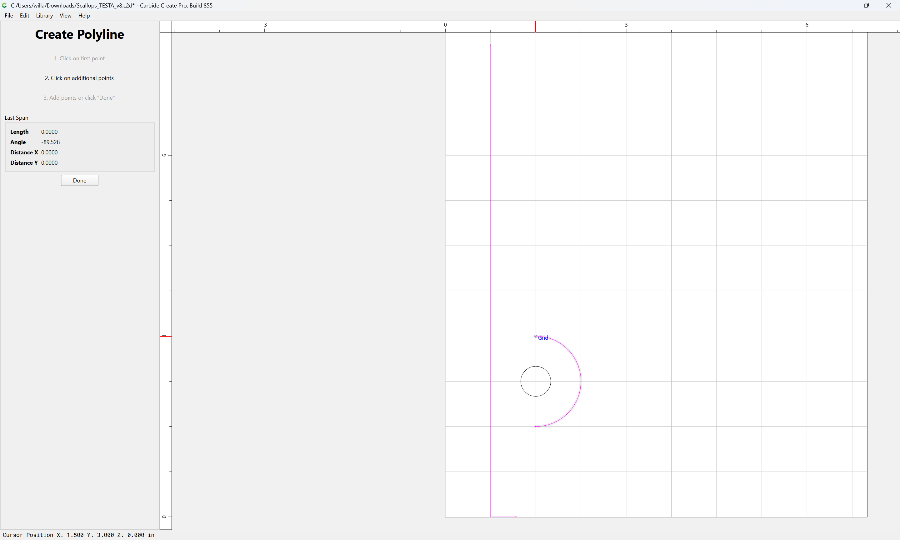

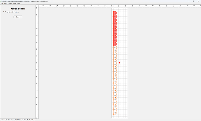

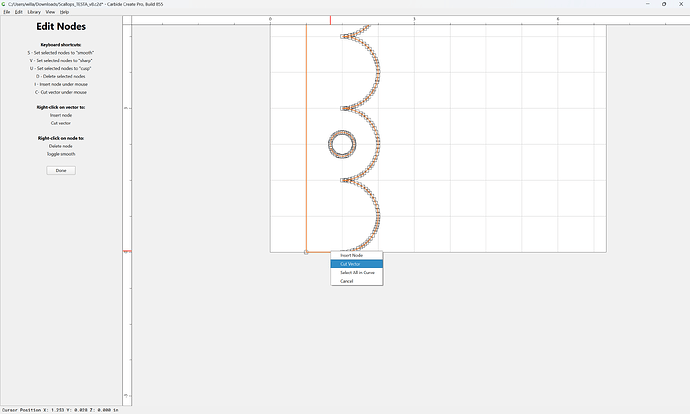

Trying to get rid of these little cuts in my file but can’t seem to figure it out, retraced the vector a few times and seems pretty clean. Not sure where to look next-
… file opens with unconnected lines… select and connect each of them … that then (cuts as expected)
I left it open cause I have a run off and I am trying to continue it long.
There are notable approaches here are:
  • have a separate layer with the scallops in pieces which may be extended at need using the Linear Array tool
  • manual edit the elements to join them
  • overlap multiples and use the Region Builder to create the desired region
We will show the second as we construct the first, then use a completed piece to demonstrate the third…

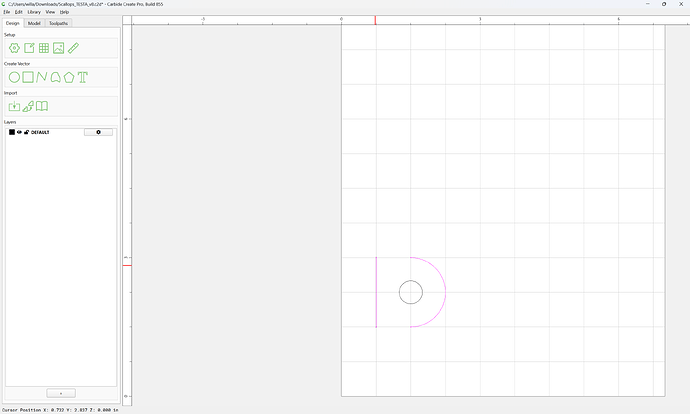

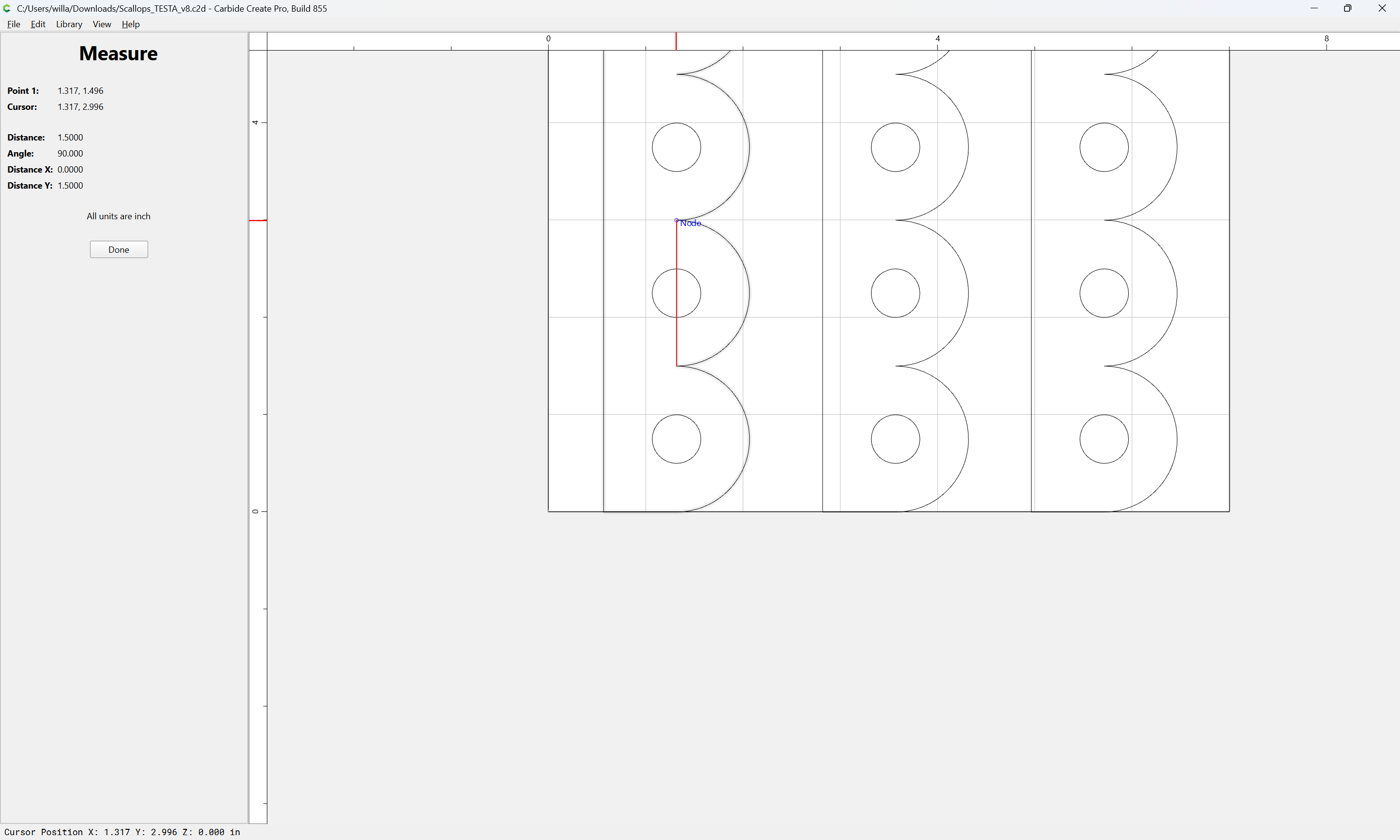

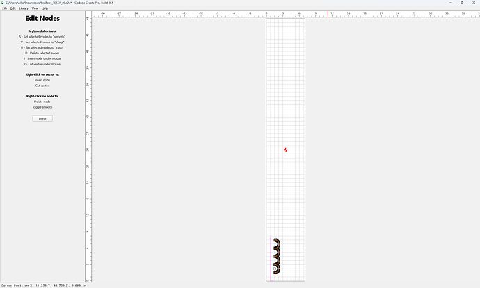

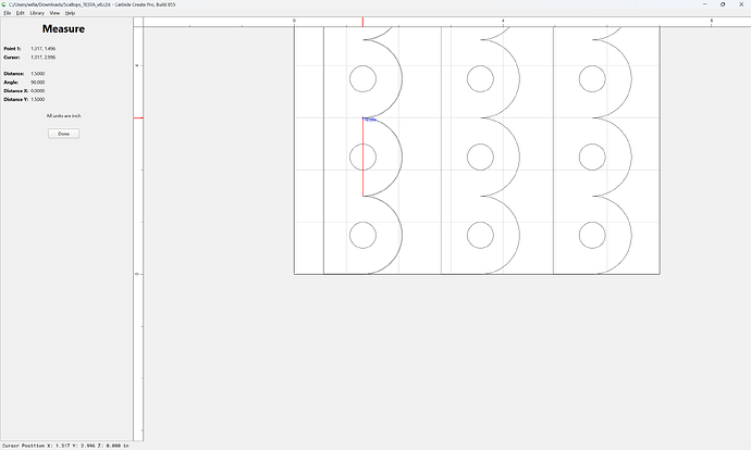

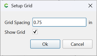

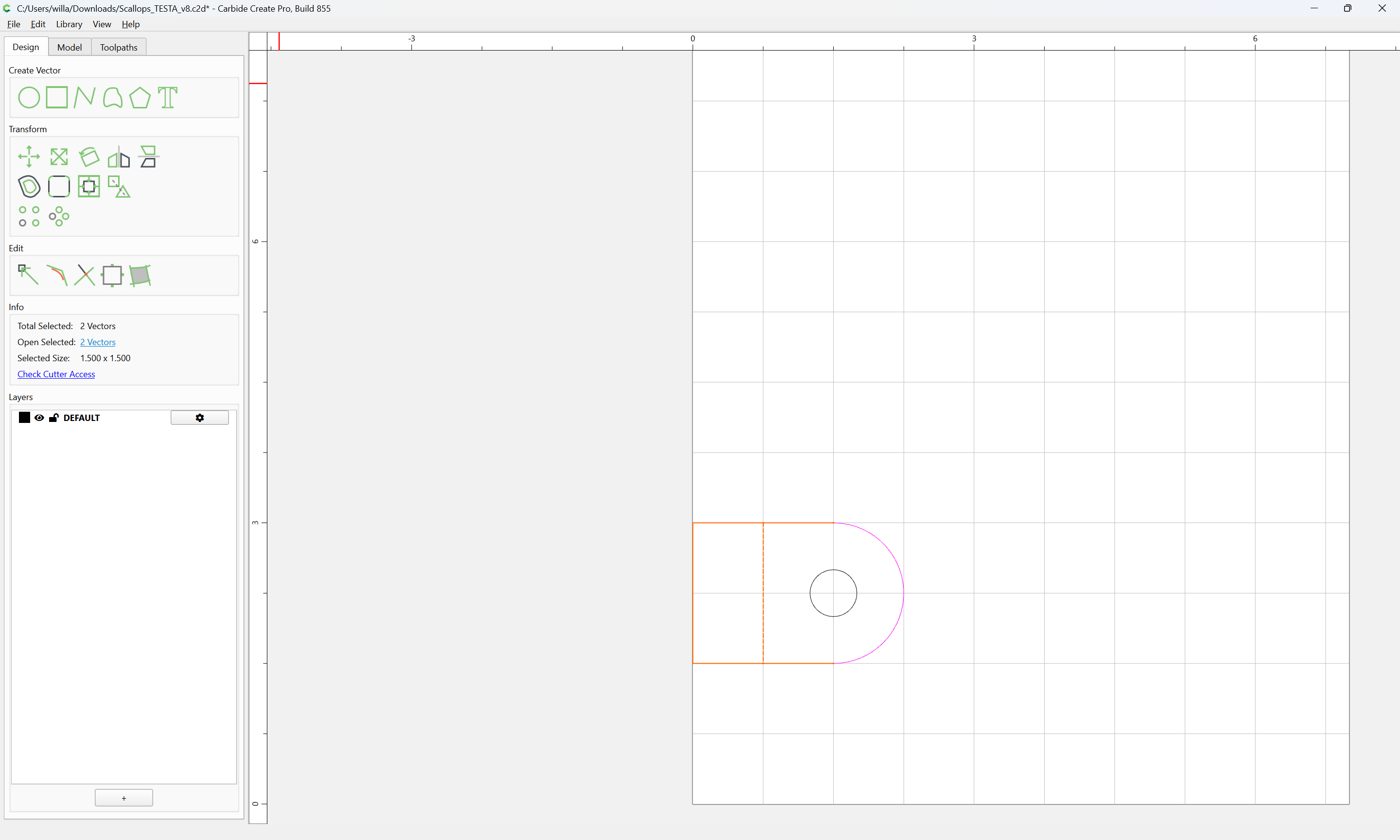

First, zoom in:
and measure the unit size:

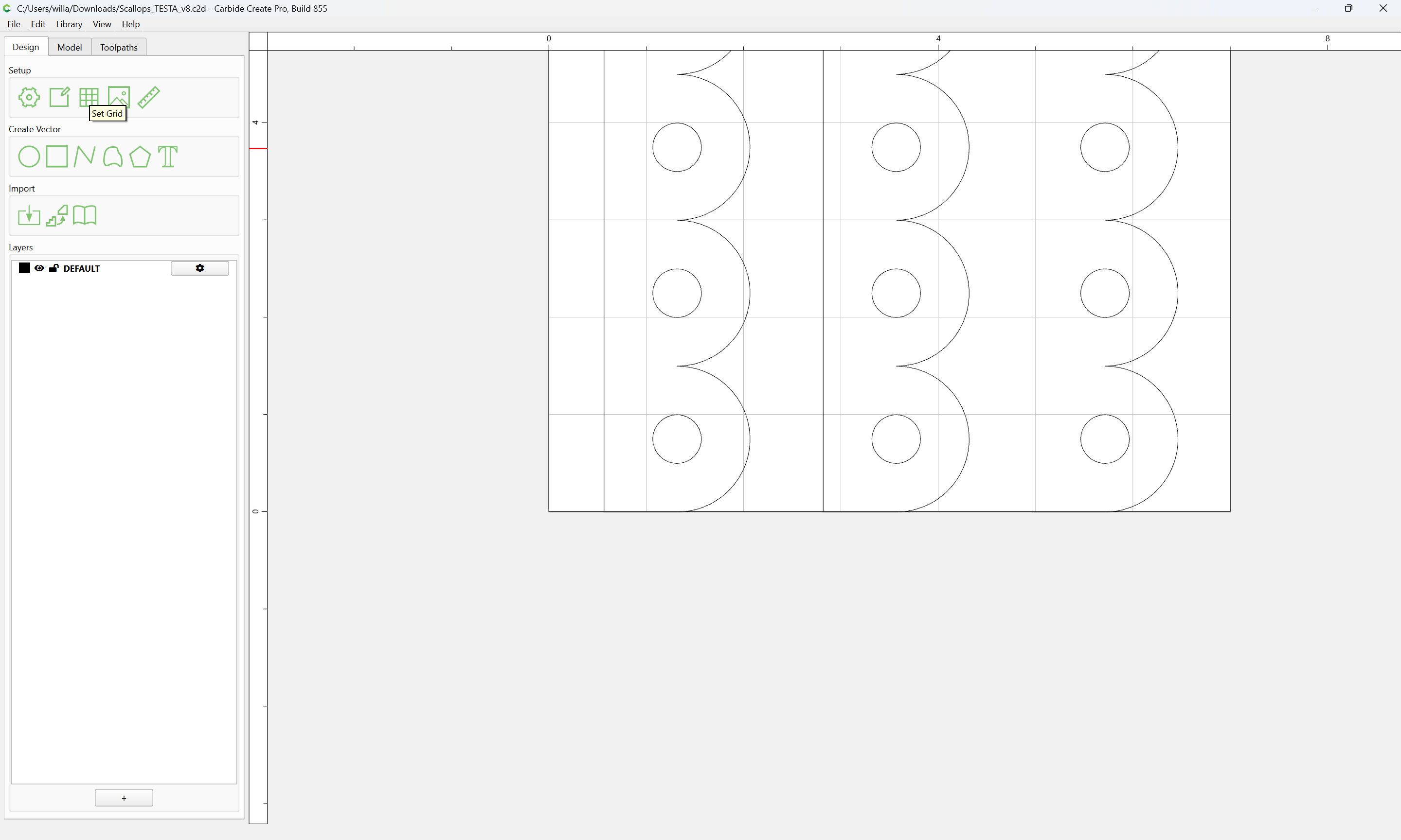

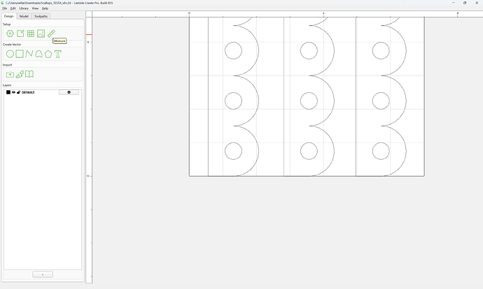

and set the grid size to match half that:
Set Grid

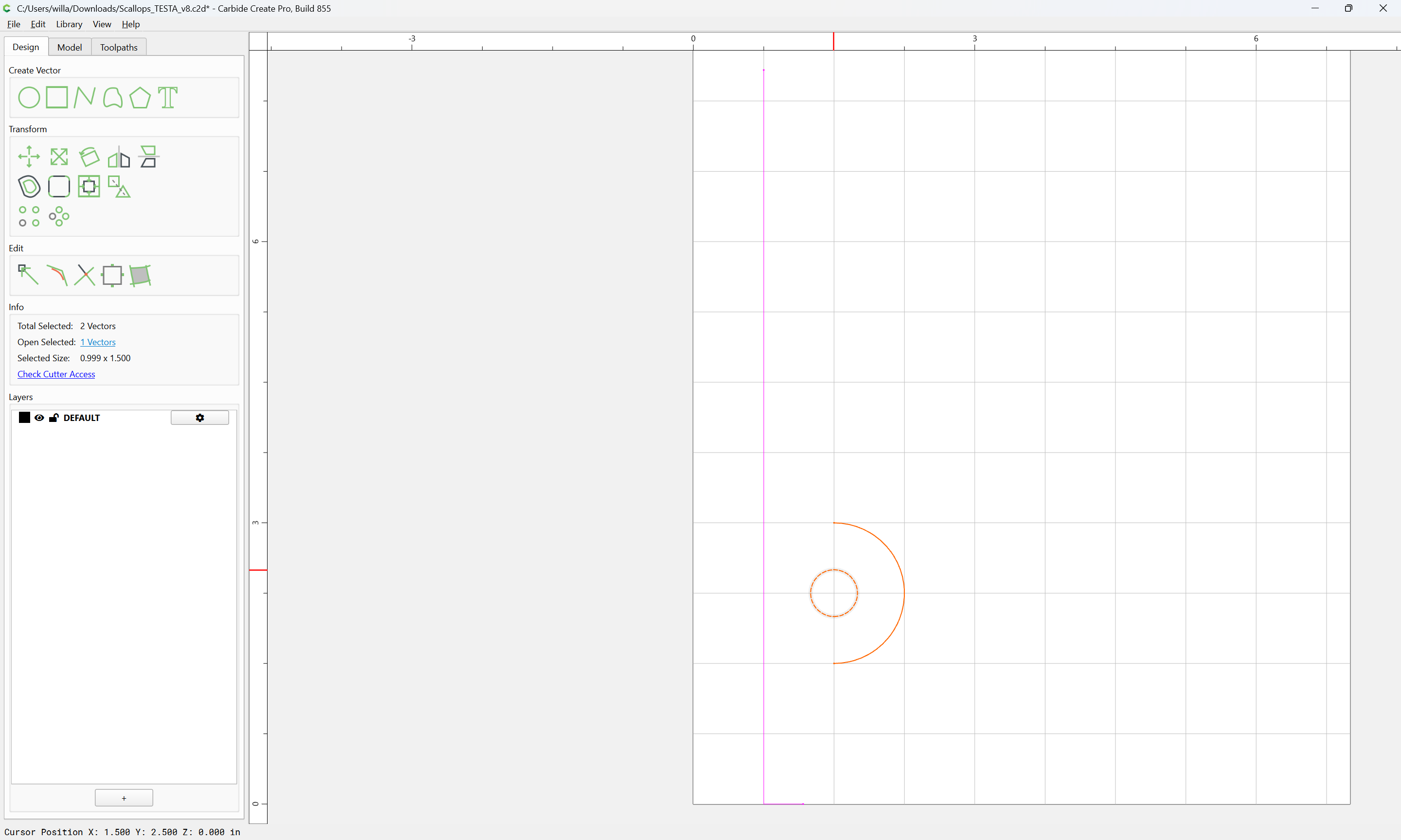

Then select everything:
and deselect one set of elements:
and delete:
Then select everything and move so that it lines up with a grid intersection:

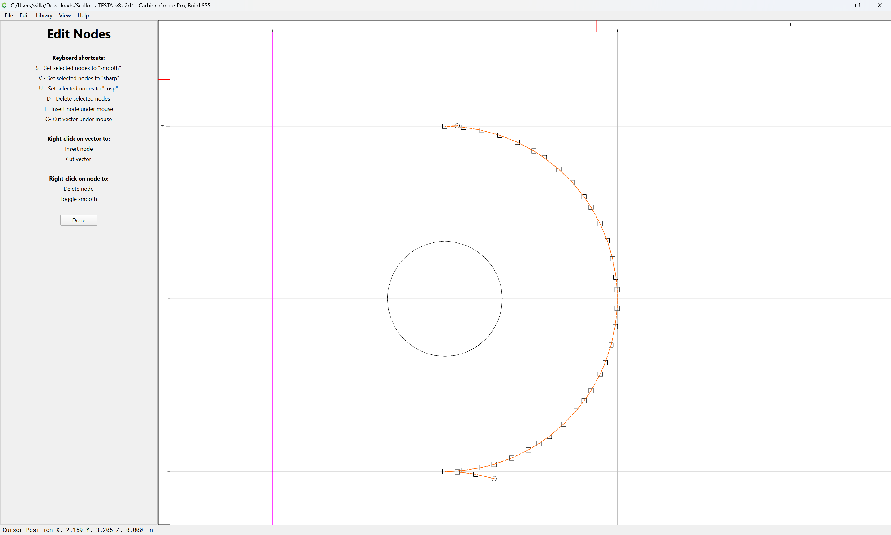

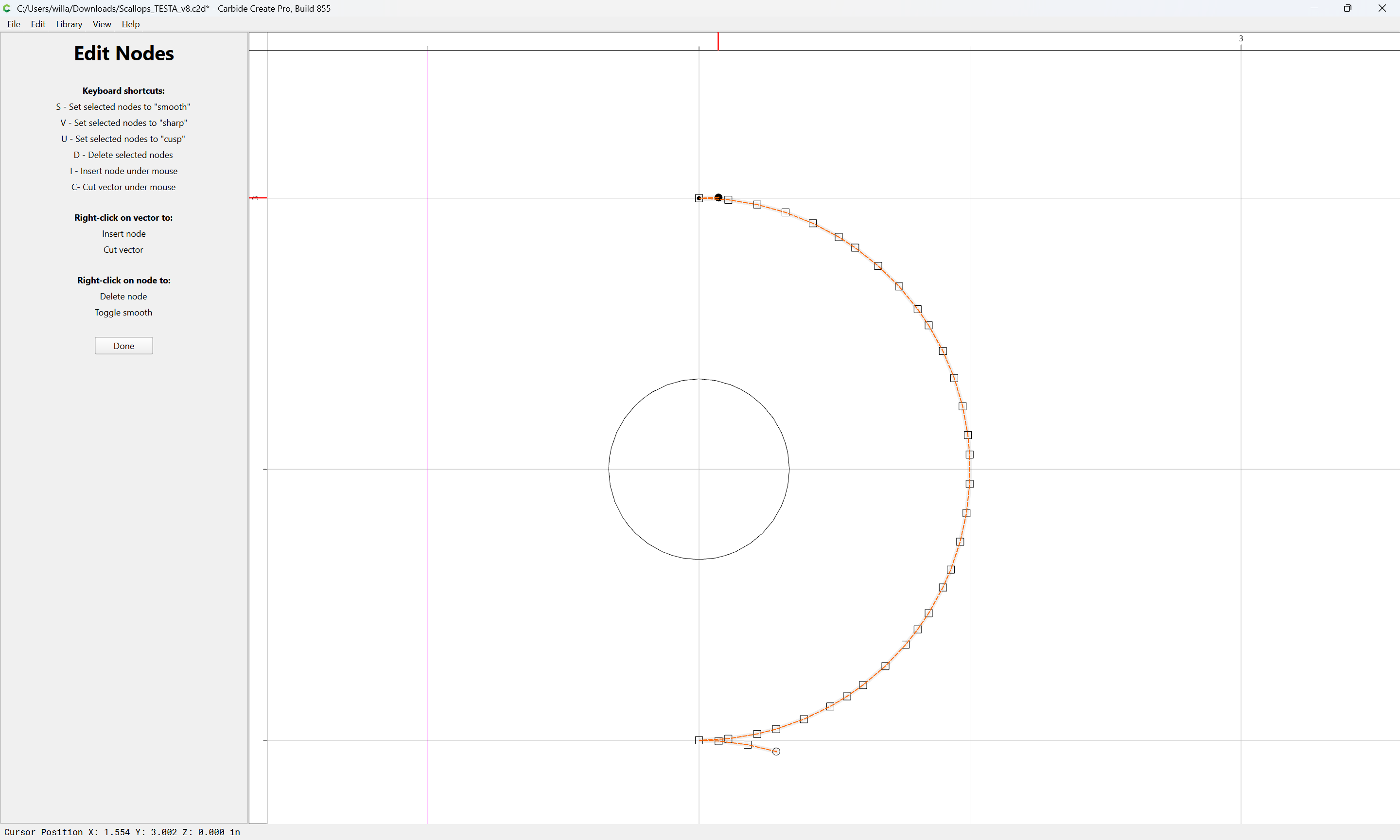

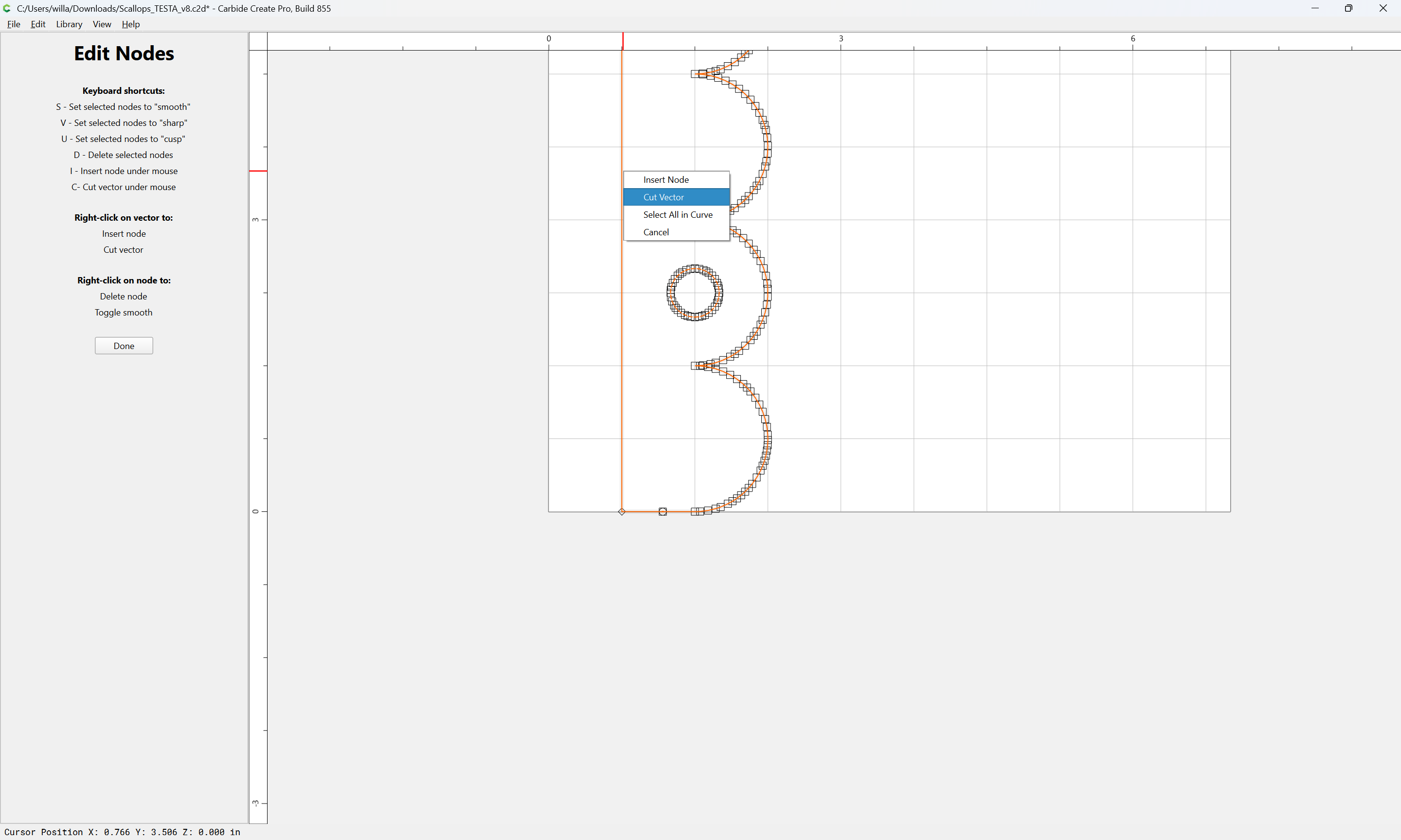

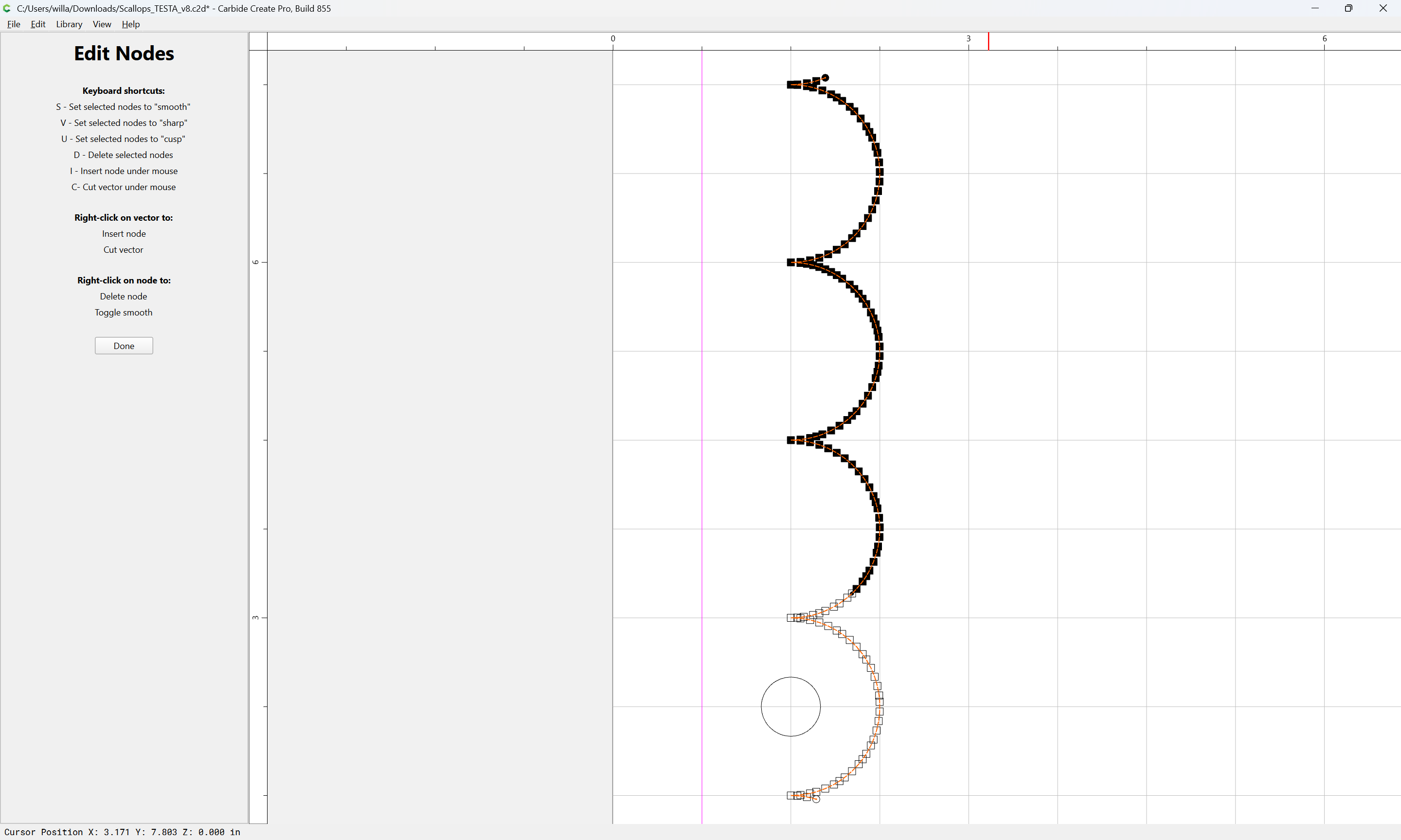

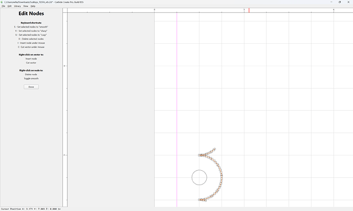

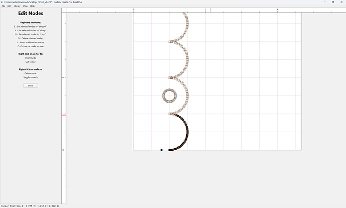

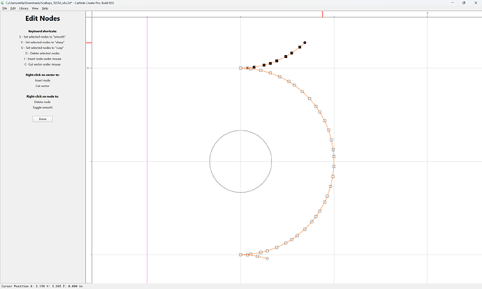

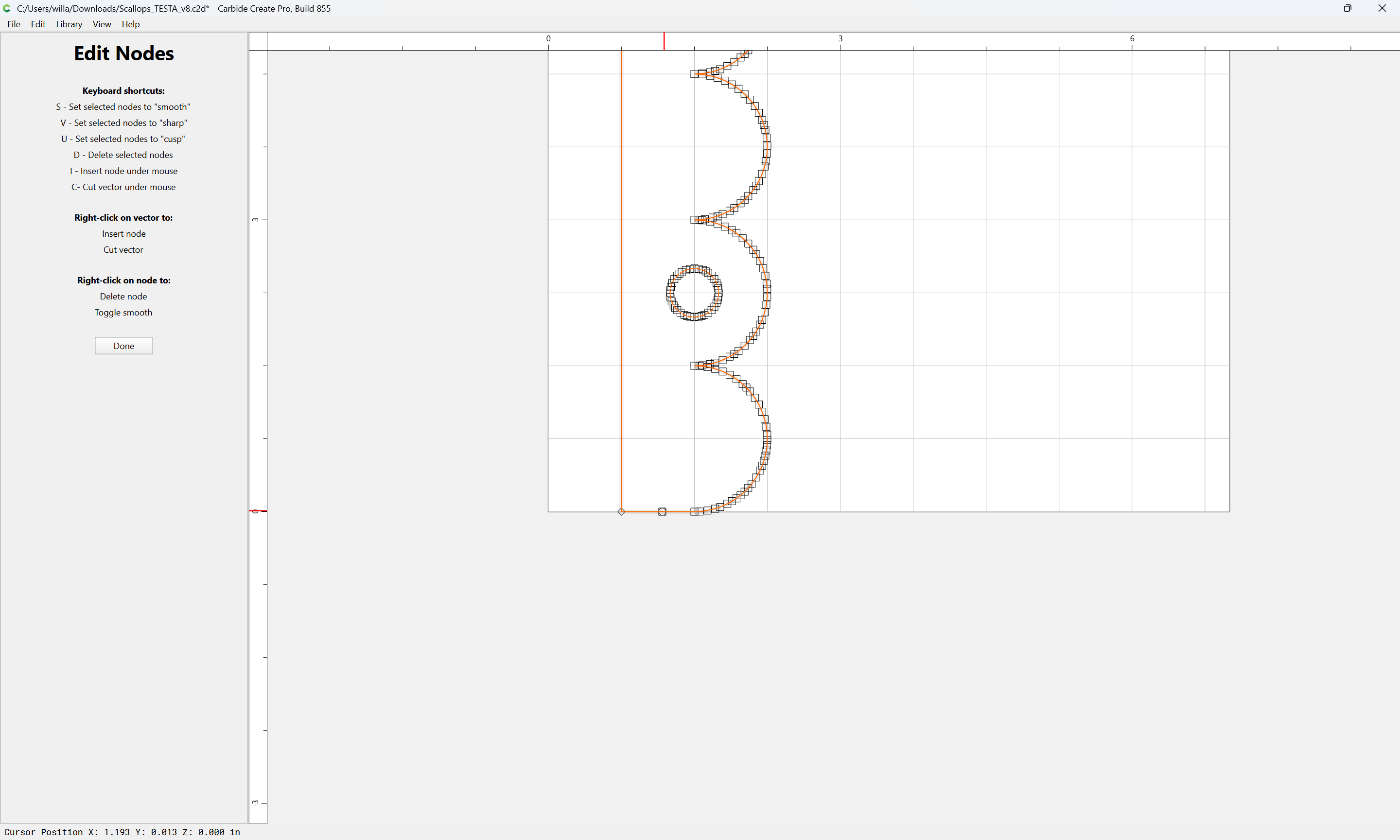

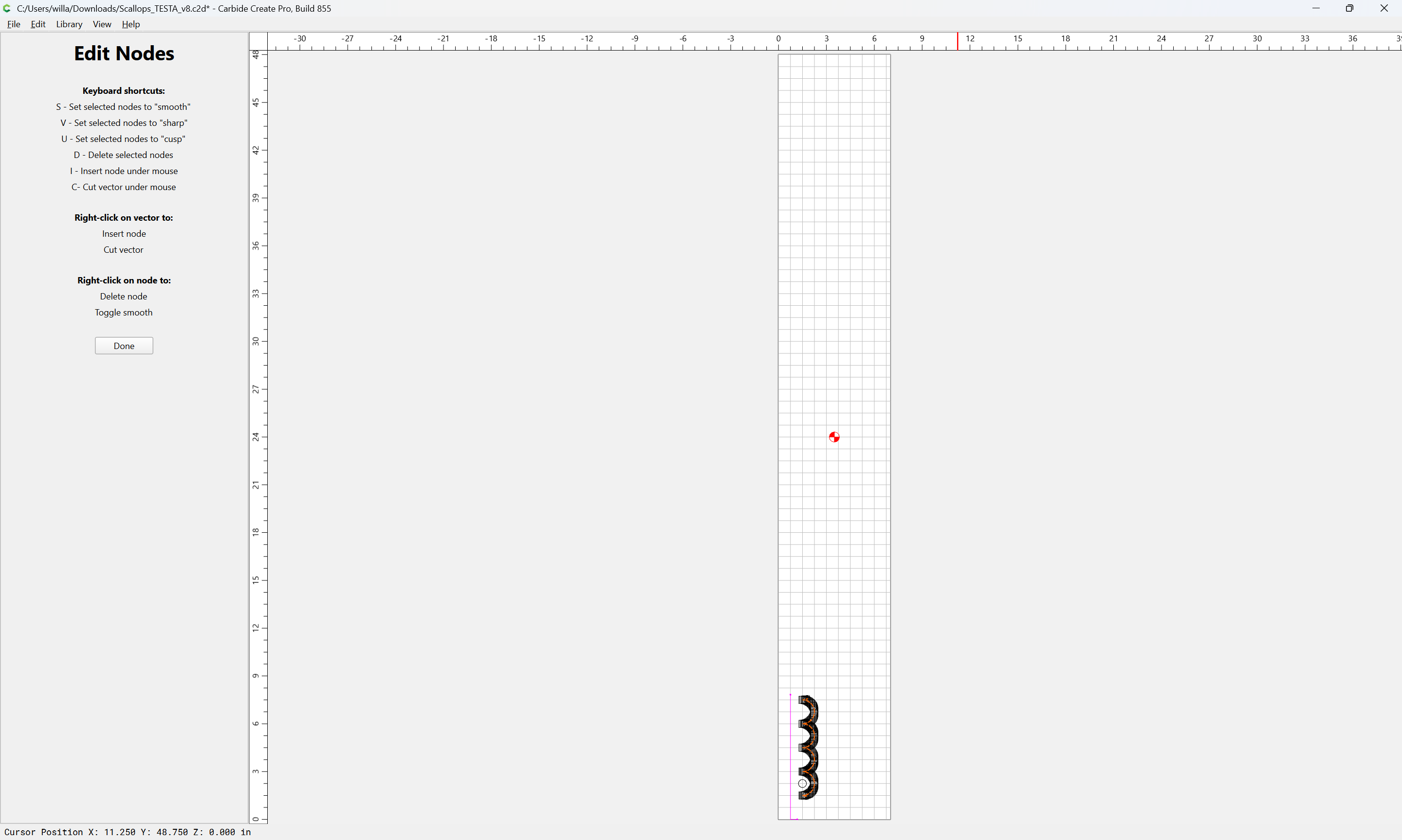

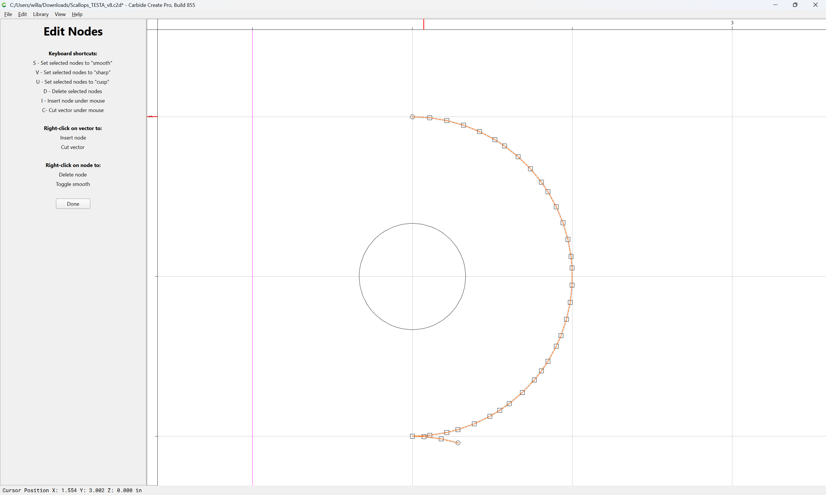

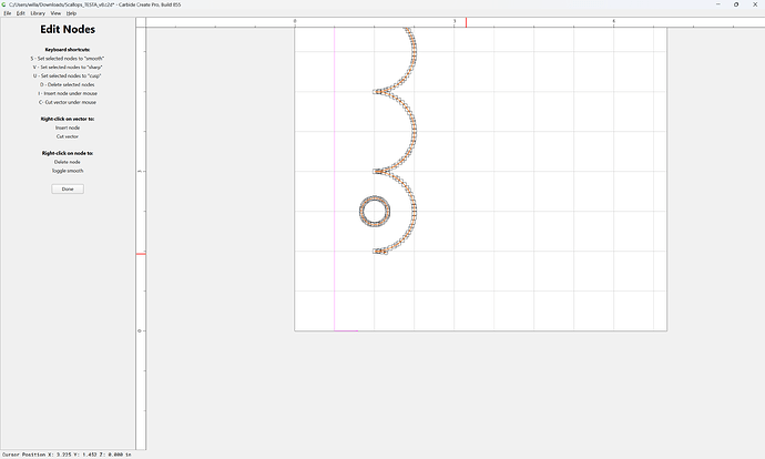

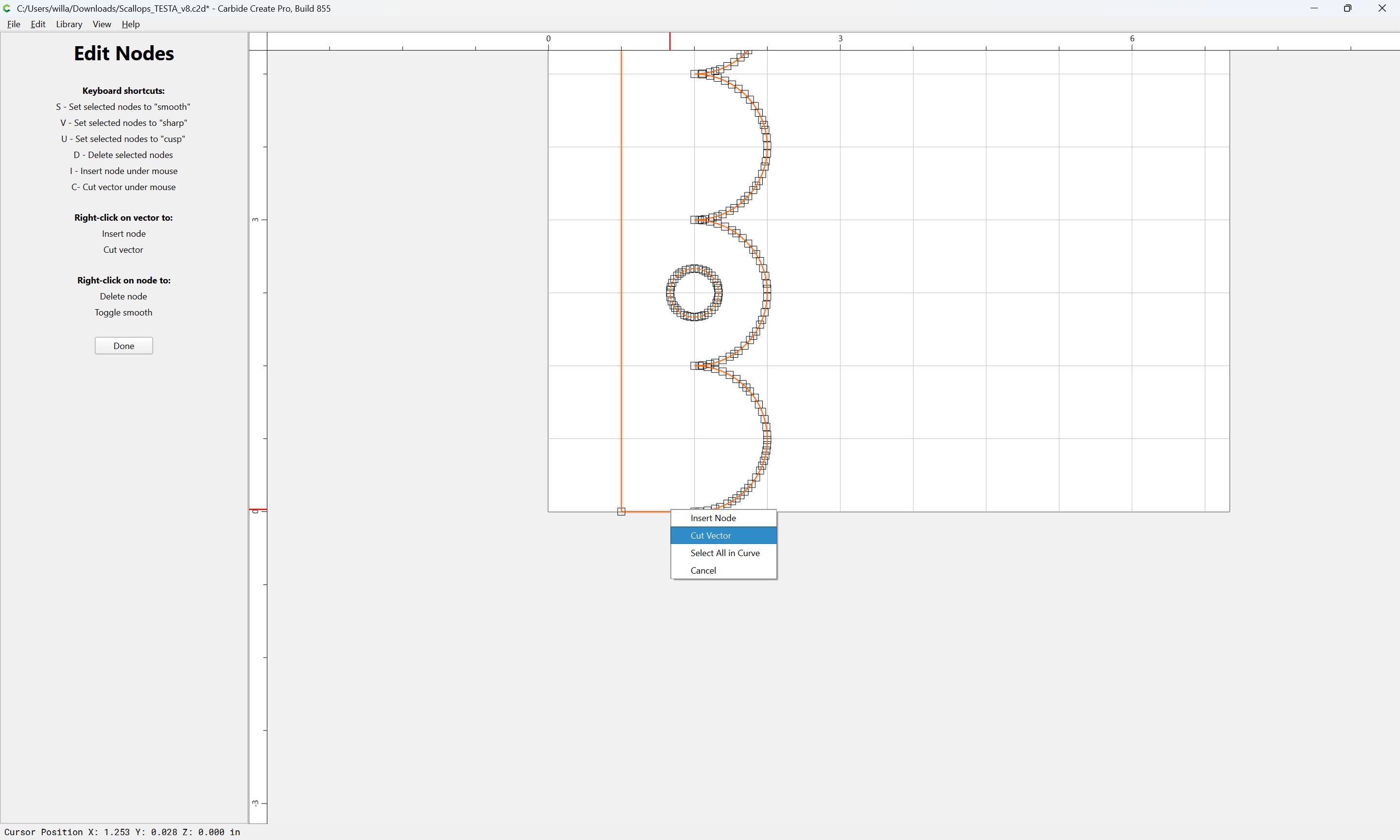

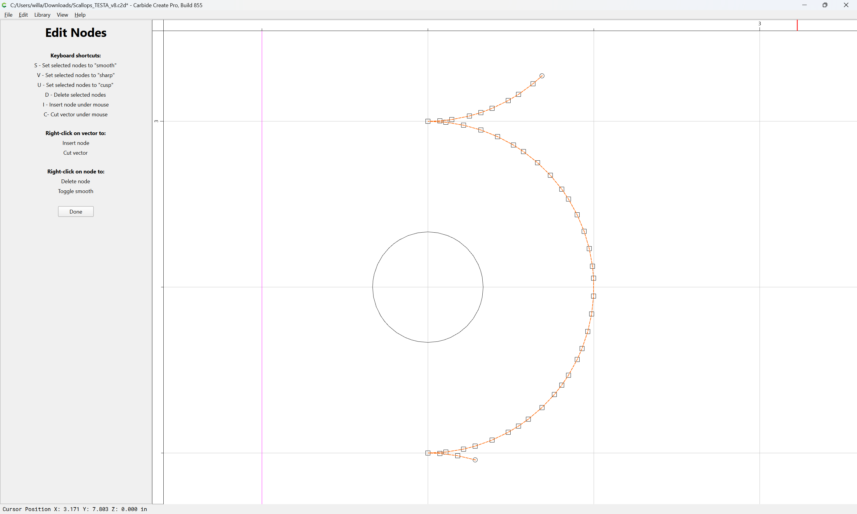

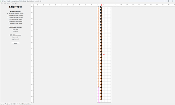

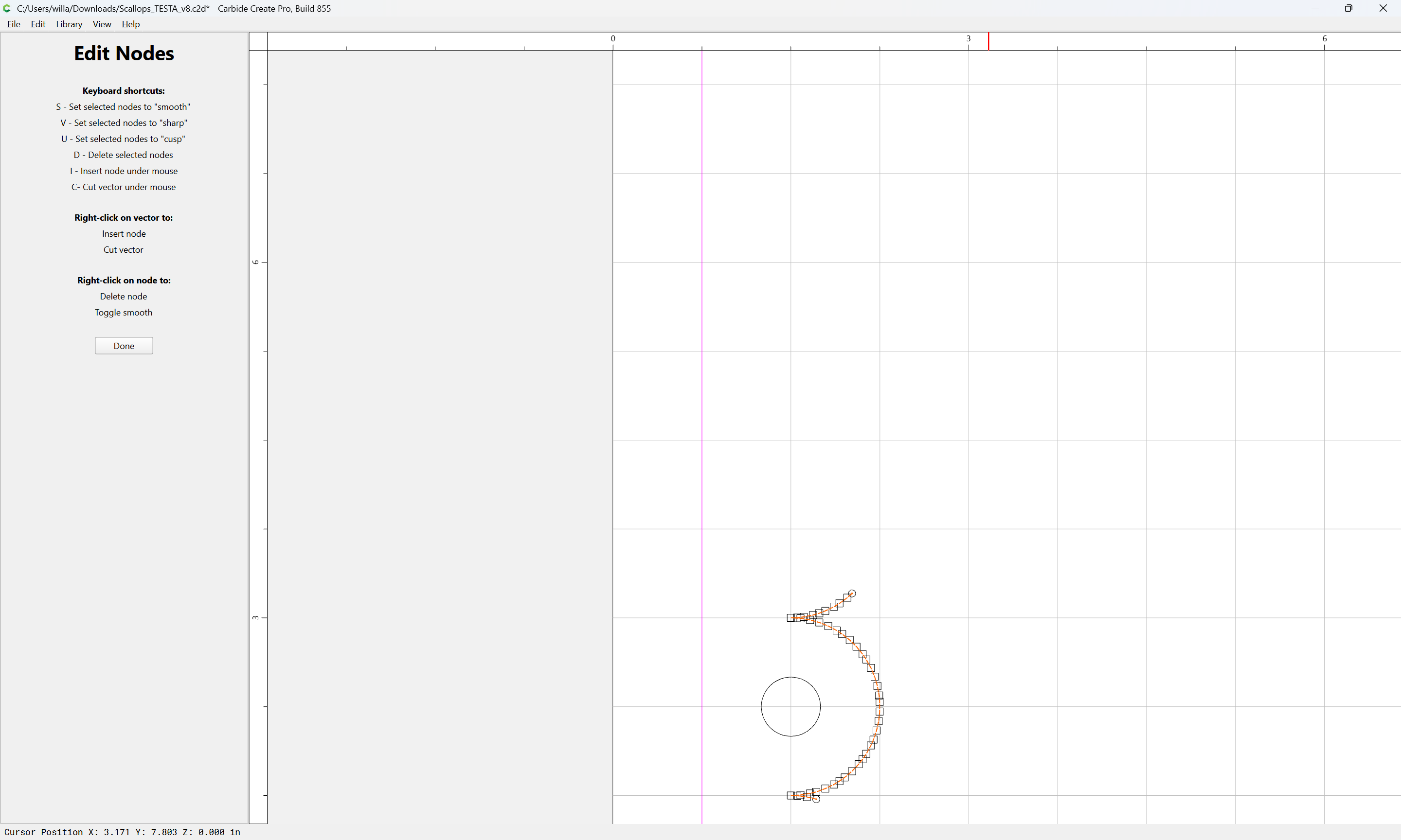

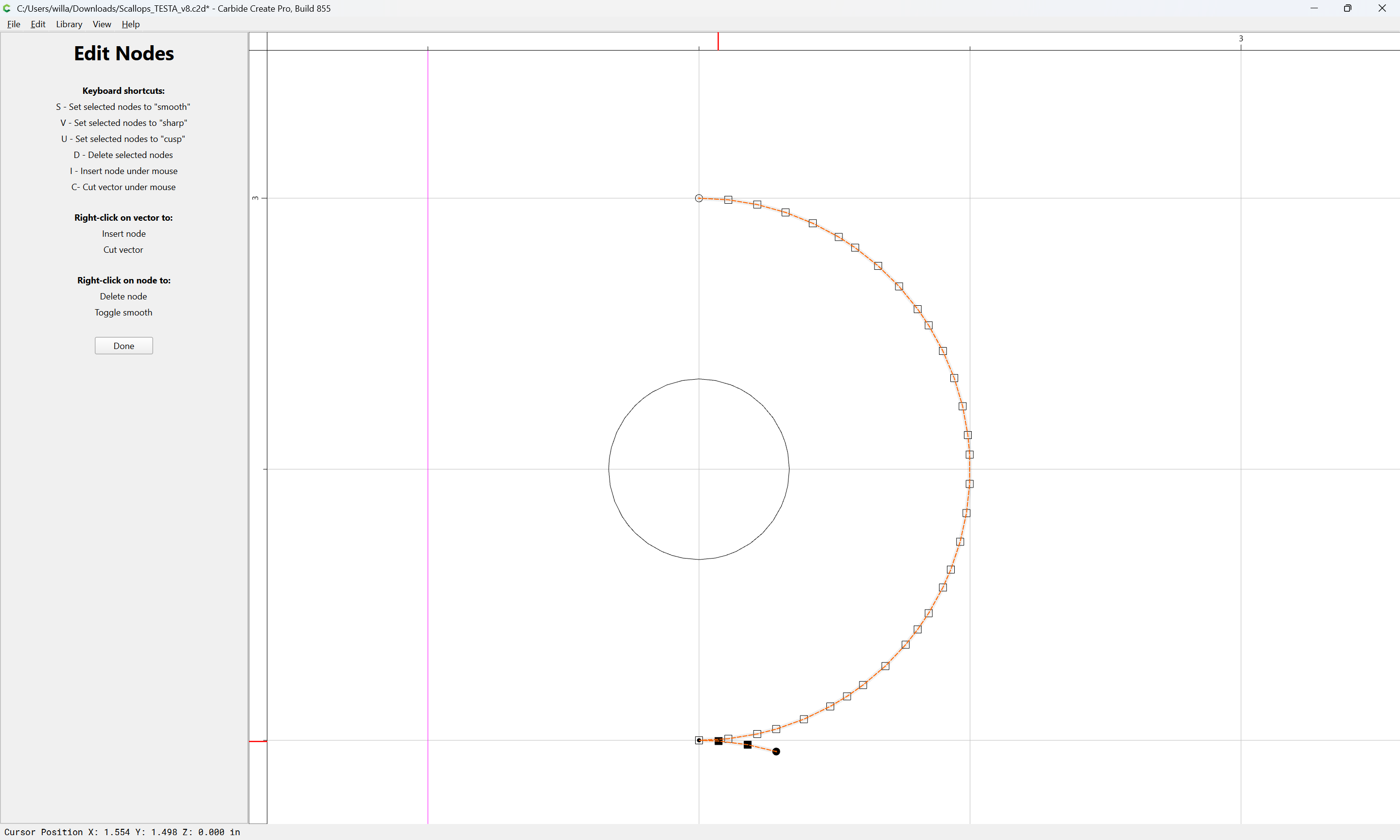

Then go into Node Edit mode:
and cut the lines so that one section will be isolated:

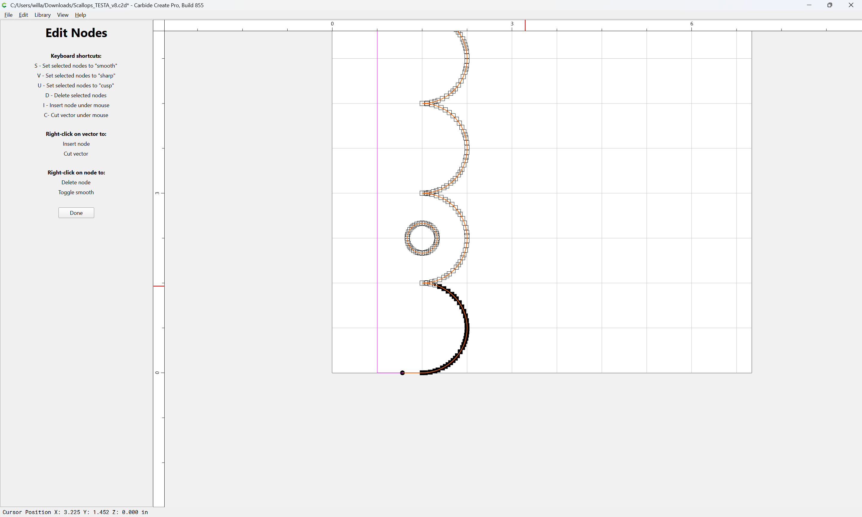

Then delete all but one curve:
d
ctrl f
ctrl f
d
d
d
Done

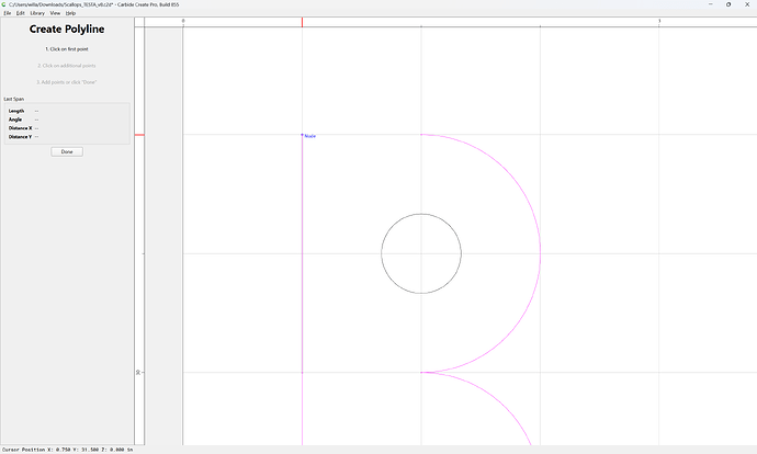

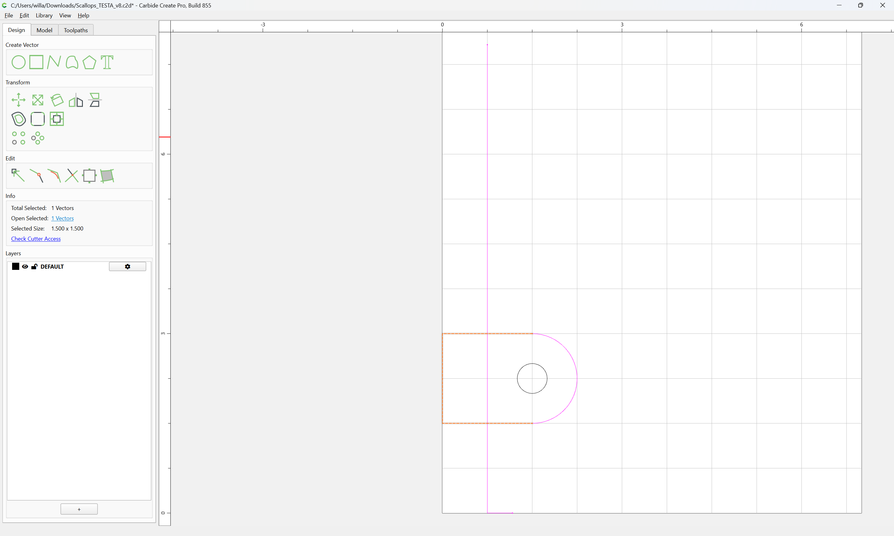

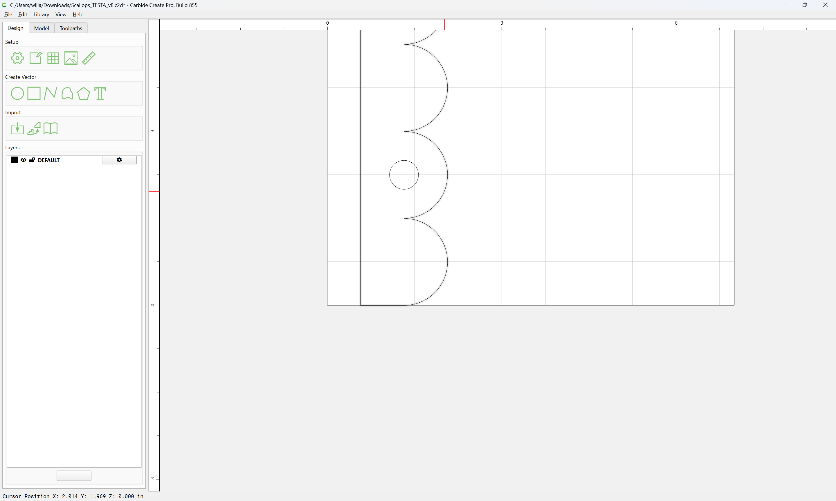

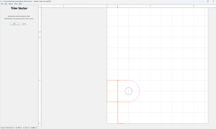

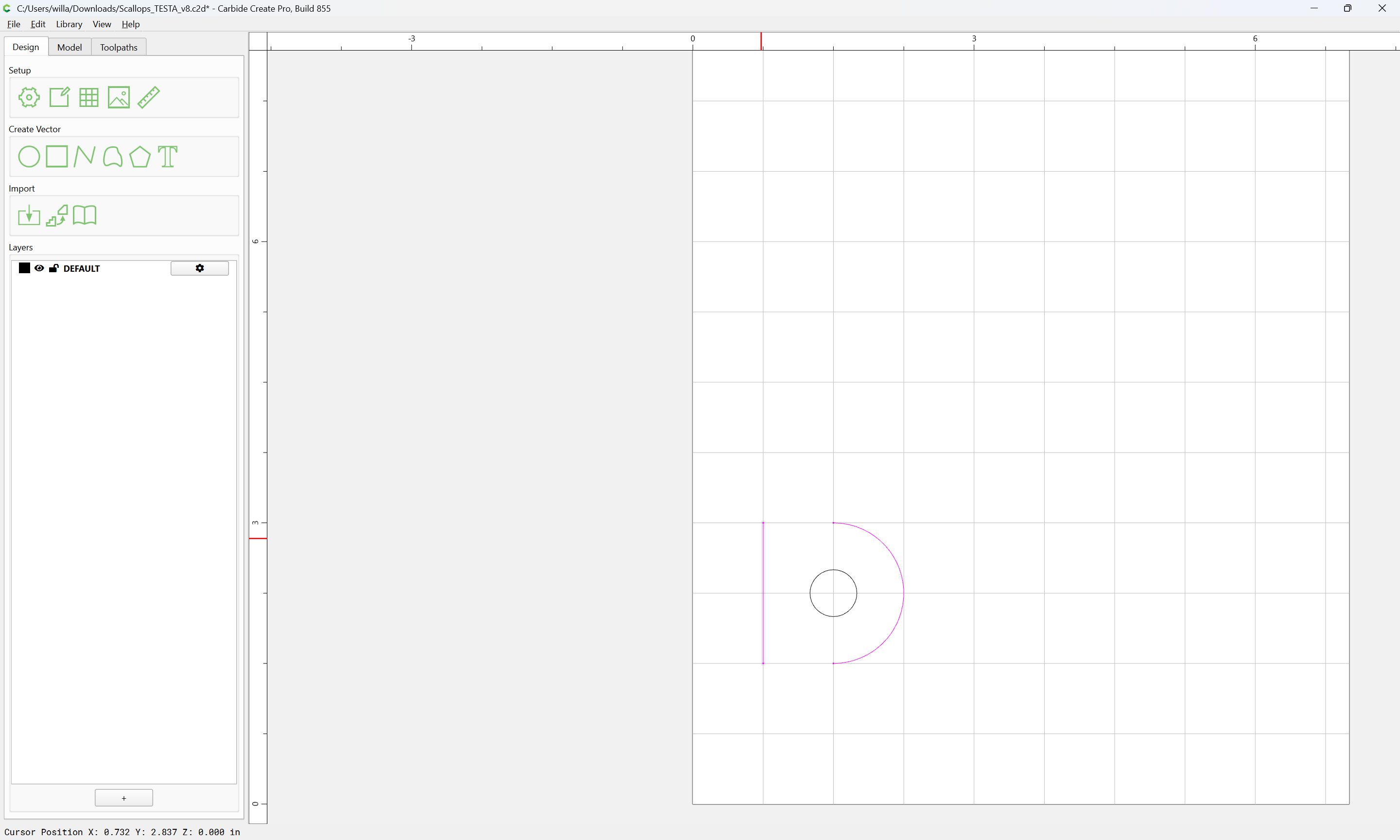

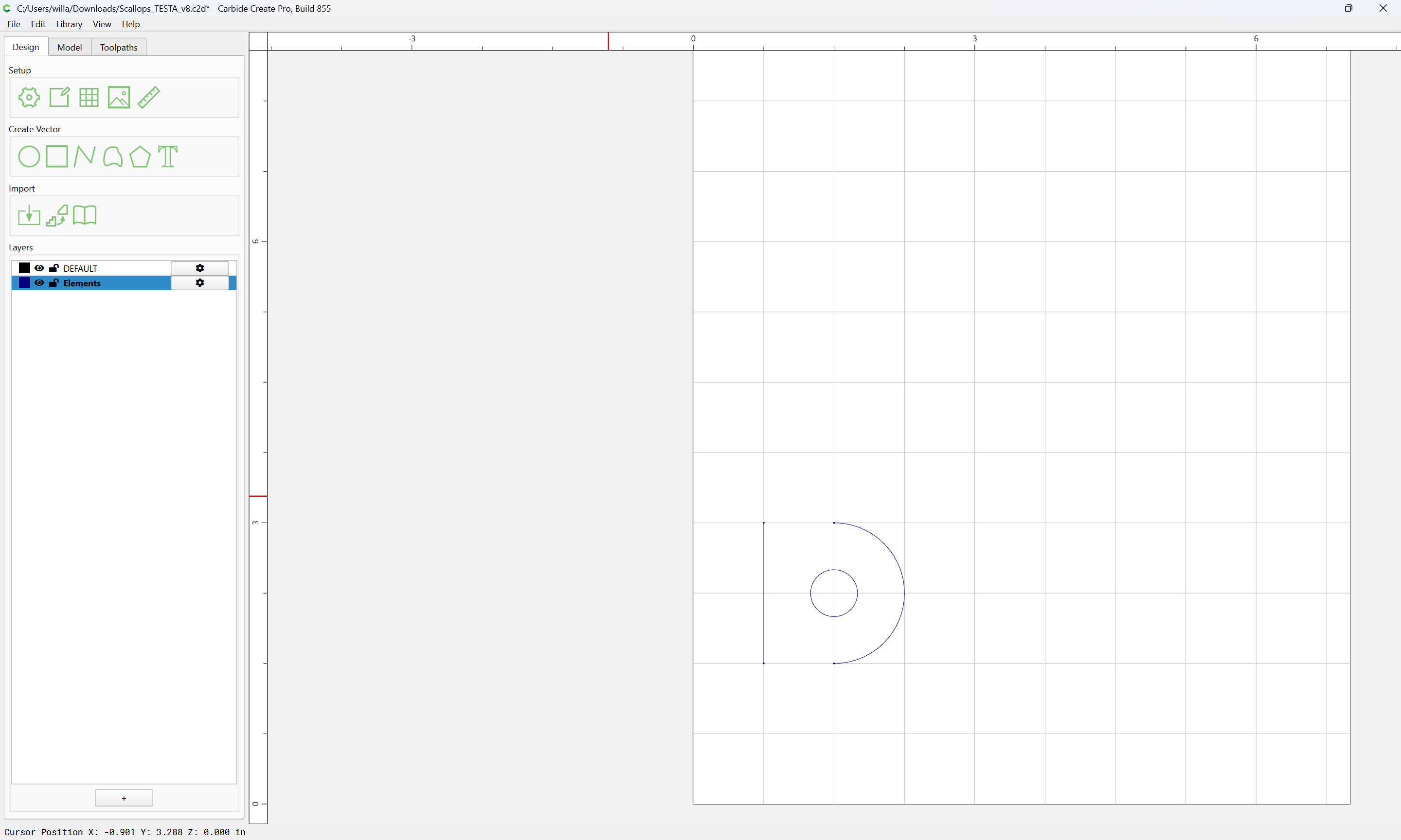

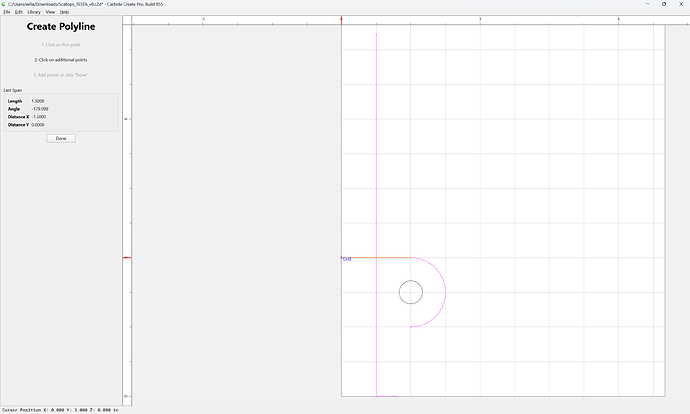

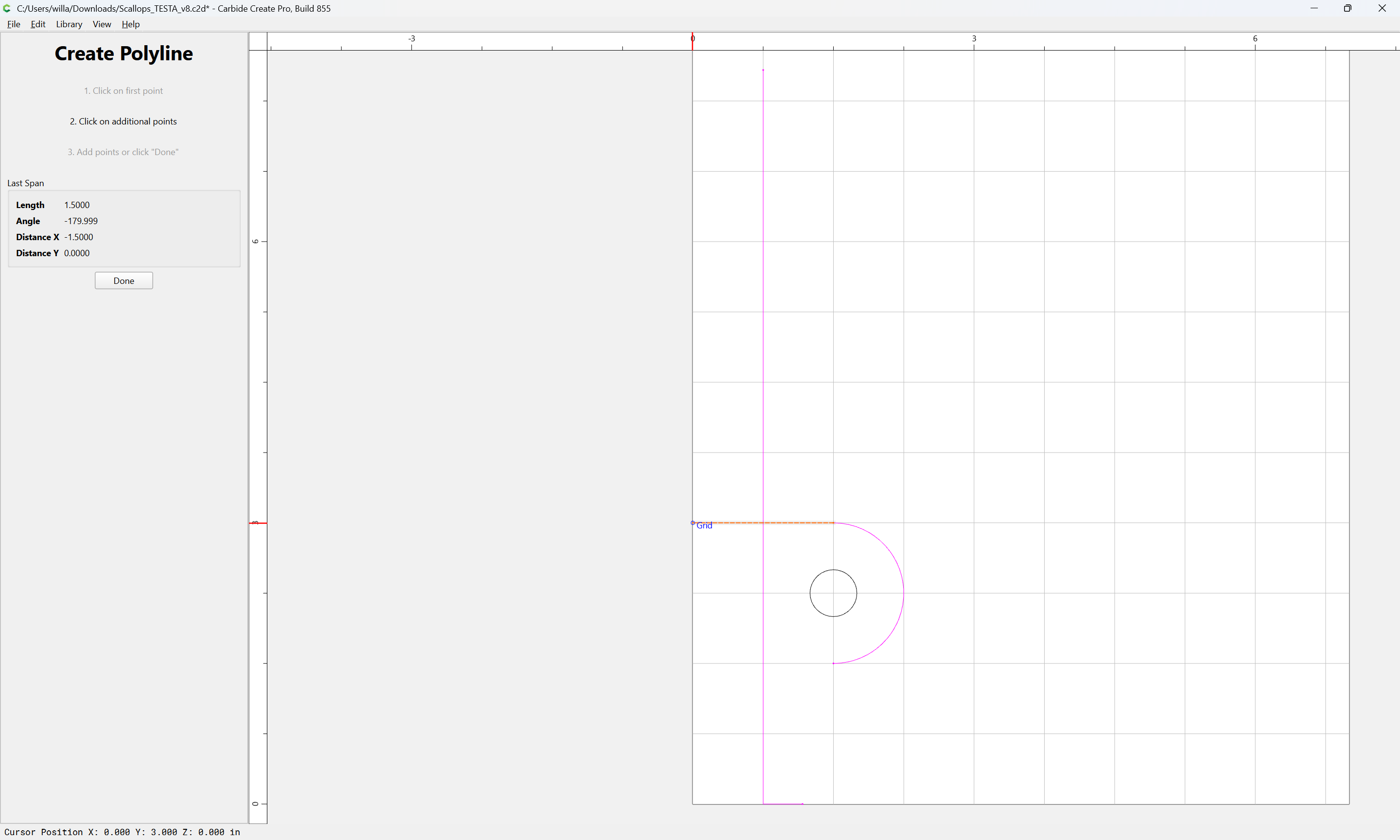

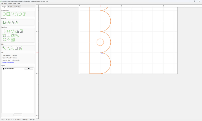

Draw in geometry to define the length of the line on the left using the Grid:
Done

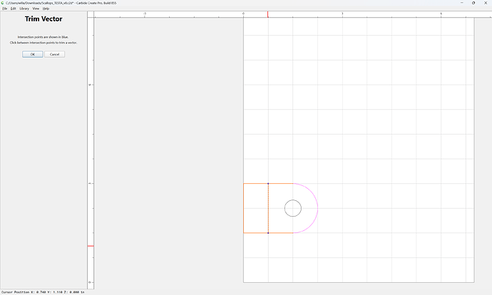

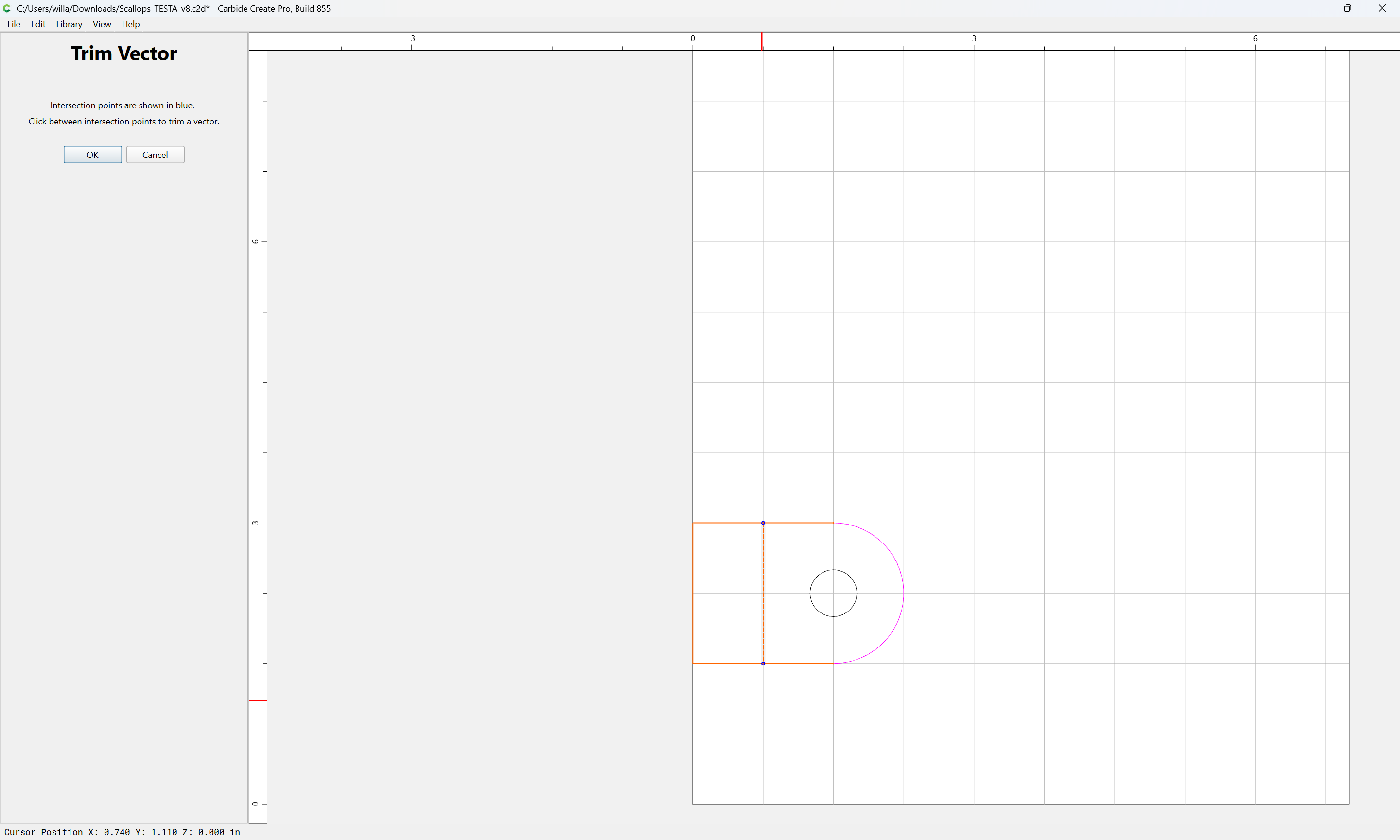

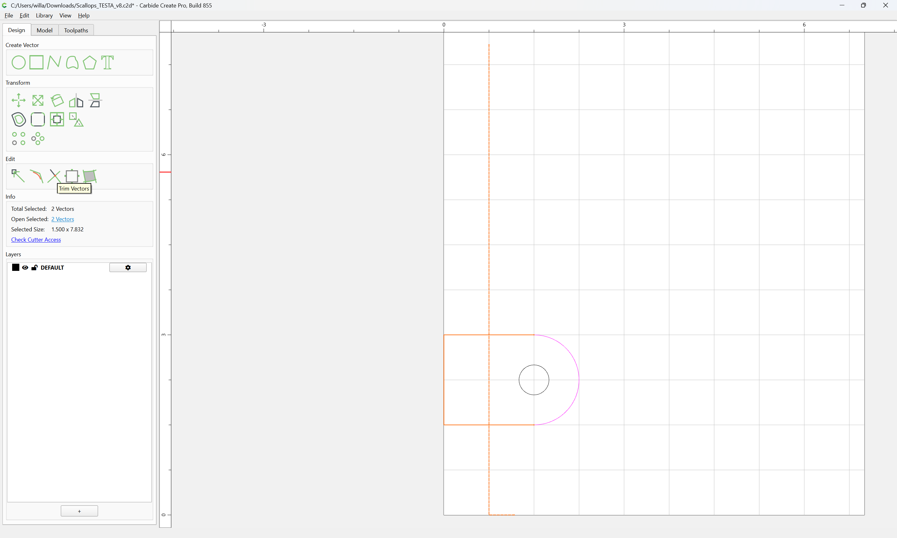

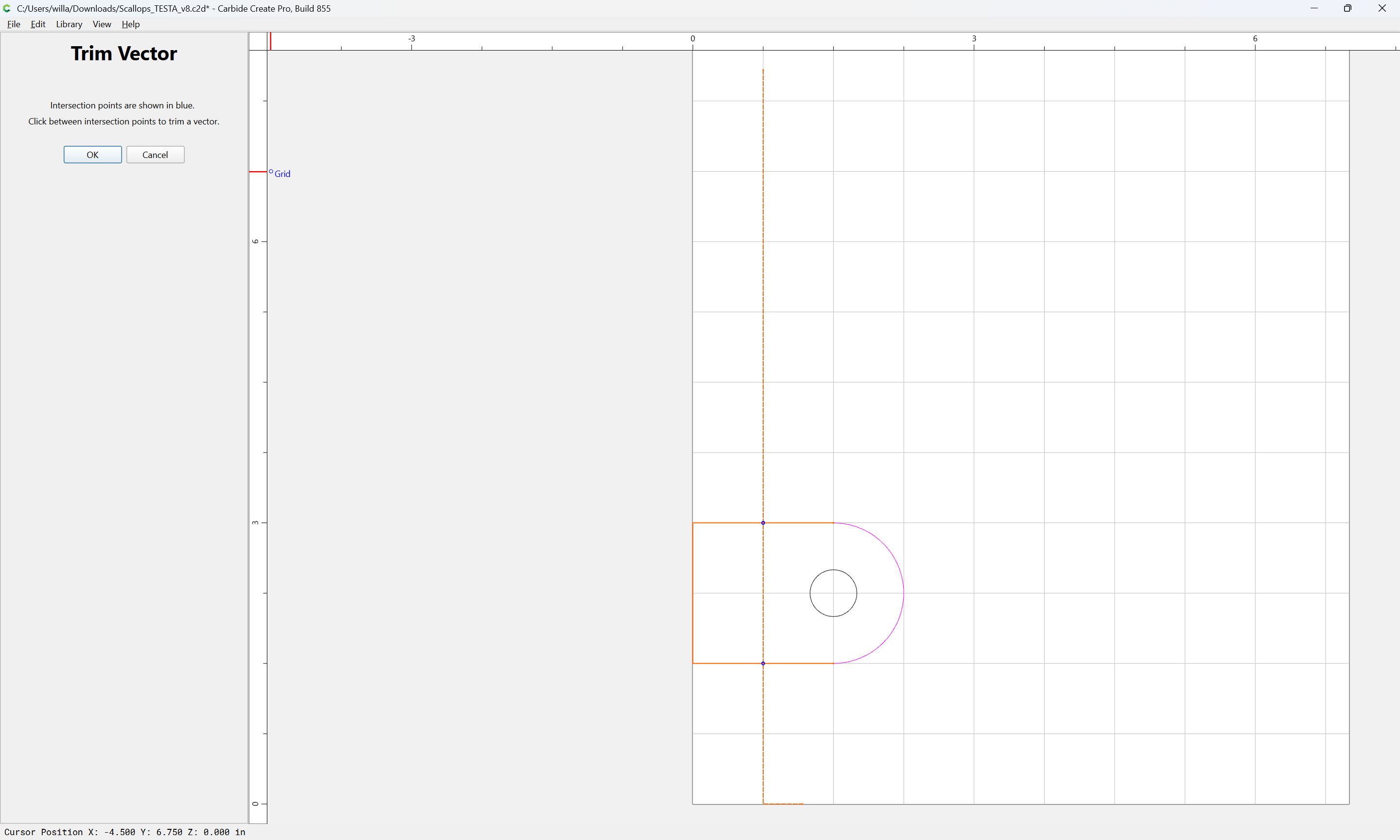

Then select the geometry:
and use Trim Vectors to reduce it to only what is wanted:
OK
Delete the drawn-in geometry:

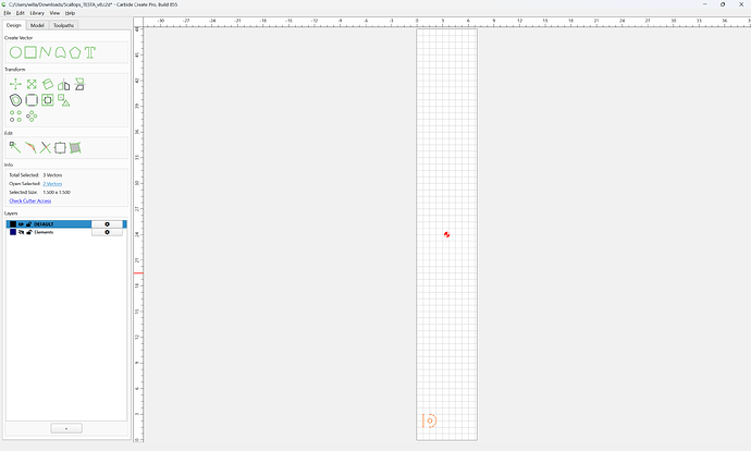

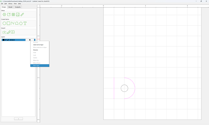

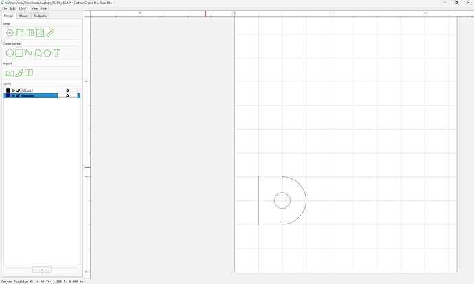

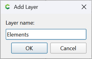

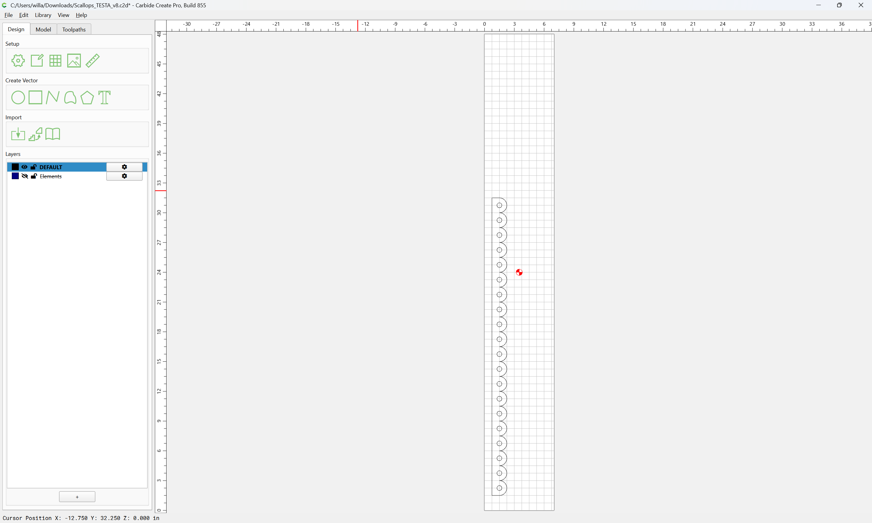

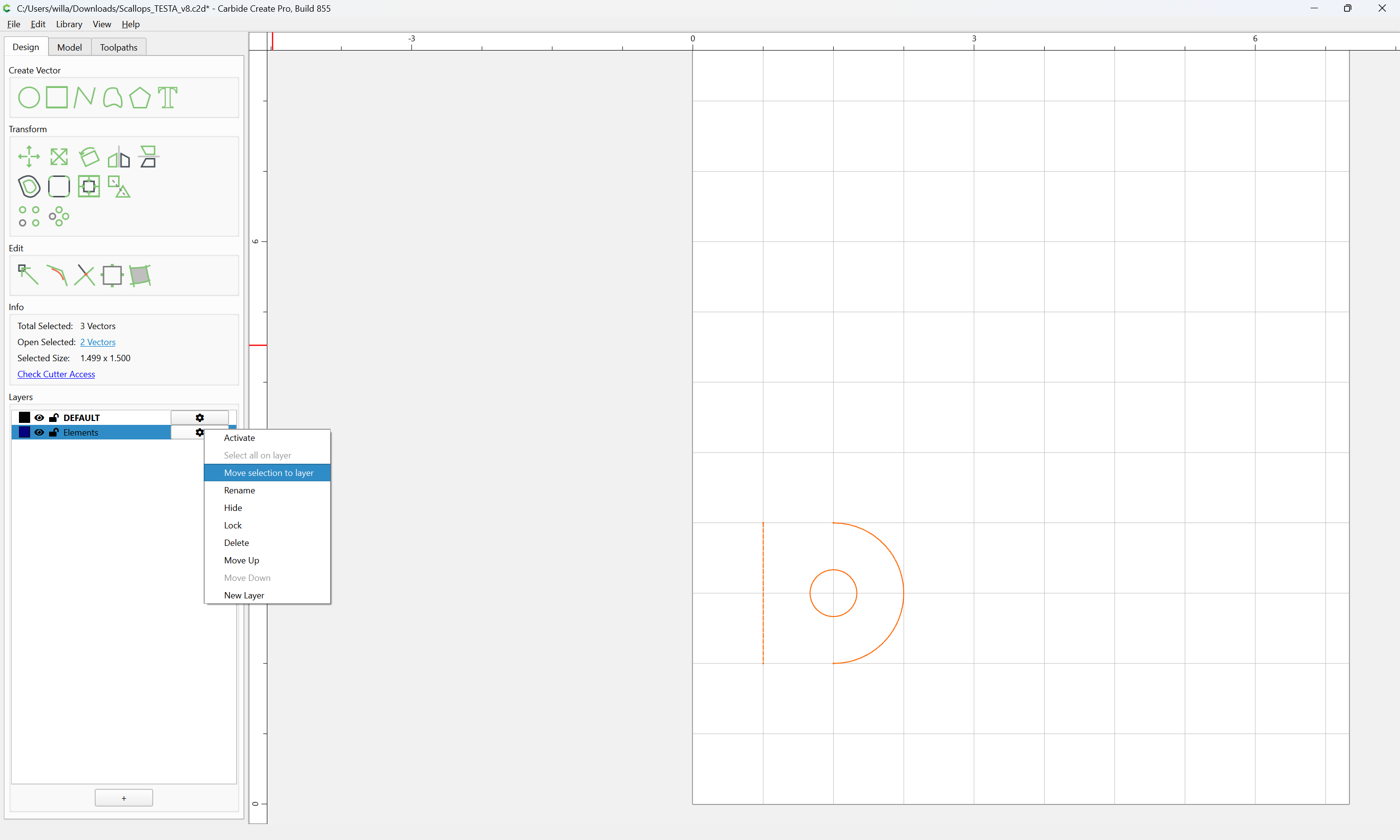

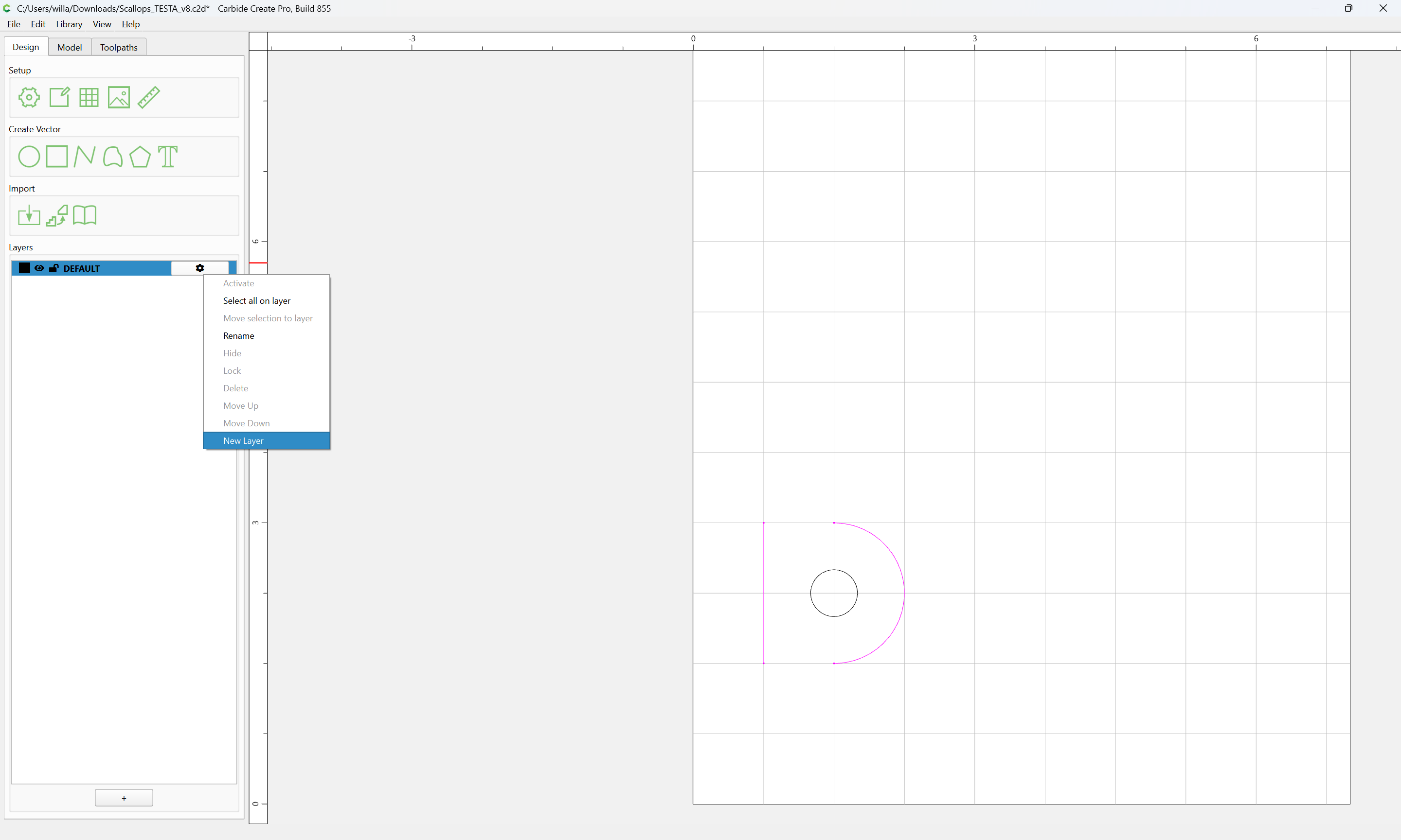

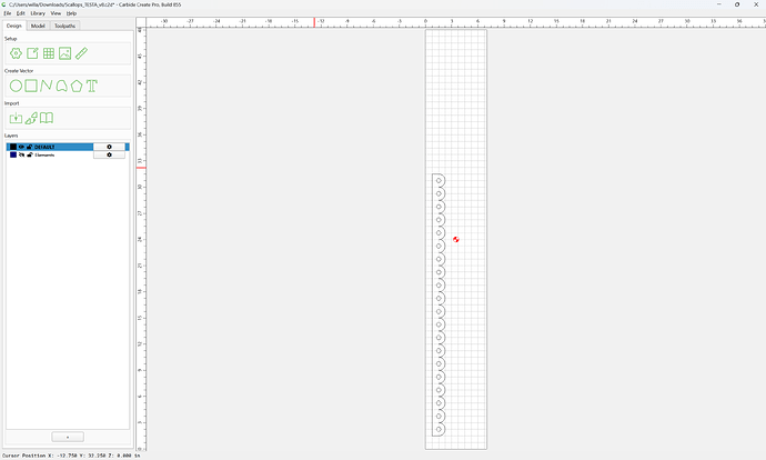

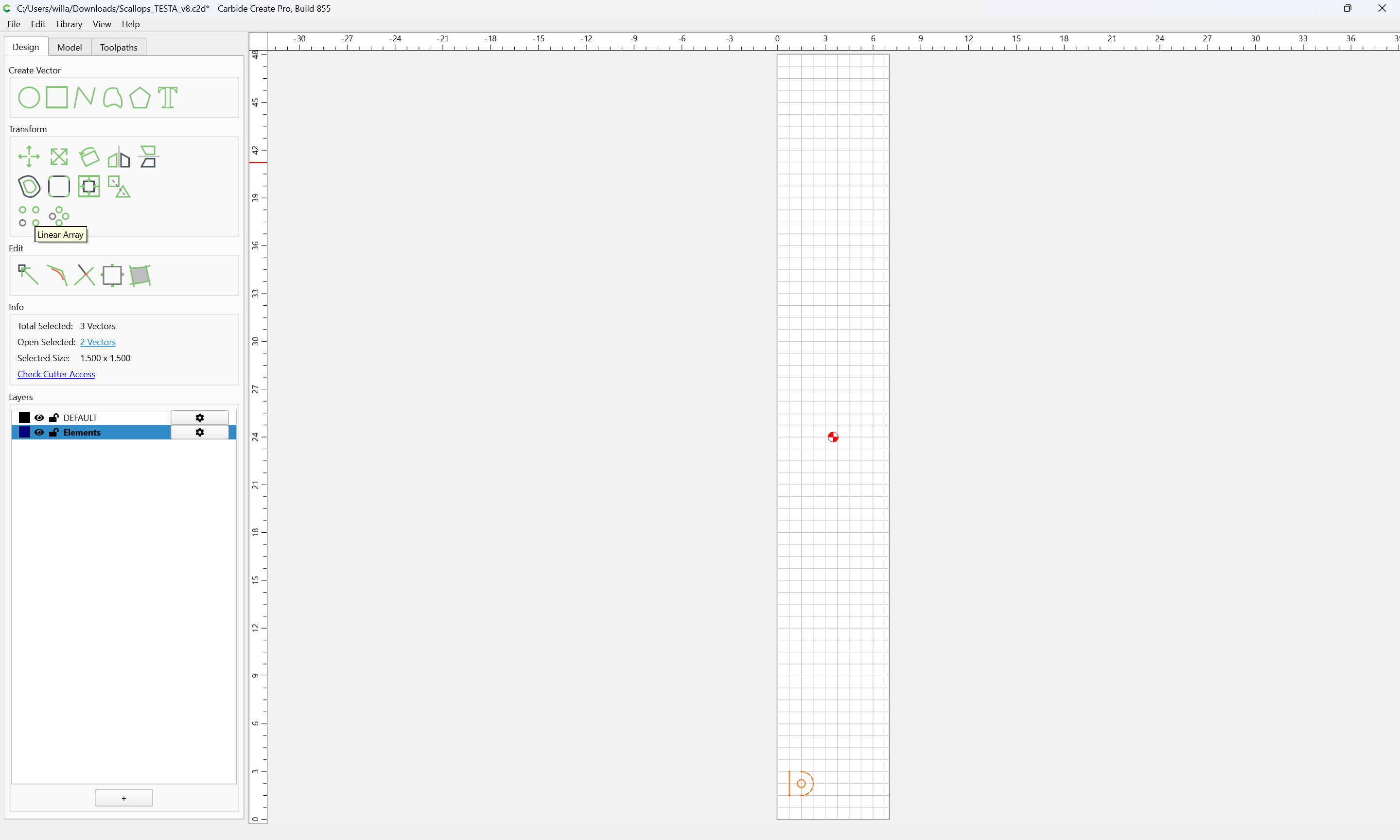

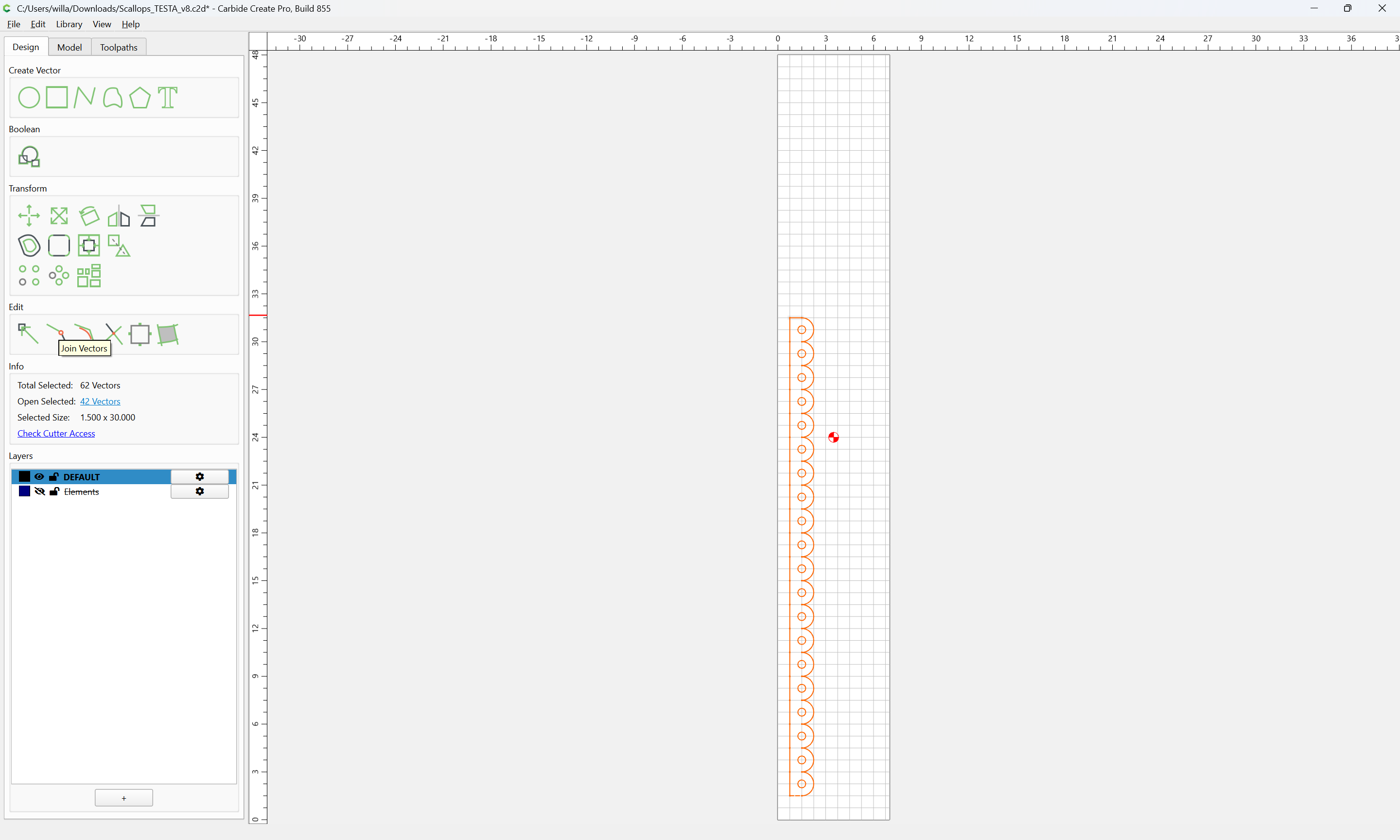

Create a new Layer:
and move everything to that layer:
Then, select everything:
copy-paste onto a different layer after double-clicking on it to make it Active:
(we will use Default)
Hide the Elements layer (against future use)

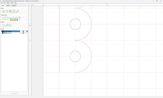

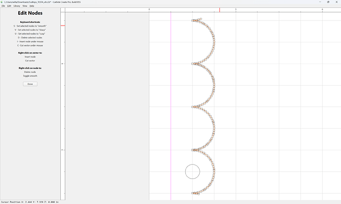

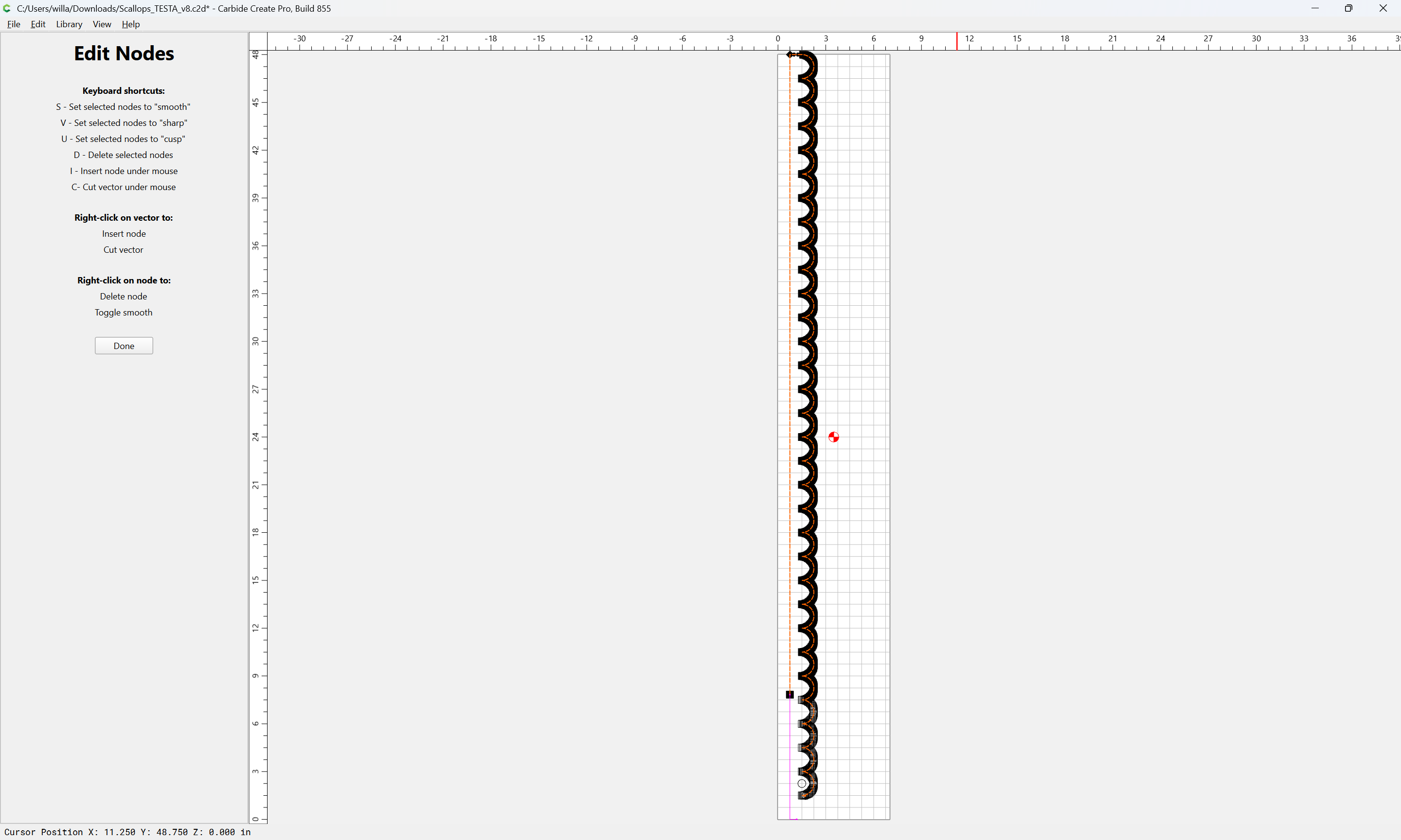

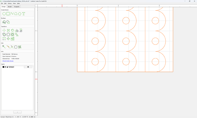

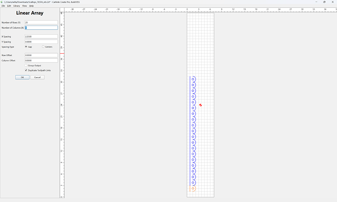

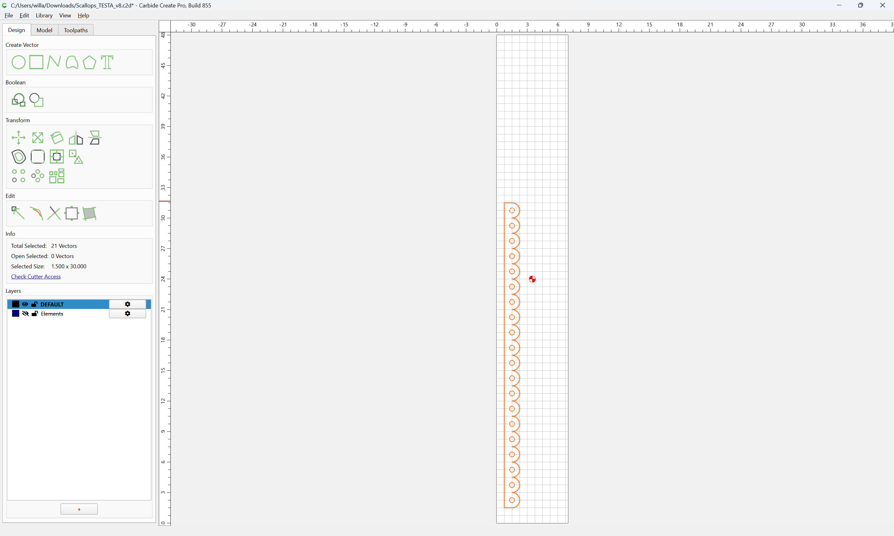

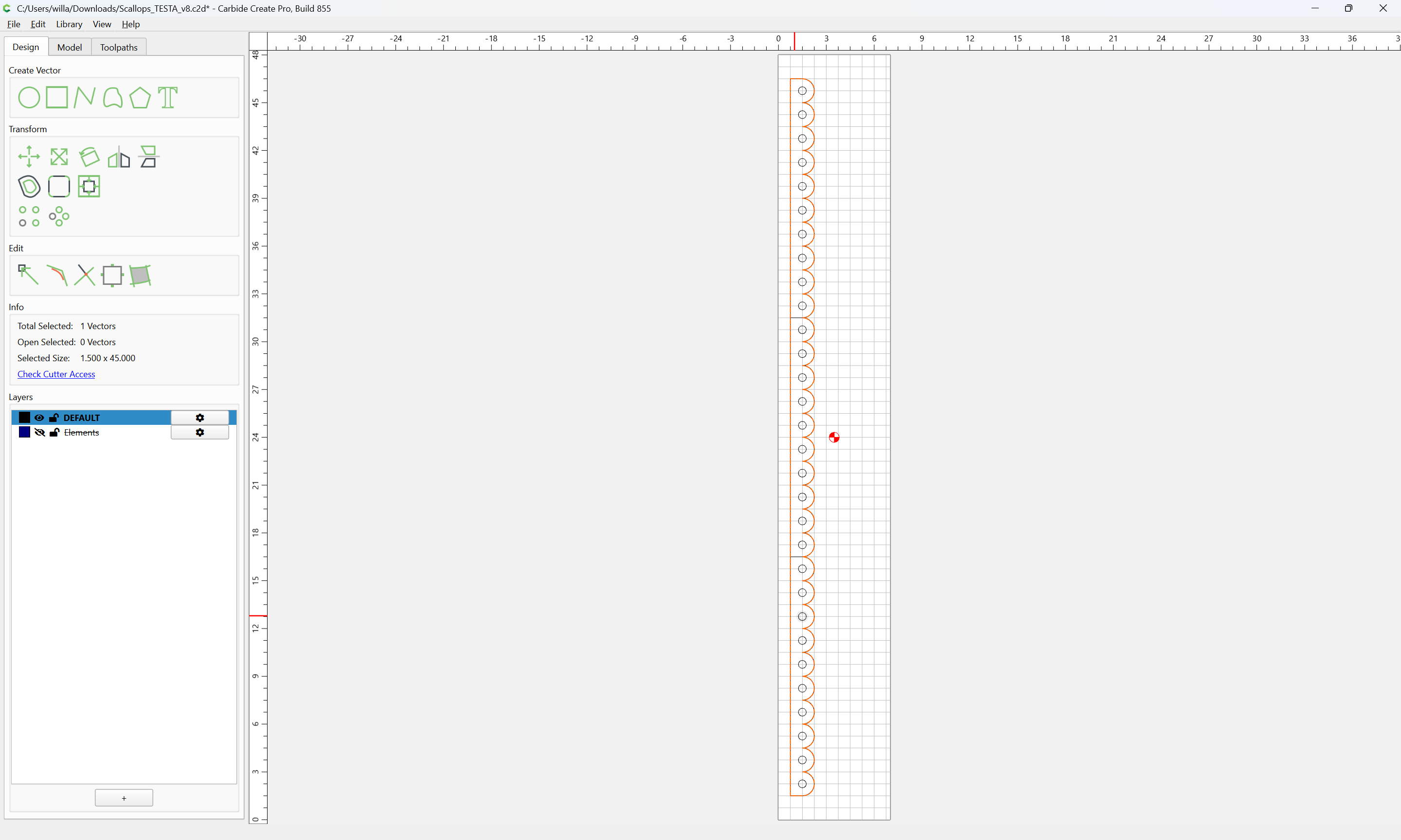

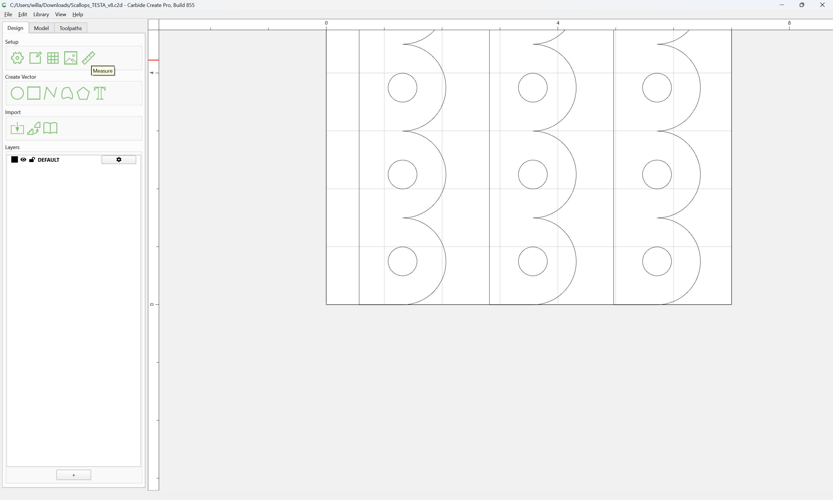

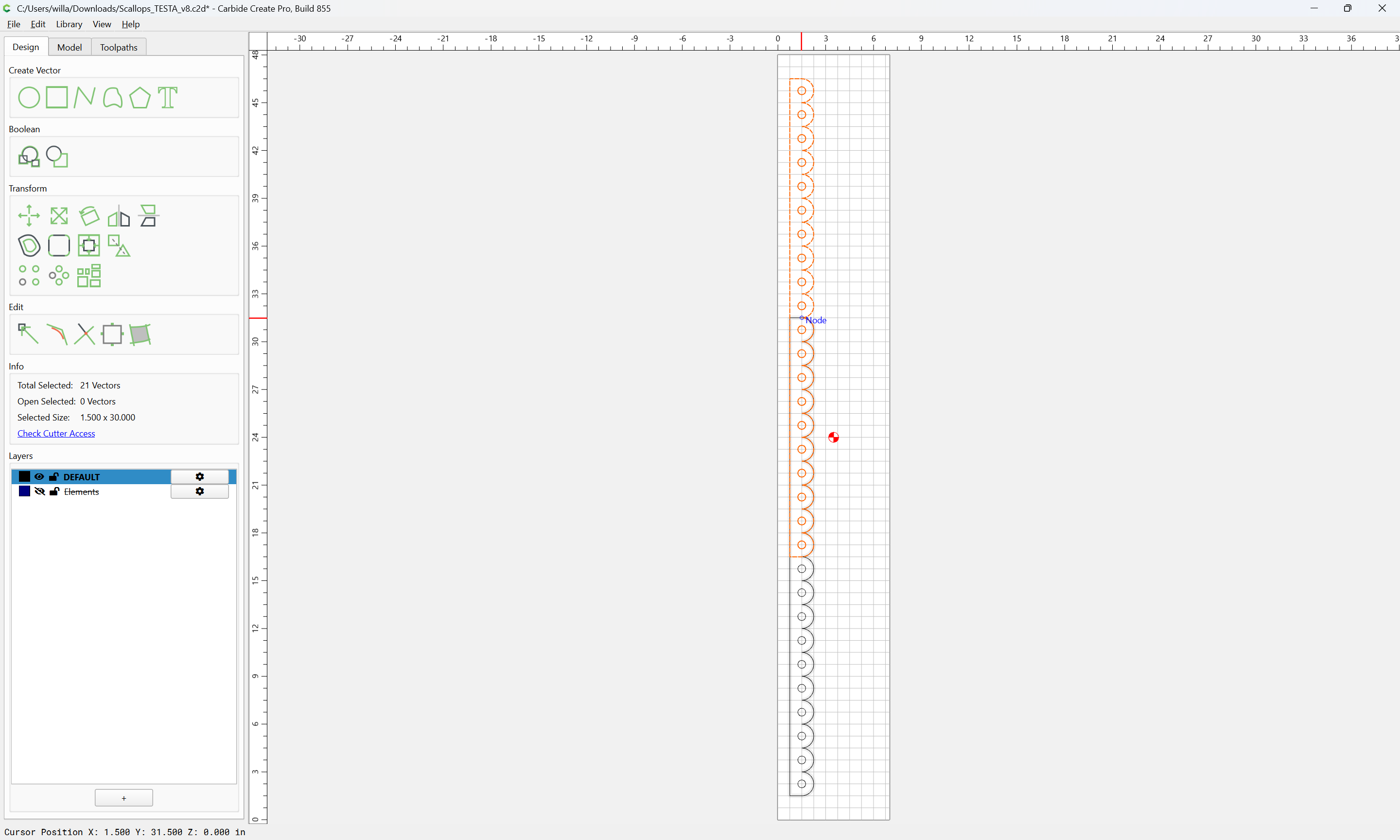

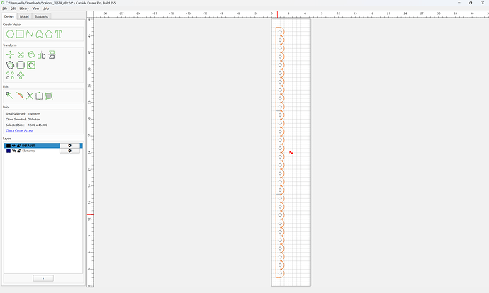

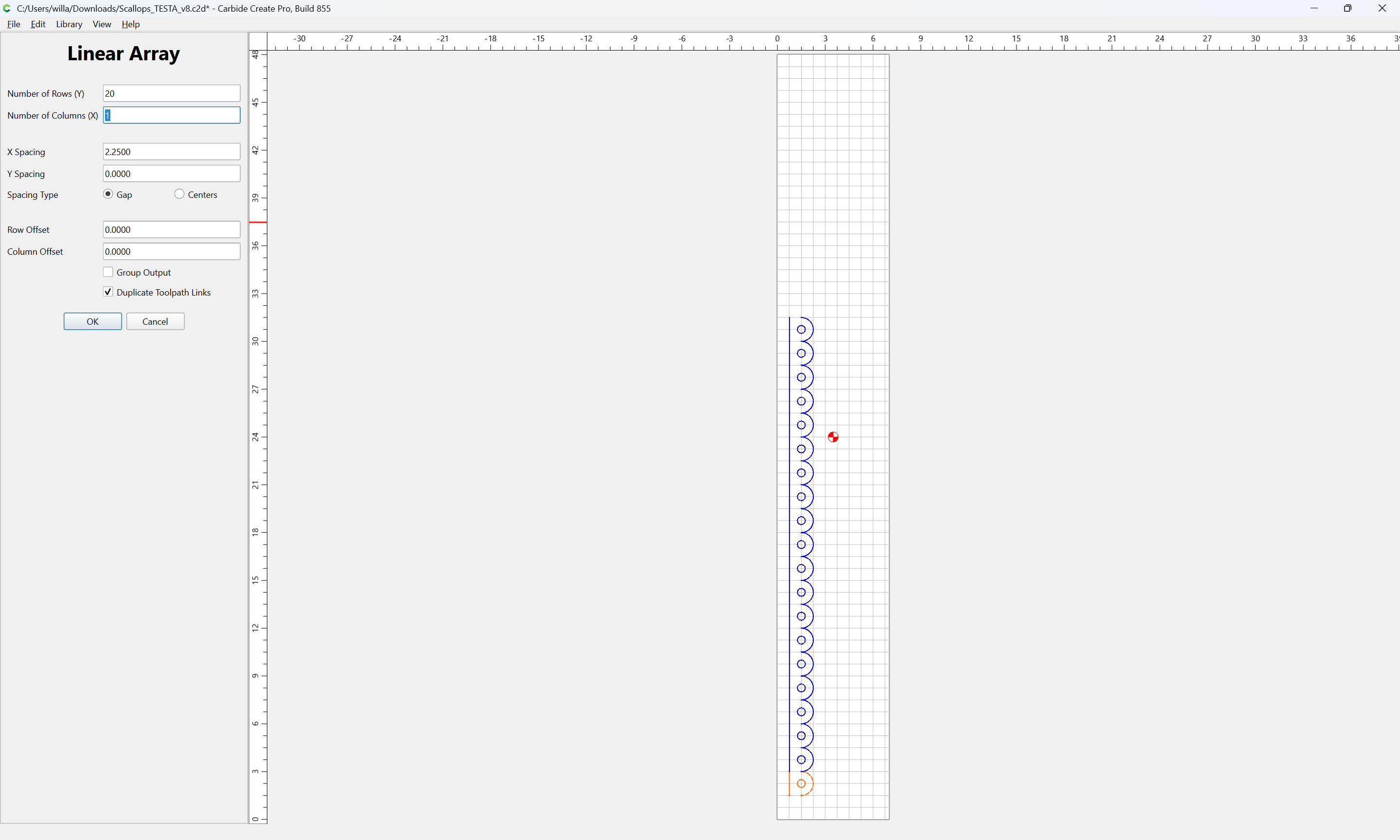

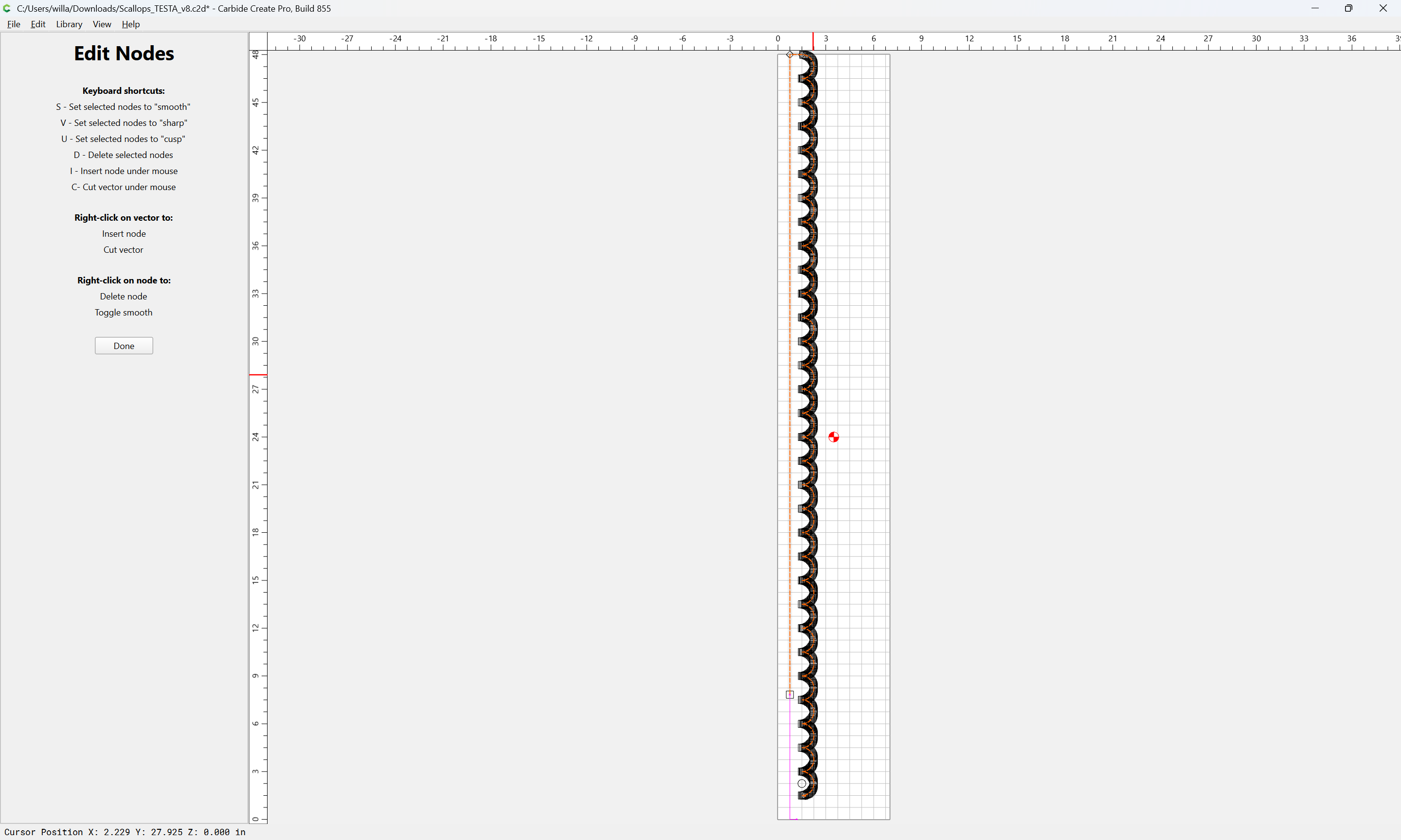

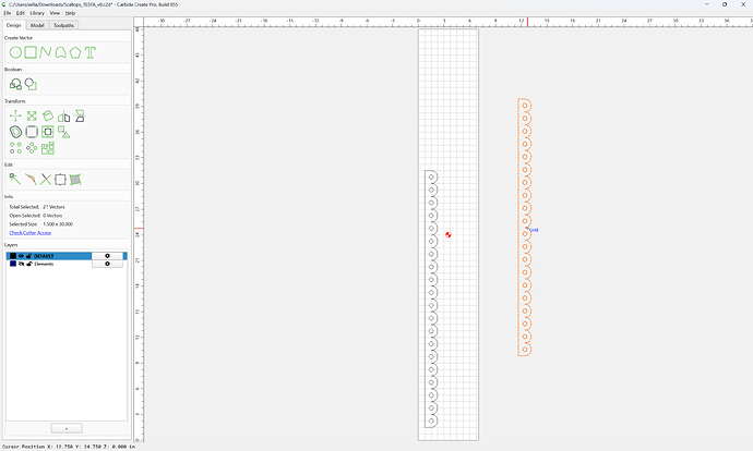

and use the Linear Array command:
to duplicate as many as are desired for a given implementation:

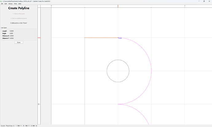

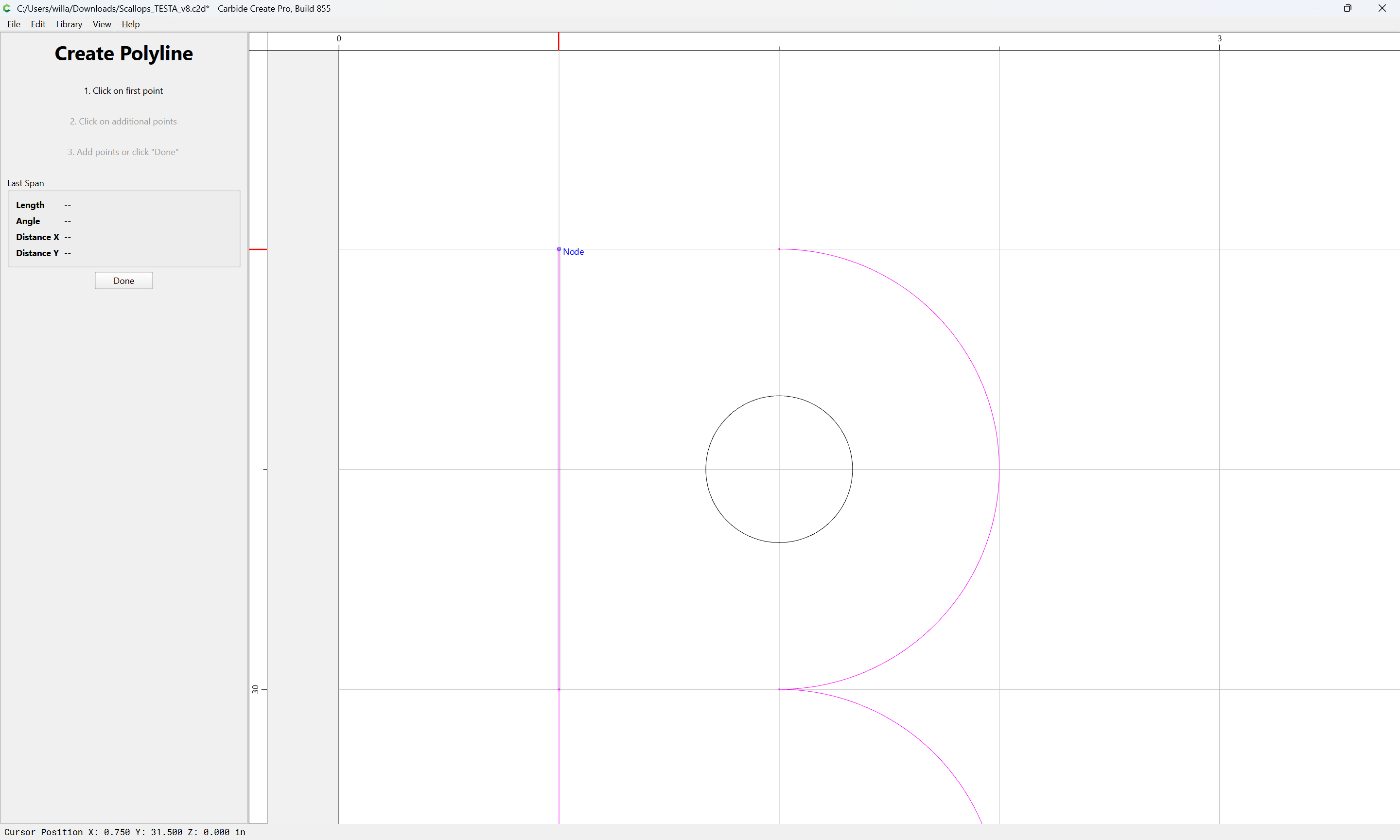

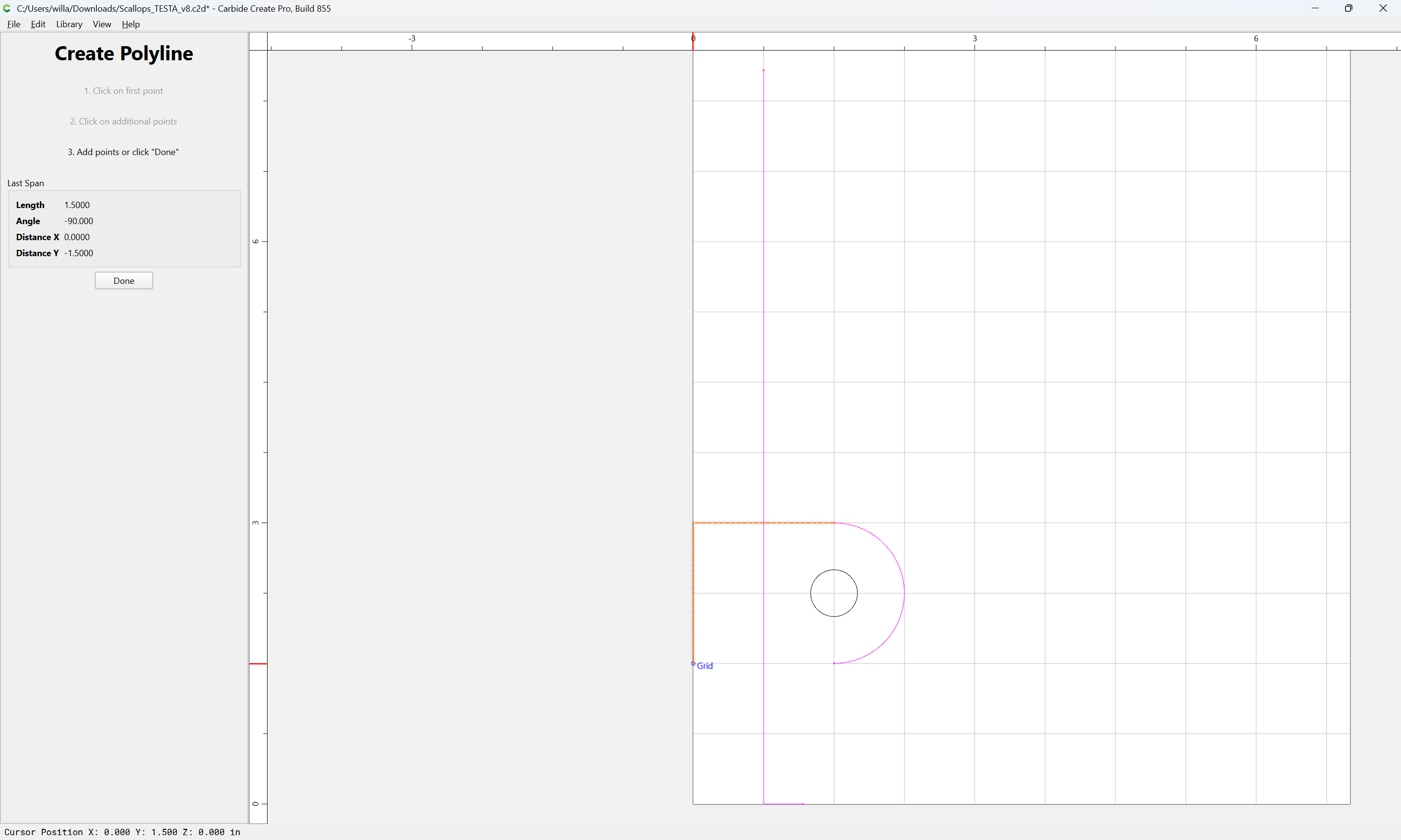

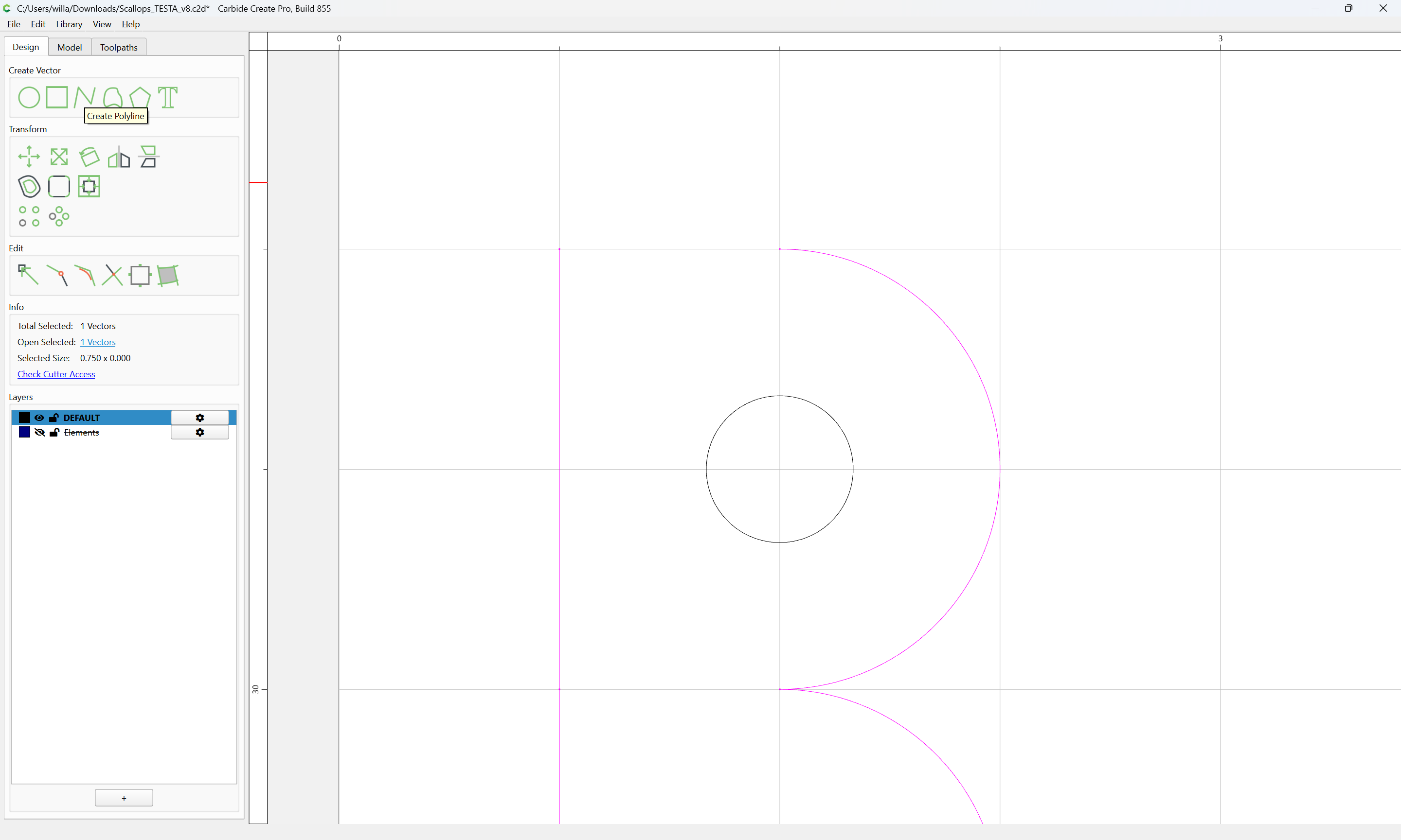

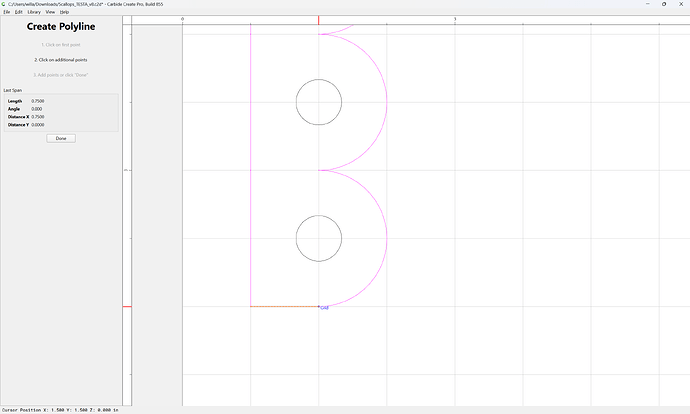

Zoom in on each end:

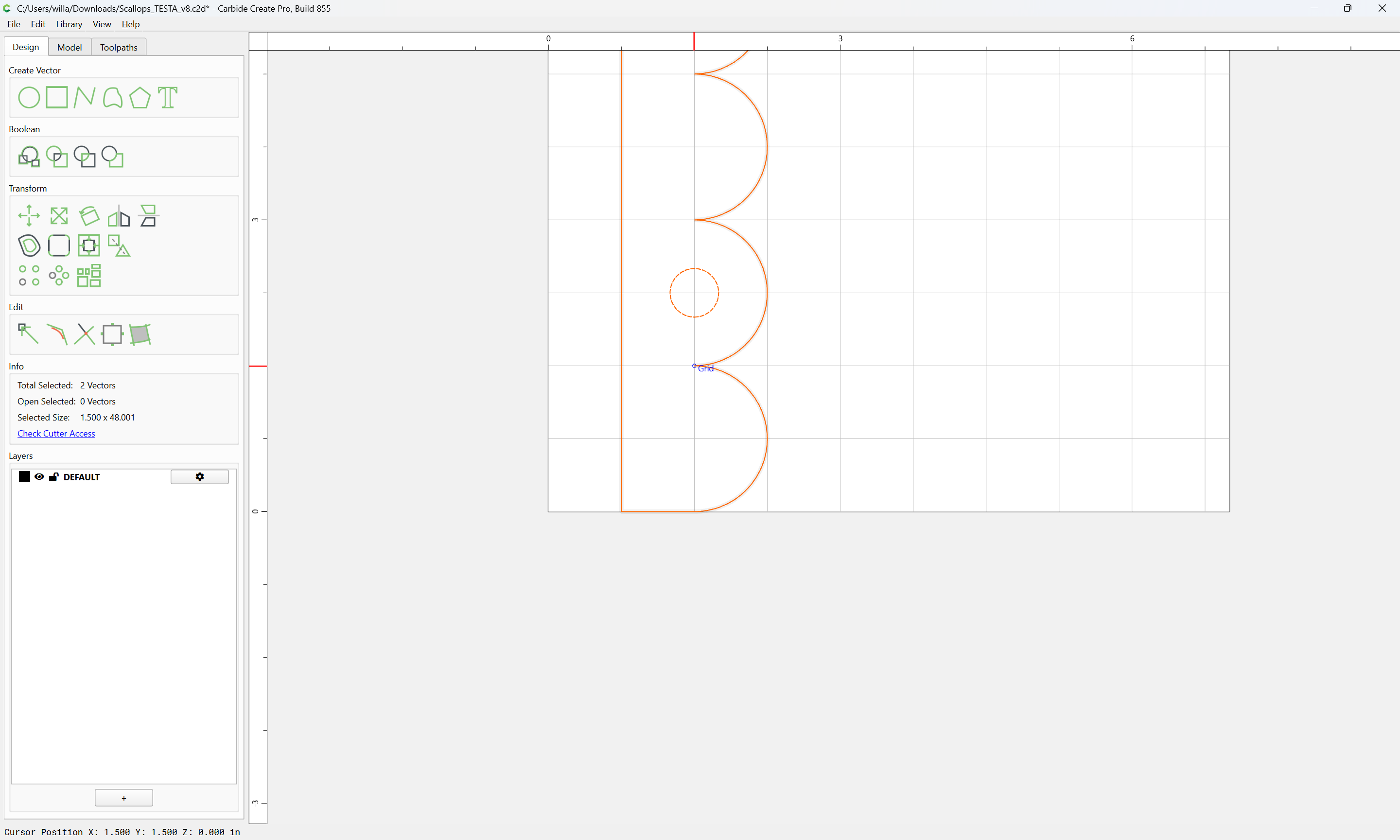

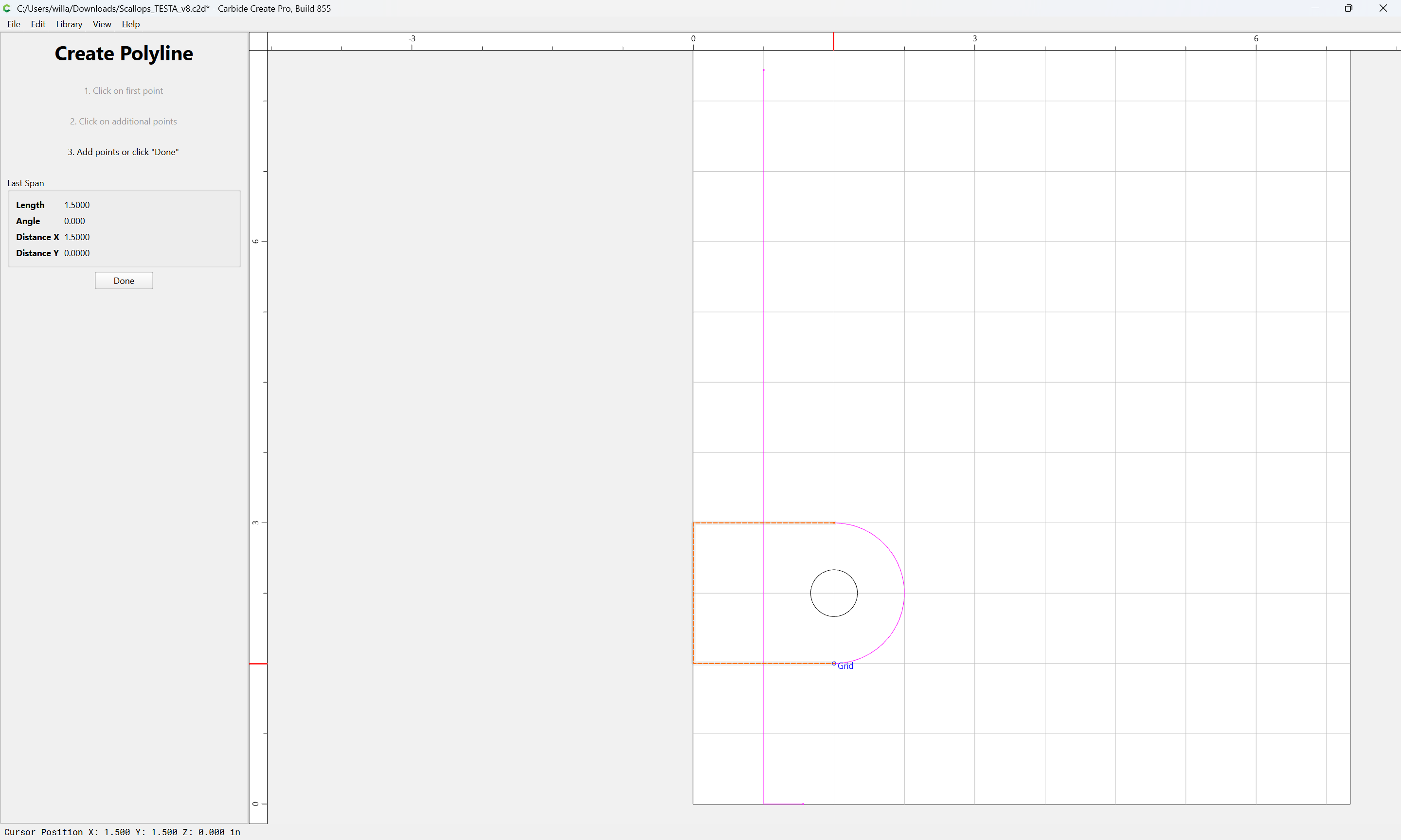

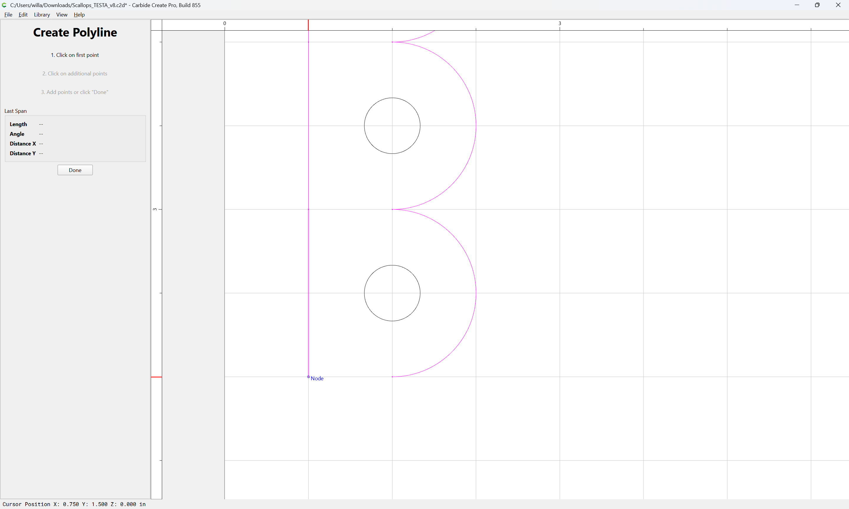

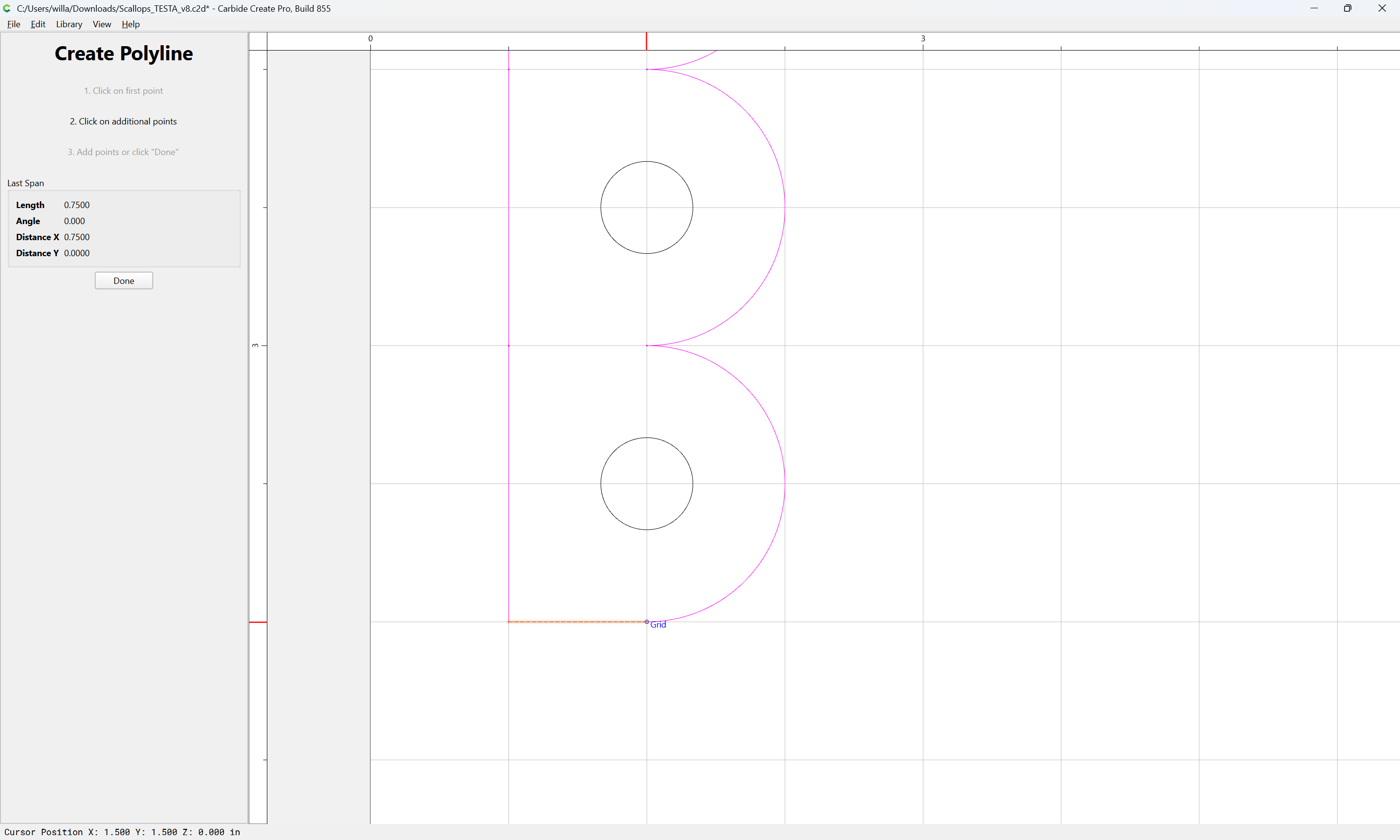

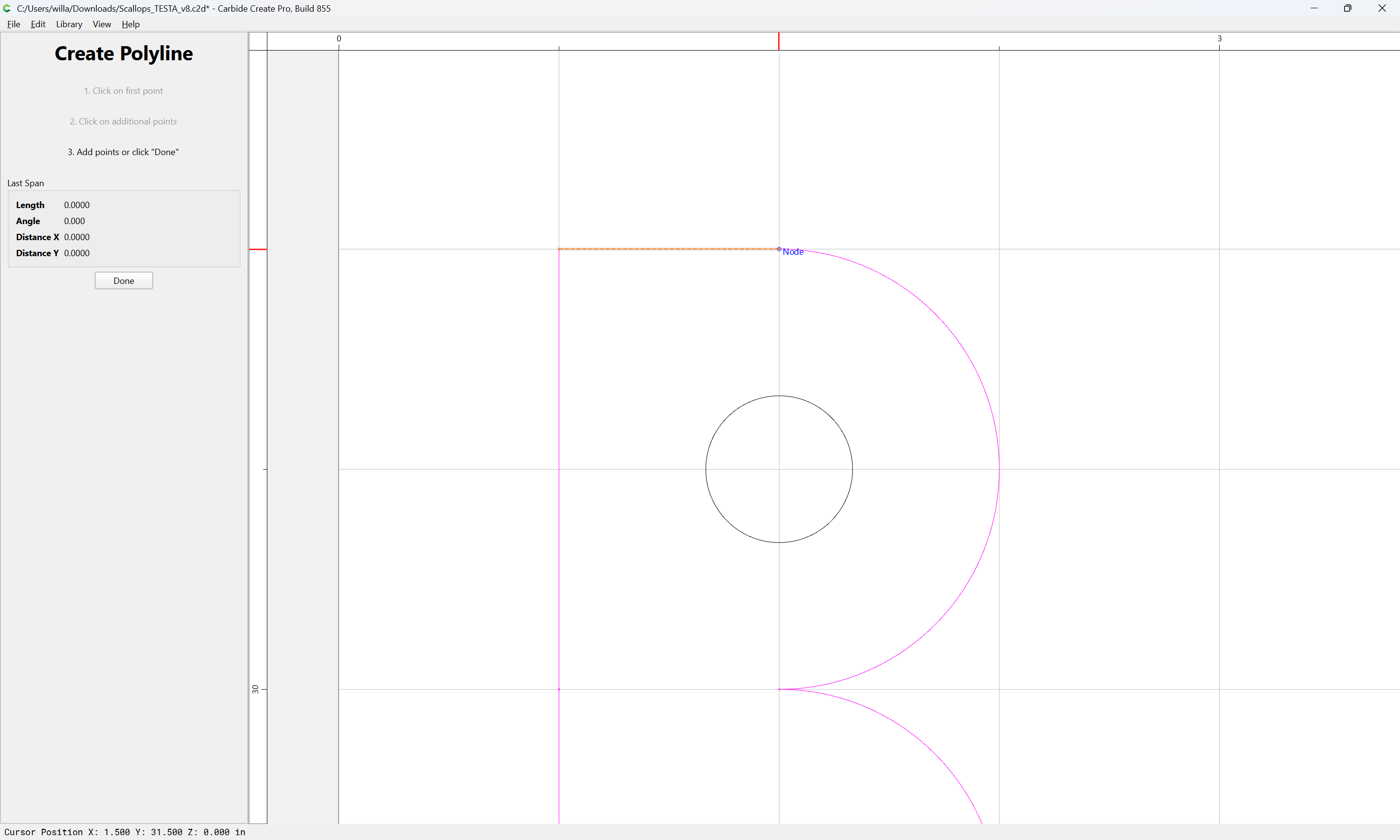

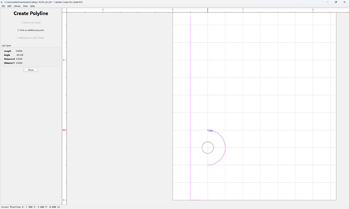

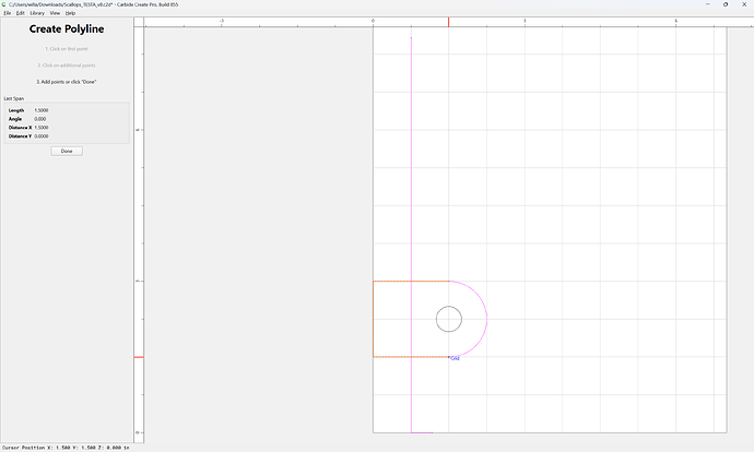

and use the Polyline tool to draw in geometry to close:
Done
Done

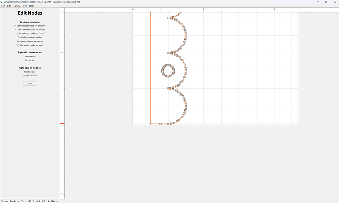

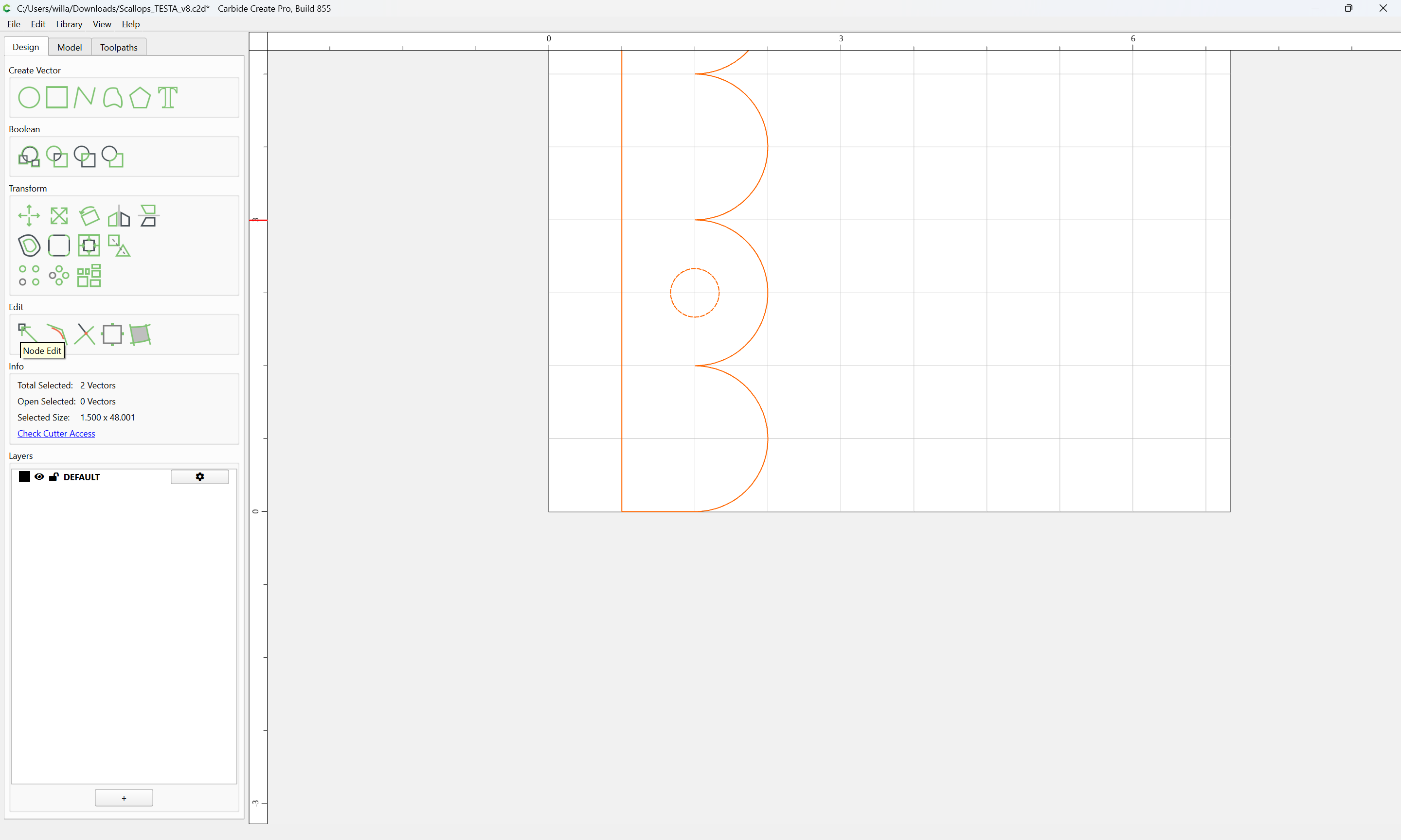

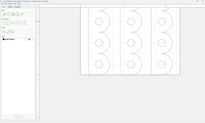

Select everything:
Join Vectors

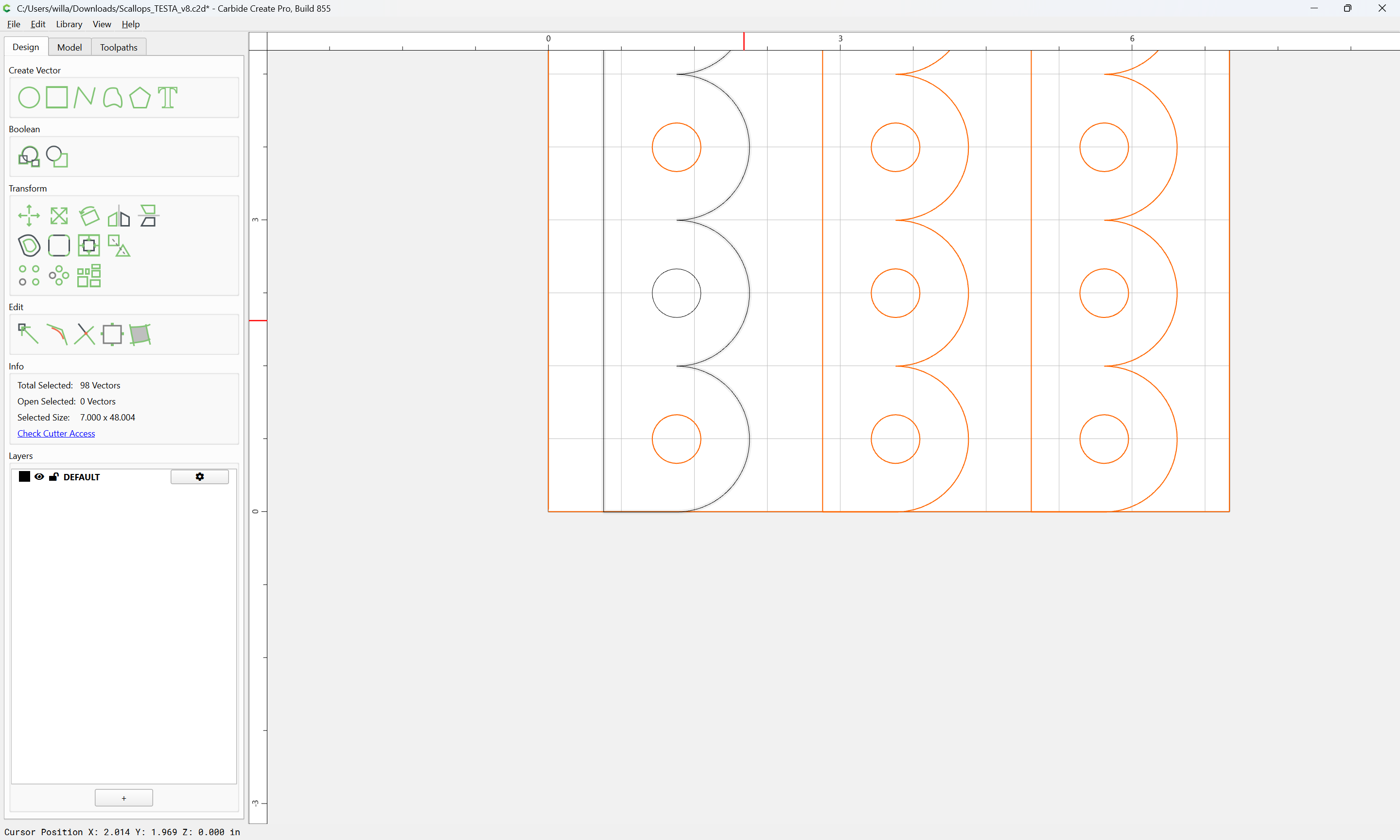

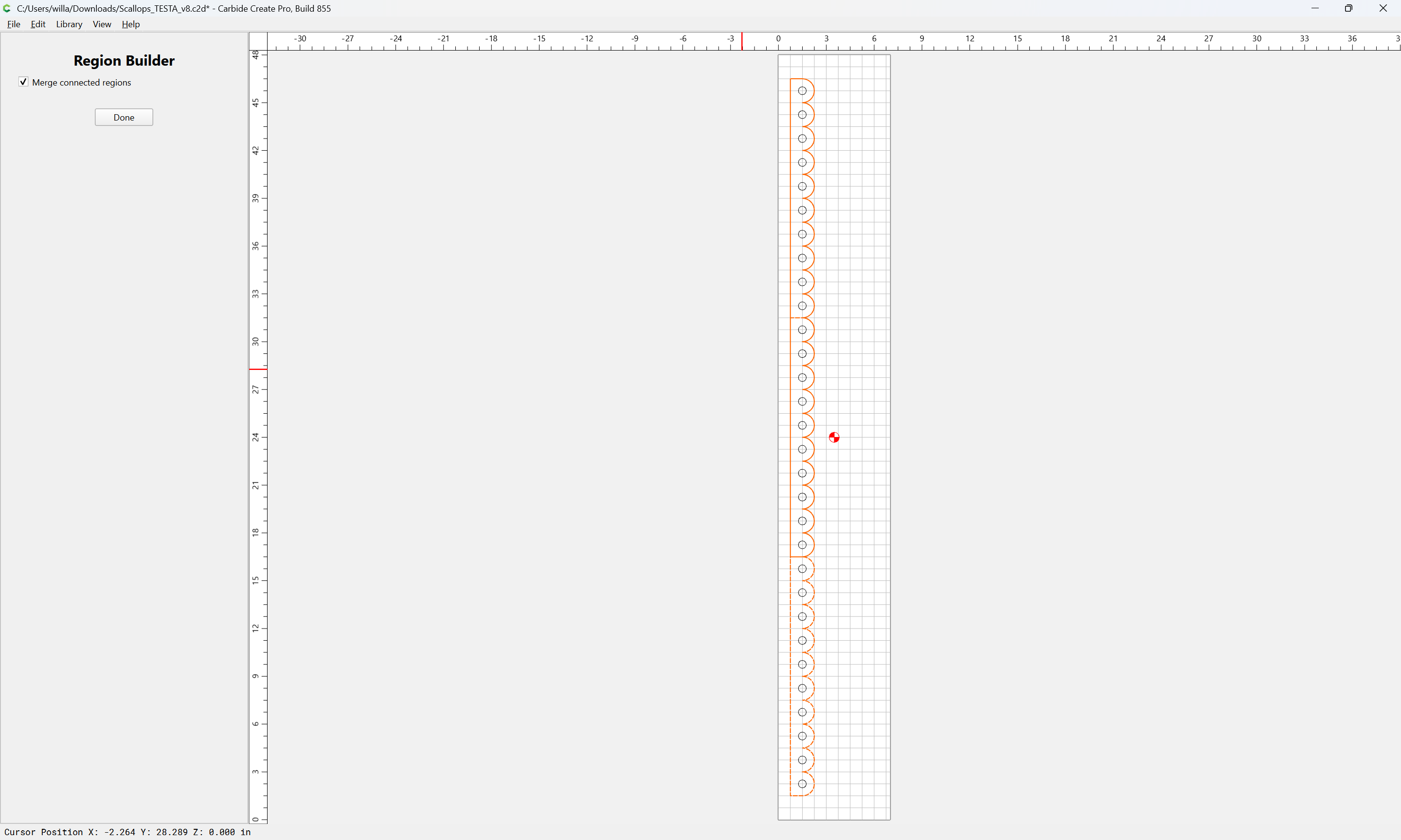

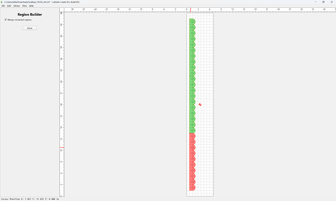

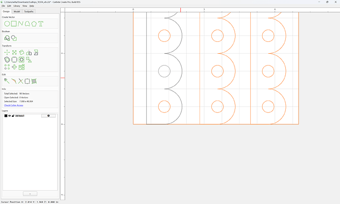

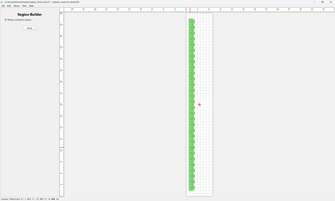

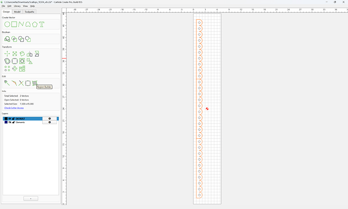

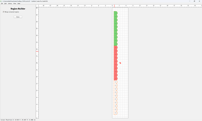

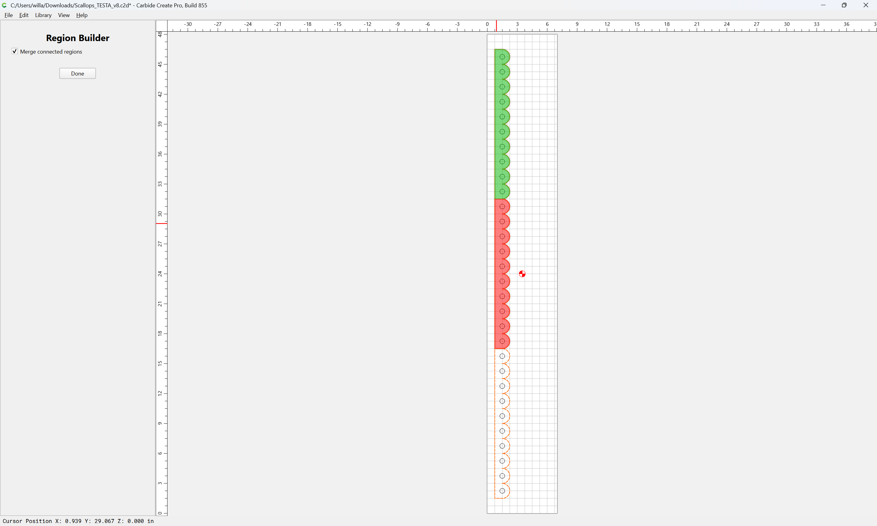

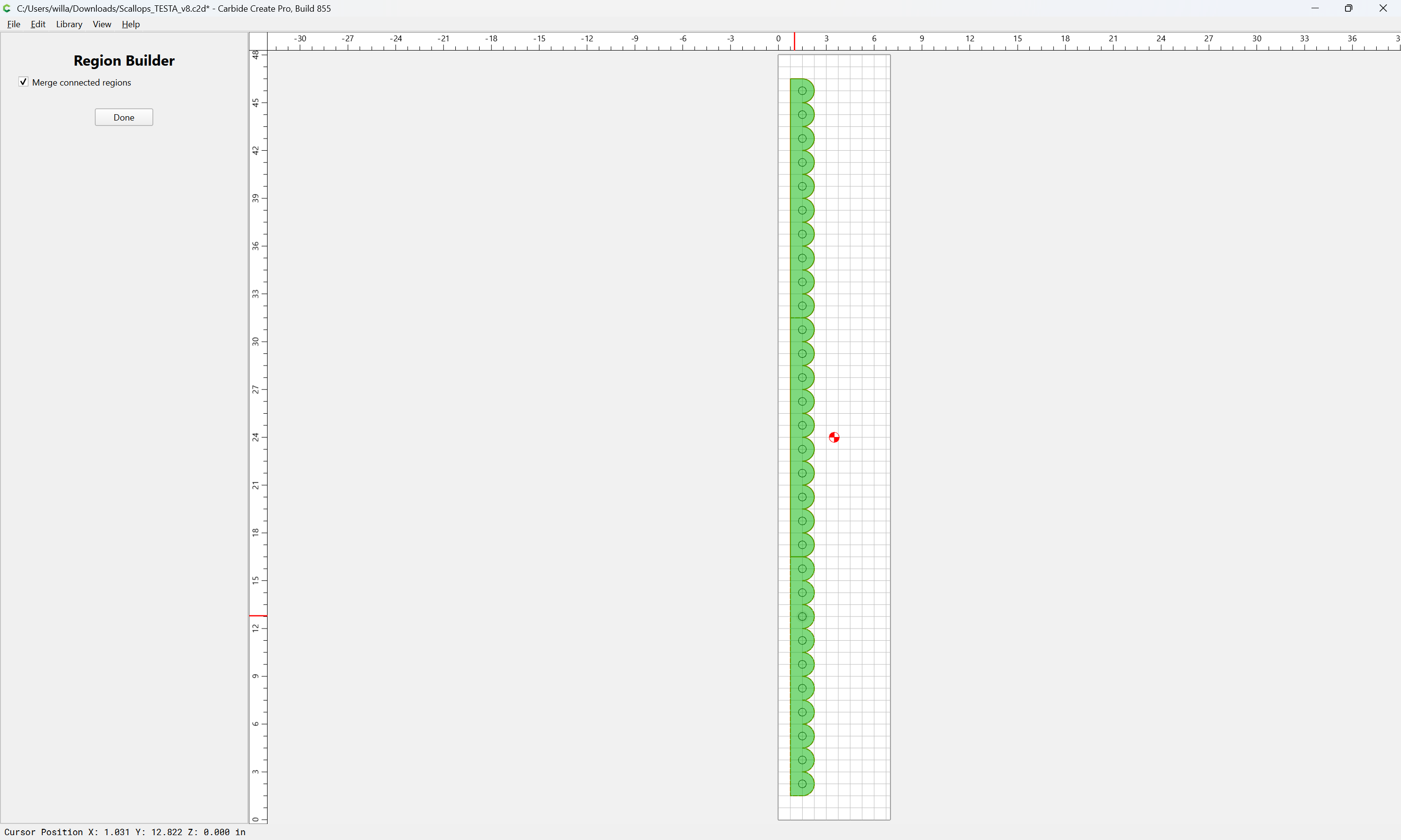

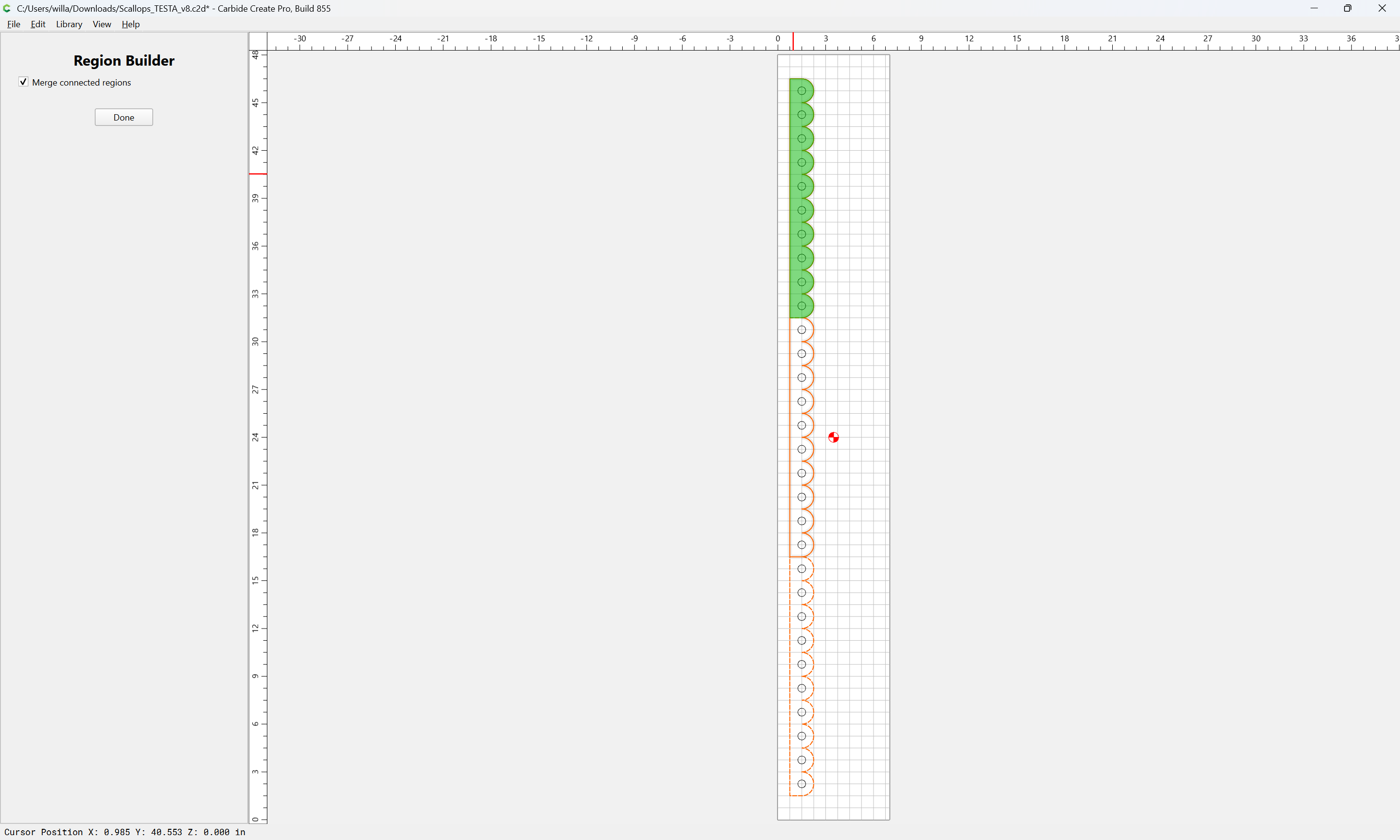

To extend this by duplicating and using the Region Builder, select and duplicate what is wanted:
Then drag it into registration with the original:

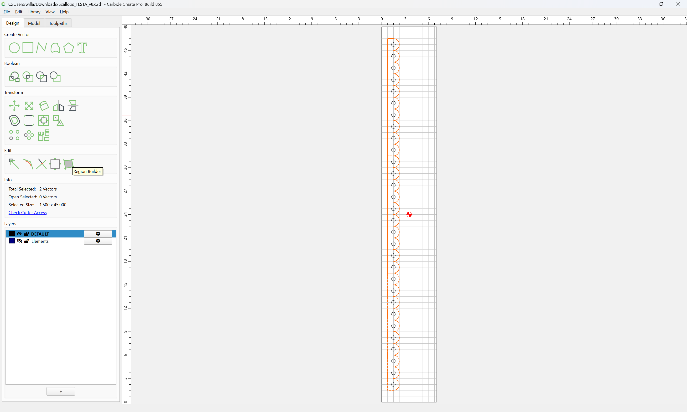

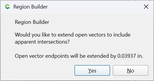

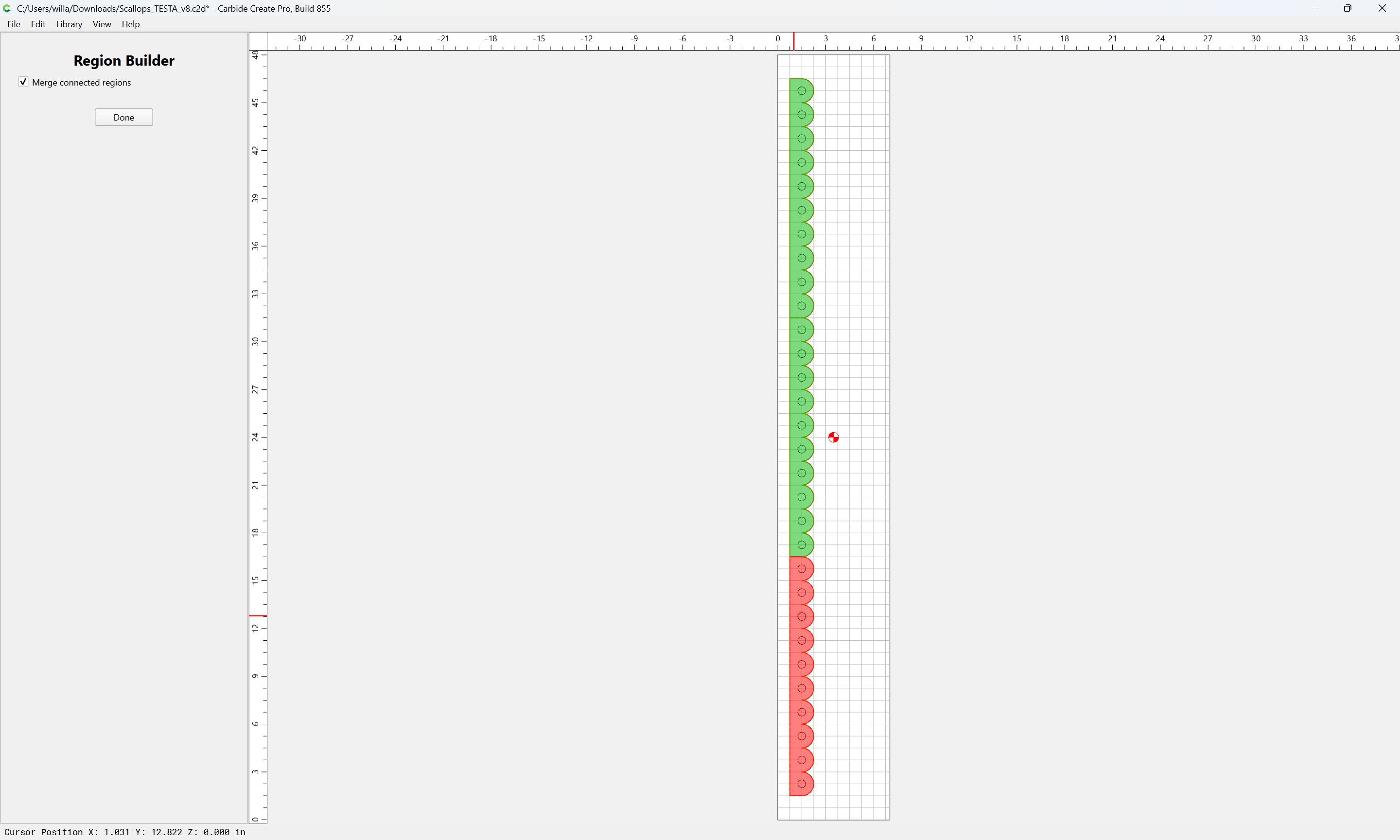

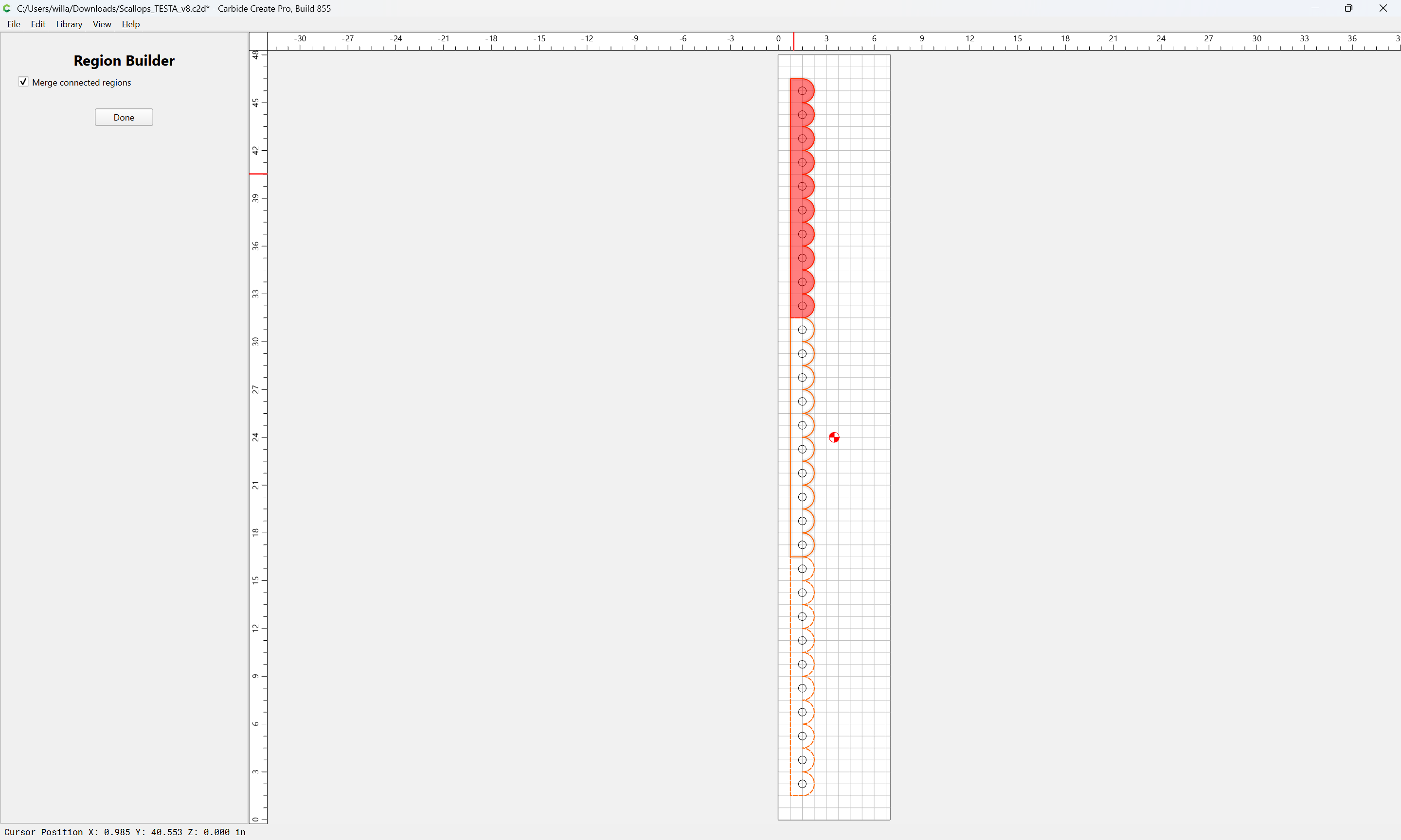

Select the two overlapping regions:
and use Region Builder:
Yes
and select the desired regions:
Done
