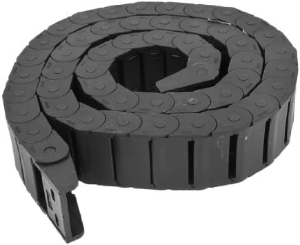

Looking to add some additional drag chain to my XXL. I got plenty with my kit, no worries there, I’m working on a special project for routing my router cable as well as a cable for some LED lighting and the feedback cable for my SuperPID off the right hand side of my XXL. I’d like to use the same drag chain style that came with my kit, but I’ve been unable to locate the exact same stuff for purchase and I don’t see it in the C3D store. Anyone know of a source?

To try to crowdsource this, I have:
  • Lal Xin Chain
  • LX1015S-2B
  • External dimensions: 20mm x 30mm
  • Internal: 10mm x 15mm
Not sure what the bend radius is (mental note, need to add protractor to my layout tools) — each length adds ~18mm
Found it one place(by part number(Generic image?) :
This one looks right when you examine the picture, embossing around the pivot, but no way of knowing if it is just a generic picture…
Found hand grenade and horseshoe Close here:
and Here:
https://www.amazon.com/uxcell-1-06M-Carrier-Cable-Chain/dp/B00N3ZL7G0/ref=sr_1_7?s=hi&ie=UTF8&qid=1487513900&sr=1-7&keywords=drag+chain+10x15
Thanks for the info Will and William. I saw a bunch on Amazon but was unsure if any of it opens to place my cables inside or if it would need me to feed my cables through it. Feeding through is not an option in this case as my ends are already in place and I don’t want to cut and solder new ends on. Is there some specific spec that says it will open to load cables?
Dan
the last link for the uxcell should open fine,its has the links to pop out on the one side,not to sure about the others
