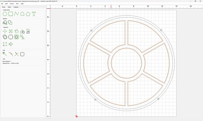

In the attached file, the “blue” straight line in each section of the tray is cutting about 1/16 or so deeper than the rest of the tray bottom. Why? It doesn’t show up in the design nor in the simulation.

You are pocketing with a ball-nosed tool — better to do this with a perimeter pass (for the rounding) and a square tool for the balance.
The lines do show if you angle the preview a bit:
If you want a smooth bottom see:
Otherwise, to achieve what you seem to want you will need to leave the bottoms uncut, then nest a series of geometries to which you will assign a No-offset contour:
(adjusting the distance so as to arrive at an even distribution w/o a central point is left as an exercise for the reader)
Not sure I’m saying what the problem is. The “fine grooves” left by the ball mill are not the problem. In each tray section, in the toolpath view, not the simulation, there is what appears to be a solid straight blue line emanating from the center outwared in 4 of the sections and from the outside inward in the other two sections and the center circle.
These are not on the design and do not show up as a separate cut in simulation, but are cutting into each tray section. I don’t have my camera at the moment, and not sure it would show up anyway.
Again, not the individual stepovers, but the solid blue line showing in the toolpath view.

If you’re talking about these lines, they are the stepovers from one pass to the next.
And they do show up in the simulation. They are not cutting any deeper, they are just cutting across the scallops left by the ballnose tool.
They are cutting deeper, by about 1/16". Not sure if I can make a pic show it up, but will try.

Attached is the best pic I can get to try and show the extra groove being cut. I have sanded out the concentric grooves made by the ball mill, but these grooves remain at now about 1/32"+ in each tray section.
Wood is a natural material — that looks like tearout from a section which is aligned with, and caused by the movement transition.
You may be able to address this by re-running a full-depth finishing pass, or adjusting the depth per pass —
0.5 / 0.04 == 12.5
the machine is making 12 full depth passes at 0.04" and one final pass at 0.02"

I agree with Tod1d. This seems normal because you are using a ball nose bit. If you were using a flat bit you wouldn’t see these. If you don’t want to see the concentric groves just use a flat end mill.
Well, cut another board with just a 1/4" end mill and everyone was right. Don’t understand why the ball mill does the extra groove, but that’s all for it. Threw it away. Don’t need all that extra work for sure to sand it out.
