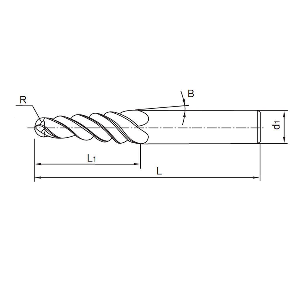

I am adding my tools into F360 and when entering in a tapered ball nose it asks for the corner radius?
I asked Precise bits (for this tool) but nothing came to mind for that value.
Update: Precise Bits said It’s half the tips radius. Simple once you know.

If it’s one of these
https://www.precisebits.com/products/carbidebits/taperedcarve250b2f.asp&filter=7
I’d start with 1/2 the tip diameter from the Precise Bits spec. It seems that Fusion is modelling this as a corner radiused (bull nose) tool and that a full ball nose is just a boundary case of that where the radius = 1/2 diameter
Something a bit like this
You’re on point. I updated my original message with just that.
