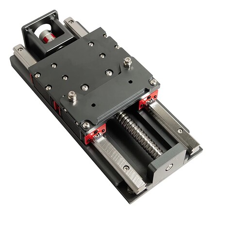

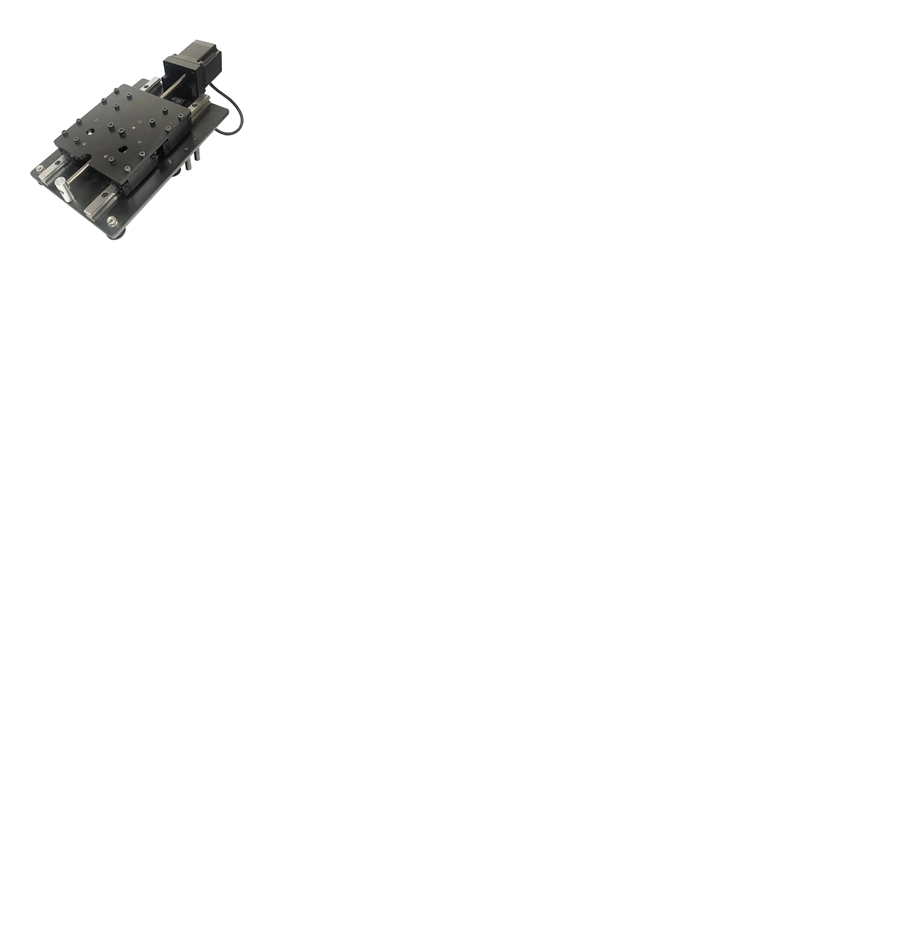

Here is a picture of a Z-Plus
The Z-Plus has a stud at the bottom with a hole the leadscrew goes through but does not touch the leadscrew. It seems some early z-plus does not have that stud.

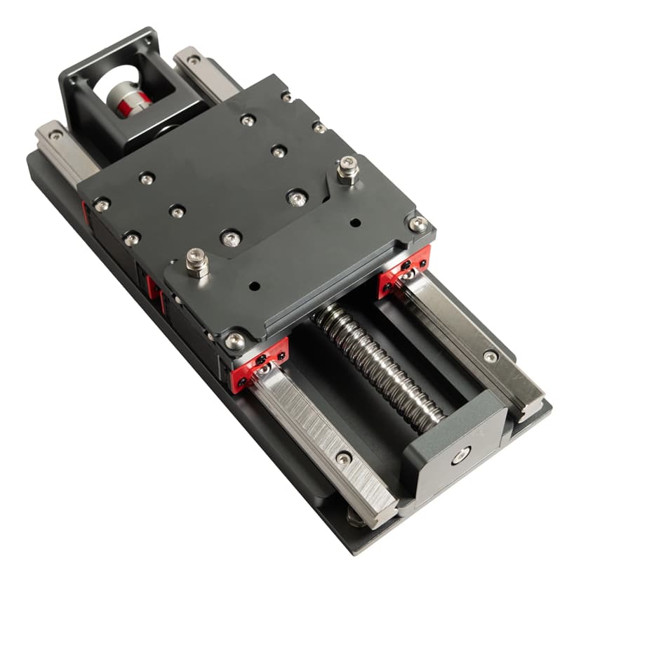

Here is an HDZ
The HDZ has a bearing at the bottom of the leadscrew.
Take a good luck at your Z and pick the correct one.
Power up Shapeoko and open Carbide Motion. Connect but do not initialize. Run the setup and pick the correct Z. After that you can connect and see if initialization happens correctly.
