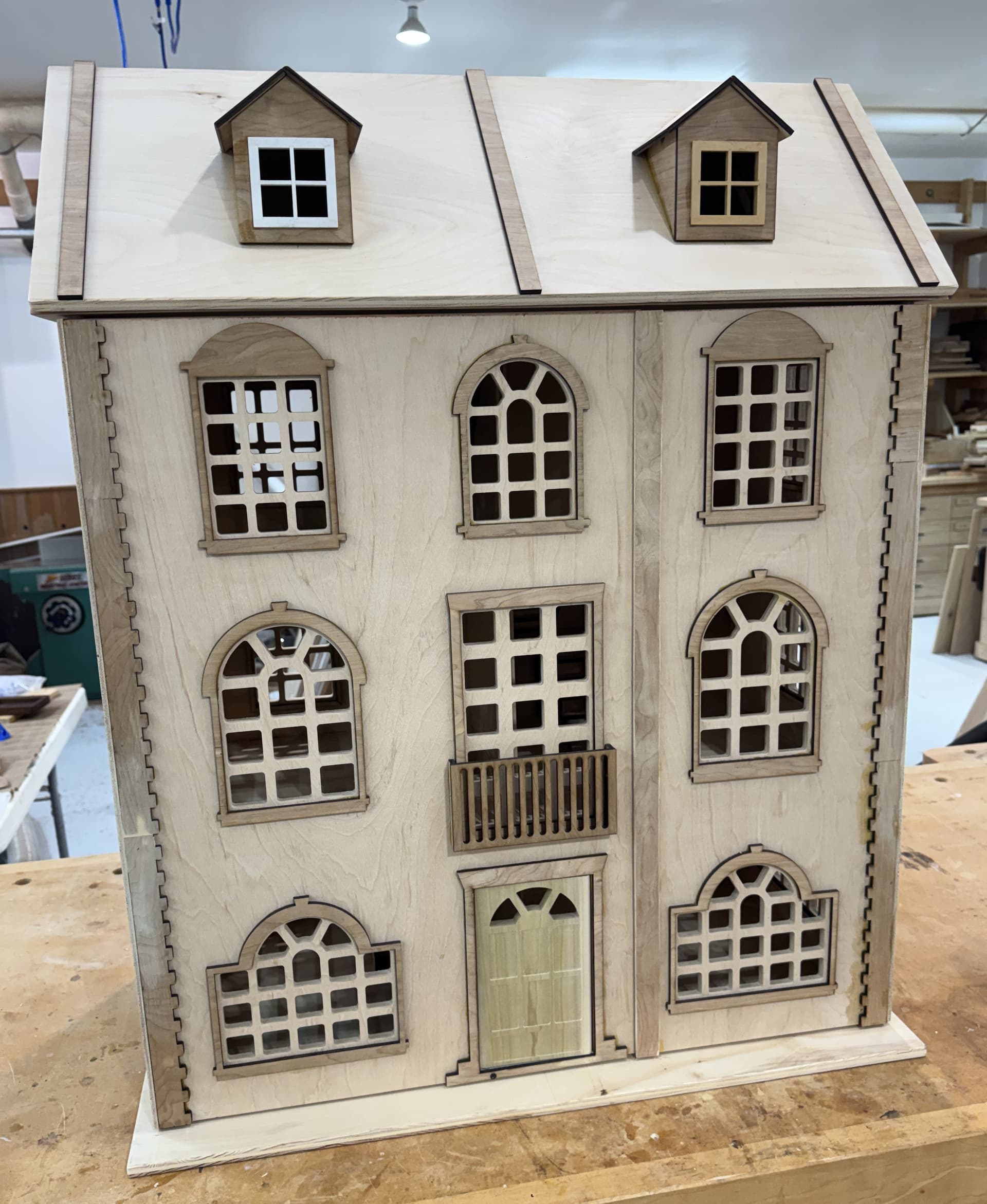

My adult daughter asked me to make a dollhouse for my granddaughters for Christmas. The inspiration was a deluxe dollhouse selling on the Harrod’s site for $1200. This is a team effort - I built the structure and my daughter will paint and decorate before Christmas morning. I’ll try to update the final look when finished.

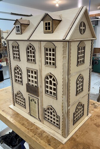

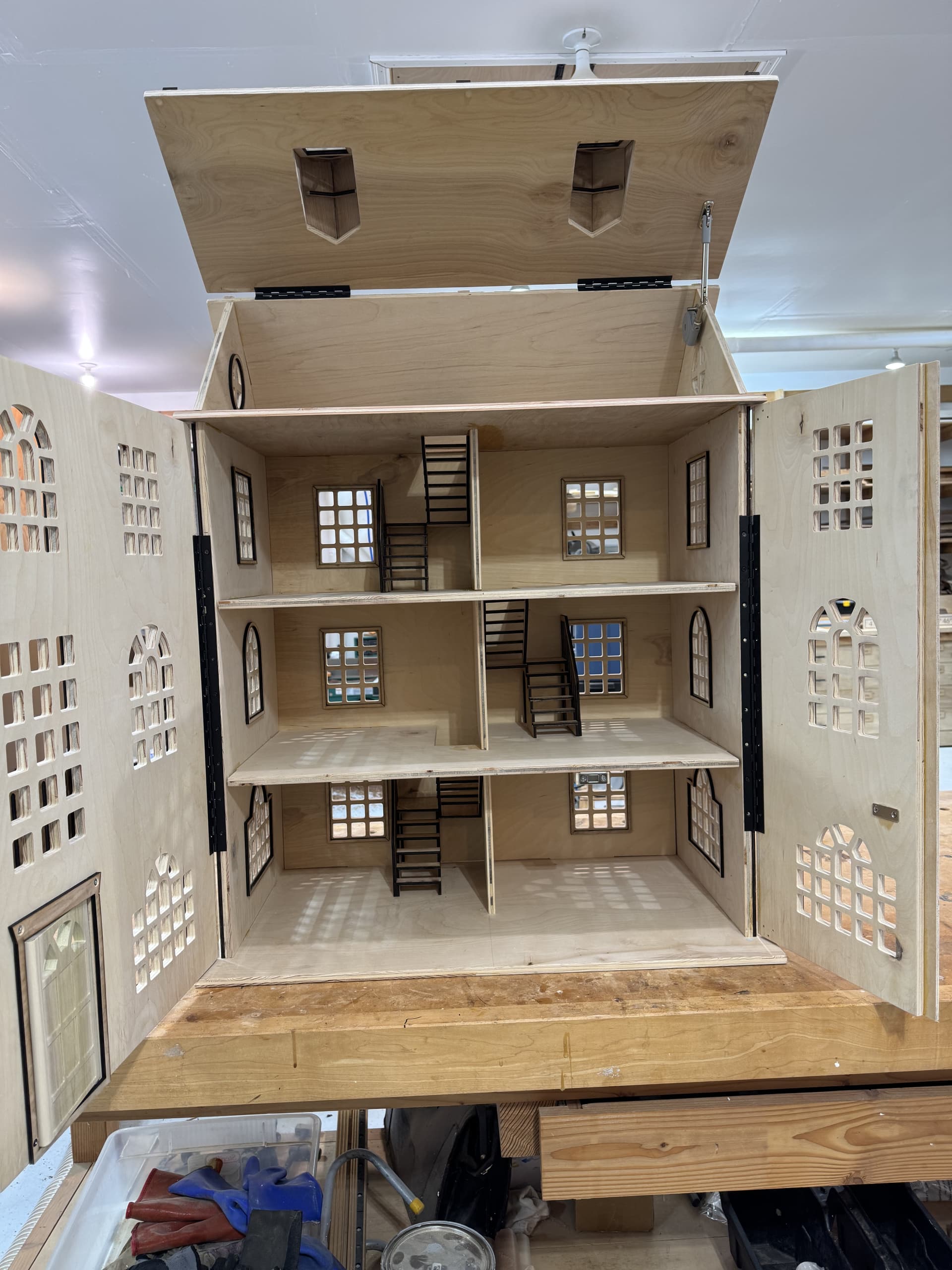

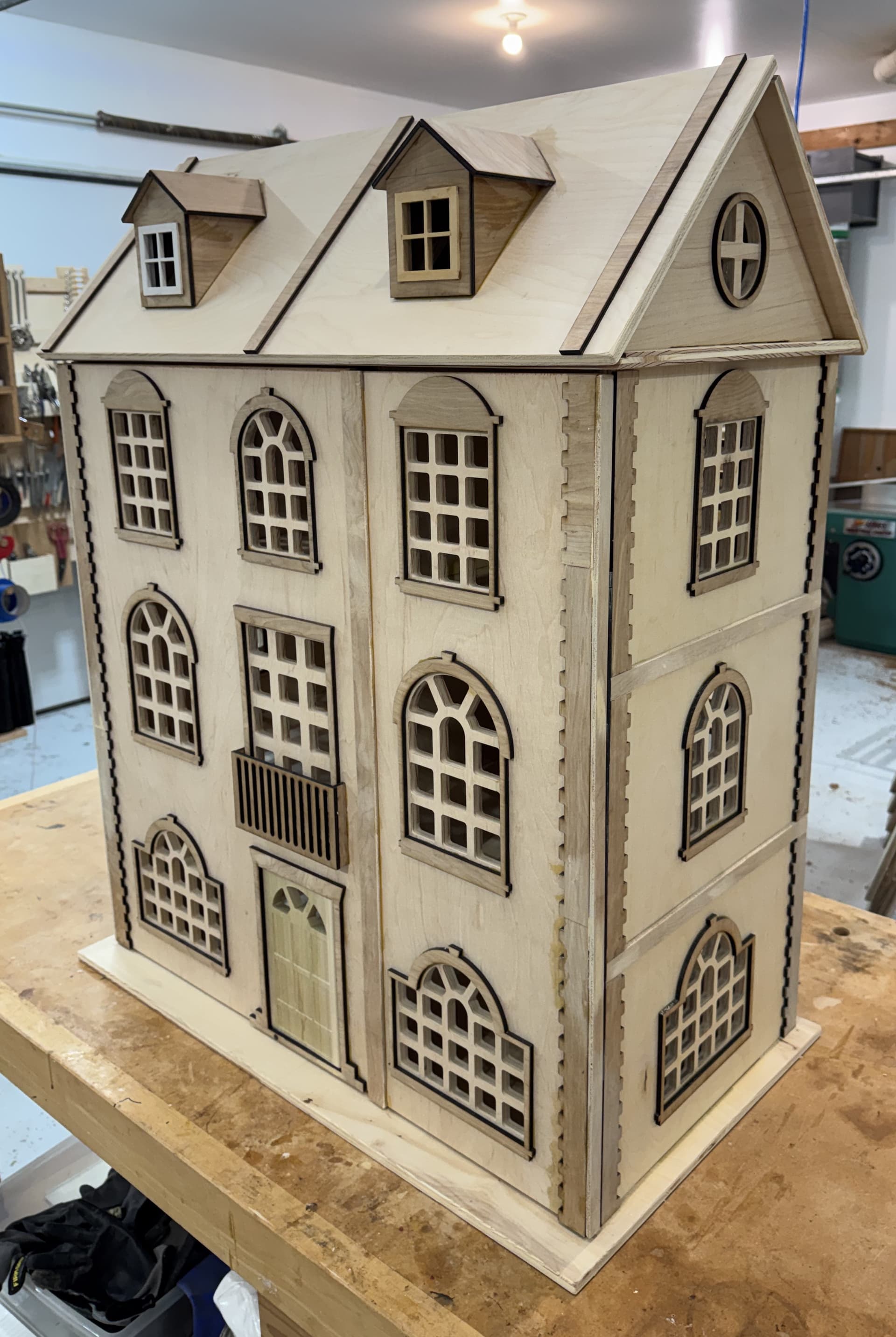

It’s big - dimensions are 40" tall x 30" wide x 16" deep. The overall construction is 1/2" plywood cut on my XXL Pro basically with interlocking tabs. The window treatments and stairs are 1/8" plywood cut with an XTool S1 laser. The front door is solid and swings, also cut on my Shapeoko. The only parts not made by me are the window panes in the top gables (you can see one is white). These were borrowed from my daughter’s old dollhouse, for a - “something new, something old” touch. There is a slow close hinge/piston on the attic roof to save fingers. Basic piano hinges on front doors and roof. Magnetic catch on front doors. Two sheets of 1/2" birch ply, 1+ sheet of 1/8" ply.

Thanks! My daughter has taken over from here. She’ll paint, decorate, and furnish. I suspect she’s buying the furniture.
