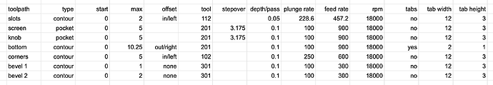

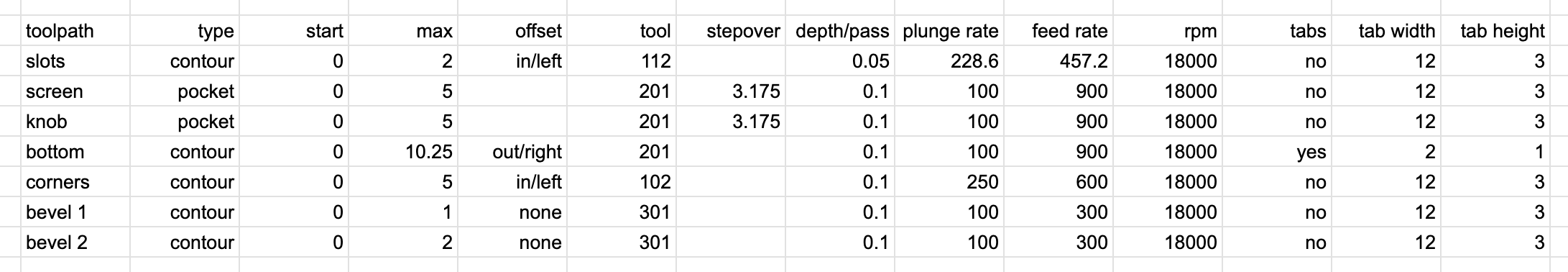

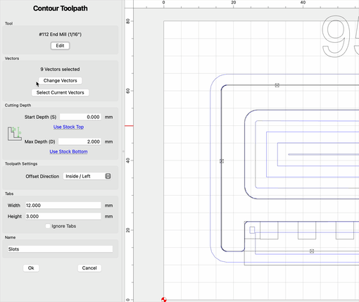

I find myself often having to double and triple check toolpath settings and there is so much clicking when there are several paths. Also, it’s easy to miss when one value is off somewhere.
Please consider adding a view that shows all toolpath settings.

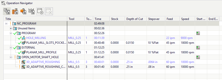

This would be nice. NX does this & it’s configurable. You have about 30 columns to choose from.
I capture & print for a setup sheet, program listing at the machine, as well as a last sanity check on parameters before posting.
