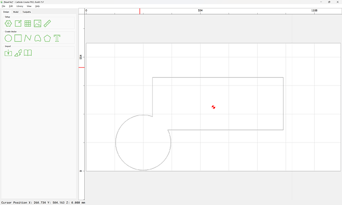

Carbide Create has this feature, “Trim Vectors”:
Select the geometry:
choose “Trim Vectors”:
click to remove whatever geometry is not wanted:
OK
OK
If desired, use “Join Vectors” to close:
  1. Correct, Carbide Create is missing this feature — usually one can make up for it w/ the options for rectangles to have Fillets:
or using the Corner tool to round things off:
