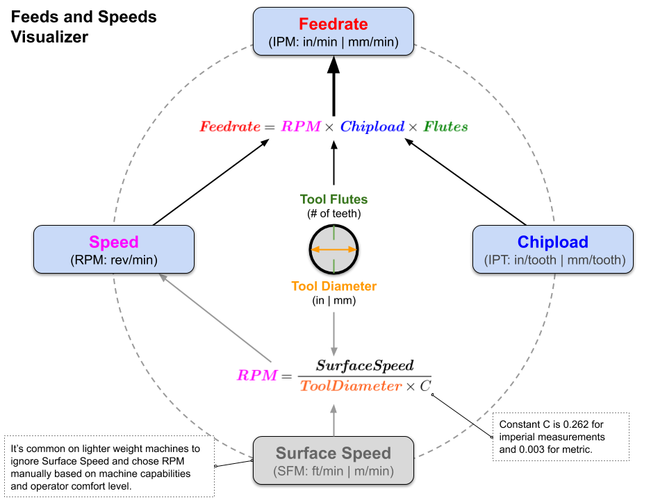

I am trying to get a better intuition for how the various feeds and speeds parameters interplay. And being a very visual learner I created a diagram for myself and figured I would share in case it helps others.
[Removed post that had reference to a metric version of diagram. Its now a single diagram covering both systems.]
That’s an awesome thing to hang up on the wall… Well done!
By the way, the link says I need permissions…
Could you update the equations so that they are really math?
  • Variables should be italic
  • use correct symbols (Ă— rather than x)
see: http://jmlr.csail.mit.edu/reviewing-papers/knuth_mathematical_writing.pdf
Yeah working on some improvements Julien mentioned too. I will work on the formulas too. Thanks for the feedback.
Ok updated the doc with some of the suggestions received so far. Namely I combined the imperial/metric versions into one, converted the formulas to latex equations, put less focus on Surface Speed per Juliens awesome ebook.
