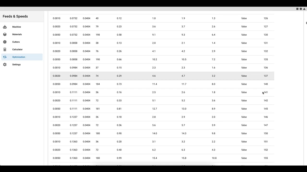

This may not be quite a traditional Gallery post but I wanted to showcase something I’ve been working on. First off, thank you to @gmack and @Julien (and others!) for their incredible contributions to the two feeds and speeds calculators that I initially used. What I’ve created here is just trying to take the SFPF calculator that I believe was modified from the NYCCNC calculator and make a really nice to use web app. Taking it one step further, I offer (dumb) optimizations. Check out my short demo walking through the calculator:
Note: please make sure to set HD as your quality otherwise it may look really blurry.
There are definitely still bugs, but what is super exciting about this calculator is the “Optimization” feature. What this does is it allows you to specify a range of chipload, woc, and doc along with a number for each and then it calculates feeds & and speeds for every combination of values, compares it against the constraints and sorts the highest material removal rate to the top. This is essentially equivalent to creating a manual spreadsheet hundreds or thousands of times and manually comparing the spreadsheets. Instead, you specify the constraints and you automatically can answer questions like “given the capacity of my machine, what is the DOC I should use given X material while doing slotting (i.e. 100% WOC engagement)”. I actually wrote an identical optimization script in Python but found myself wanting something a bit more user friendly that didn’t require running code directly. Hence the UI.
Would love any and all feedback based on the demo video! There is a lot of potential for enhanced calculations. One thing I’ve thought about adding is one of those graphs that shows force as the endmill rotates, similar to Millalyzer. I haven’t quite found the need for that myself though. Also the calculator does not yet support spindles, but that would be pretty easy to change.
I haven’t yet published the calculator to an actual website (running on localhost). I was considering Github Pages but it doesn’t support SPA routers very well (need to look into this more). In any case, a big goal of this would be that we could have community contribution by creating materials and cutters in the tool that we could make be defaults. That way when someone new to Shapeoko / Nomad joins they can use the calculator to get a really good starting point for various scenarios. Not sure if that is too far fetched and people actually care about calculating feeds & speeds as much as I do. I know once you have them set you’re pretty much good to go.

I recognize that maybe this topic should be moved out of gallery since it did have pictures at first but is now more just a discussion. I’m looking into optimizing by feeds and speeds a bit more as I think I’m being a bit conservative, but what is unclear to me is what is a good max power % and max machine force % of the router to use? I’ve been making sure it is <= 25%, but I’m not sure if that is too conservative? I believe on @gmack 's spreadsheet if it gets above 40-50% it starts getting yellow, but I’m not sure what that actually means practically… I imagine you want to keep deflection lower unless you’re ok with doing some extra finishing passes. Any thoughts? cc @Julien

I would of course let @gmack comment on the rationale for the specific power thresholds values in his spreadsheet, but to me the yellow zone is just a warning that one enters the MRR range where the spindle/router power may start to be a main limiting factor (when it’s very often deflection that becomes a problem first, long before power)
A 25% power target for roughing passes seems too conservative indeed, 50-60% is probably more sensible (or let the user pick a value?)
Thanks for the quick reply @Julien! I tried out 40% (it’s cutting right now) and it seems to be doing just fine. I still kept the deflection pretty low (<20%). Next time I plan to try 50-60% of the power / machine force to see how it does. Curious if you think there’s a decent upper limit for deflection? Given that I will do a finish pass, I figure deflection could also be higher. I have max deflection at 0.001in and then it is doing 20% of that maximum (per how @gmack’s calculator works). So probably could even increase that to 80-100% and leave it to the actual deflection value (0.001in)?
The user can in fact choose a value and constrain the optimization problem however they want. That’s actually 99% of the reason I made the calculator.
Example constraints I applied:
And the optimization results:
I chose the first row, which maximizes MRR. But I’m really just trying to gauge upper limits to target. Sounds like 50%-60% for spindle/router power and machine force is a good target, and perhaps just setting the actual deflection I can live with per my finishing pass and setting max deflection percent to 100% would be fine. Would you agree / disagree based on your experience?
