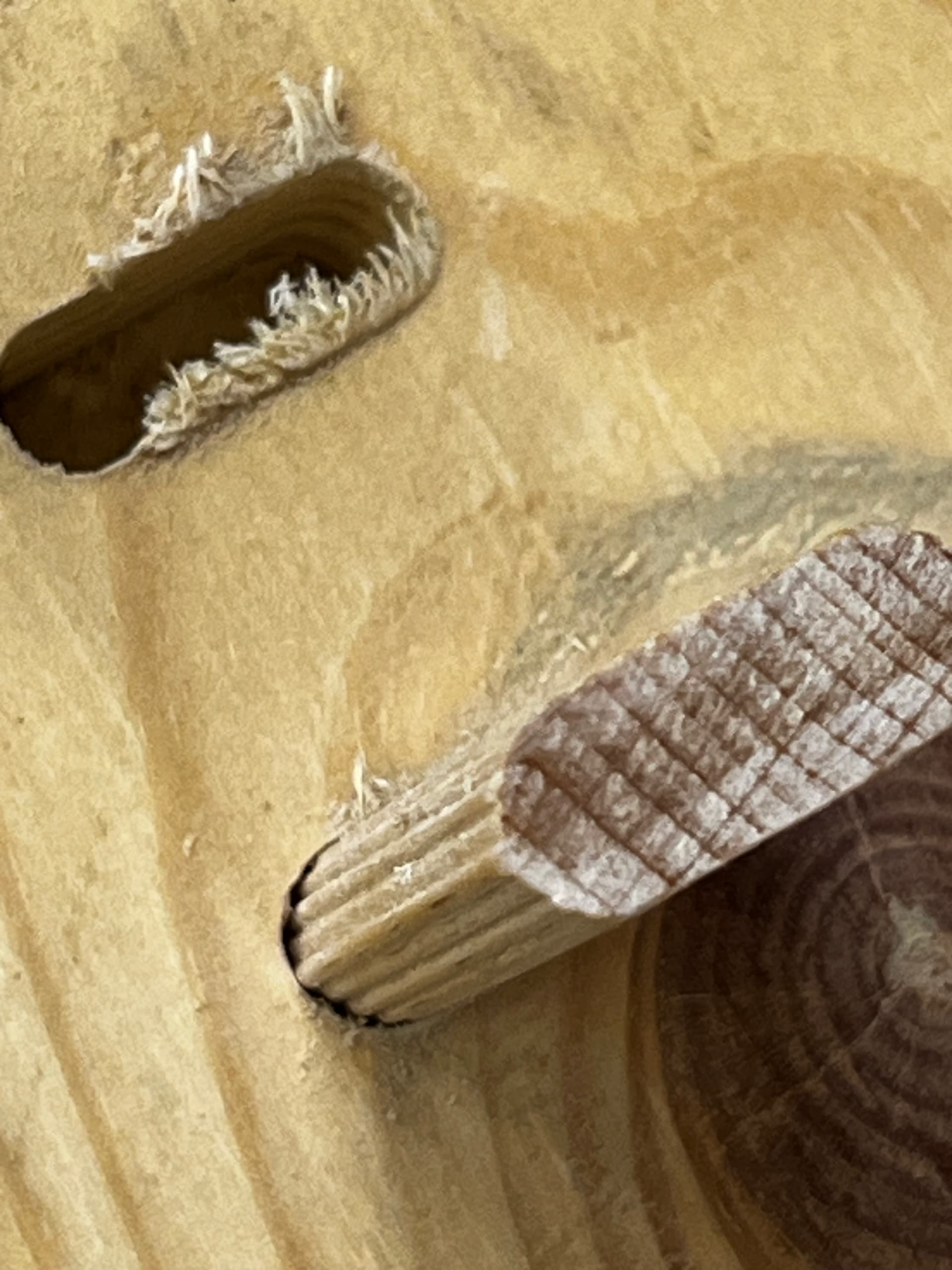

For an 8mm thick Festool Domino, machine a hole exactly 8.4mm wide, 22mm height and a fillet corner of 5mm. This produces a sweet fit.
Nice to know. I dont have a Domino but I bought the Jessm Pocket Hole jig that emulates the Domino in making holes for Domino sized pockets. I have ordered all the beech loose tenons from Amazon. The Festool ones were toooooo exensive.
