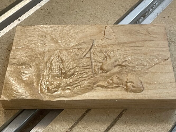

First the test result:

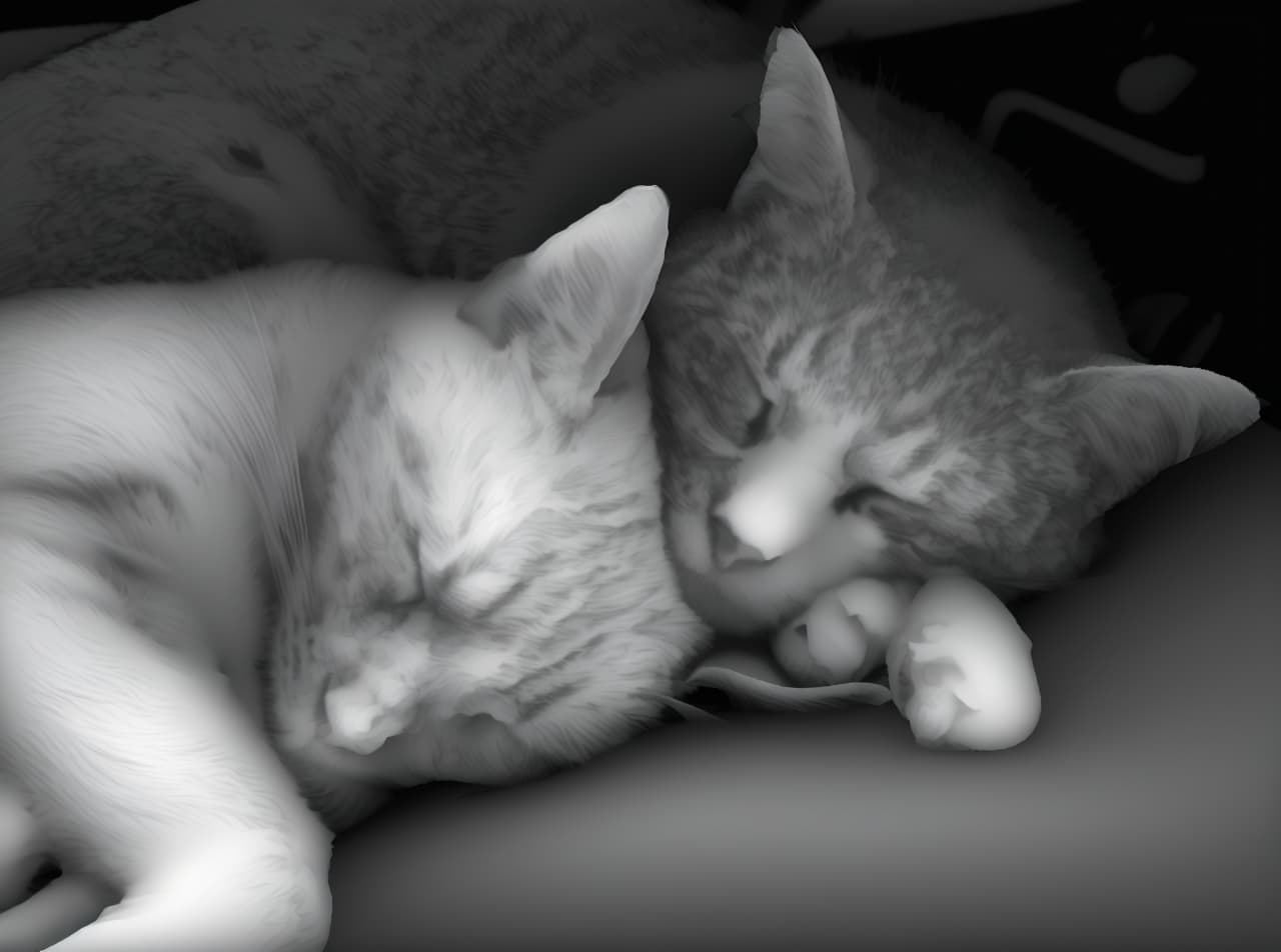

It’s a pretty simple process, upload an image, select a couple of options and click draw. You get four versions of the depth map and you can download them to use in Carbide Create Pro.
Mine looked like this:
For this first test I didn’t adjust anything. I just loaded it in as an image in the Model section of Pro and mapped it to my stock. I am pretty pleased with the result for a quick test.

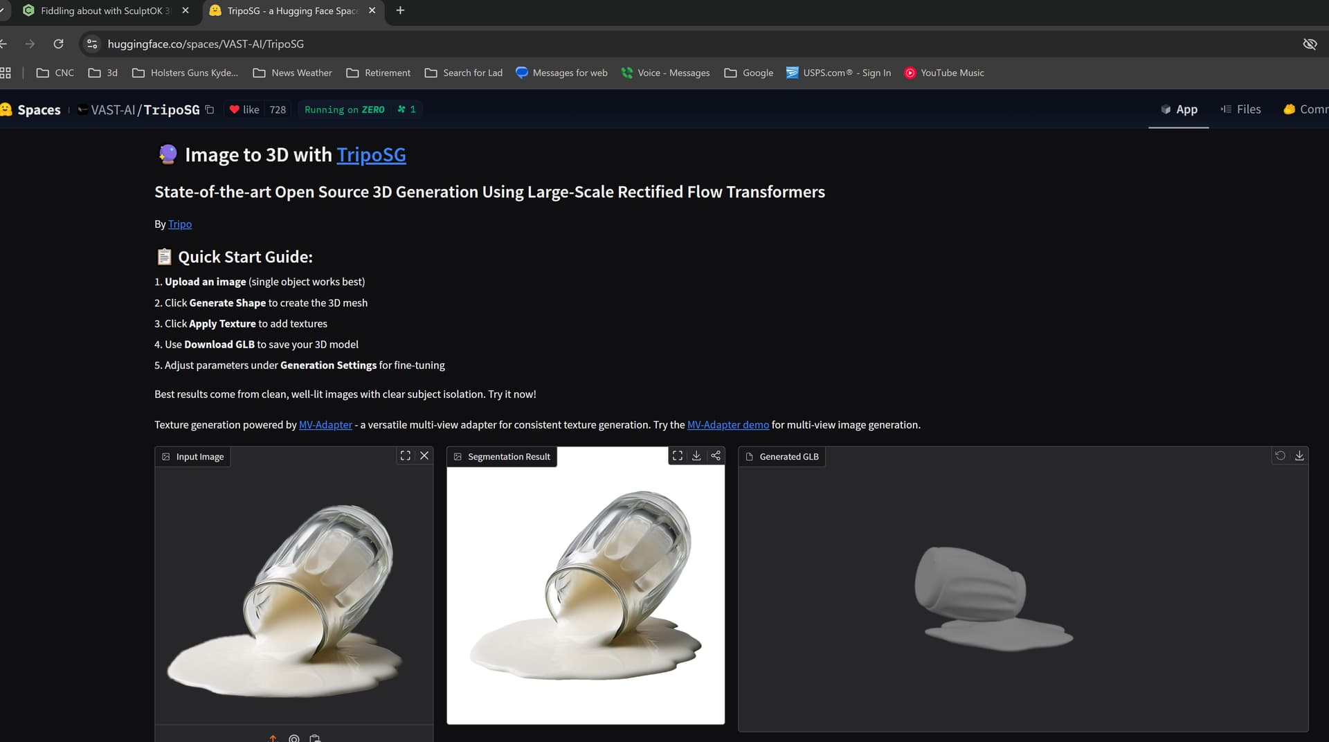

Here is another site that also works well. I just uploaded a random image to show here.
I know it has pricing but they haven’t asked for any money yet…
One work of caution…these 3d sites and especially downloaded software requires a serious GPU…unless you have all day to watch it.
