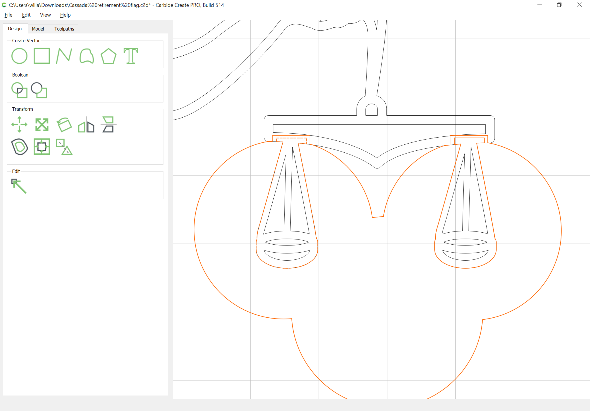

I am cutting this police patch on a flag. I did doc at .06. It did not cut the scale the lady is holding. I changed doc to .07 and cut again. It barely cut a little bit of it, but still not there. I don’t want to cut any deeper on rest of patch. I’m thinking I need to select scale only and cut deeper, but the scale is tied in with the rest of the lady so I can’t just do the scale only. I do not know how or understand how to edit nodes and close off the lines and make the scale a closed object I can cut. Someone did a trace of this patch and created the file for me. I have finished this flag completely and still sitting on machine, so I need to be able to fix existing file and finish the cut before removing. Any ideas to help? Thanks for all the help I get from here. Mike

Draw a series of circles which define the area you wish to cut and which all overlap:
Boolean Union them:
Select the original design and ungroup it:
(My kingdom for a sub-select option)
Select only the outline and duplicate it:
Drag the duplicate into registration with the original:
(My kingdom for a clone option)
Shift-click on the drawn-in geometry to add it to the selection so one can do a Boolean Intersection:
resulting in:
Draw in geometry which you can use to bridge the gap:
Boolean subtract it to make a bridge to union with the geometry you wish to keep:
Delete the geometry which was preserved from the Boolean Subtraction operation and duplicate the bridge geometry:
Drag the duplicate into position:
Select the bridge geometries and the geometry created earlier and Boolean Union:
resulting in:
Select the outer geometry and delete it:
Node edit the geometry for the scales to reduce the top area to what one wishes to cut:
Delete all the extraneous nodes:
Select the geometry and create a new Toolpath Group and assign a suitable toolpath:
which should preview and cut as desired:
