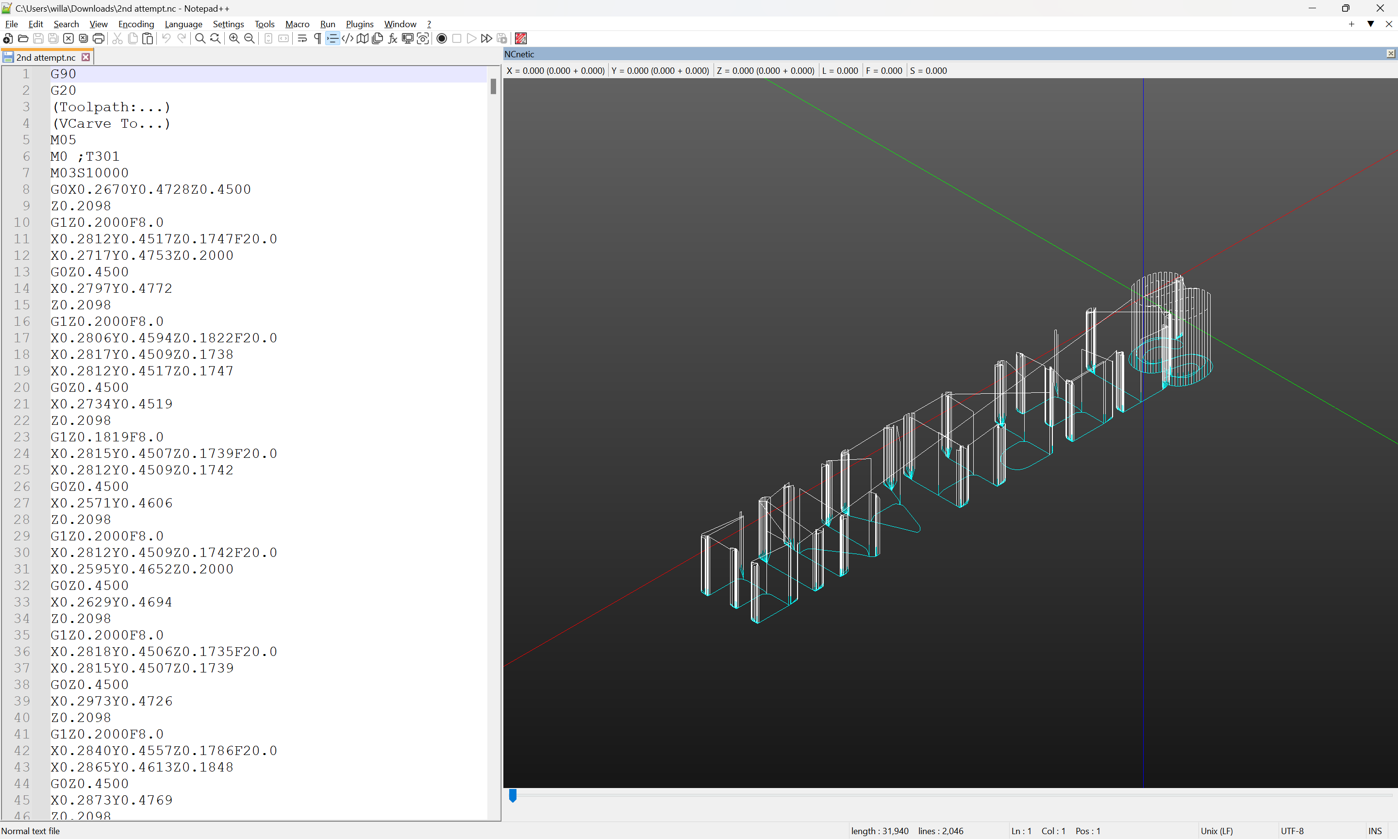

Friends, I’m struggling to find what I’m doing wrong. I’m brand new and using 30-day trial of Carbide Create 3D. When I save my file as a G-Code, I can see it on the offline device. I actually often see 2 files named the same. But when I send either to print, nothing happens on the machine. The display will sometimes go through 0-100%, or another one gets stuck at 10%. But again the machine doesn’t move. However, when I select the files that came with the Gemitsu 3020’s SIM card they seem to work fine.
I’ve even uploaded other Carbide Create files from forums, saved them as G-Code (didn’t alter any of the settings) and they don’t work.

Could it be that you are copying over the metadata and then selecting that?
Usually it’s a . (dot) file.
Select and file on the Mac and “Get Info”, then do the same thing to the copied file — is everything reasonably equivalent?

Thanks for the quick response. they look almost identical.
2nd attempt.nc (31.2 KB)

The file seems fine:
Permissions issue?
Maybe try copying one of the sample files, renaming it, then over-writing it with one of your own?
