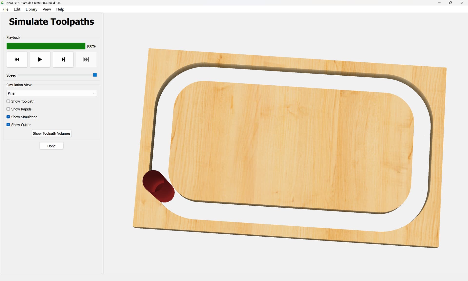

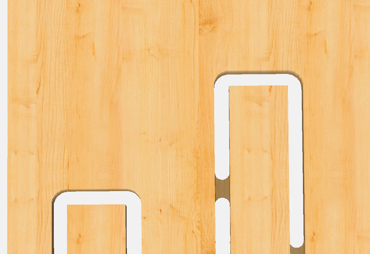

I created a design that has rounded corners on a rectangle.
In the simulation, the corners are square (and in the cutting).
What am I missing?

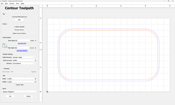

I believe that’s the result when you select the Inside/Left toolpath direction. Try Outside/right instead.
In the future, upload the design file as well (the C2D file). Pictures are a good way to describe the problem, but useless for diagnosing it.

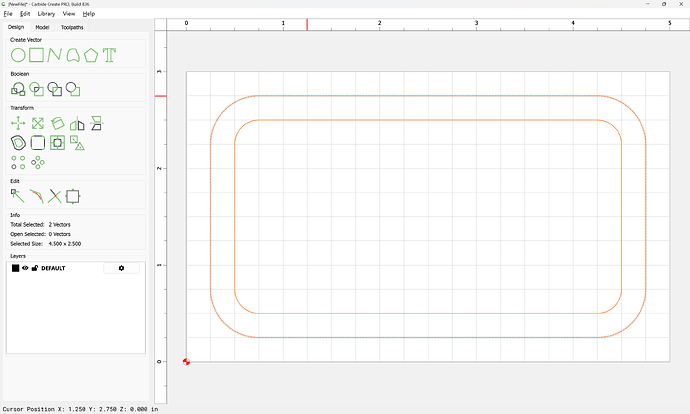

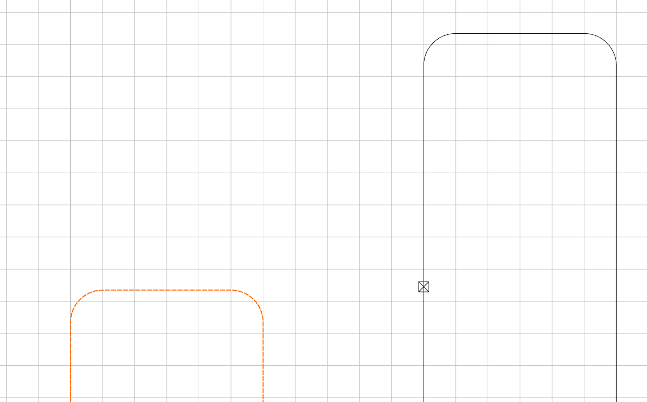

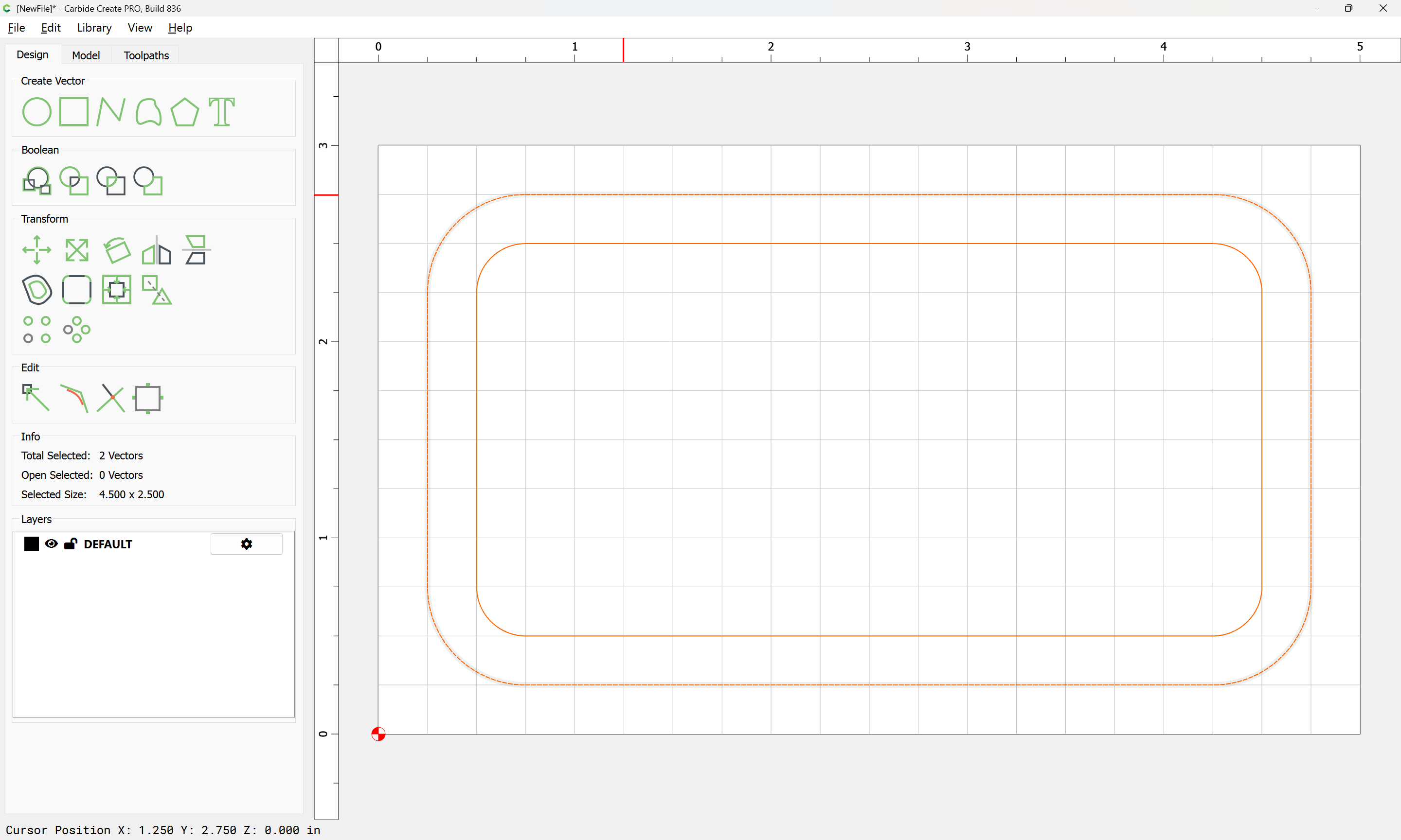

If you want full control over appearance you will need to draw both of the desired edges:
and cut as a pocket:

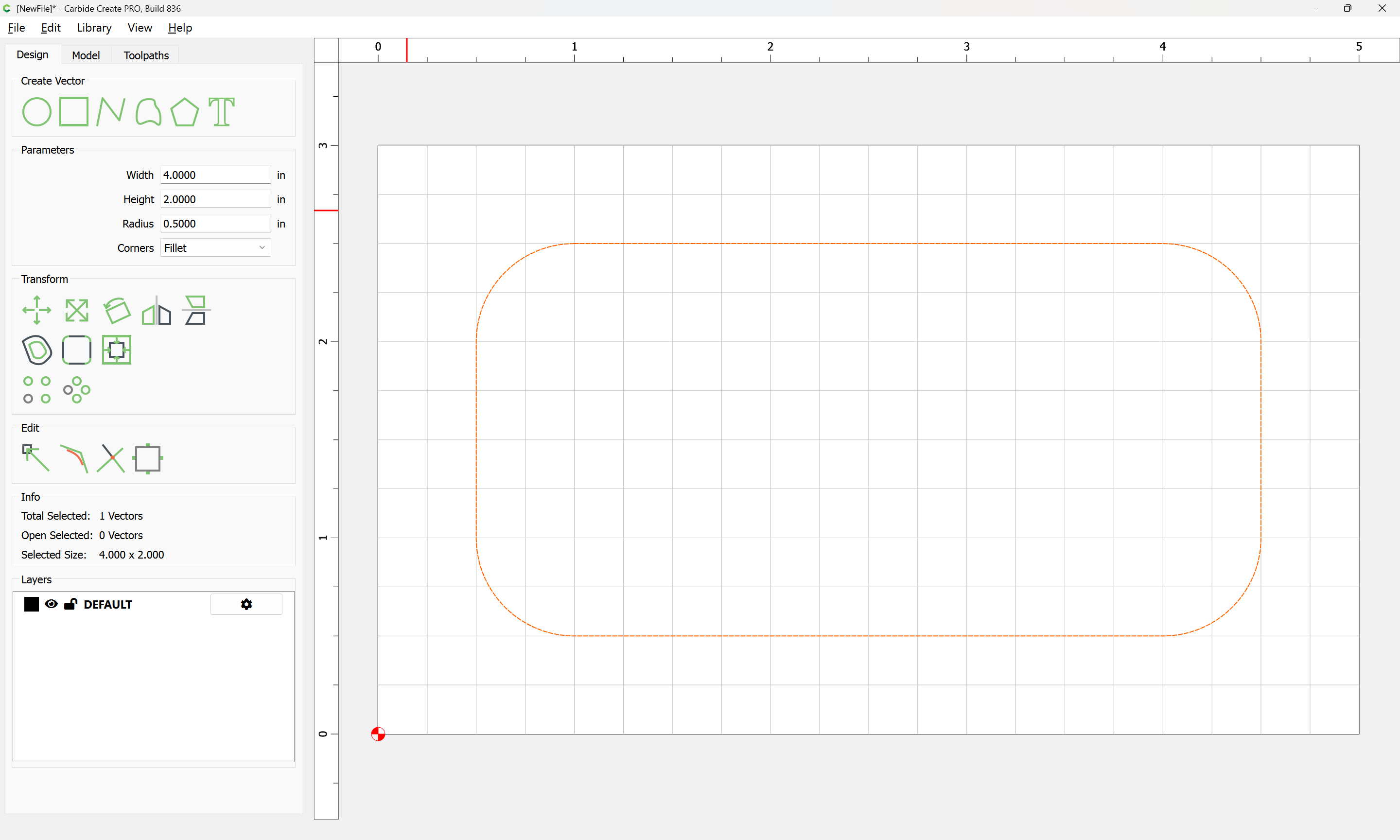

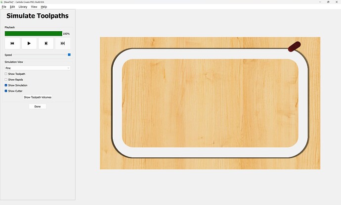

As noted, if you do an outside contour to a rounded form:
then it will be rounded as well:
thanks for the responses. not sure how I missed the outside spec.
