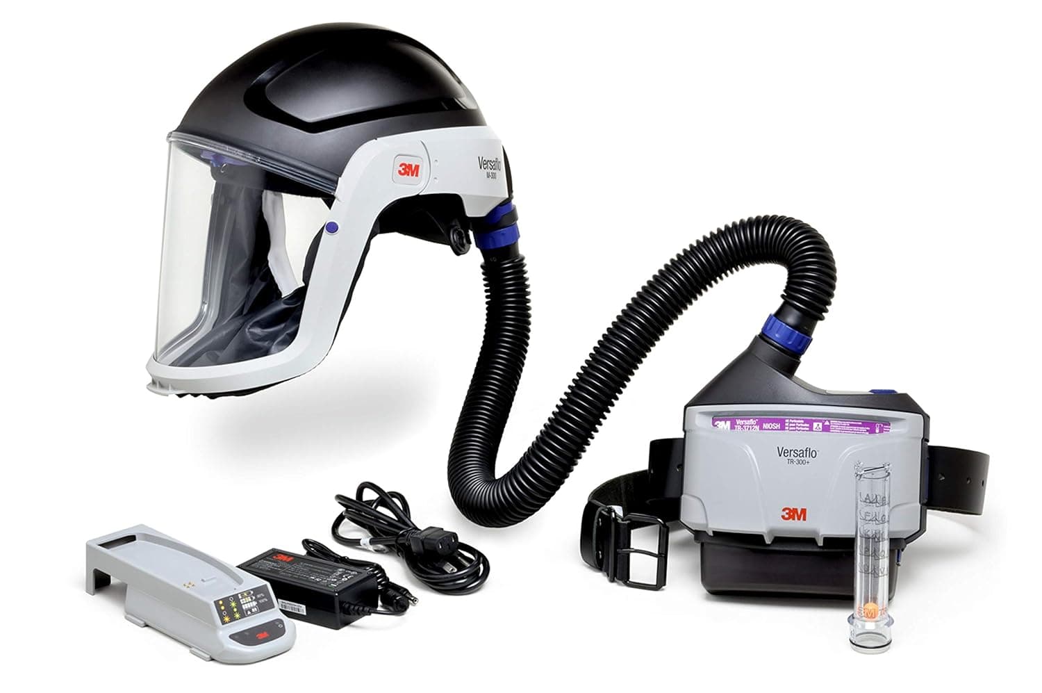

The ideal (but for cost) solution ia a PAPR (powered air purifying respirator). like the 3M Versaflow. HEPA filtration, a continuous flow of cool clean air, doesn’t fog glasses, works with a beard. It’s the only solution I know of that’s reasonably comfortable to wear 6-8 hours a day.
A “good sealing mask” is something that just doesn’t exist for most of us, certainly not if you have facial hair or a non-average face shape. The common paper N95 masks are AFAIK impossible to fully seal, the rubber gasketed ones can be made to seal but must be uncomfortably tight and will cause skin irritation or worse if used consistently.
I have a Versaflow PAPR I use for wood turning where controlling fine dust at the source is very hard. It also incorporates a hard hat and impact shield to intercept flying objects coming off the lathe.

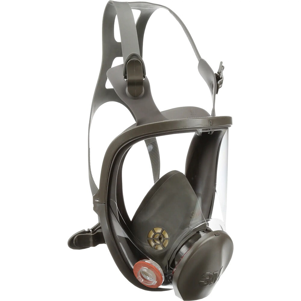

I was working in an 8 x 12 shed for years cutting and sanding exotic hardwoods (Bolivian
Rosewood, Katalox, Purpleheart, Zebrawood, Leopardwood, Ipe, Padauk) with S#!][Y dust collection, so I had dust on me and all over my shop. It took about 5-6 years, but I am now allergic to all of those woods. I bought Tyvek smocks, but those weren’t good enough, so I went to the full bunny suit and full face respirator (pic that is close enough to get the idea), but that just sucked in the summer.
Sweat dripping down my face, ugh. I ended up buying the 3M PAPR that @rogerwiegand mentioned, and OH MY DOG!!! If you ever need to wear a respirator for any length of time, this is AWESOME!!! Yes, it is stupid expensive, but man, having a cool breeze always blowing on your face and not having that rubber mask pressed up against your face, with the sweat and the heat and the closeness of the air. . . Ugh, I really wish I had bought it 10 years ago.
So, I guess the lesson is - and this is not specifically directed at you - do the best dust collection you can to prevent becoming allergic.

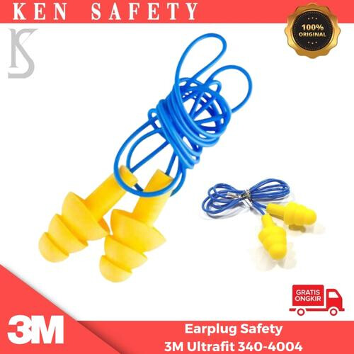

Oh yeah, I am a big baby when it comes to my hearing. I use these 3M Peltor X5 earmuffs and / or these triple flange ones:
I get the corded ones from work for free, and I actually bought a box of them (not corded) for home. They are 3M 340-4004, and a box of 100 pair is about $115, but that box is like 3 years old, and still has about 25 pairs or so left, so I think it was a good investment.
The Airshield Pro also has a fan to blow across your face but is all self contained rather than having a hose going to it. So, that makes it heavy on your head. The 3M is probably more comfortable to wear.
