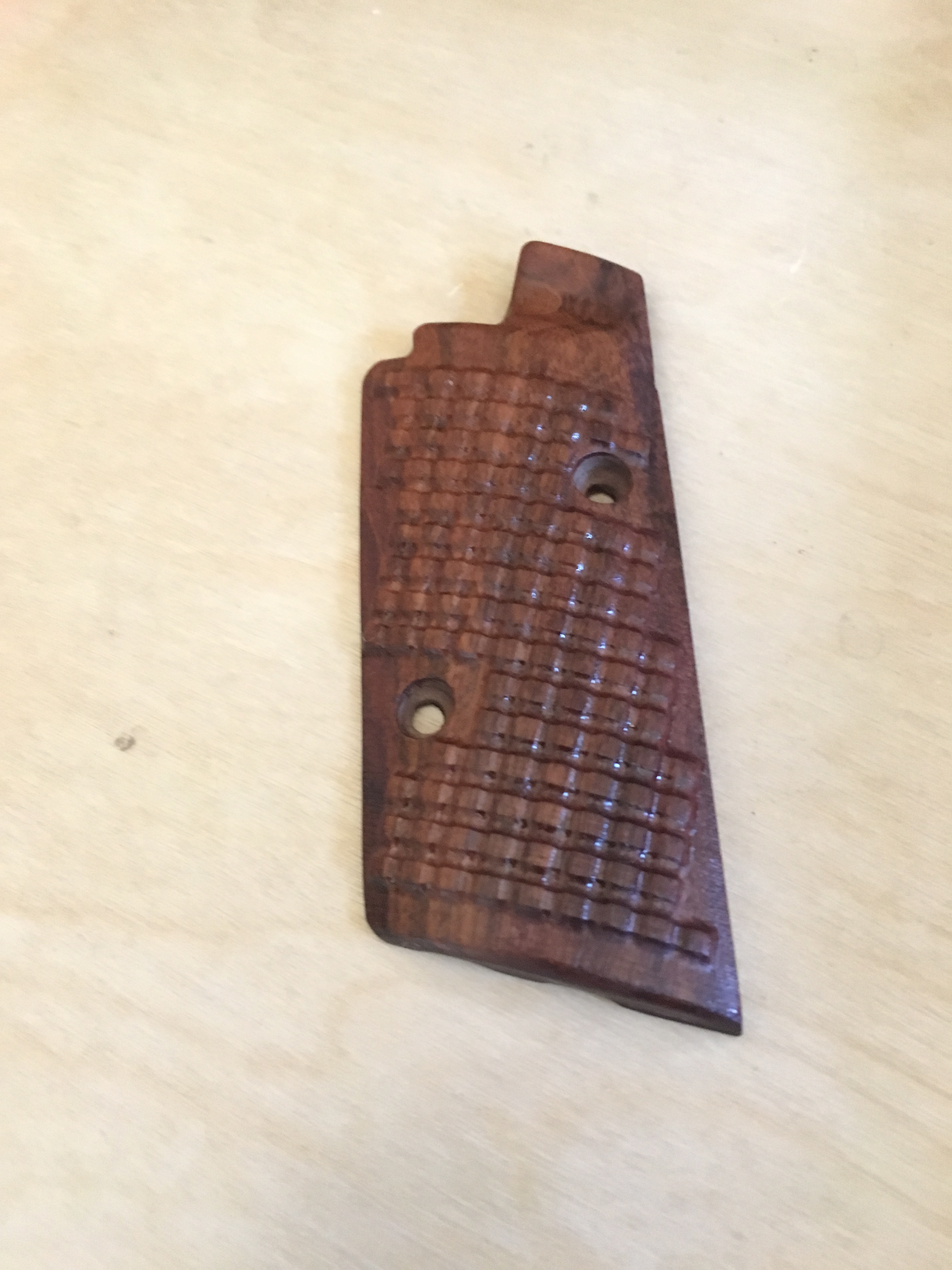

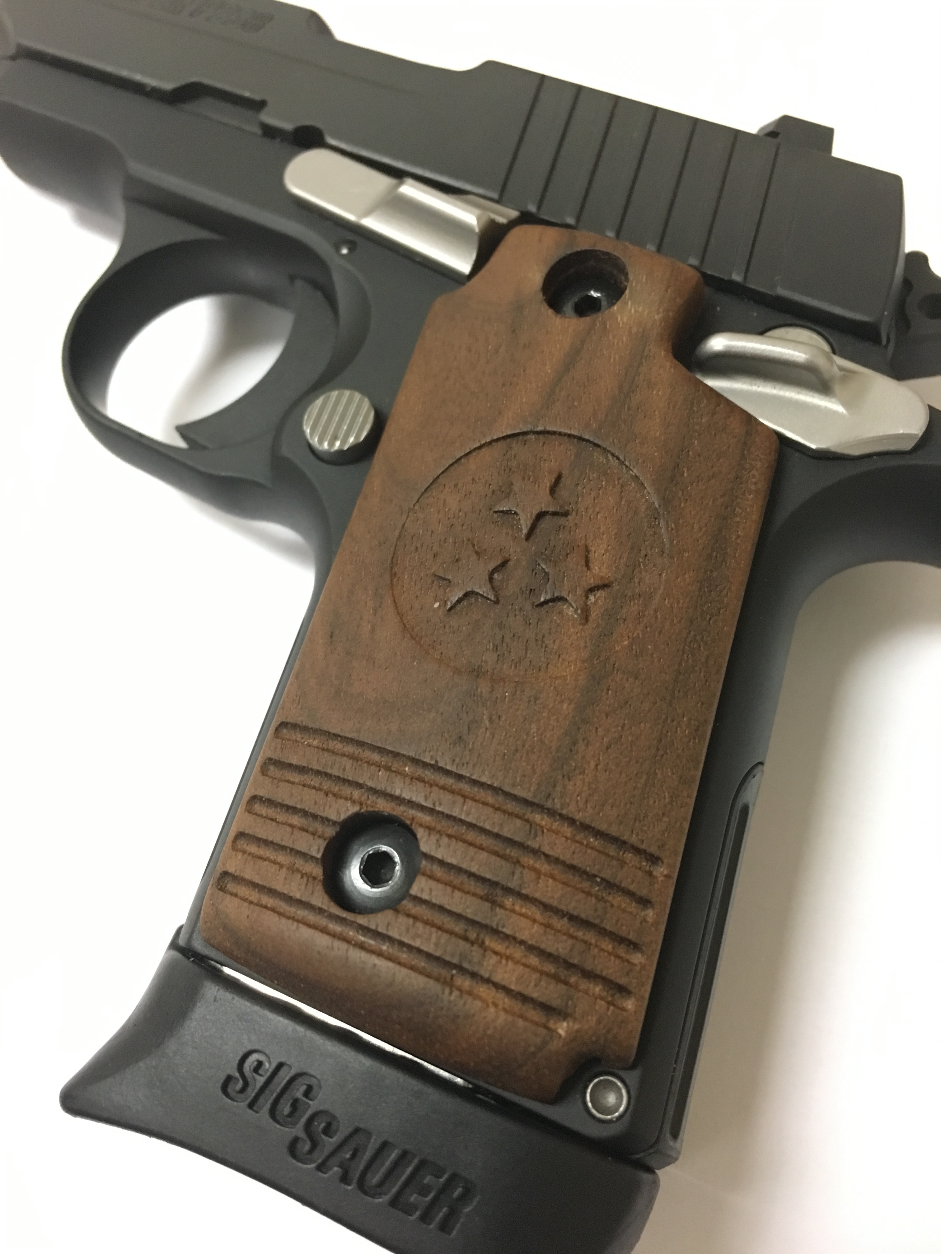

Yes, I think you are right. I ran some cocobola and then walnut. The walnut ran much better. I am designing some prototype gun grips for a new manufacturer. While experimenting I also made some for a Sig P238 with the Tennessee logo on to see how they would come out. Here are a couple of photos.
