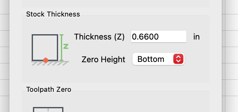

I want my final material thickness to be 5/8". I set my material thickness in CC and zero’d my machine to the top of the material in CM. I set my Max Depth to t+.625 (hoping for a 5/8" finished material thickness). But the machine is milling deeper than that. What am I doint wrong?
Maybe I shold be setting Stock Thickness/Zero Height to “bottom” and not “top”?
@dcolley

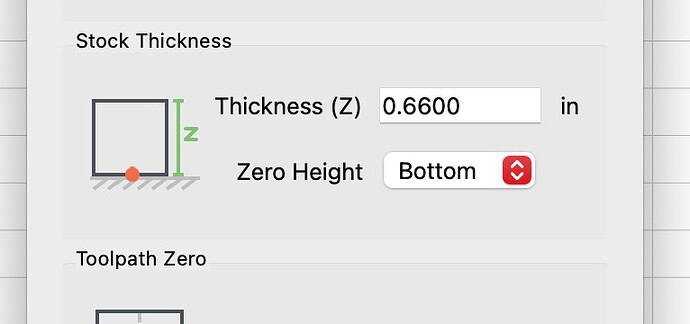

If you want to zero off the spoil board (stock bottom) then you need to zero there, not the “top of material”.
In the first pic your zero height is set to bottom. Change that to top if you are zeroing on the top as you described
sorry, yes. I screenshot it AFTER I changed it to bottom. I was set at top w/ Max Depth “t-.625”
After milling my meterial is NOT .625"! it is closer to 1/2"

So I’m doint it right then?

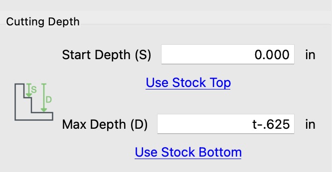

Set Zero Height to: Top
Set Max Depth (D) to: t-.625
Should it not be t+.625? Not thinking well here today…- would put you below t???
edit no that doesnt make sense :sweat_smile:

No, the simulation takes like 111 mins to run at t+.

I normally zero off the top of material. That sounds right but I don’t normally use this method either. You have to make sure the actual thickness is dead on and need to measure thickness in several place. Even if you split the difference from .5” to .0625 is only 0.0625” which is 1/16”. The material might be cupped or warped a little and this could be your result.

I know it’s the easy way to use t … but why not zero off the top and set your max depth to what ever the difference is between material thickness and 5/8"?
Thanks guys. I really think by formula and settings are right.
@Jeffish - that is probibly the best idea and what i’d do most of the time. But I have a bunch of boards that I am trying to flatten to the same thickness - without haveing to math… :rofl:
Im also using dbl-sided tape,which is adding about .004-ish to my thickness when fastened to the spoilboard.
