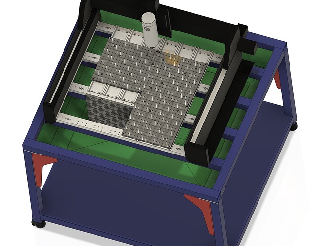

This is where the design is so far. Will be sand filled, welded base frame, welded upper enclosure, hinged panels on all sides except the front will have doors of some kind. Also considering a custom chip tray/chute thingy under the base frame with a bucket under that.
The side panels will all be custom made from 18ga sheet steel with acrylic polycarbonate windows.
Hi MG6,
I would recommend Polycarbonate for the windows. Shatter resistance…
Also if you ever want to add dust extraction you might want to raise the ceiling of the enclosure to allow for hose travel. I made my enclosures 4 feet tall on top to be able to lean in over the machine and have enough room to hang down a hose from the top.
Also might want to connect the leg bottoms together for added stability. The HDM has a lot of mass and when changing directions using rapids it can shake an enclosure quite a bit.
Congrats on purchasing an amazing machine!
Ditto on raise the roof. Plus, you will avoid cracking your head on that cross piece reaching in to do whatever.

I am going to have a downdraft slot at the back, and of course the dust / chip collection at the spindle. I have a similar design on my laser enclosure already. I’ll post later.
I already have cross beams supporting each nomad bar on the bottom of the HDM. It is way more beef than it will ever need. Plus, I’m filling them all with sand. Originally I was going to do a concrete bed like the Langmuir MR1, but decided that was massive overkill for my needs. I’m just going to run a mist system. I could always add or change to a wet system later if needed.
I am not done with the design. I am going to have gussets on every axis plane. There will be bracing on the legs, they will not move even in a hurricane. I did similar design structure on my Langmuir Crossfire Pro build and it is a tank, over built unnecessarily, but it looks great and cuts well.
@Griff Good point. Since I am using iterative and incremental design, lean ux, I am still revising the ergonomics. I am leaning towards a clamshell lid design for the enclosure, even though I modeled it as a frame to get started. I wanted to understand the physics of the dimensions first. Mine will wind up being a more square version of the DIY Engineering guys enclosure, but made out of steel rather than plywood.

Specs say 27"x21"x5.7". Does this orientation look right?

Design option 1 for the chip collector. This design would allow using coolant spray recirc. But I’m not thrilled with all the sheet metal work I’d have to do. As a hobby machinist-fab I’m not sure its worth the hassle. But, I also don’t want to deal with chips everywhere. It was a nightmare with my other router setup…chips everywhere. Hence the desire for an enclosure.
Thoughts?
Also, I finished the design for the vertical work holding area and SMW fixture plate.
I have arrived at the final divergence design for the hopper.

On this - if you can go for more even angles - you will get less chip build up on the shallow angles.
