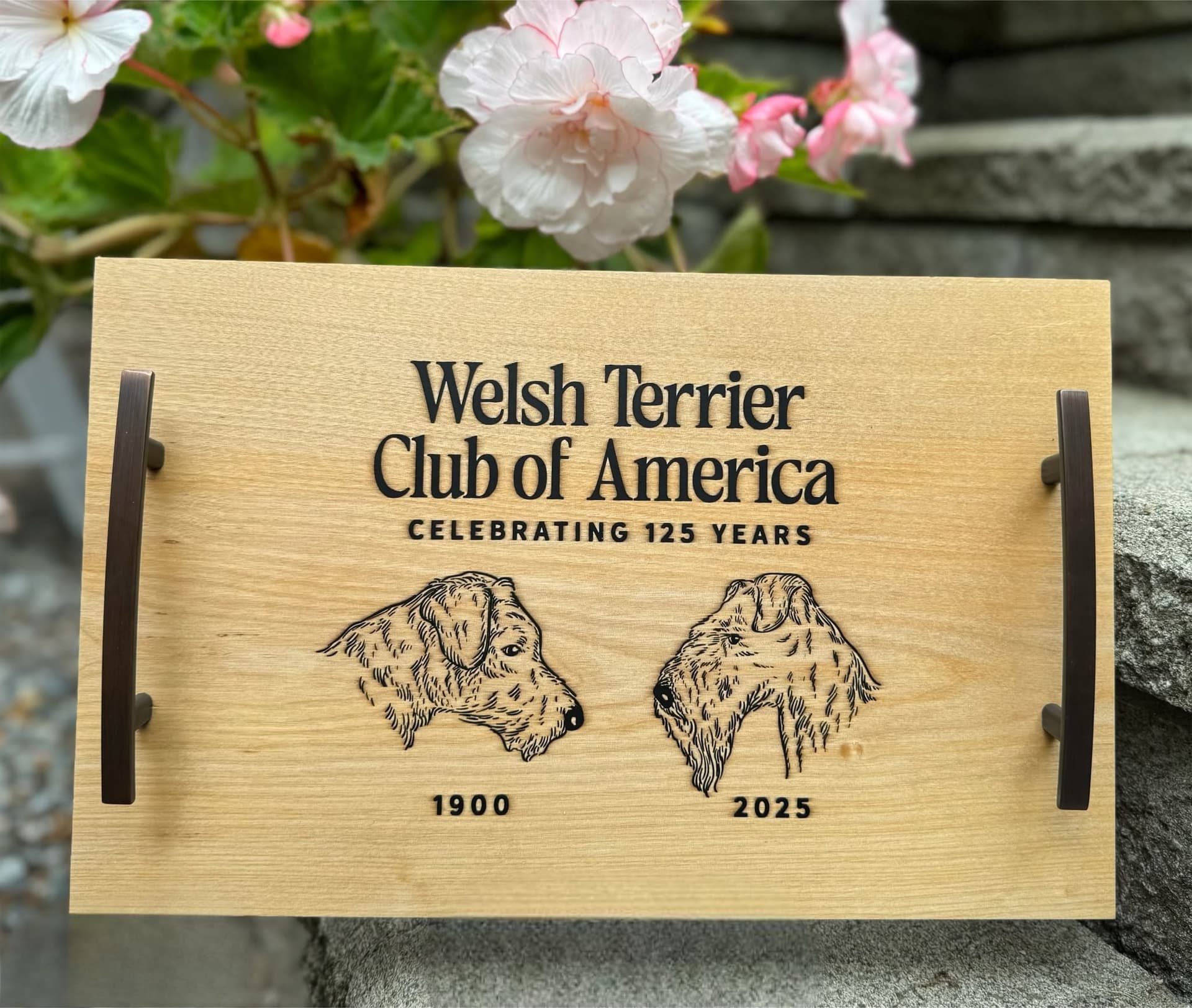

How are people finishing their letters on v-carved charcuterie boards. Most of the ones I see on Etsy are laser engraved, but I don’t have a laser engraver. I want to use my CNC but do the letters stand out enough if they are just carved?
I personally think that anything intended for food service should have a completely smooth surface, so that it can be cleaned properly.
Unless intended only for display or as artwork, I would never consider using laser engraving, nor would I leave a board just V Carved.
Any serving item I have created I have V Carved then filled with epoxy, sanded smooth and then finished with something that helps seal the surface so it doesn’t absorb anything - I have had good success with ‘Odie’s Oil’. It’s not cheap, but it’s easy to use and so far very durable.
My first thought with something like that would be make the large letters big enough to do them with inlays with a dark wood like walnut, ebony, etc… Then I would do the rest with Vcarves and colored epoxy which is easy and fun.
