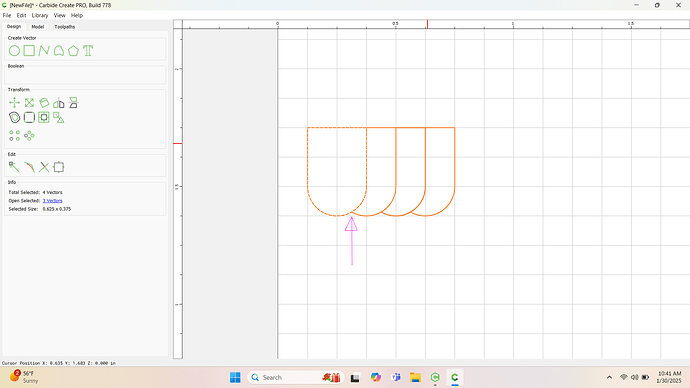

If you were looking at the sideways view of your endmill, where the red arrow is in the pic above, this would be the material between each pass of a ball nose endmill, which would represent stepover. Now, the smaller the stepover, the smaller that material lump that is left behind. Technically you will never get rid of that lump if you reduced the stepover to mere movements for better surface finish, but the smaller the stepover the less of the lump you will feel, until you have a surface that feels smooth to the touch, but has micro lumps between passes, if this makes sense.

It would be better to look at this pic as these progressive shapes being the side of your endmill, and that spot where the arrow is represents the material left behind between ball nose endmill toolpaths.
