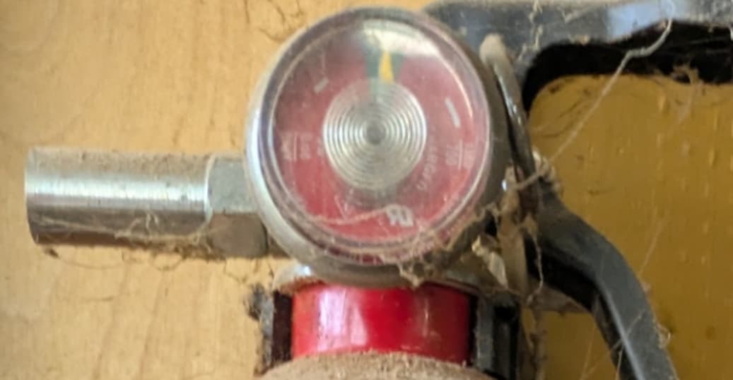

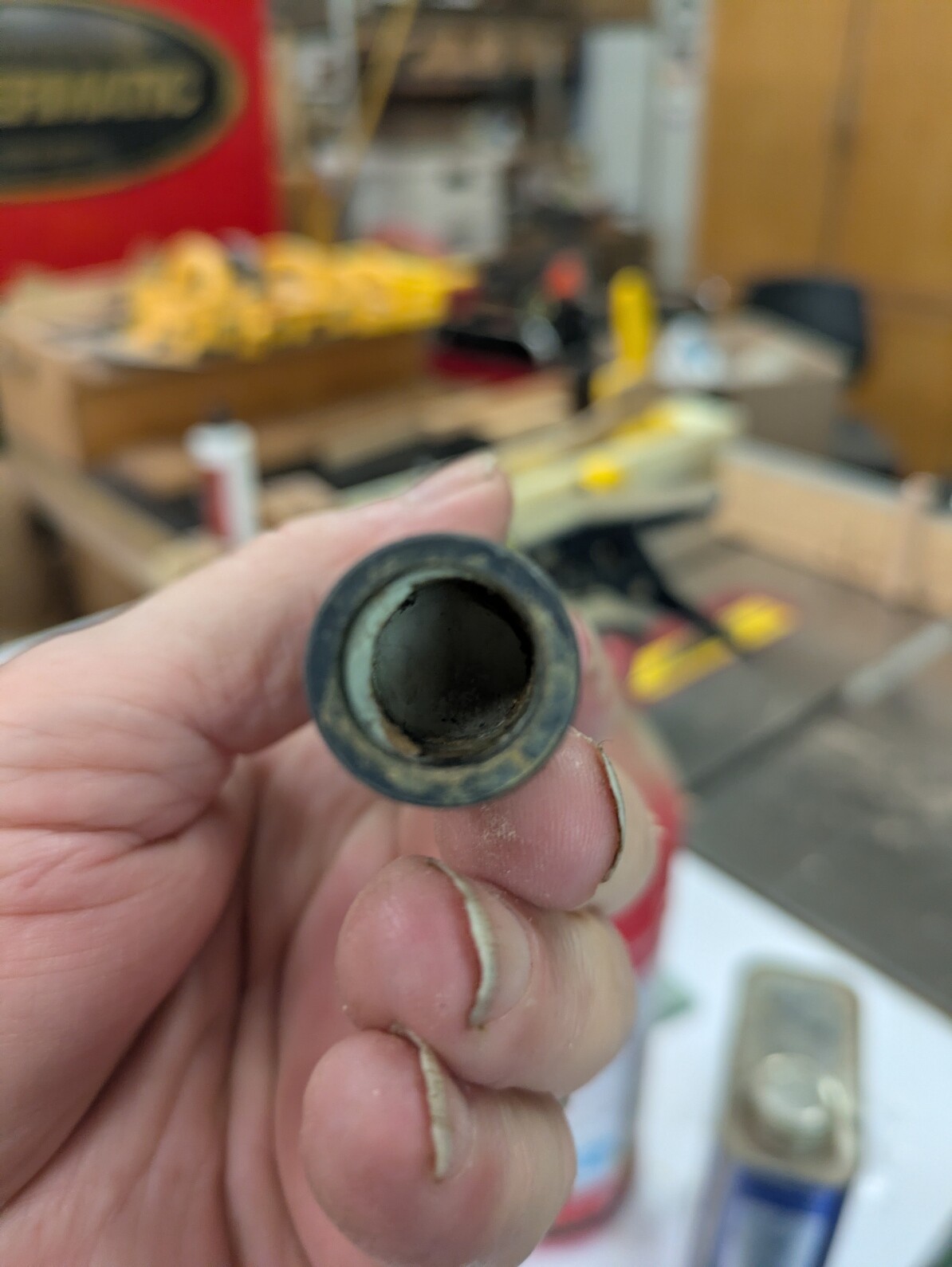

Hopefully you have a fire extinguisher in your shop. I have two inside the shop and one outside the roll up door to my shop. I noticed the one outside had the gauge in the red. I did not know that fire extinguishers expire. Even if the one outside had not gone flat it would not have worked because a dirt dobber had a nest inside the nozzle. I bought a new one at Walmart for $50.00.

Here is a picture of my old outside fire extinguisher.

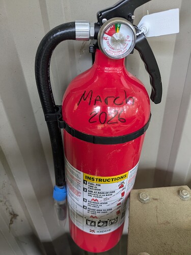

A dirt dobber had a nest inside the nozzle. I put a plastic bag over the nozzle of my new extinguisher to prevent a bug from getting inside.
I loosely wraped painters tape around the outside of the plastic bag so it would fly off if used. I think it will keep critters out of the extinguisher.
I wrote the date I installed the new extinguisher so I can visually see when it expires in 10 years.
I highly recommend you inspect your fire extinguishers. They do not have an expiration date but they do have a manufacture date. So after 10 years they should be replaced. I understand even if the pressure gauge still has pressure the chemicals inside can solidify and would not spray out when needed.
