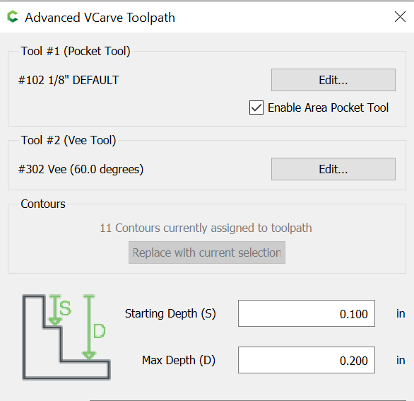

Today I did my first attempt at vcarve inlay and I need some help troubleshooting why it did not turn out.
for the pocket side these are my tool path and settings
The plug side was set like this:
Any insights would be appreciated.
Did you use a 60deg cutter? The picture looks like either a 90deg (cutting away more than you expected), or your Z-zero is too deep
Thank you for the quick response and helpful feedback. Here is the carve bit I used. I was told it was a 60, and the geometry works out that way(I think), so maybe on both change I did not get the z correct with the probe.
Comparing angles on endmills is difficult — Maybe cut a V slot and then machine off half of it so you can see the profile?
How thick was your stock for the male inlay?
It was 1/2 inch poplar stock for the male side and 1/2inch alder for the female. Maybe poplar too soft and chips too easy?? Just for reference the piece is 3"x3"
