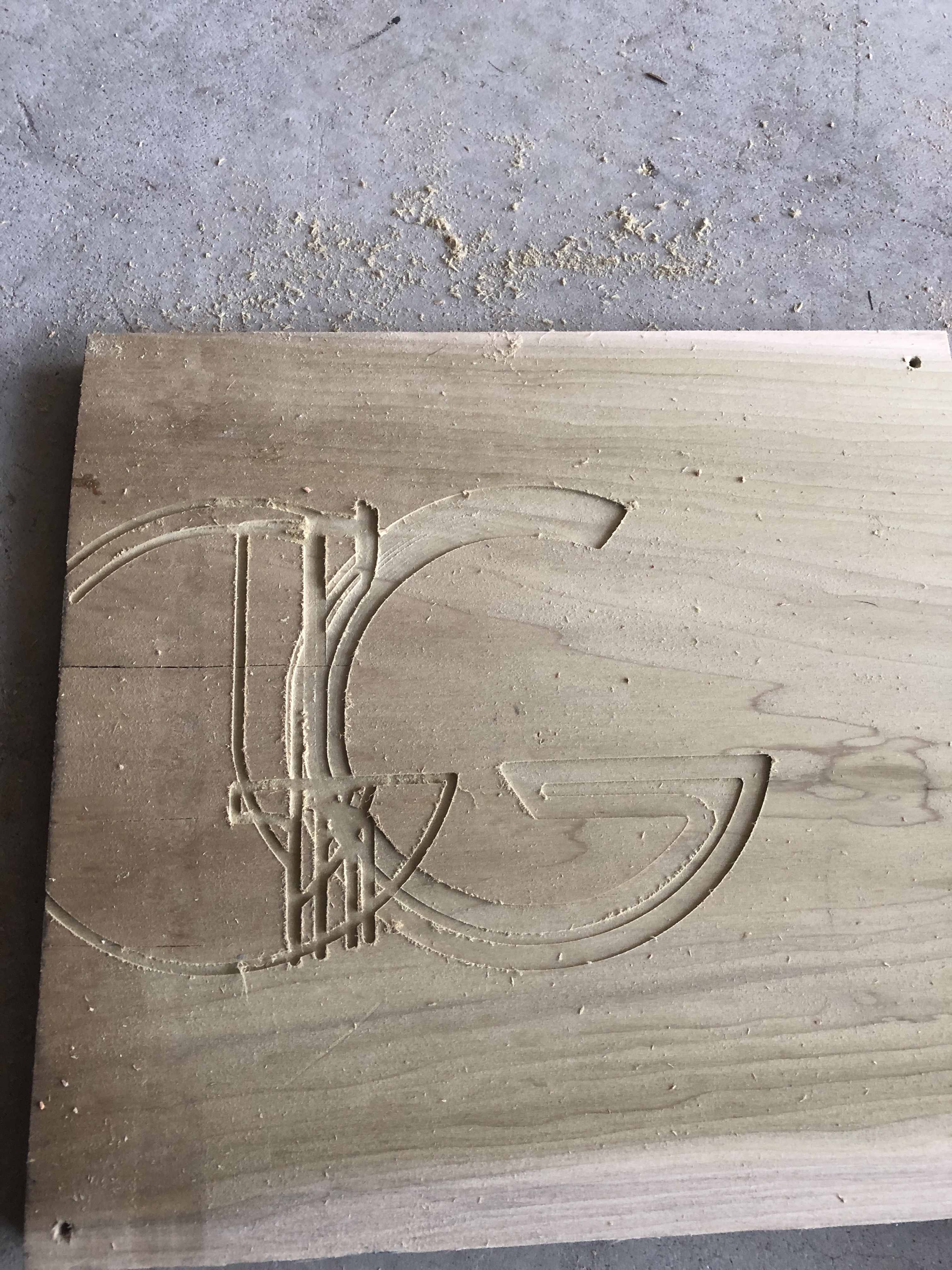

I set up a simple file with 6 parts designed in illustrator and CAMed in Carbide Create. Basic 1/4in endmill doing an outside cut through material with tabs. When it executed, it did one pass around the first part, and then somehow the entire file/drawing shifted down about an inch. the second pass proceeded to overlap the first, and 2 of the parts were hanging off the bottom of my stock as a result of the shift.
I tried re-cutting the 3 bad parts and the same thing happened. Any help would be much appreciated!!

So I’ve been pulling my hair out today over this issue. I’m more convinced it’s G-Code related and not the machine. I ran it a second time on a piece that was previously cut so that the machine was not under any chip load and it did the same thing. It was at the top right corner of the top right piece where I hear a grinding noise and I checked the Y axis and there is no slipping of the belt. I tried drawing a square in Carbide Create and it ran fine - I tried running another file that was made on the computer and it seemed to run fine.

Usually the motor skipping steps. Are you reaching the machine’s limits? Basically, is the gantry crashing at the top of your design? Was the first pass dimensionally accurate?
Another possibility could be a loose / broken connection on a Y stepper
Gcode is fine…no reason to cause what you’re describing.

Bingo this was it - being the total newbie that I am I didn’t realize there was so much un-usable space towards the back. Thanks for all the help!!
