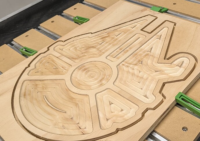

Today I made my first cuts with the machine, working on a “rough draft” of a project I hope to complete in the coming weeks. Inspired by the following Youtube video, I decided to build a snack tray shaped like a famous space ship:
I designed my own version in Inkscape, then brough that into Carbide Create and assigned toolpaths.
I was trying to figure out if I had the size and shapes correct before using an expensive hardwood, so I used 3/4 inch plywood to start.
The outside contour toolpath was 0.5" deep and I used the #201 1/4" bit. No problems there. I set zeros manually using the wiggle a piece of paper method.
Then I used a 3/4" bowl bit for the pockets which were supposed to be 0.25" deep, and that’s where things got a little funny. I cut the contour first, then Carbide motion prompted me for a tool change before the pocket paths.
I put in the bowl bit in, and Carbide motion seemed to re-calibrated using my BitSetter. But, all of the following pocket paths started “in the air”, and ended up therefore being shallower than I had designed. It’s almost like the BitSetter didn’t work?
Can anyone point me in the right direction to troubleshoot this?

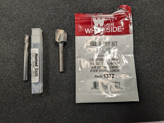

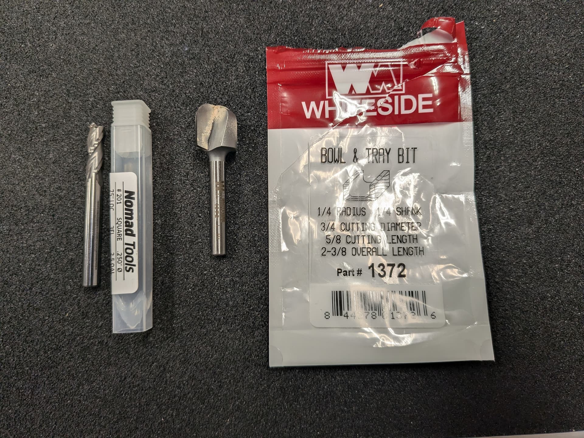

I’ve also attached a picture of the two tools that I used:
Unfortunately I don’t have a picture showing the machine at zero position as I zeroed on the top surface of the lower left corner of the workpiece, which I’ve since removed from the table.
I should add that I used the 1/4" tool to set zeroes.
It’s best to leave stock clamped in place until you’ve sorted things out or decided that you’re not going to try another run.
The tools seem to be of similar lengths, so it seems unlikely that the machine bottomed out trying to move down.

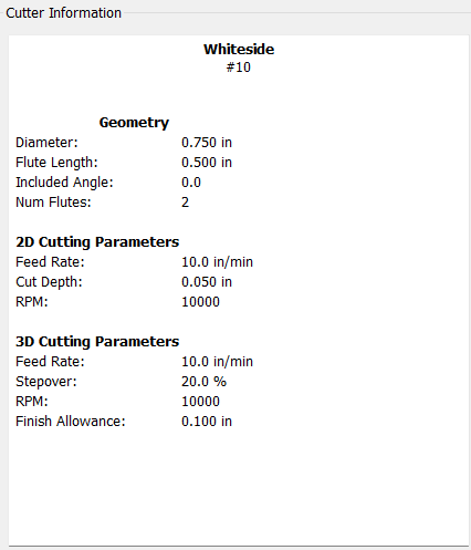

Doing some further investigation into this problem, haven’t had time to run another test cut yet, but got to wondering.
I had to add my 3/4" bowl bit to Carbide Create manually as it didn’t exist in the library. Could incorrect geometry parameters cause the problem I experienced? Here is what I set:
Screenshot 2024-06-25 152956
No, the only parameter for an end mill in a pocket path that would affect the cutter path is the diameter.
Cut depth affects the number of layers/levels, but the path should be the same on each level.
Depth is controlled by the max depth setting in the toolpath.
The issue you’re having must be in the process of changing & measuring the tools.
I would start by separating the paths by tool, and disabling the bitsetter and setting the Z zero manually for each tool. Then once you’re confident, turn the bitsetter back on, but use the “Measure Tool / Change Tool” button (if it’s still there), and double check your Z zero before executing the toolpath.
At that point, when the program asks you to change the tool, look at the Z value in the readout.
Since you already measured that tool, it should go to the bitsetter, come back, and the Z value should be the same.
