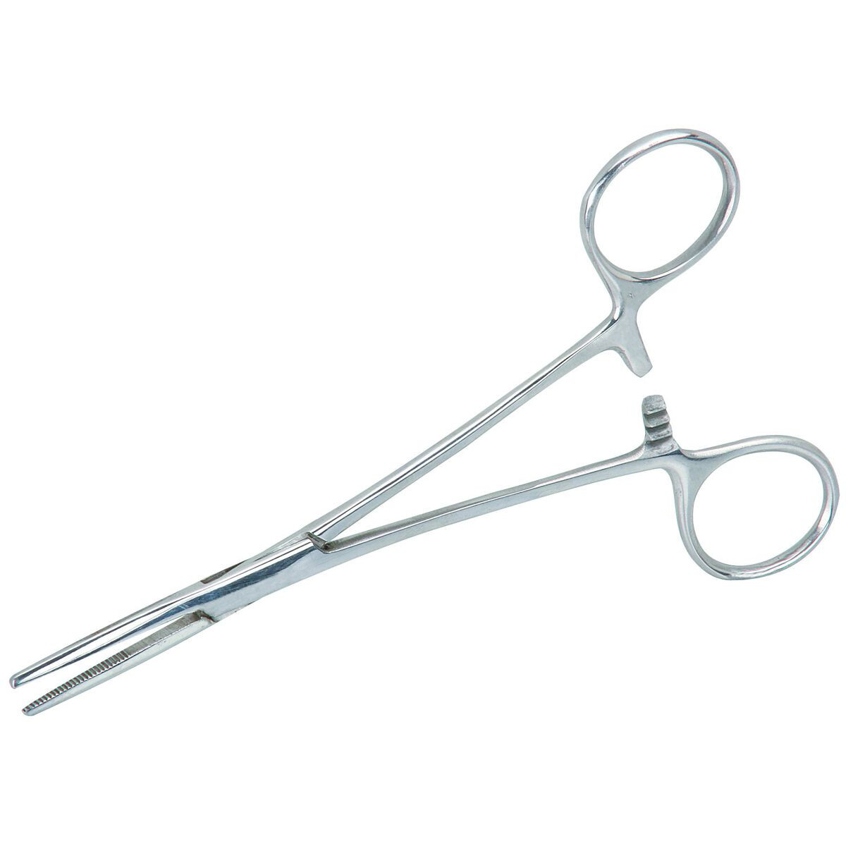

I was using the machine about four times a week. The biggest challenge was the belt would slip loose from the clip while trying to tighten the M5 screw.
I have a Shapeoko 3 but the belt issue on a new belt is the same. I use a medical clamp to hold the belt in place so it does not slip out of place while I tighten the bolt.
Once the belt is in place a while it gets a crimp that will stay usually if you have to remove the belt for some reason.
