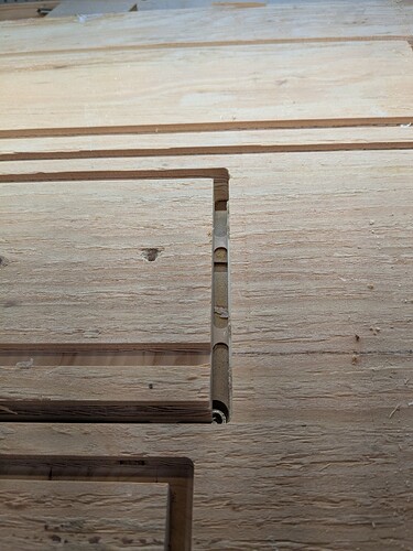

I did make 2D Pockets (#251) for the cutout down a 1/2" from the Top, then a Contour (#201) with tabs for the last 1/4" .

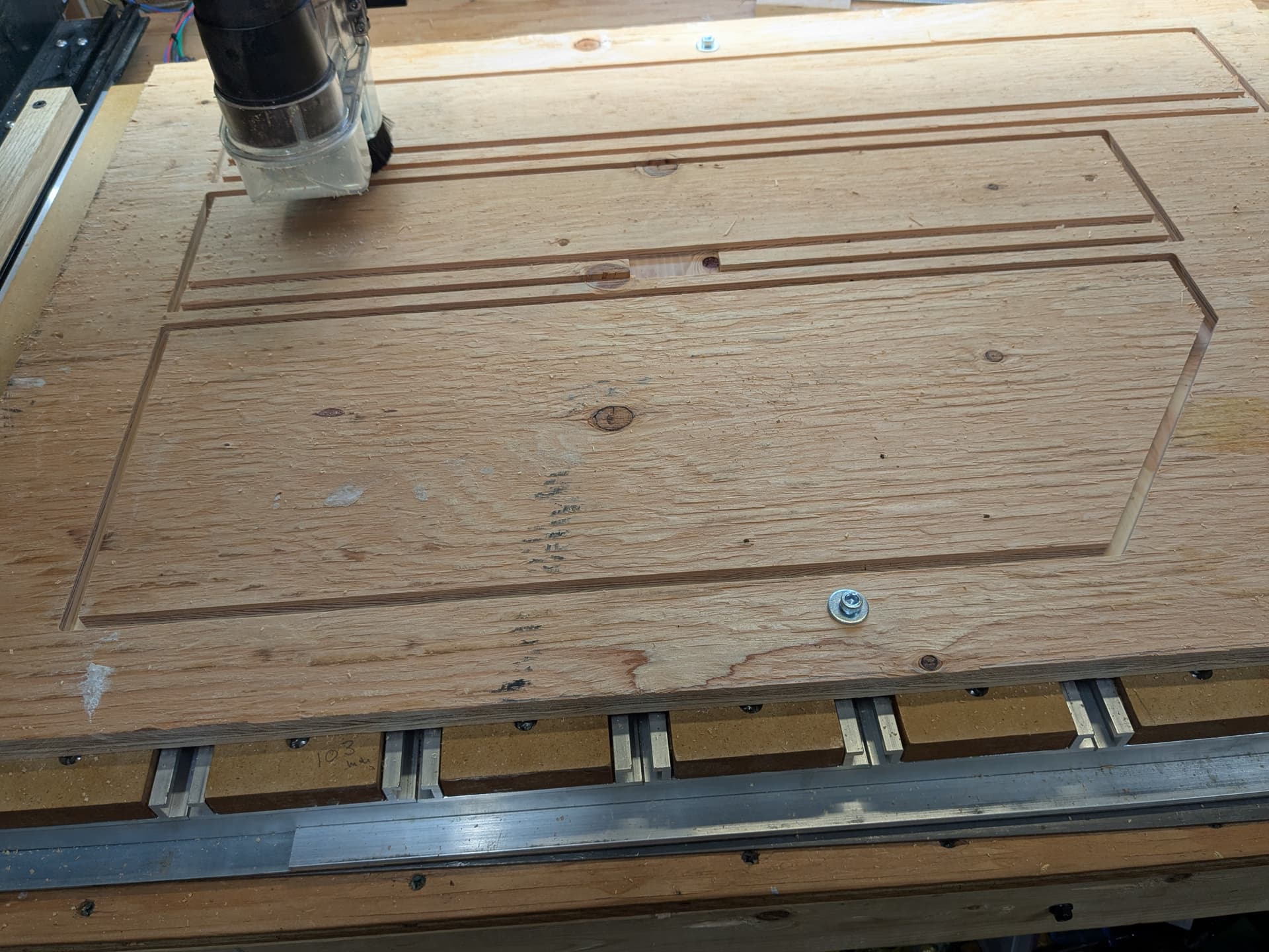

So far it looks good to me. This is a functional piece, not art work.
I screwed up and have a real shallow ramp, but they may have helped.
I actually spend it up to %140, no nasty noises.
On to the #201 for the last 1/4 " of cutout. All appendages crossed.
Looks good . I had to run @ 40% IPM.
This is a success in my book. All the bits still look good as well.
I need to raise the height of the tabs, some snapped off during cutting but the part didn’t move.

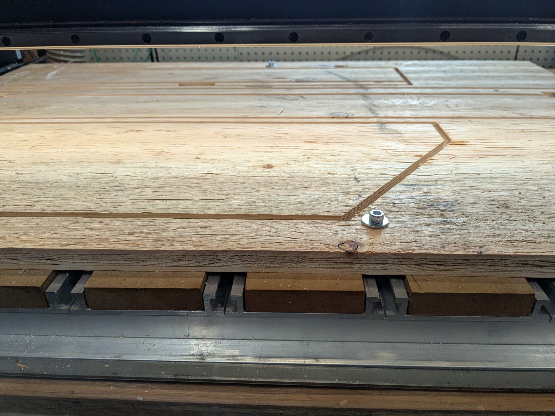

The plywood had a 1/8" bow in it and I didn’t have a way to clamp it down.
So I temporarily clamped the edges and pocketed 0.35 holes (2) through the plywood at a location ( I said the Thk was 0.95 to get over the material ) that was over a T slot and not in the product area.
I used 1/4 washers ( 3/4 OD ) and the 6mm screws to squish the plywood down and remove the temporary clamps.
Now it’s secured enough.
