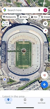

I’ve never been to Neyland Stadium and I’ve been to Sanford once, but didn’t see much of it. So everything was done via Google Maps, Google Street View and images on Google. I took a screen shot of the aerial view on Google Maps and used that as a reference for the overall shape and spacing. Then used images to create the rest.

Of course, I’ll take a shot at it. No past experience with the exception of CAD software. My background is engineering, so Solidworks is what I used to model it.
I took a screenshot like this (Google Maps):
I dropped this image into Solidworks and used this as a guide to create a 2D footprint of the stadium features. Once that was built and polished up, I used the “Google Street” views to get the 360 degree view of the stadium from multiple vantage points. Neyland Stadium had quite a few views available so it was like I was able to walk around the stadium.
If you notice, the 360 degree “street view” was taken in 2014, so it doesn’t capture changes within the past 10 years. That is where I go to Google images to find recent pictures. For instance, the scoreboard on the northwest end of the stadium didn’t exist in 2014.
At this point, it is really just free hand to try to match the stadium design as close as you can.
The end result looks something like this:
I hope that helps!
