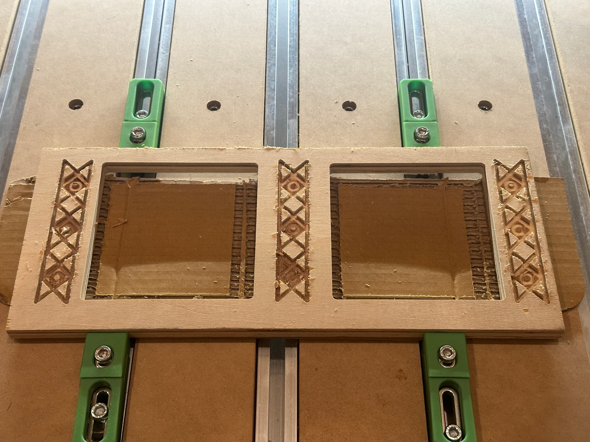

Success!
Not perfect, but we were able to cut two squares and add some detail design work without breaking anything…or burning down the house.
I forgot to adjust the depth per pass on the design, so it tore out, but overall it was a fun learning experience. One almost dangerous experience was that the inner squares I cut out (all the way through) started flopping and flying around as the last pass was breaking through…and that caused some pieces to fly out and throw off the cut a little.
@fuelfire @WillAdams @Tod1d @Redlander @Woodcrafter @CullenS @Stankus
Thanks everyone for your patience and support!
Any interior area which is cut completely free is a potential projectile.
Use tabs:
https://carbide3d.com/hub/courses/create/tabs/
or some other workholding method which will keep them secure — alternately, for my part, any internal element which is too small to be a useful piece of stock for a future project gets machined away (my time is more valuable than the machine’s).
