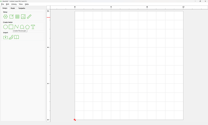

She want’s to cut a perfect 8 x 8 square out of a 12 x 12 pine board (cabinet grade 12 ply) that’s 3/4 thick. The end result will look like a frame and that’s what she would like as a part of her bigger project.
  1. Is there a file that we can use that has a square border that we can adjust for this purpose? Such as a square sign? If not, I welcome guidance on making this square cut out in carbide create - I’ve watch the tutorials.

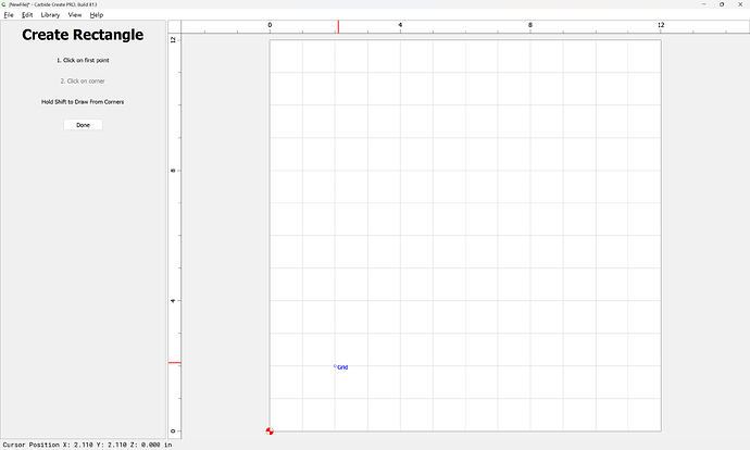

If you want a plain square, just use the line tool and draw a square. I you want something more fancy you can use inkscape.

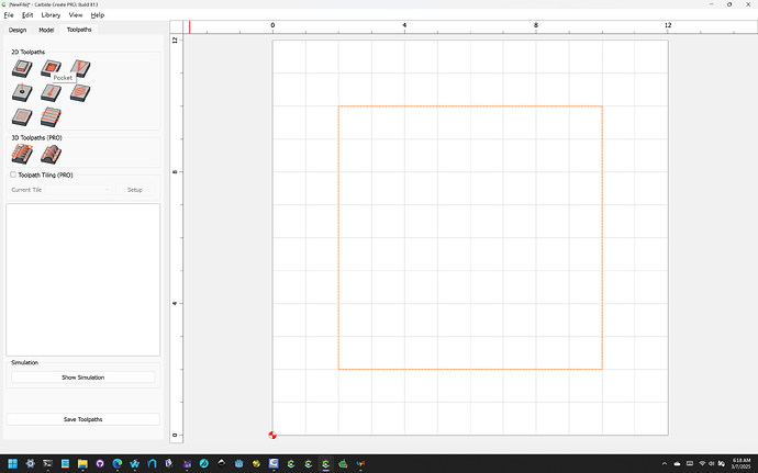

See attached for her project. She has a 12 x 12 square and wants to cut a clean and exact 8x8 out of the exact center. Any more suggestions?

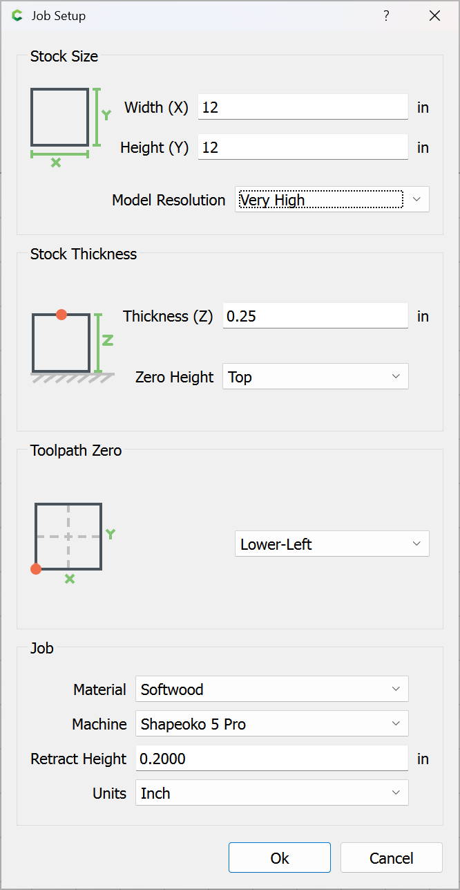

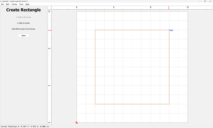

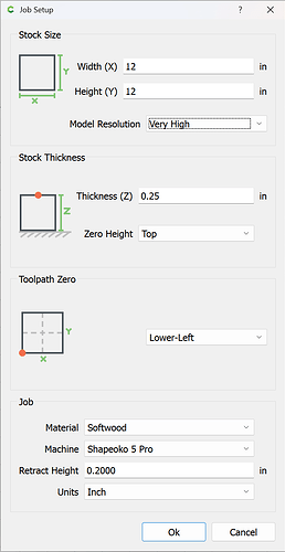

First, set the Stock to the correct size as described in:

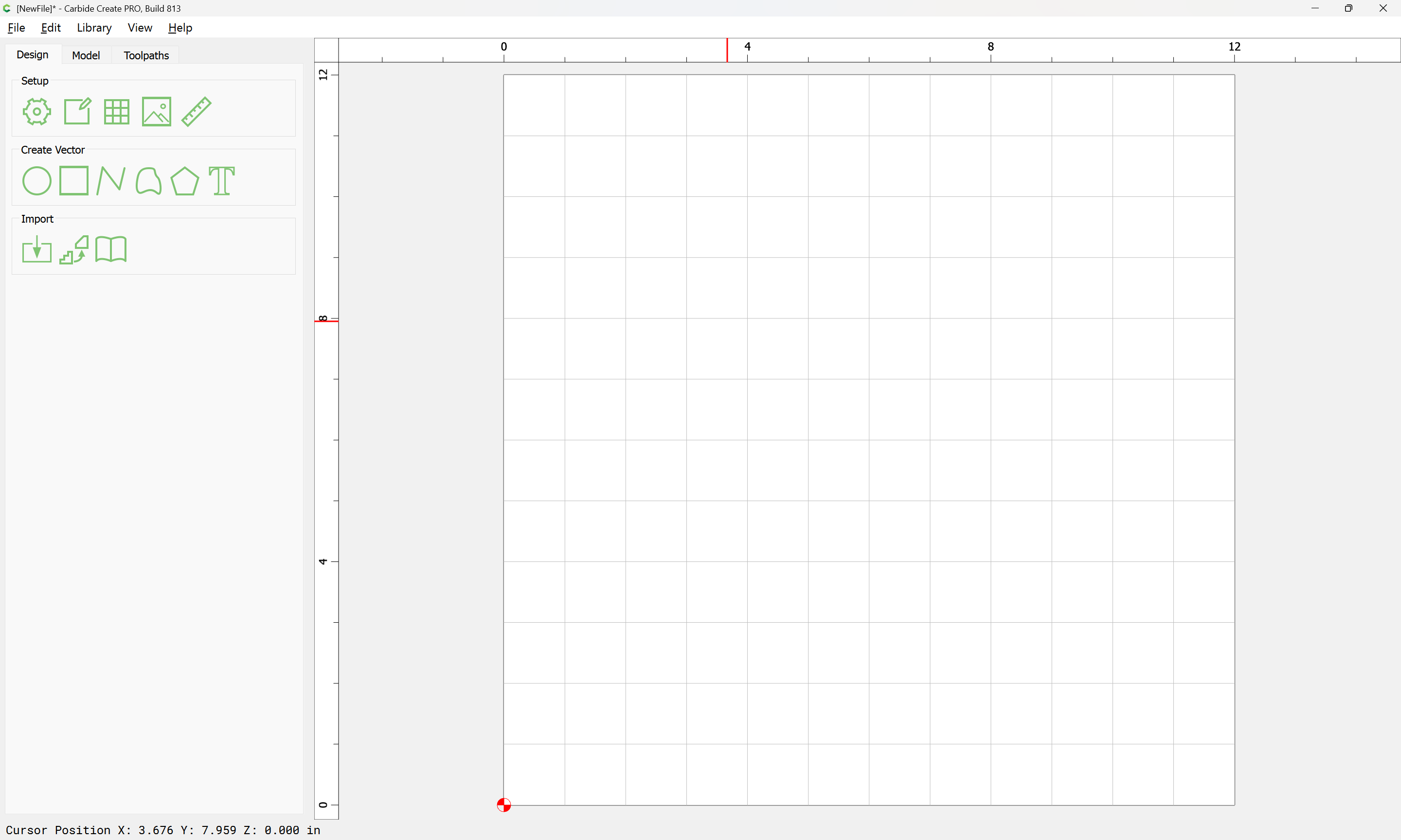

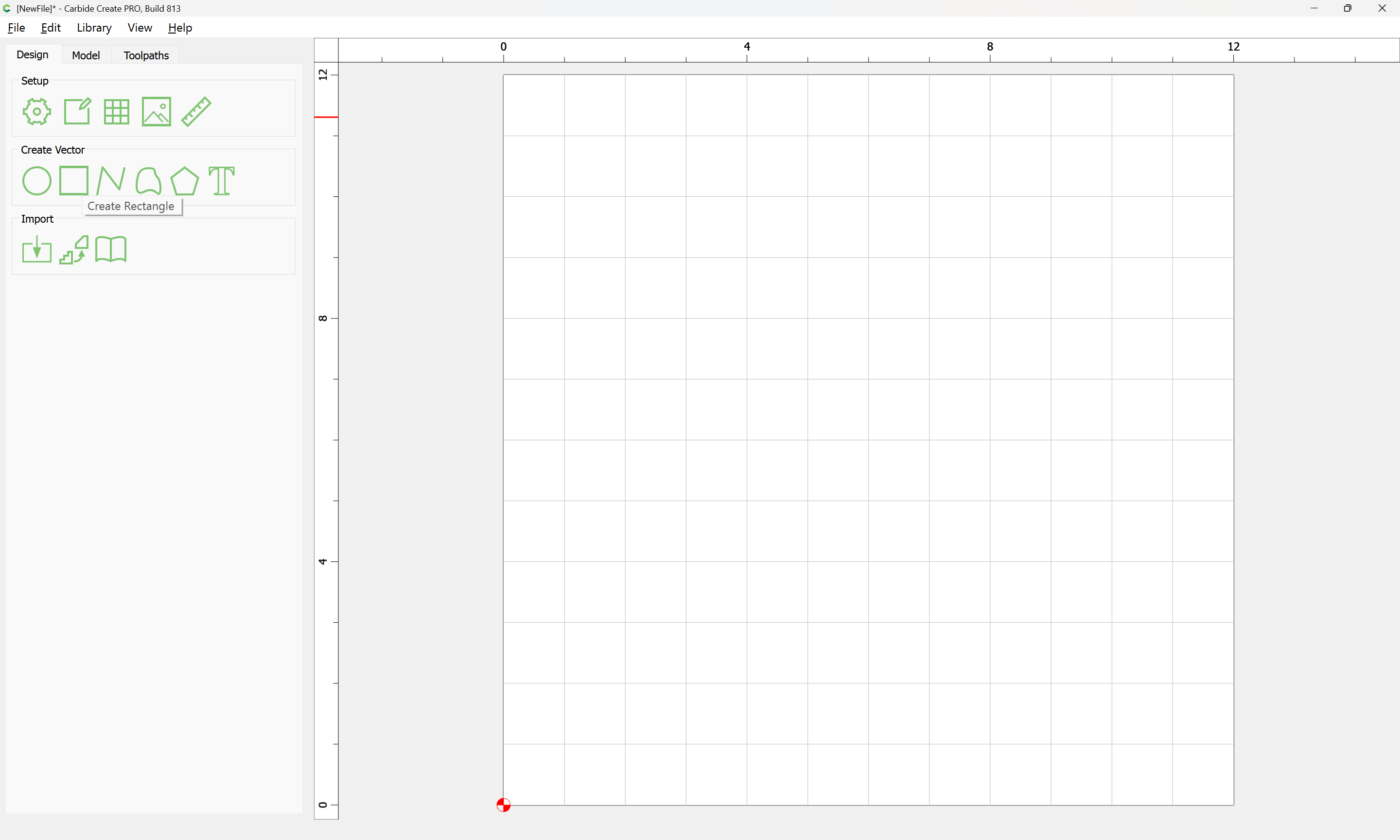

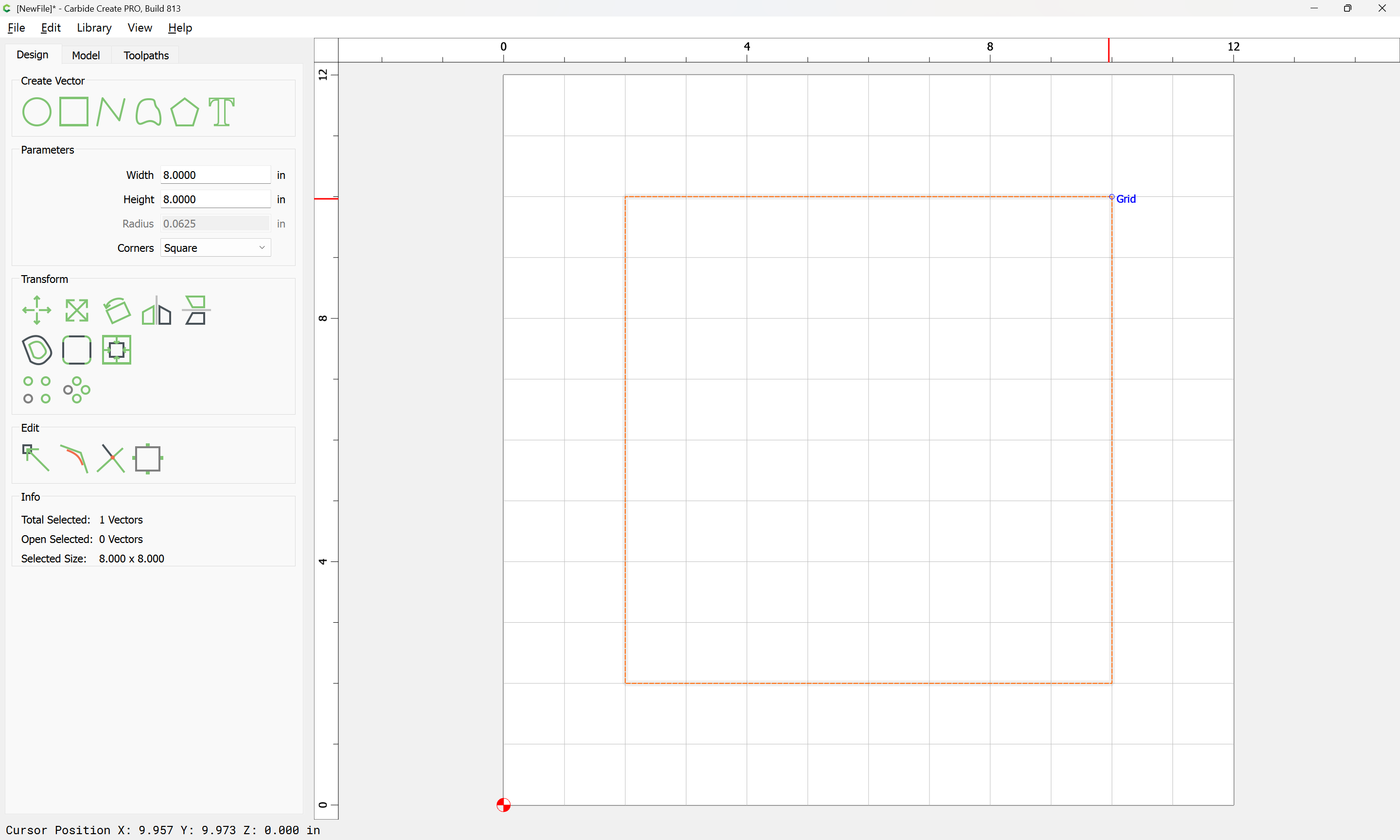

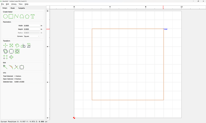

Then draw an 8" x 8" square as described in:
https://carbide3d.com/hub/courses/create/shapes/
and
https://carbide3d.com/hub/courses/create/object-manipulation/

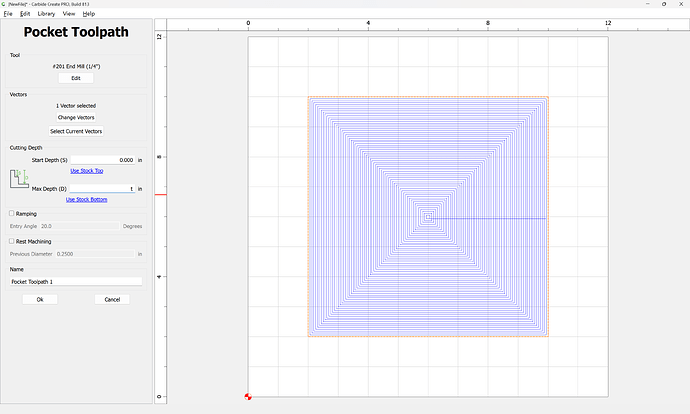

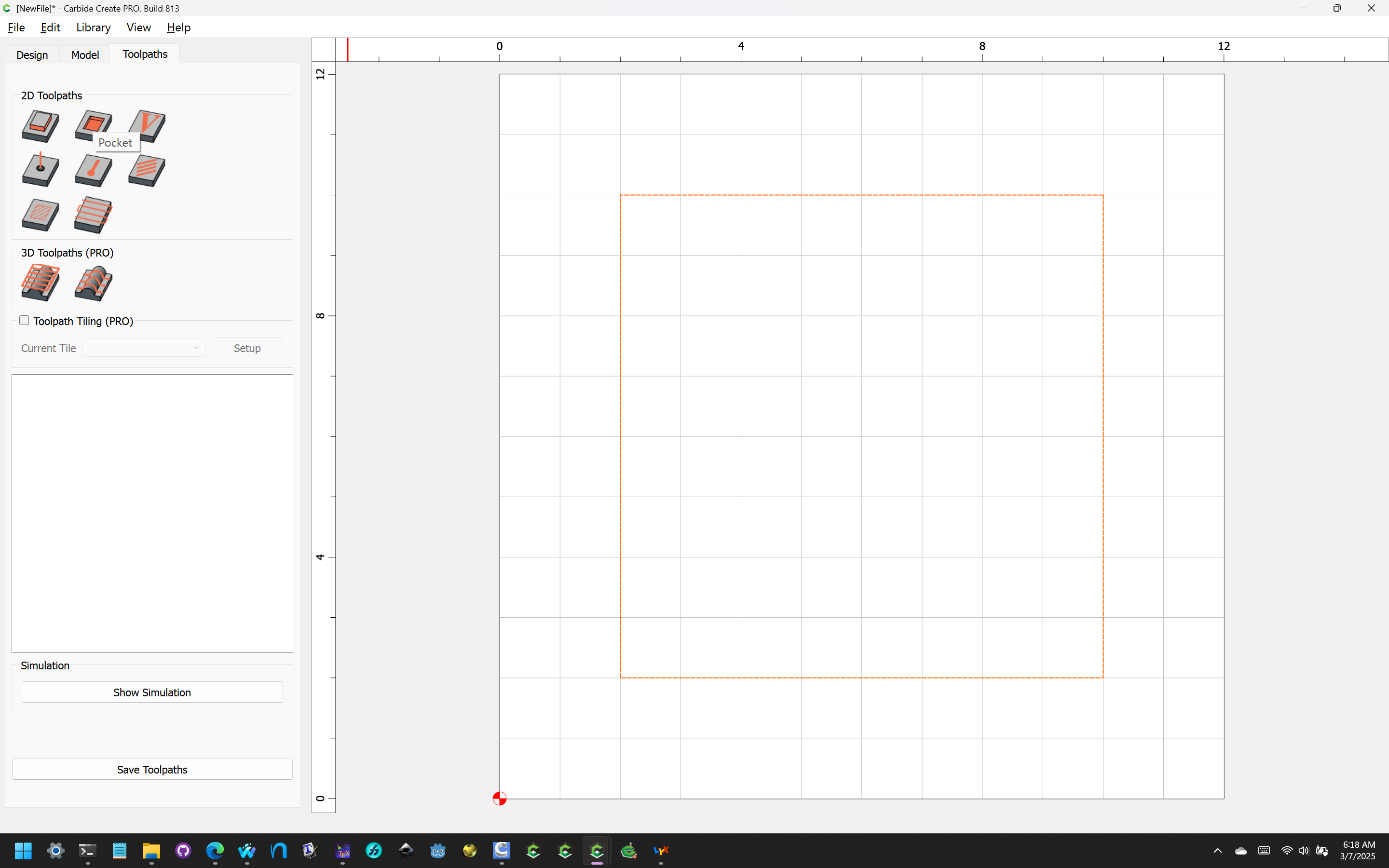

Then assign a toolpath as described in:
https://carbide3d.com/hub/courses/create/toolpaths/

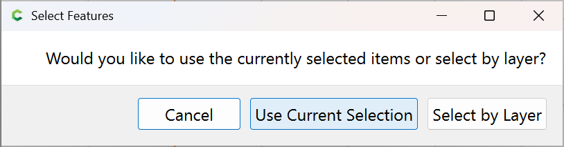

Use Current Selection
Select a suitable tool as described at:
https://carbide3d.com/hub/courses/create/tool-library/
(note that the size of the tool will determine the radius at the corners)

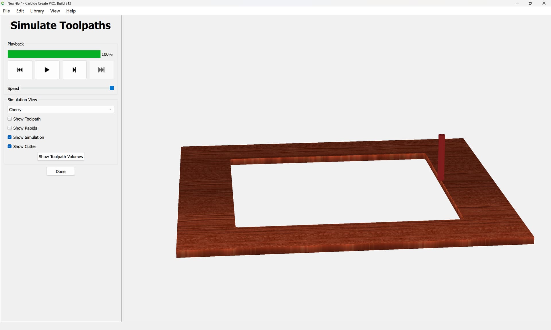

and verify it in 3D as shown at:
https://carbide3d.com/hub/courses/create/simulation/
Setting the zero relative to the stock is as shown in:
which should have been covered at:
https://carbide3d.com/hub/courses/running-shapeoko/hello-world/
c.f.,
I would recommend working through a couple of the projects at:
https://my.carbide3d.com/#Projects
before striking out on your own.

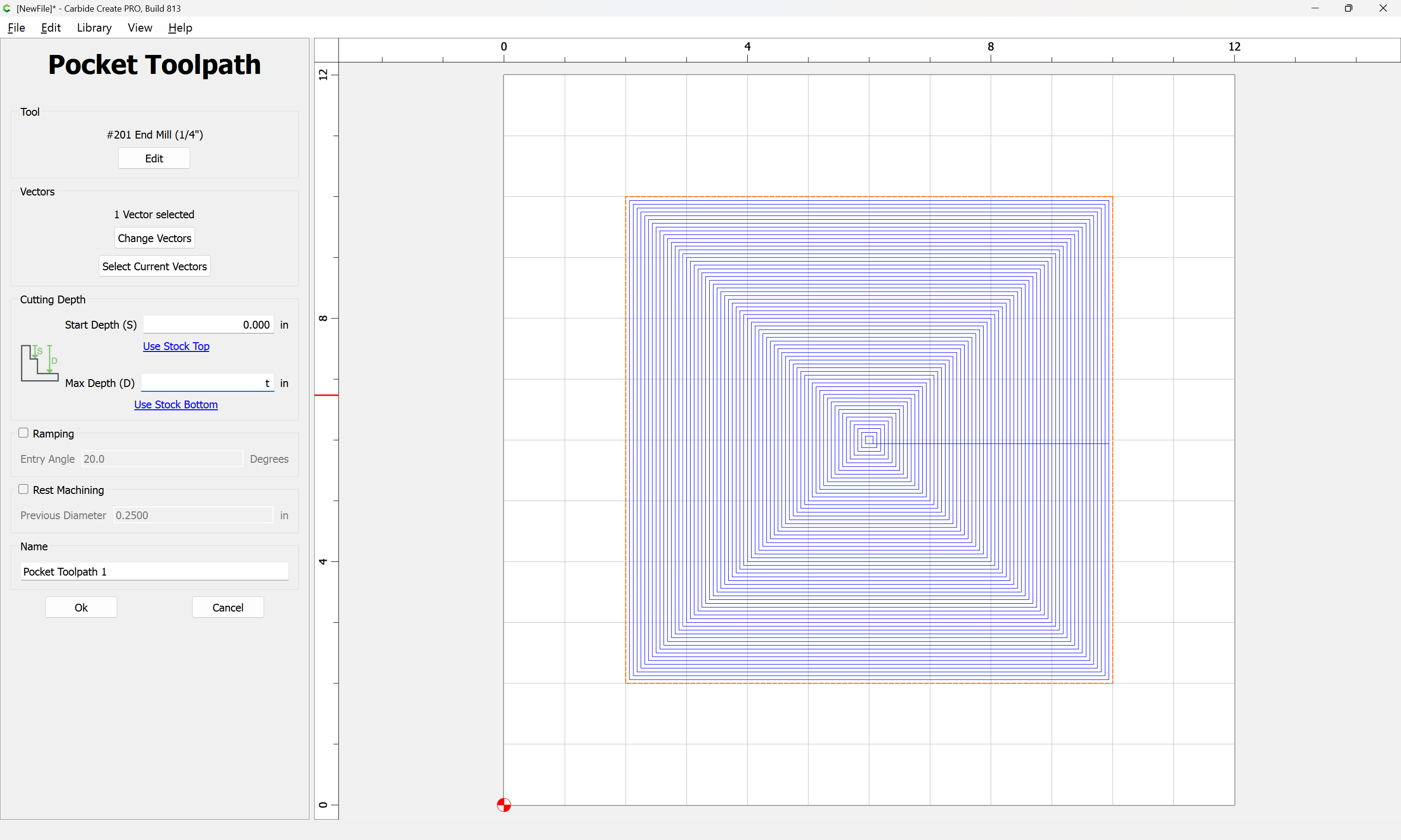

I know he said he wanted to a hole out of the center but I think he wants to cut the center out and still have the 8x8 square. If that’s the case you want to use contour not pocket.
Also if I understand you have the 12 by 12 already and you don’t want you cut the outer square. The issue with that is that it will be almost impossible to align it exact. So I would cut a 12x12 pocket like will showed you in a scrap price of wood. Then without re zeroing your x and y, put your work peice into that pocket then run your 8x8 cut program.

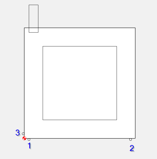

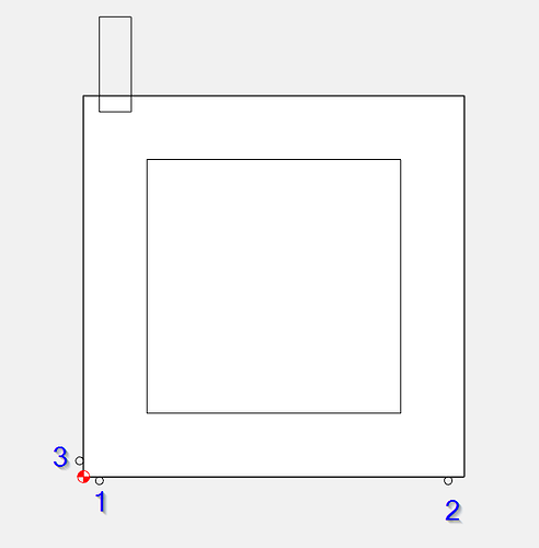

Here’s a quick & easy way for a ‘one off’ job that requires no fixtures or guides.
You can do this on the spoilboard, or add another sacrificial board on top.
Place your frame as square as you can get it by eye.
chuck up a 1/4" dowel and move it to a position close to the left edge, and in front of your stock. [1], just above the table or spoilboard.
Butt the stock into the dowel and place a clamp opposite of this point.
Now move the dowel using the Z and X jog only, leaving Y where it is. Lower the dowel to just above the table again, near the right front edge [2]. Bump the stock into the dowel & place another clamp anywhere.
Go to your Set Zero page and type “-0.125” into the Y field and hit Enter.
Now on the left edge, jog the dowel into the left edge until it just touches.
Go to your Set Zero page and type “-0.125” into the X field and hit Enter.
Now you just need to set Z. Assuming you’re using Top of Stock for your Zero Height, touch the top of the stock & Zero Z. If not using a bitsetter, wait and do this after you load the actual tool.

One other approach to get an 8x8 square hole exactly centered in a 12x12 board is start with a board larger than 12x12 and cut both inner hole and outer perimeter in the same file. In create make one of the squares and use the offset tool to make the other. Corner positionless critical with this approach

Lastly, when I hit Start Job, I get this error below. I set my zero position at the front left corner of the 12 x 12 and the project is just cutting the 8 x 8" so I’m not sure why it would have this error.
