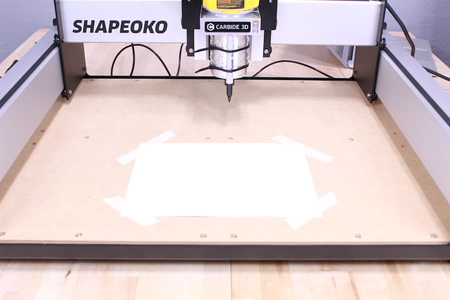

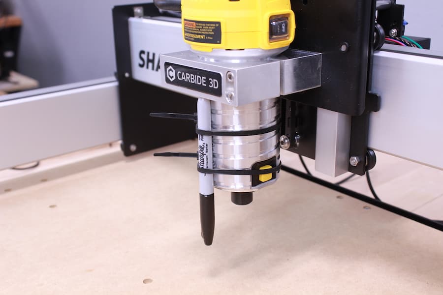

secure the paper and mount the Sharpie — note that on newer machines one can use the nifty “Quick Draw”:
Secure Paper
Tape a piece of paper (letter sized, A4) to your machine in landscape orientation. The paper needs to be secured at all 4 corners, make sure it lays flat and smooth. Masking tape works well.
PROTIP: Place a piece of cardboard below the paper, both to prevent bleed through to your wasteboard, and to provide a little ‘cushion’ to a felt tip pen or marker.
Using zip ties, mount the Sharpie to the slot of your spindle. You can wrap a strong rubber band around the pen or use a small clamp to really secure the marker.

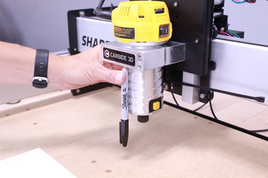

For this tutorial, we are starting the job from the lower left hand corner of the paper.
  1. Change the ‘INCREMENT’ value to FAST.
  2. Use the Y- button to move your machine towards the front edge.
  3. use the X- button to move your machine towards the left edge.
  4. Use the Z- button to move the sharpie closer to the paper.
When the Sharpie gets close to the corner, change the INCREMENT value to something smaller, like 1mm or 0.25mm.
Continue using the directional buttons to position the sharpie in the lower left corner of the paper as shown in the photo above.
Continue to jog the Z-axis down until the Sharpie is barely touching the paper.

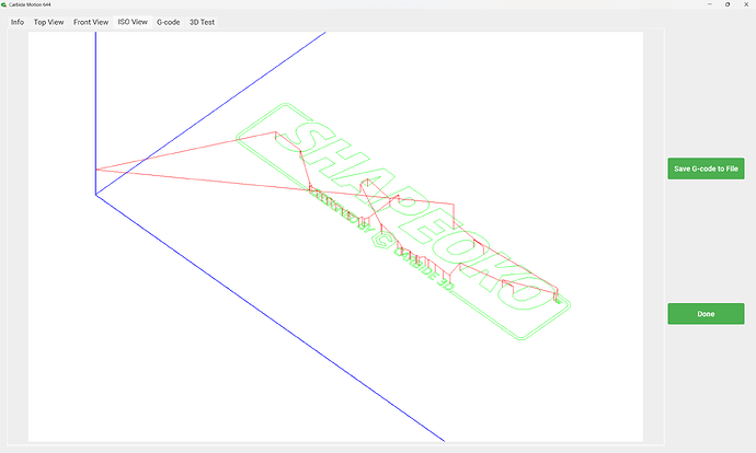

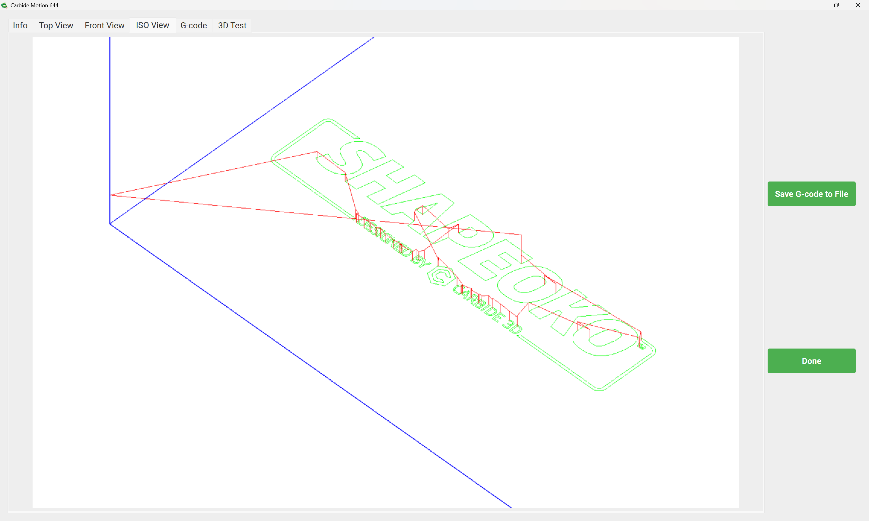

In newer versions, a preview window will appear:
review the various tabs and once satisfied that the file is the correct one, and that the origin matches the zero click “Done”
